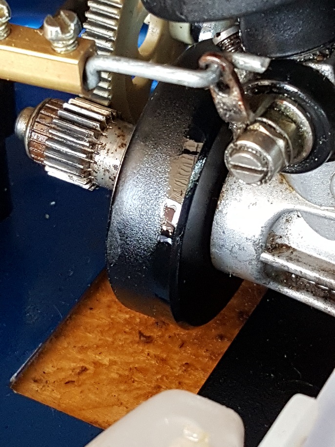

I noticed that after having it running (igniter attached....) for about a minute, the idle stop screw & spring are pretty wet with fuel, and some fuel sprayed up onto underside of air-filter body (on the linkage side of the carb). I wiped them dry, had another couple of quick goes at starting (un-successfully), wet again afterwards.
I don't know if this is normal..?
This, after wiping the flywheel dry, priming and half a dozen or so pulls on the starter.

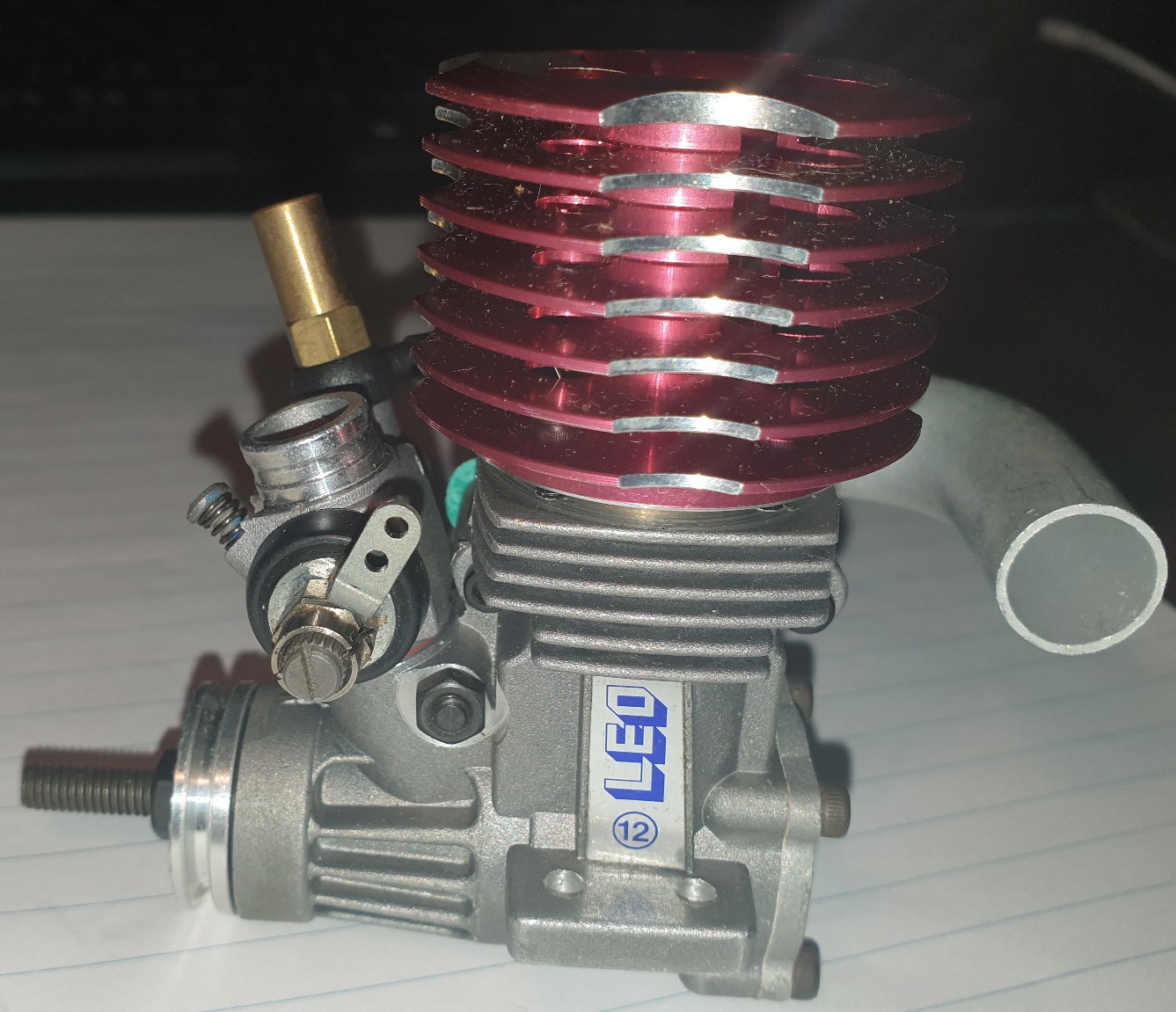

Having said that, I do have a NIB Leo 12.... although it appears slightly different to yours Colin - red head, tuned pipe, and no pullstart. These pictures may help, or may not.... let's see.
Watching all the posts here, and will chime in when I can add something useful :shock:

Alex, that looks like a GT manifold and gasket ?
Posts: 3652
Has thanked: 1695 times
Been thanked: 1126 times
Re: Carb problems? (Nitro 10)
RC10th wrote: Sun Aug 25, 2019 9:17 pm I'll chime in after work.... Hard to type out a decent post on your phone with limited time
In that in this instance, GT means what, exactly? I assume it's a tuned pipe manifold, rather than the original cast unit, although I could probably sort one of those if necessary...
Just have to work out what looks better, red head or blue.... :lol:
