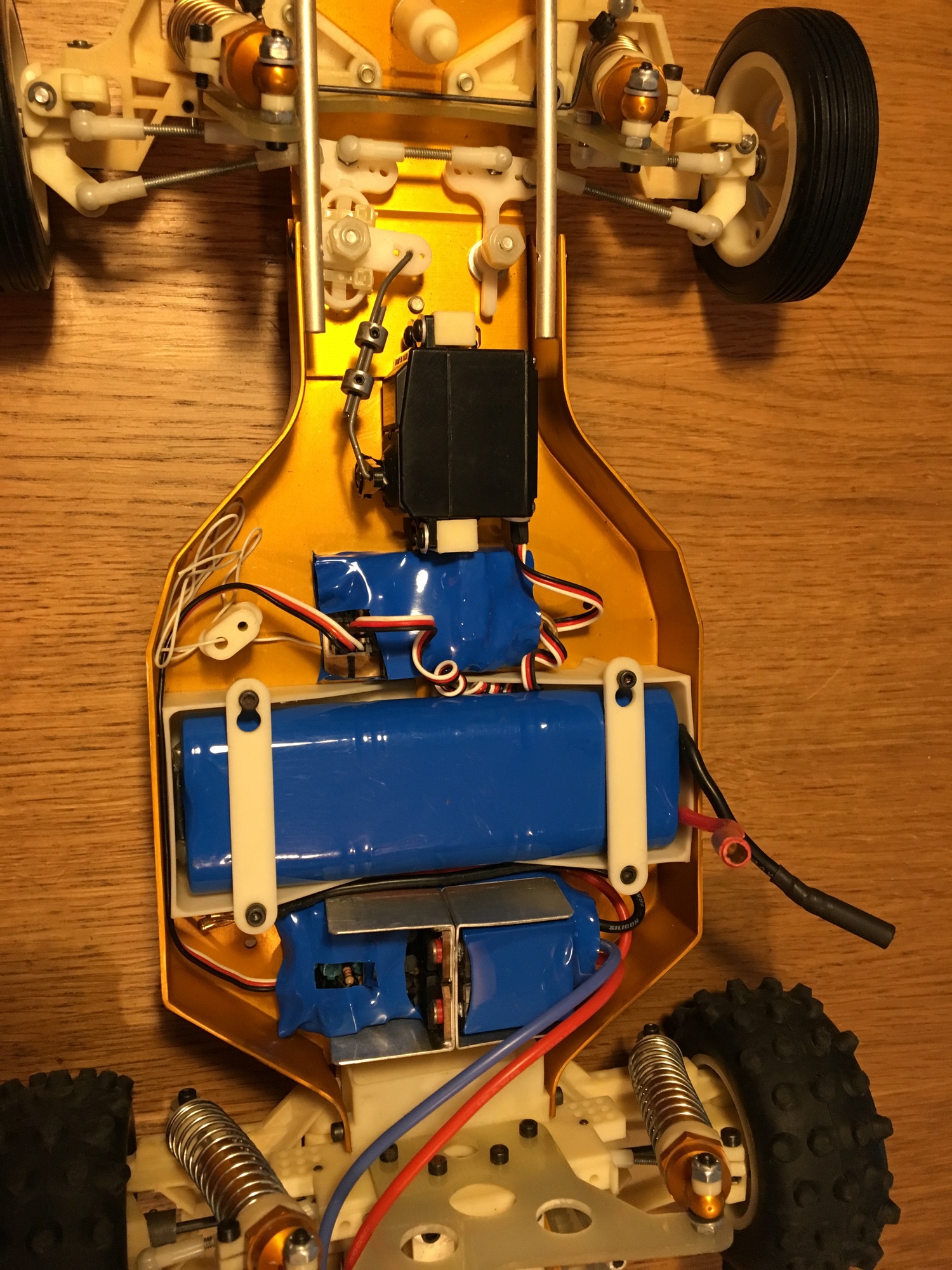

I just dug up my RC10 #6011 from my parent's house. I haven't found a battery that fits the transverse battery cup holders. Does anyone have suggestions on what to use in these models?

I am guessing you are looking at the measurement on NiMh 6 cell packs.
The nickel metal hydride (NiMh) 6 cell packs are longer than the older NiCads were.
Haven't seen NiCad packs for a while, but that doesn't mean they don't exist. I just don"t now where
Loose subC NiCads can still be found on Ebay and Amazon and elsewhere. You would need to solder the tabs on, shrink wrap it and wire it up to the ESC yourself.
One other thought would be to run a NiMh pack front to back.
All that said you could run a Lipo with a brushed ESC. There are a few threads mentioning this on RC10talk. Try a search.

If I recall 6 cell NiMh cells are the same size as NiCd, the problem is that most factory packs these days have plastic en caps installed. These make the pack about 1/4” too wide to fit transversely. Cut off the caps and you should be good to go.
I’ll post a picture later.

If you remove the plastic end caps, just be sure to cover the battery ends so that they don't short out against the chassis.
