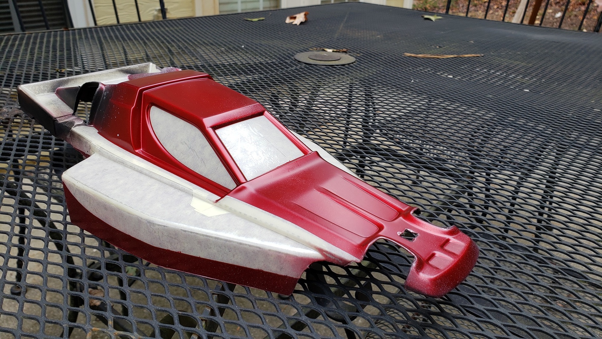

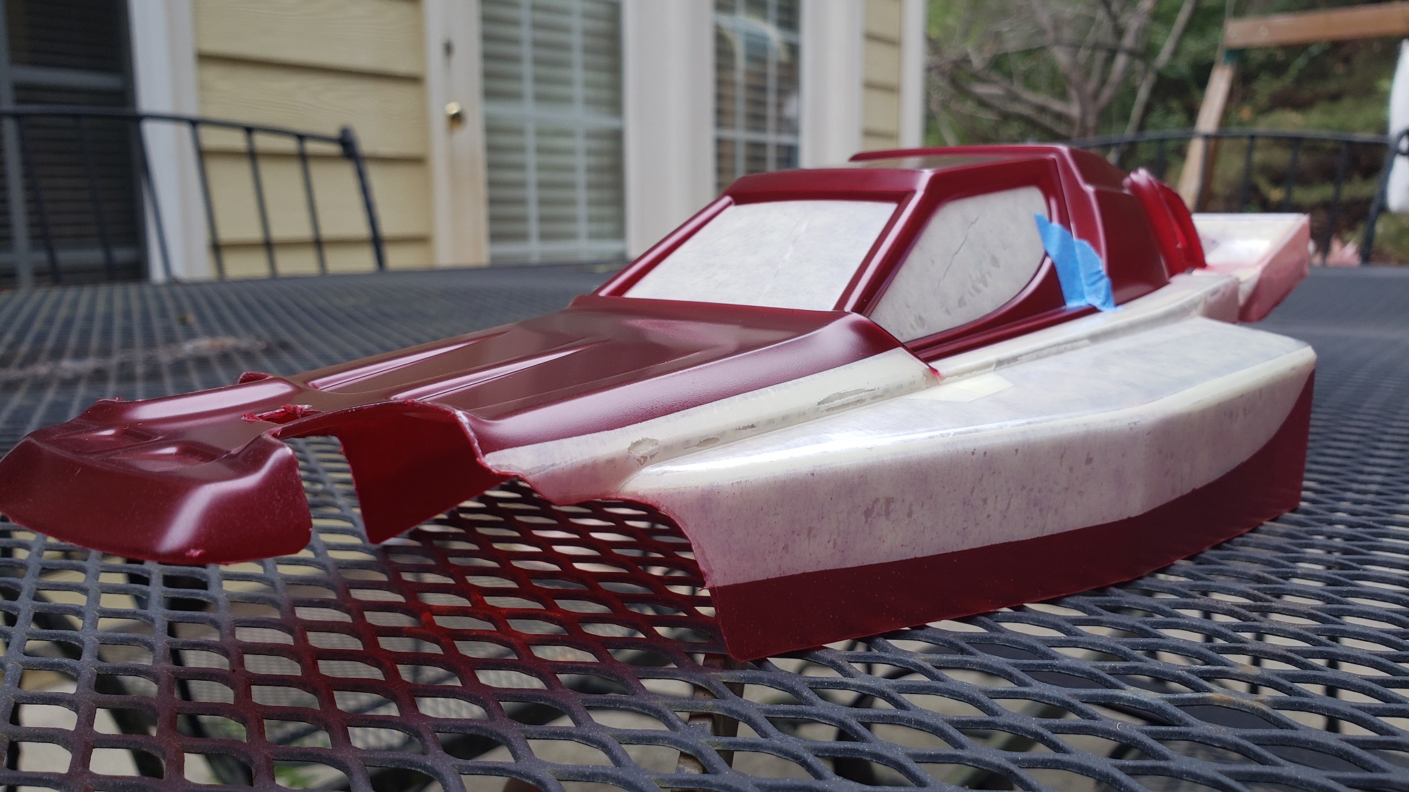

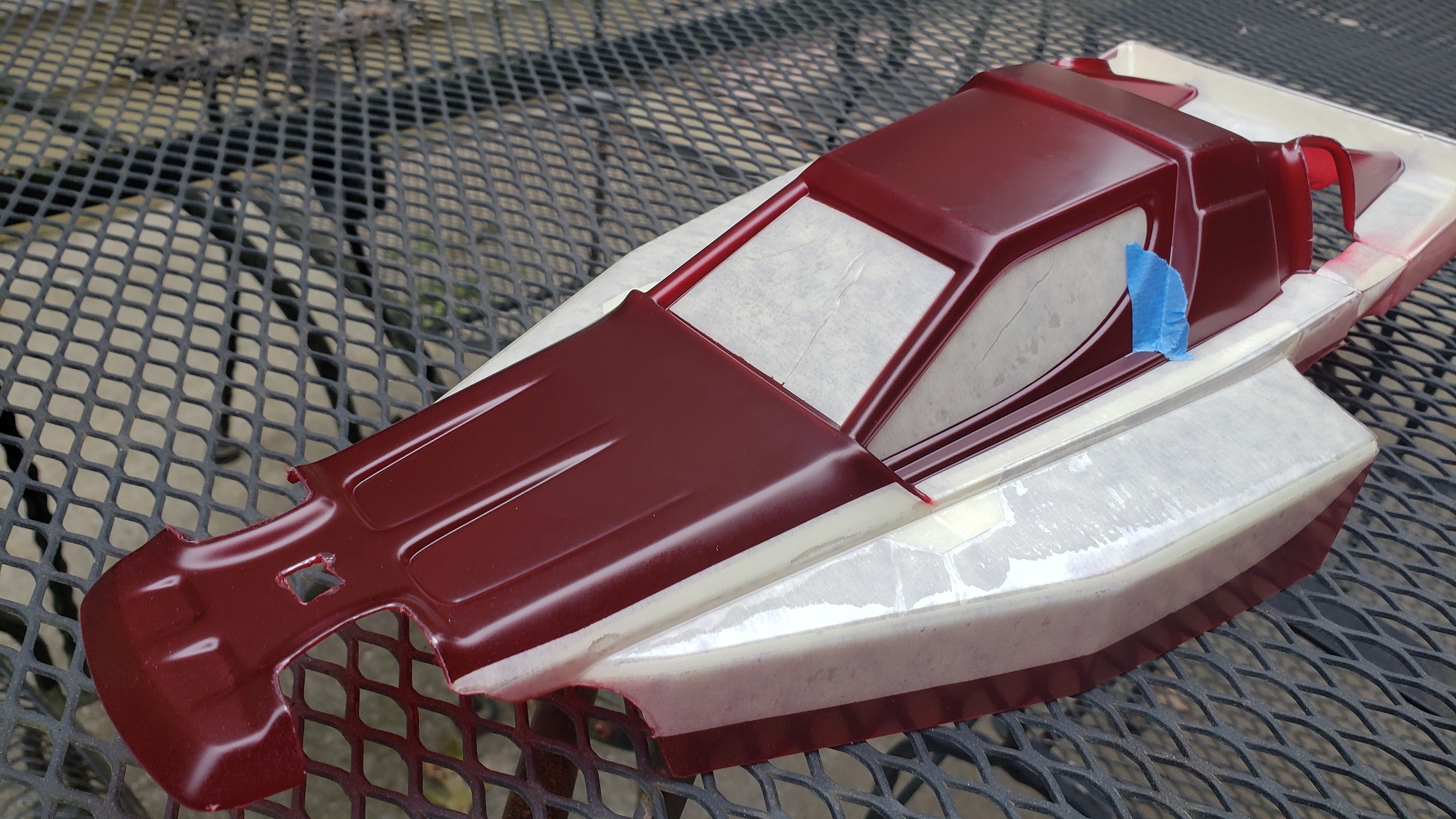

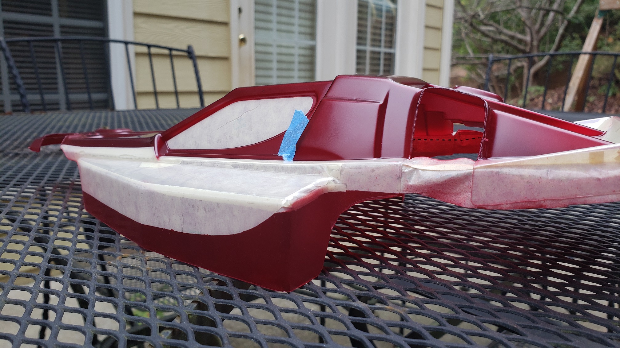

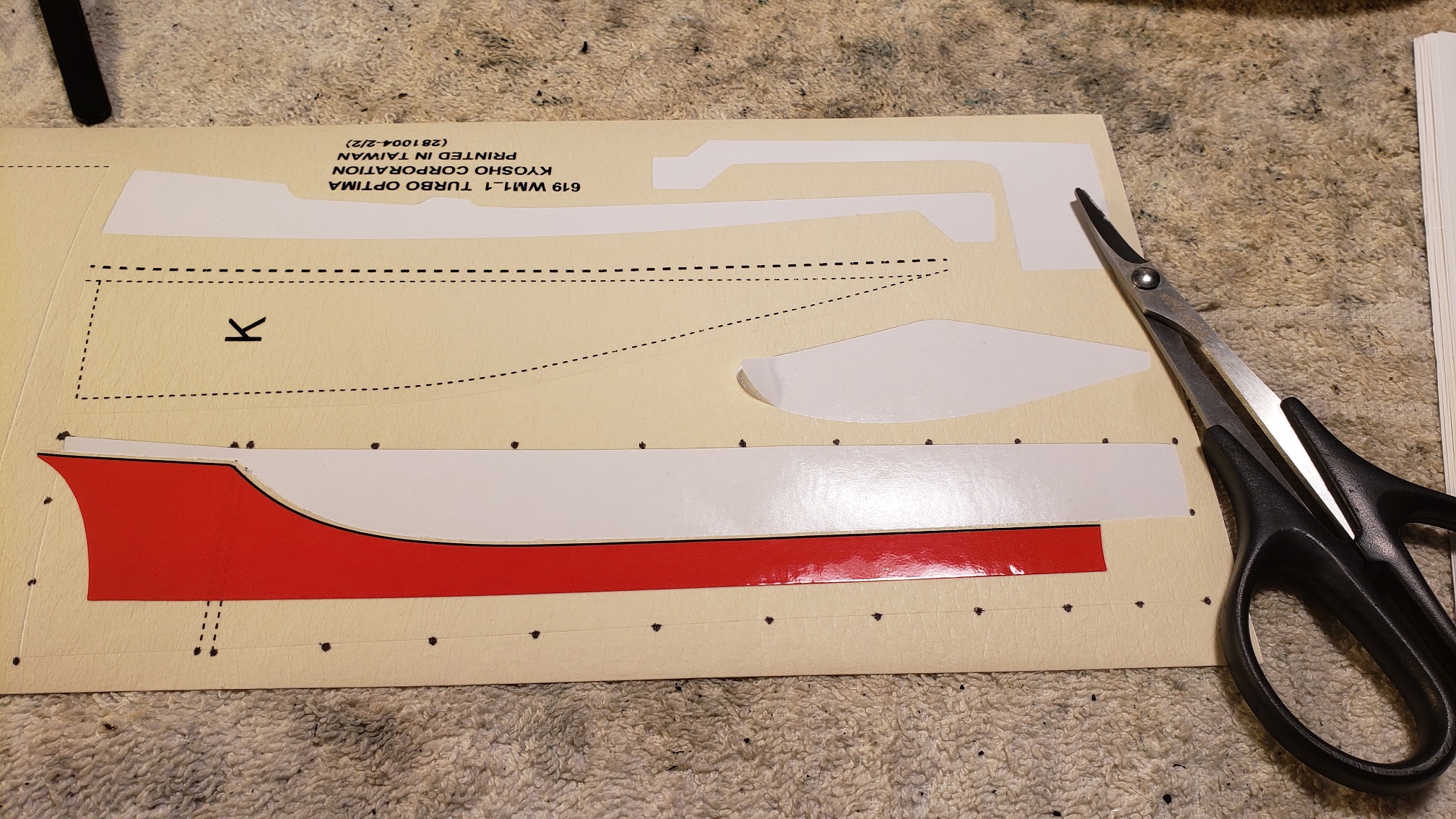

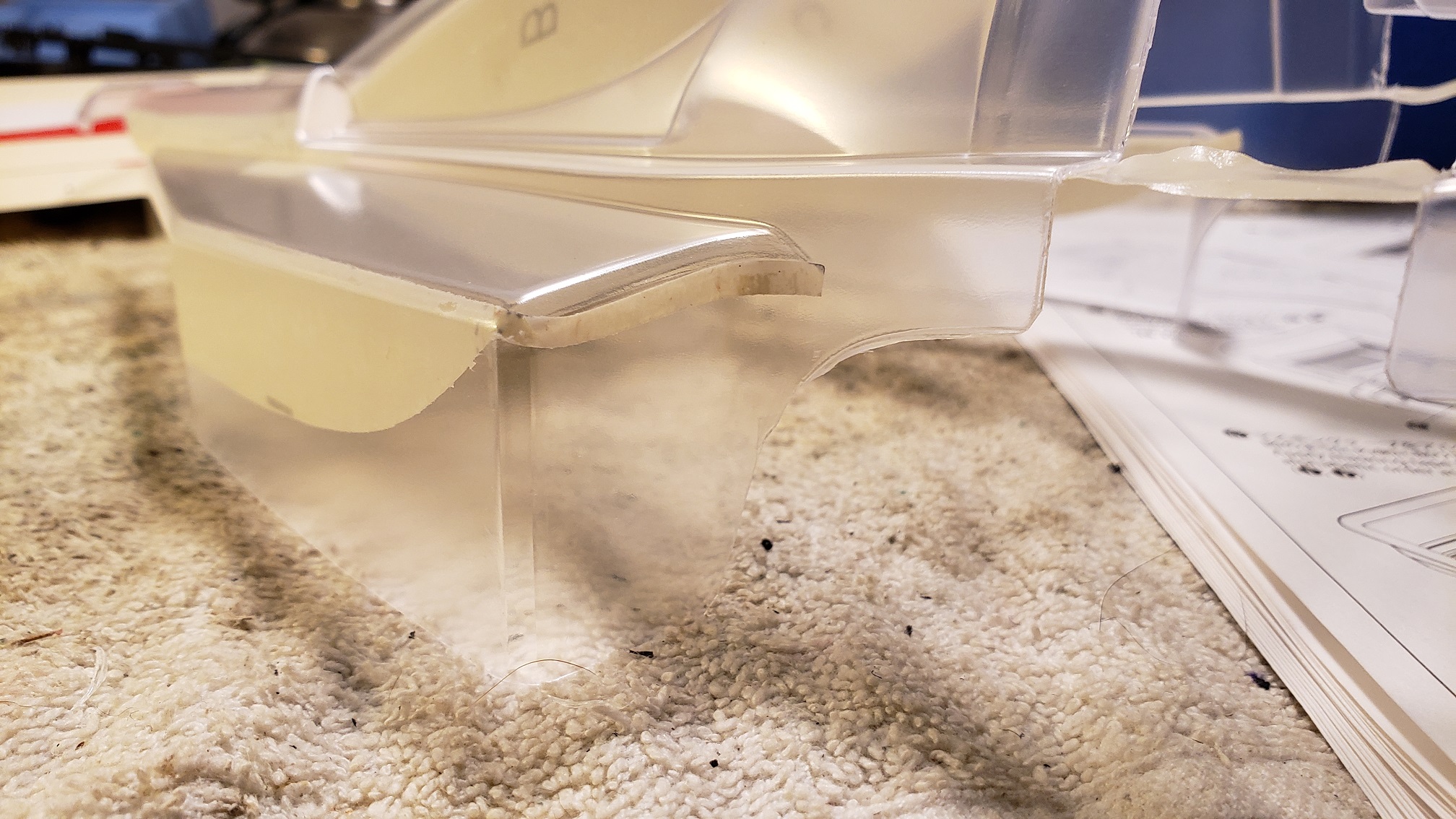

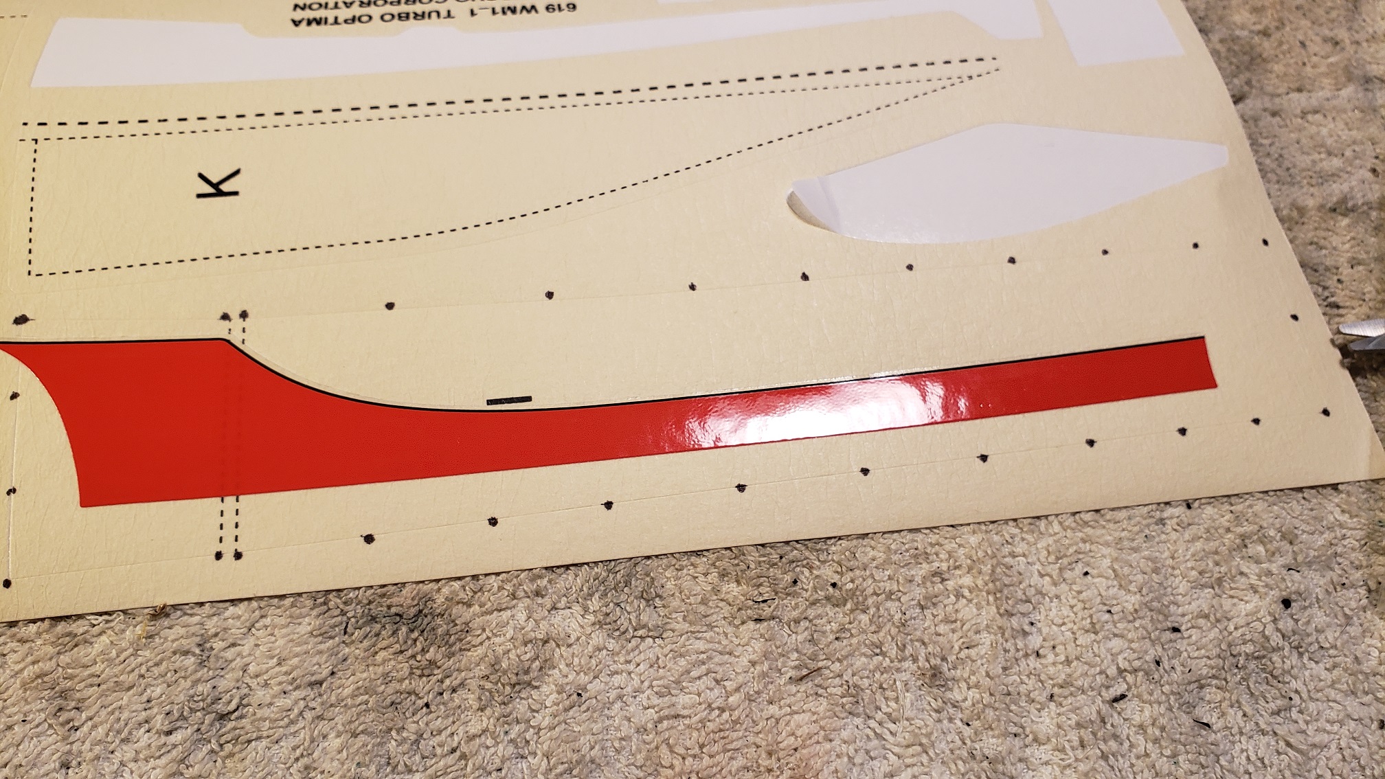

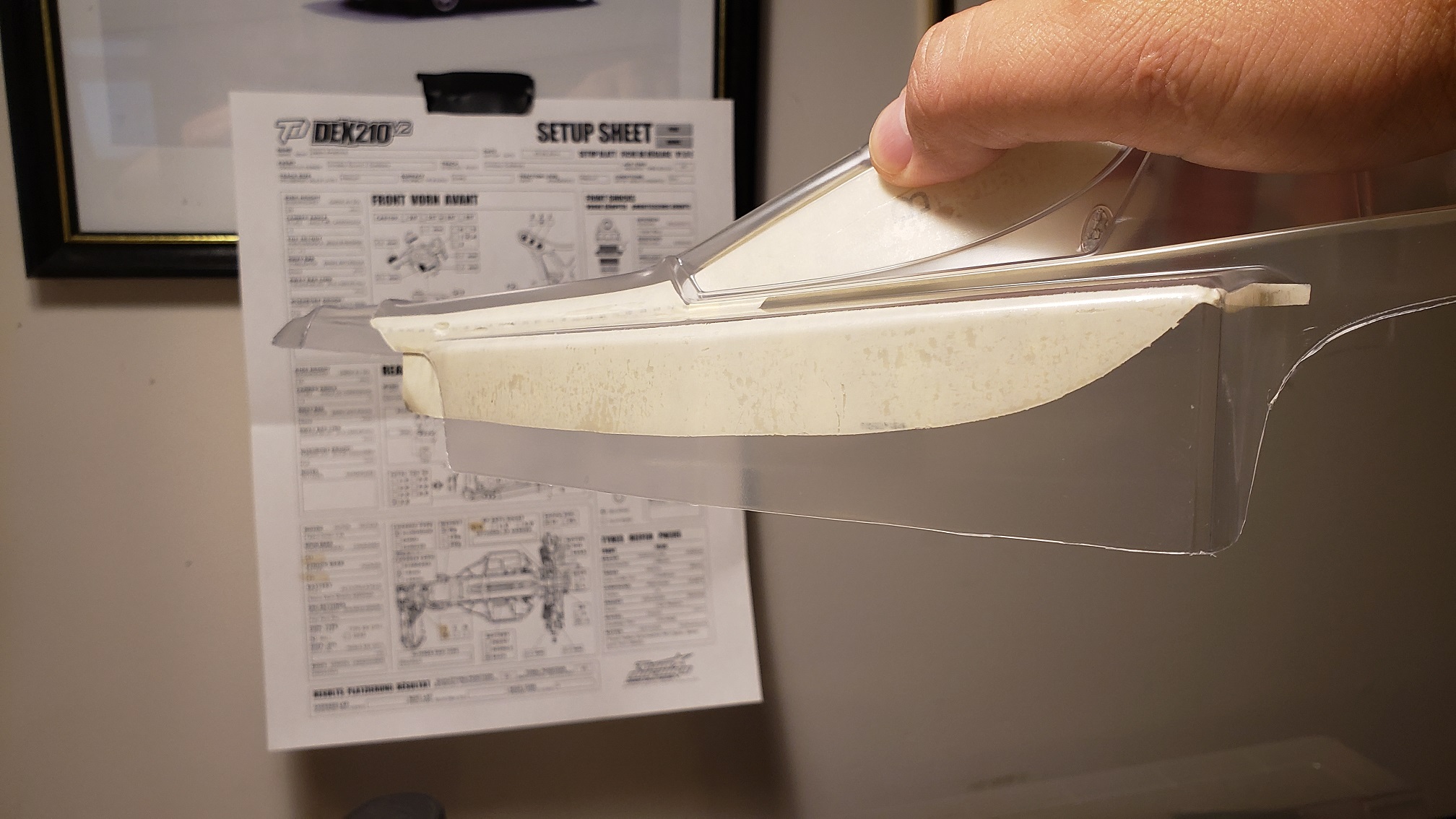

OK, so the painting story.
Since I knew that I was going to go a darker color for the red sections, I knew that I wouldn't be able to use the decals that came in the kit for the side pods. So I had to come up with some way for me to carve the included masking tape that would allow me to paint the bottom half of the side pods and create that swoop.
Then it dawned on me....
Use the decals to create the swoop! Then the masking started to look like this.... Once the weekend hit, I was able to get out and paint.

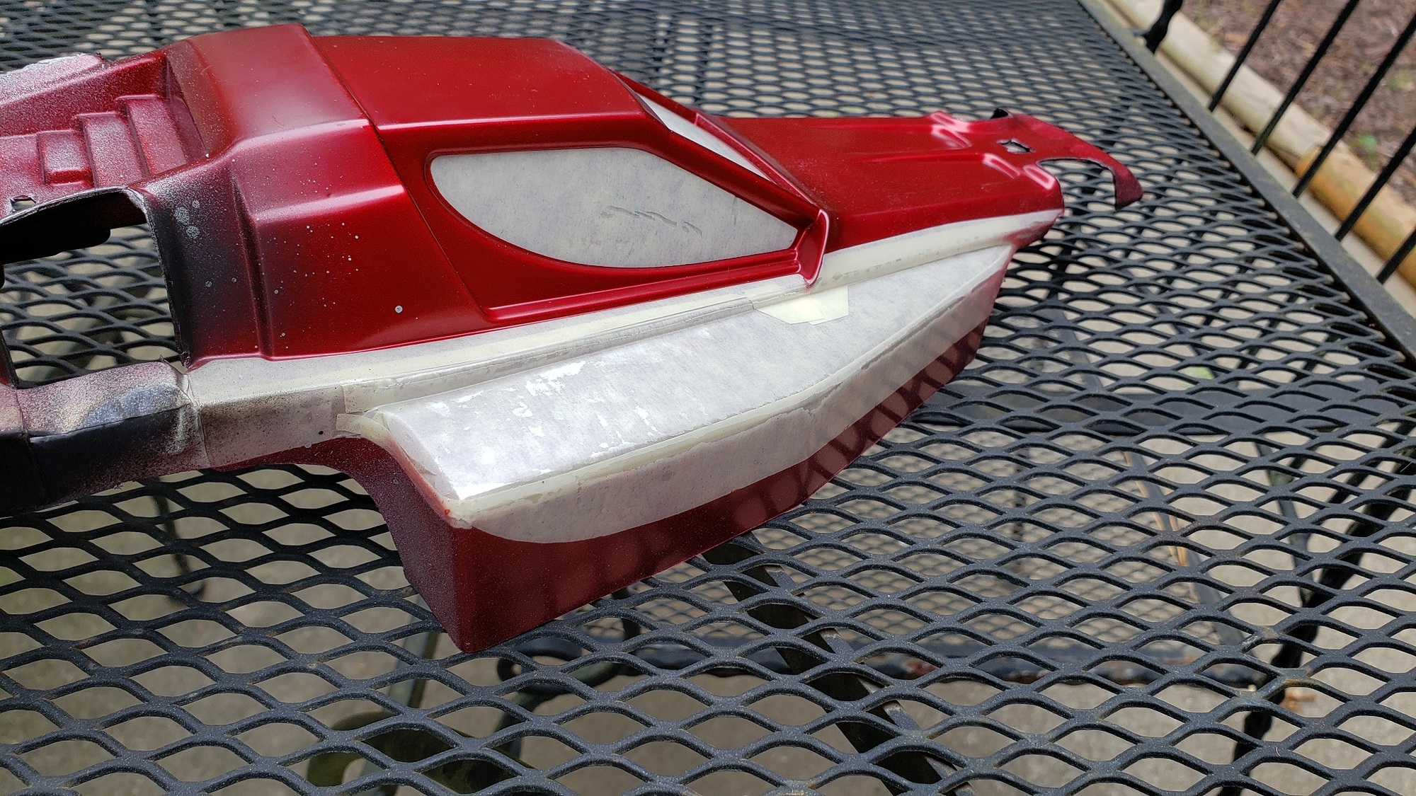

First was 3 coats of Tamiya Translucent Red. PS-37.
Proud owner of an RC10 Championship Edition from way back in '92
Late-model stuff: Durango DEX210 v1 and my daughter's Traxxas Rustler
- Posts: 33
- Joined: Sun Dec 27, 2015 9:07 pm
- Has thanked: 13 times
- Been thanked: 7 times

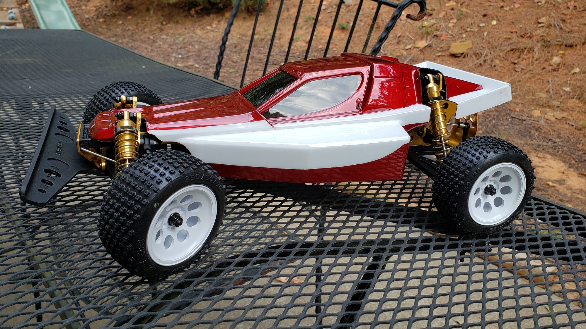

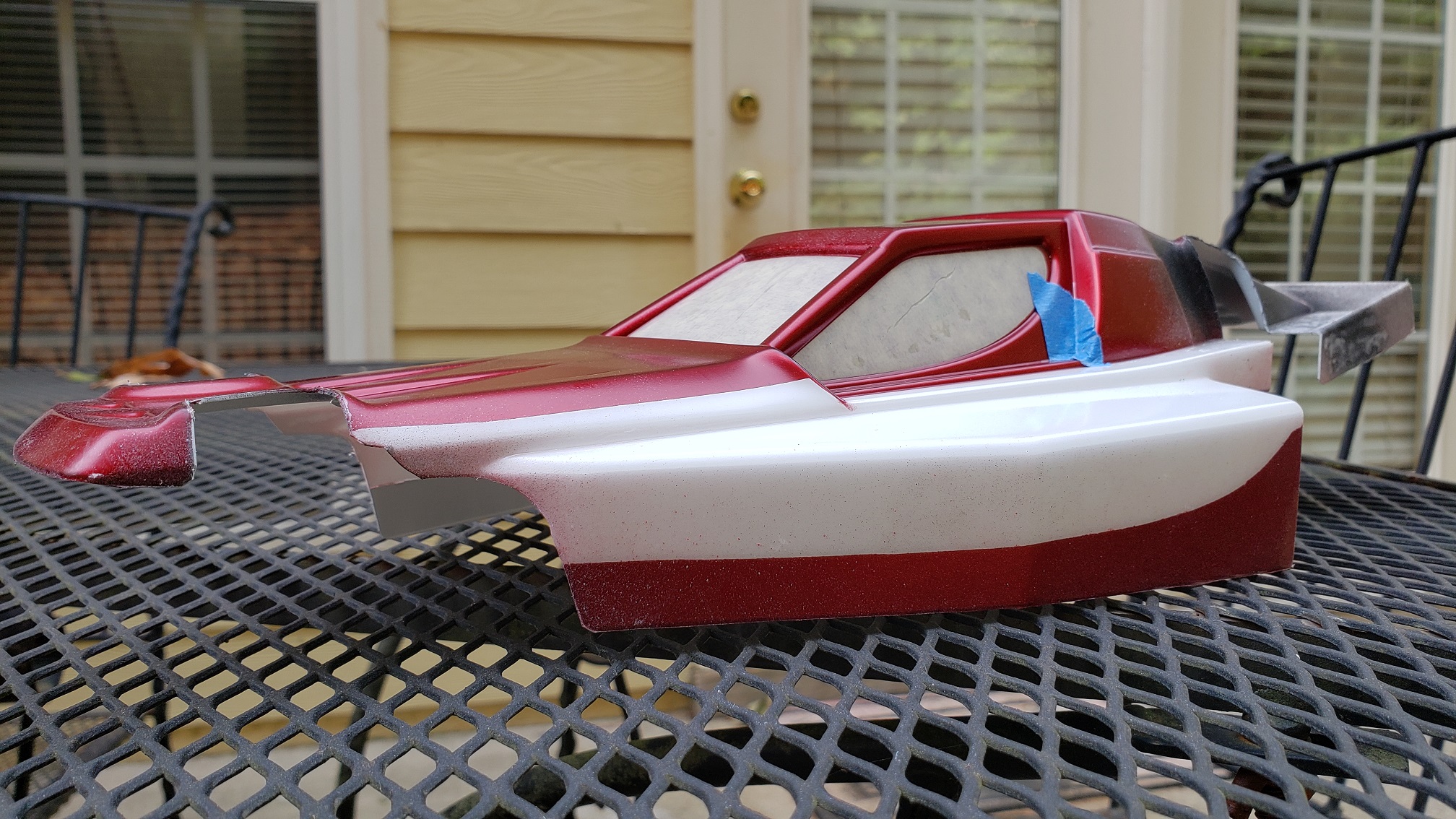

Re: First one I ever had... 2019 Turbo Optima re-re build

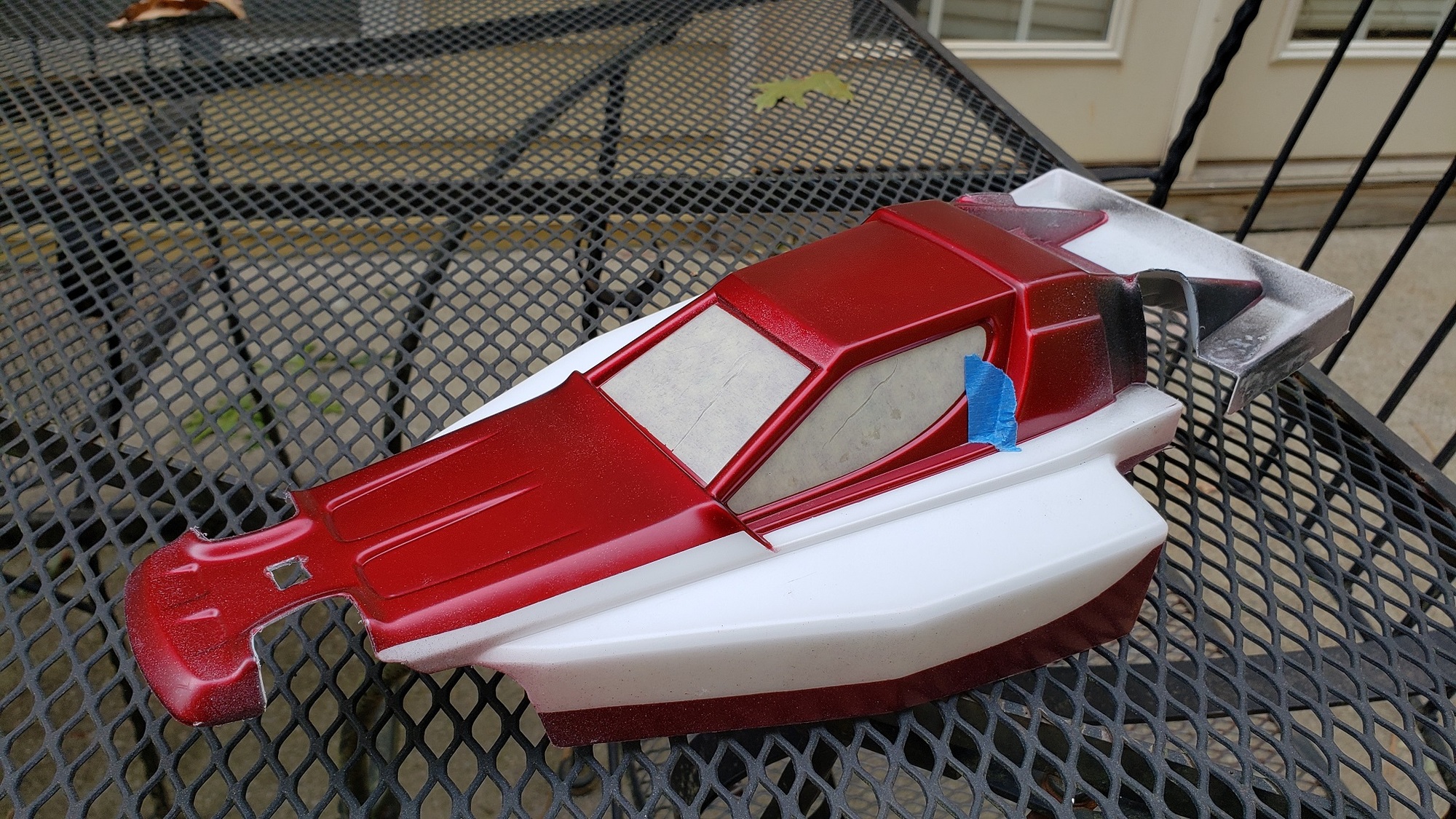

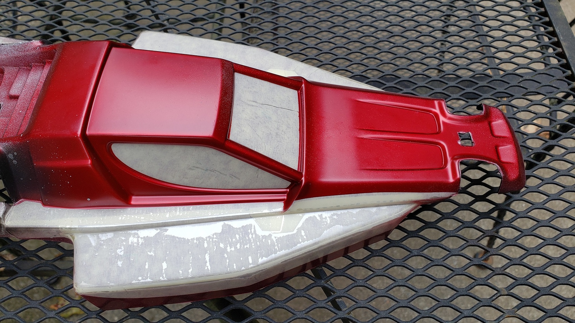

Behind that was 2 coats of Tamiya Bright Silver. PS-41. It was after this where the color really started to pop. (and I can't believe I actually just used that cliche).
After the silver, I followed it with one thick layer of Black. PS-5.
Then I pulled the masking tape, and painted the white. I couldn't avoid a couple of blemishes here.... I didn't have tape perfect in the back of the body, AND I actually dropped it on the lawn paint-side down.
Here's the white.... And thoughts of Starsky and Hutch start to come to mind.
My original plan was to then recarve a VERY thin line of the masking tape to create that fine black line in the original box art, but I decided that there was no way my hand was steady enough to keep it straight. So I decided to forego the black border line.
And then here's the finished paint job after peeling the protective film.

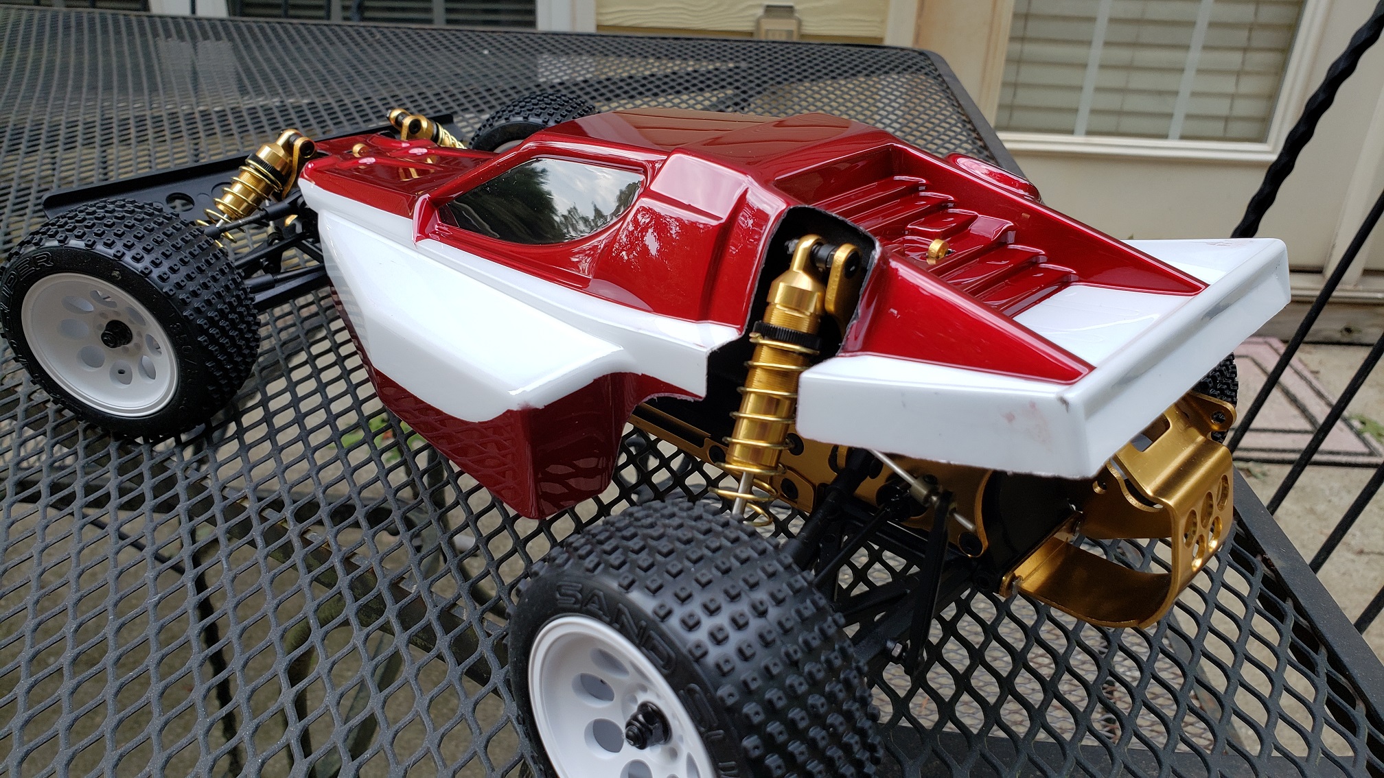

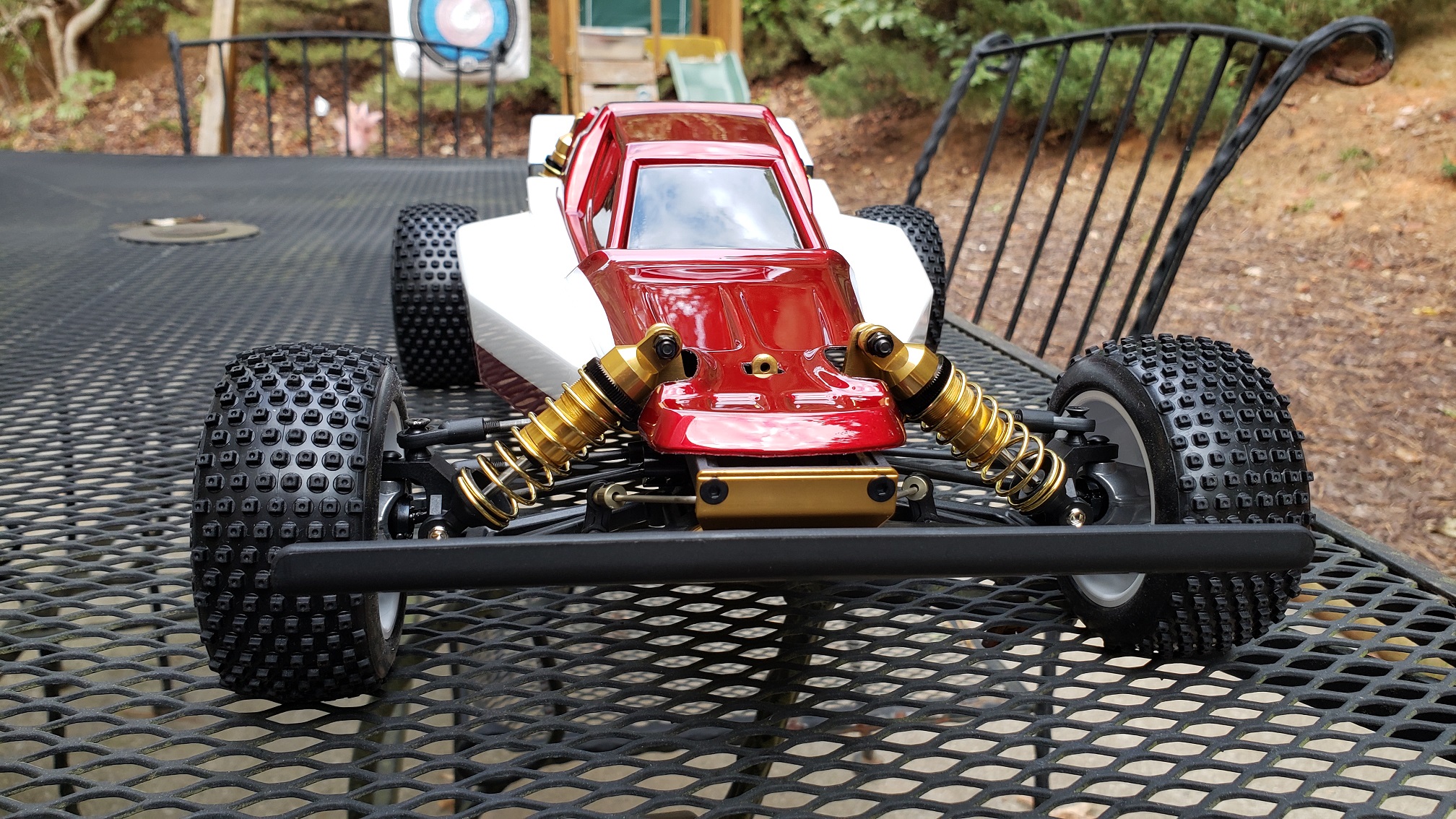

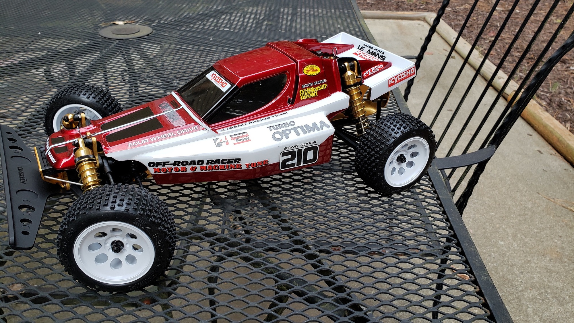

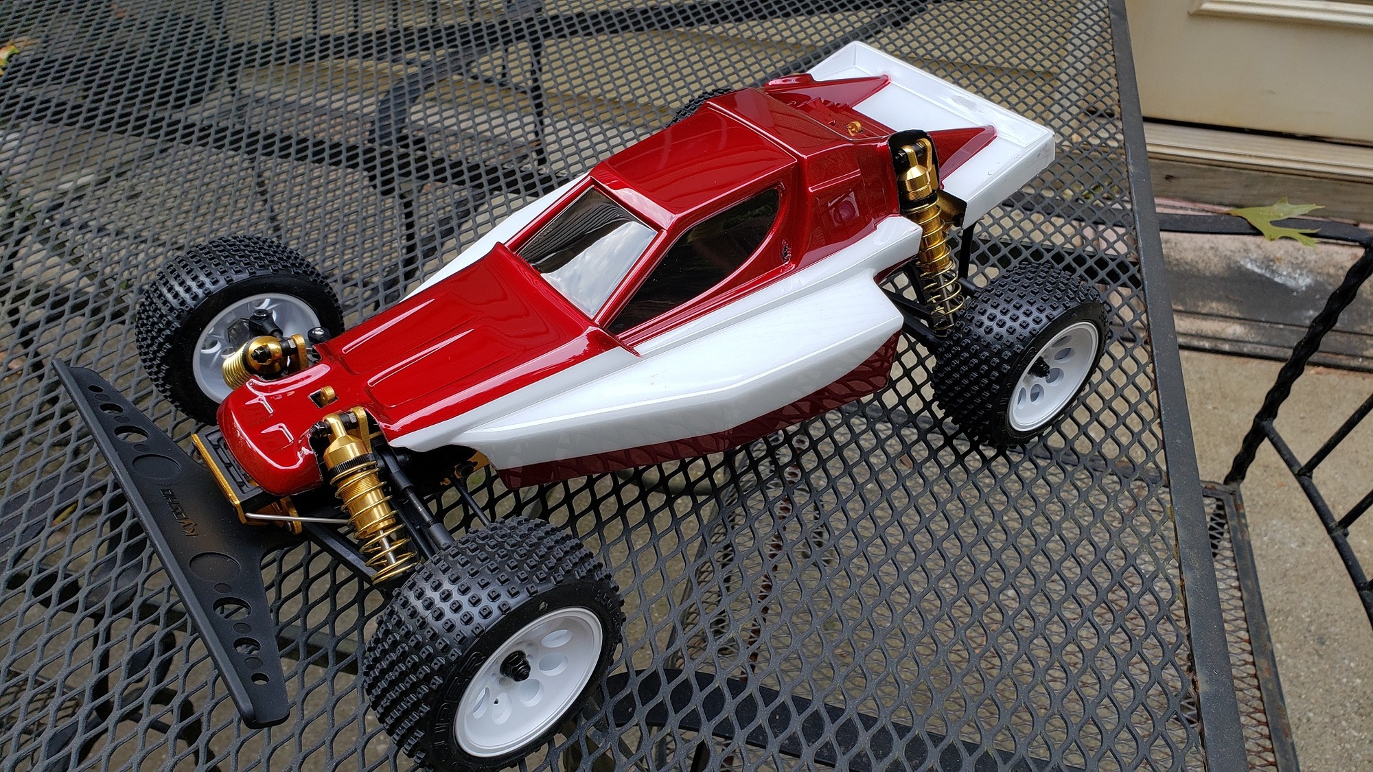

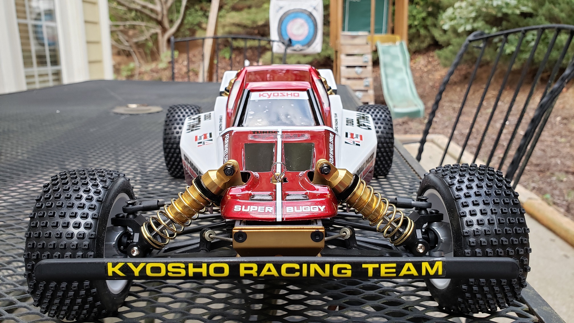

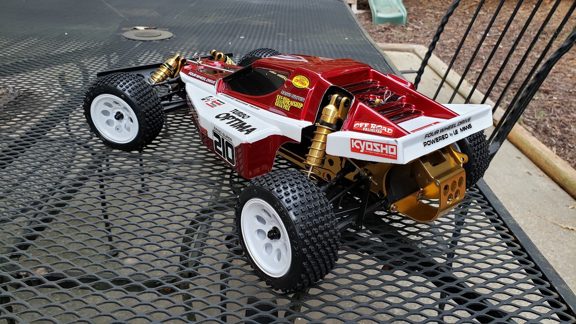

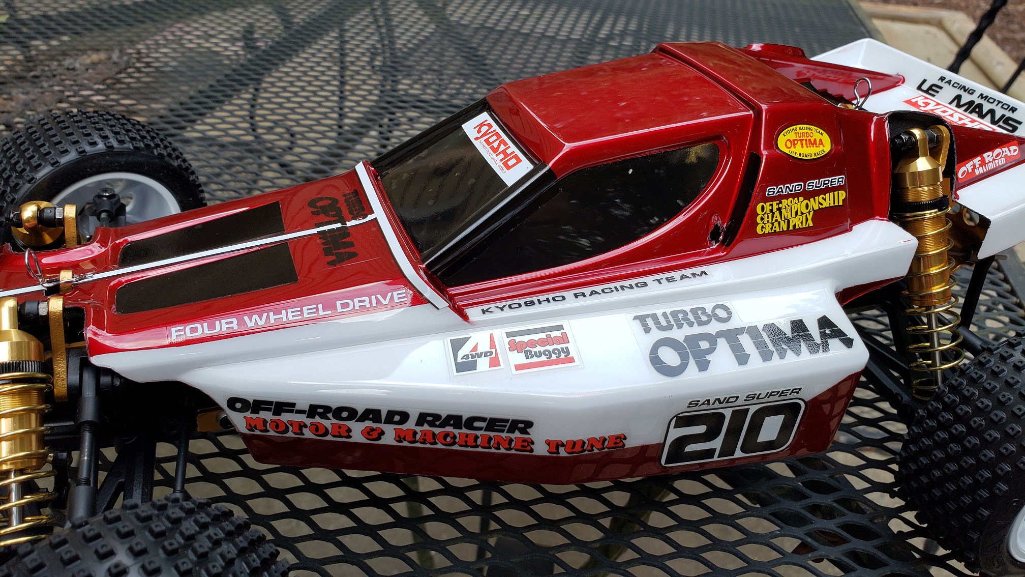

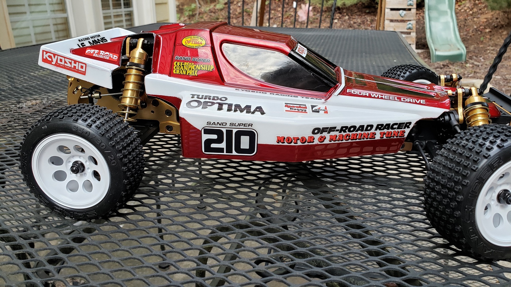

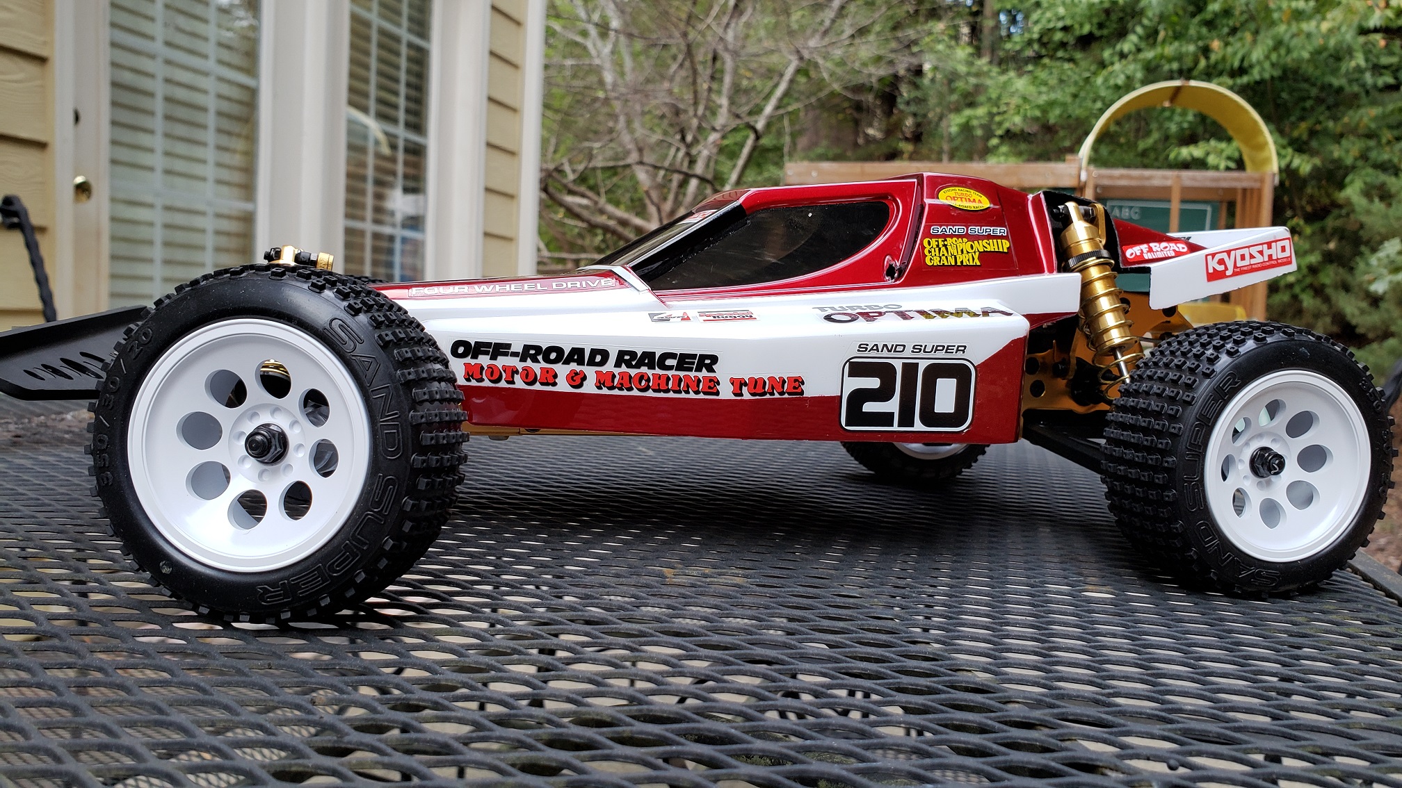

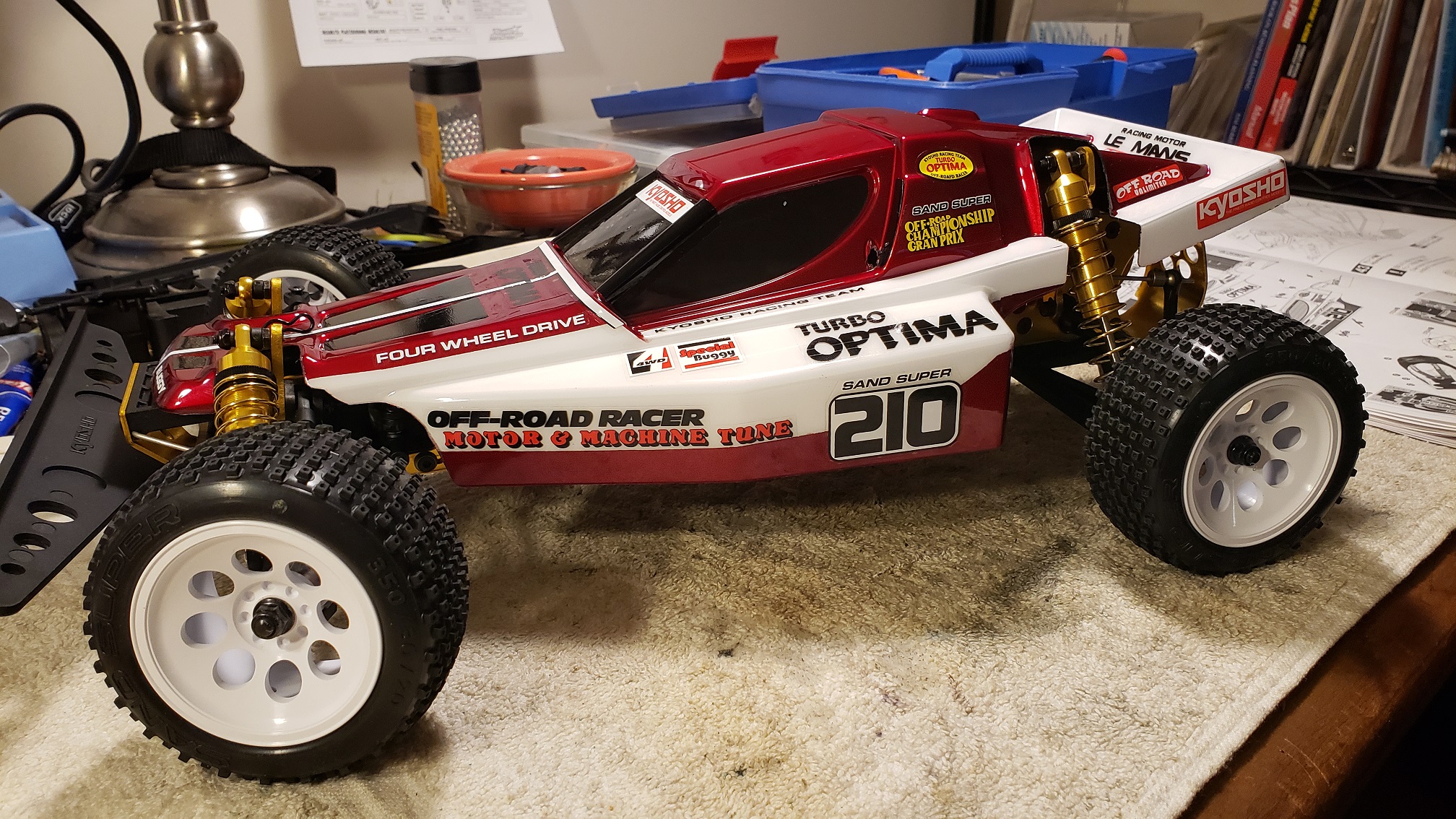

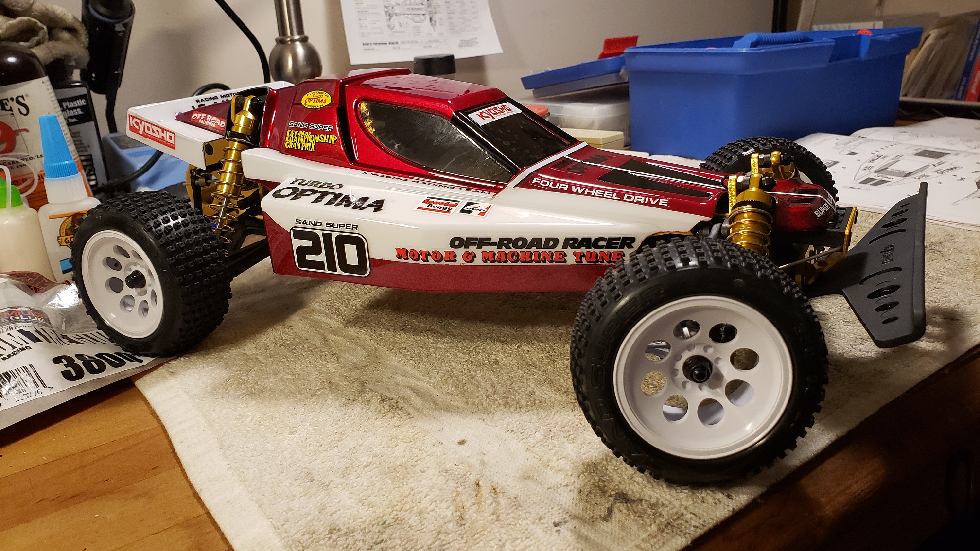

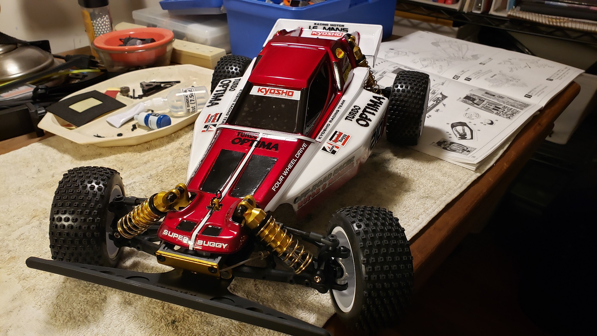

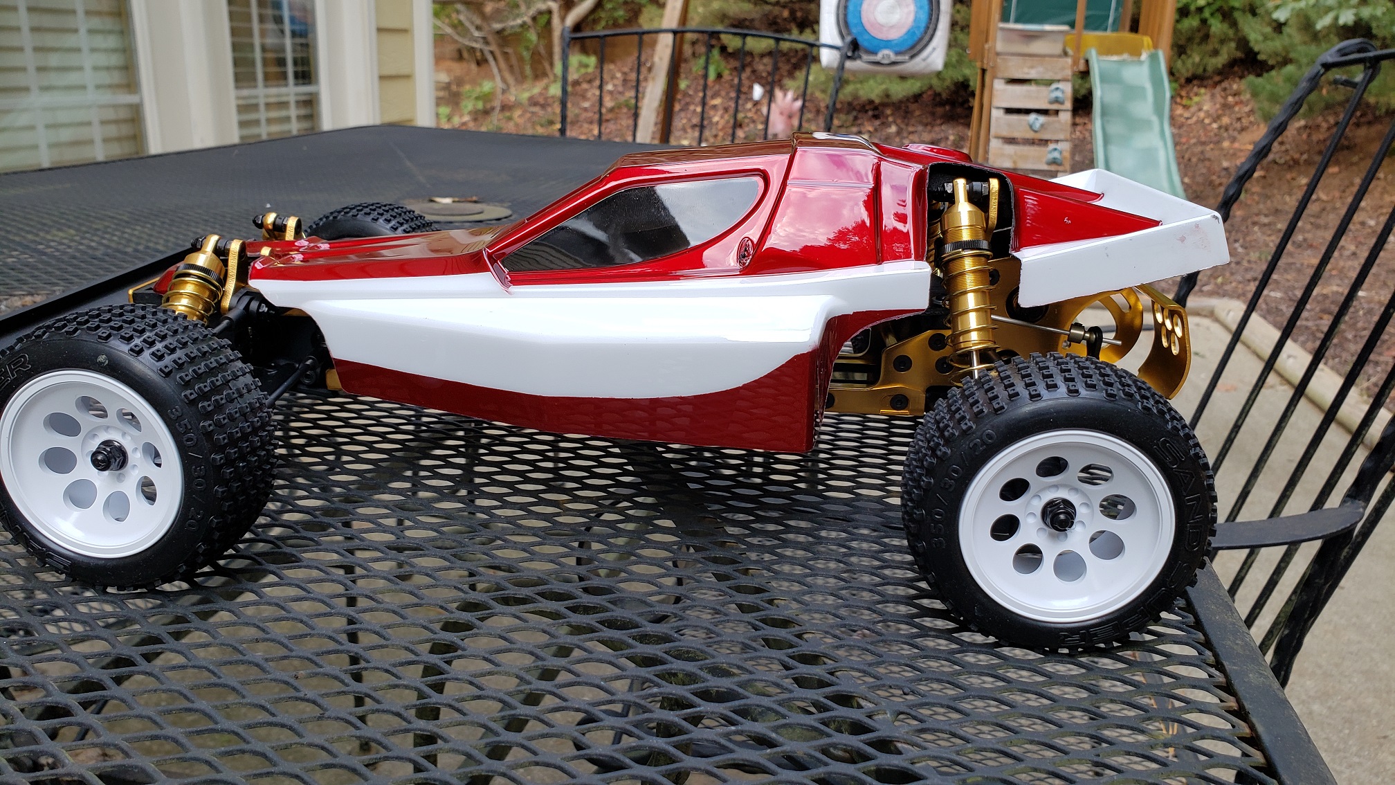

And then here are the final final pics after applying all the decals.
Funny, the instruction manual actually contains a guide on where to place everything to match the box art, BUT they actually miss a couple of them.... so keep a keen eye if you want to match the box art.
I'm sad to report that I didn't get the rear of the side pods perfect. BUT, I was as careful as I could be. There were about 3 different pieces of masking tape that joined at that spot, and it was hard to keep up with the layers.
This yellow on the bumper is the wrong decal, but the correct decal on the box is not anywhere to be found on the decal sheet.
And here are some inside under my desk lights. Does the red seem darker?
All in all. I think it came out pretty nice. I have to admit that I'm love with that red color.
