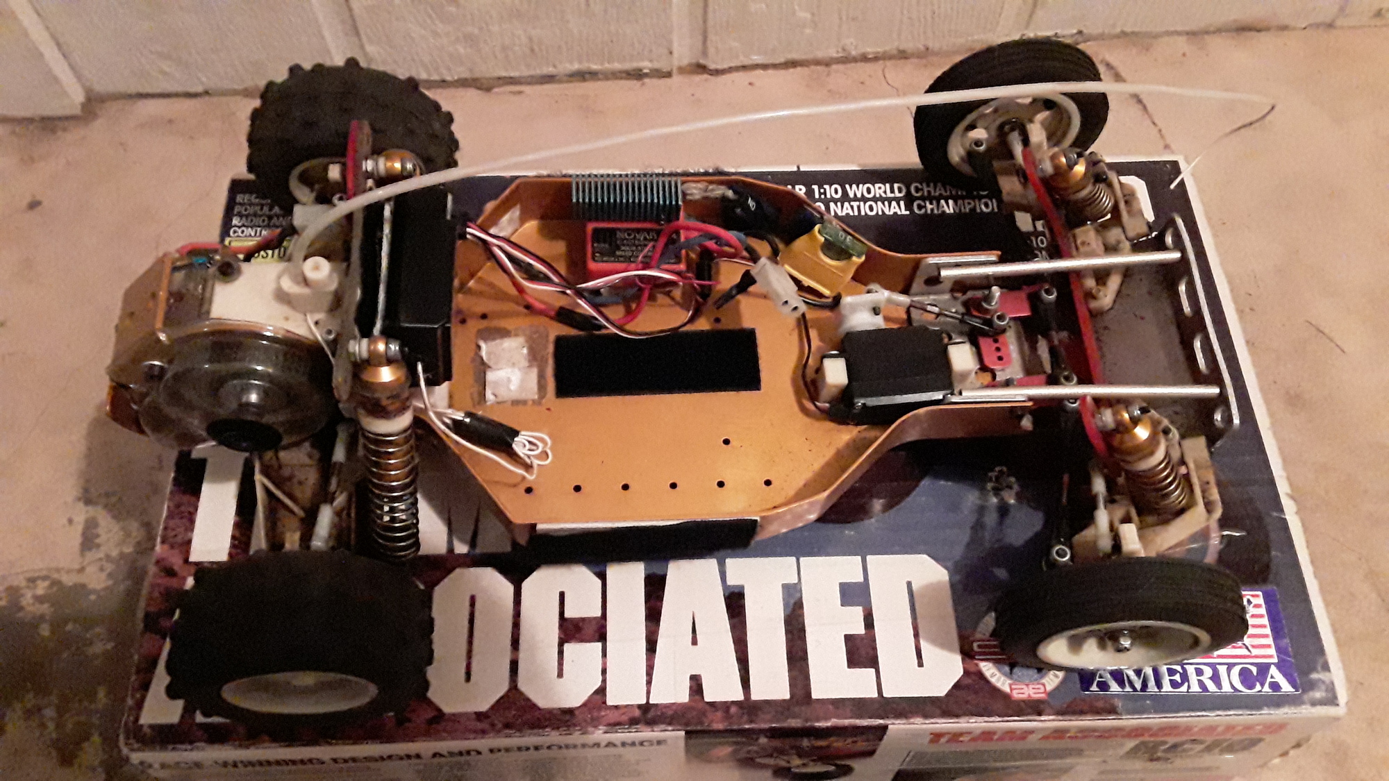

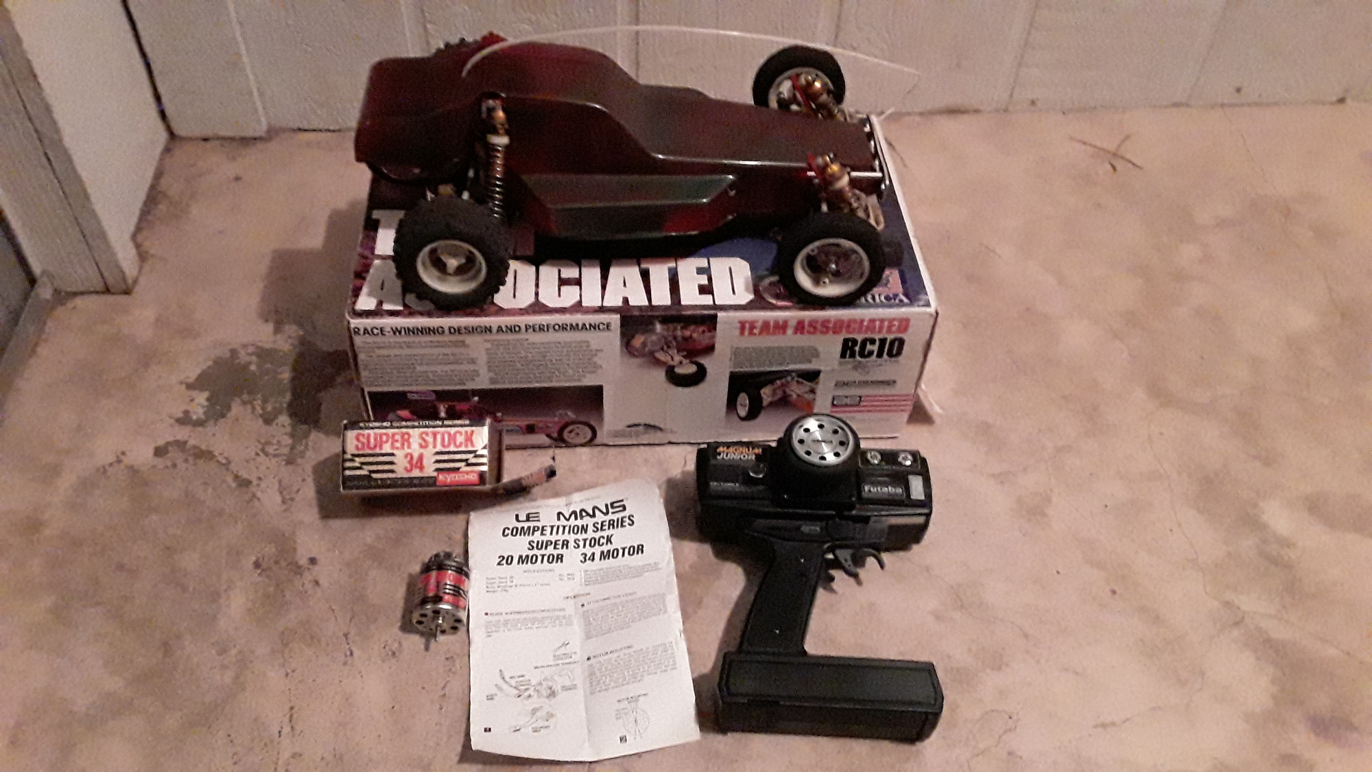

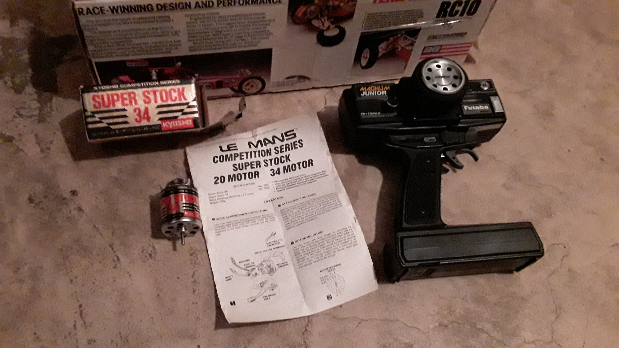

Hey guys, I'm a new 13 yr. old here, and this is my first post.
I got this old Team Associated RC10(built from the kit by my dad and grandpa), and I want to bring it back to life. :D
It's also got a Futaba Magnum Junior transmitter, and an aftermarket speed controller system. Stock motor, driving through a Vari-Lok differential.

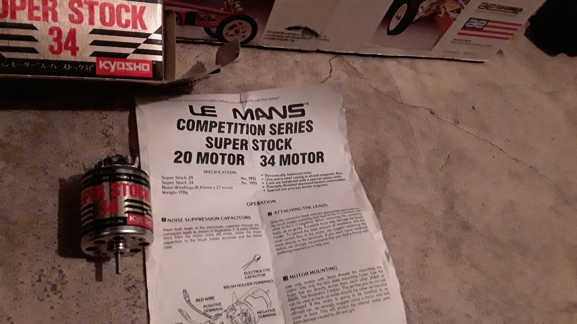

In the box, I also found a Kyosho Le Mans 34 Super Stock motor(with bearings)! :shock:
I'm considering swapping it in, or selling it to buy other parts, what's y'all's advice?
The Kyosho Le Mans 34 says 0.65mm x 27 turns. What does this mean? Is more turns desirable? And for what reason?
I can't find ANY info on the web for the LM34, so any info about it would be helpful.
it's also got dual bearings, so that's a HUGE plus!

Nice kit bud looks pretty much stock except for the red stuff which is ‘Hot Trick’ aftermarket hop ups. Do you plan on modernizing the electronics?
I would take the original wheels and tires off and get some others so you don’t ruin them.

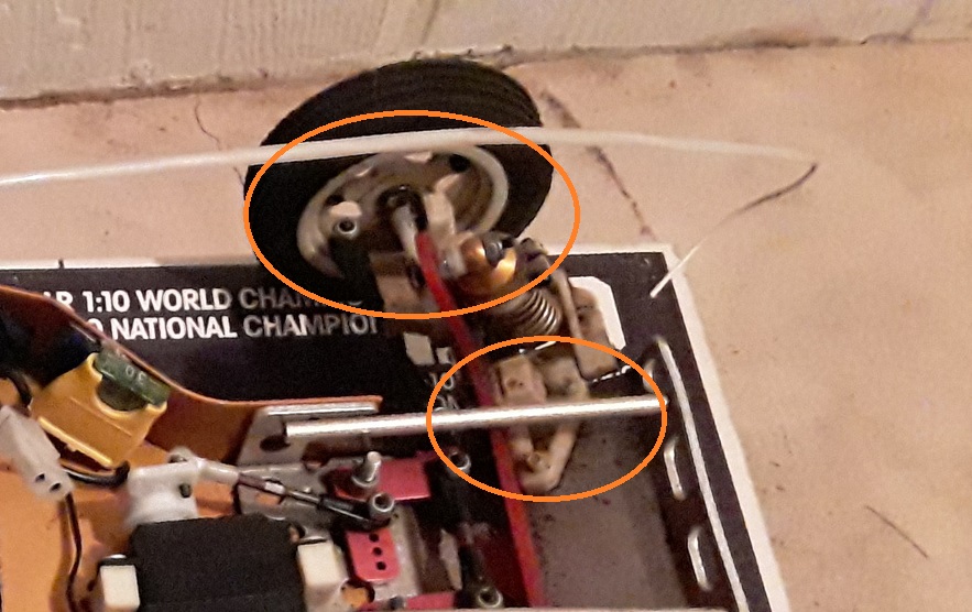

Hi JT,
You have a really nice car with some very cool upgrades. .65 x 27 turns refers to the size and number of turns of wire on the armature - less turns usually means a hotter motor.
As for the body, it's tricky to strip the paint but you can repaint the body on the outside (it's probably been painted on the inside). Either apply paint that's meant for polycarbonate (lexan) in a color of your choice to the outside then, if you want it to be glossy (lexan paint is flat), you can simply apply ordinary gloss clear. Or. you can "prime" the body with polycarbonate paint (white for instance) then apply just about any ordinary paint from a Walmart or from the auto parts store. If you apply ordinary paint directly to the lexan, it won't stick and it will flake off pretty quickly.
The steering parts and front arm pivot blocks are the parts I've broken most often - mostly likely because they've become dry and brittle over the years. If you re-hydrate these parts, it will improve their strength. Just dropping them in boiling water for about 10 minutes will make the nylon more pliable and less prone to breakage.

Vintage brushed "stock" motors are 27 turn, not sure of wire gauge. In my experience there is not a huge difference between the vintage 27 turn stock motors. It seemed to me batteries, gearing, type of car and mostly driving ability were just, if not more, important.
New brushless stock motors are considered 17.5 turn. The new 17.5 brushless motors are now more like vintage 10-12 turn brushed modified motors. Brushless motors will require a new brushless ESC however.

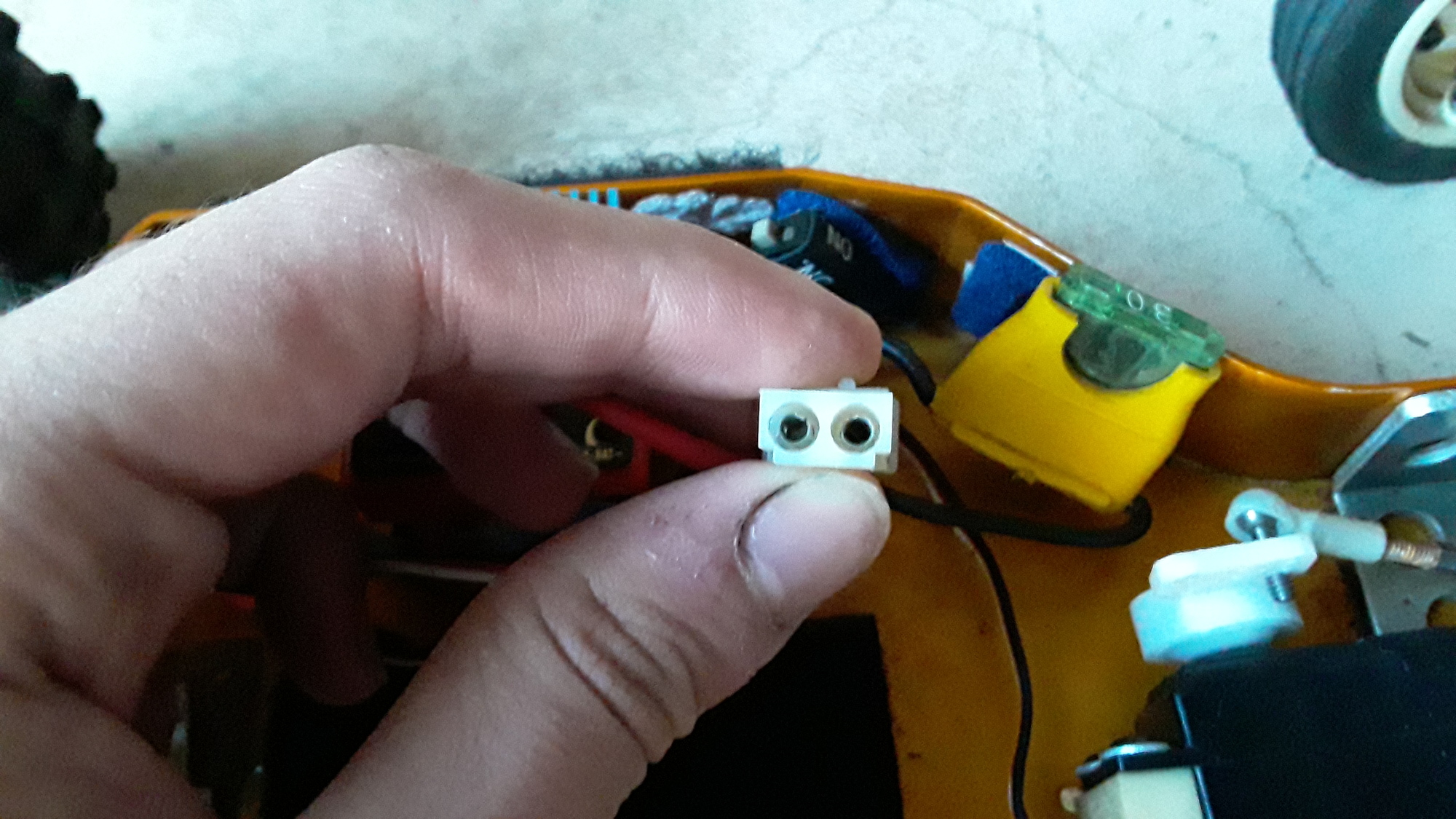

So I'm about ready to buy a battery for this thing, and I have a few questions.
One person told me to use a NiMH to keep from frying the electronics, but I don't see how a 7.2V NiMH would protect the components as compared to a 7.2V LiPo.
Any particular kinds of batteries I should avoid or look for?
What is this battery connector?

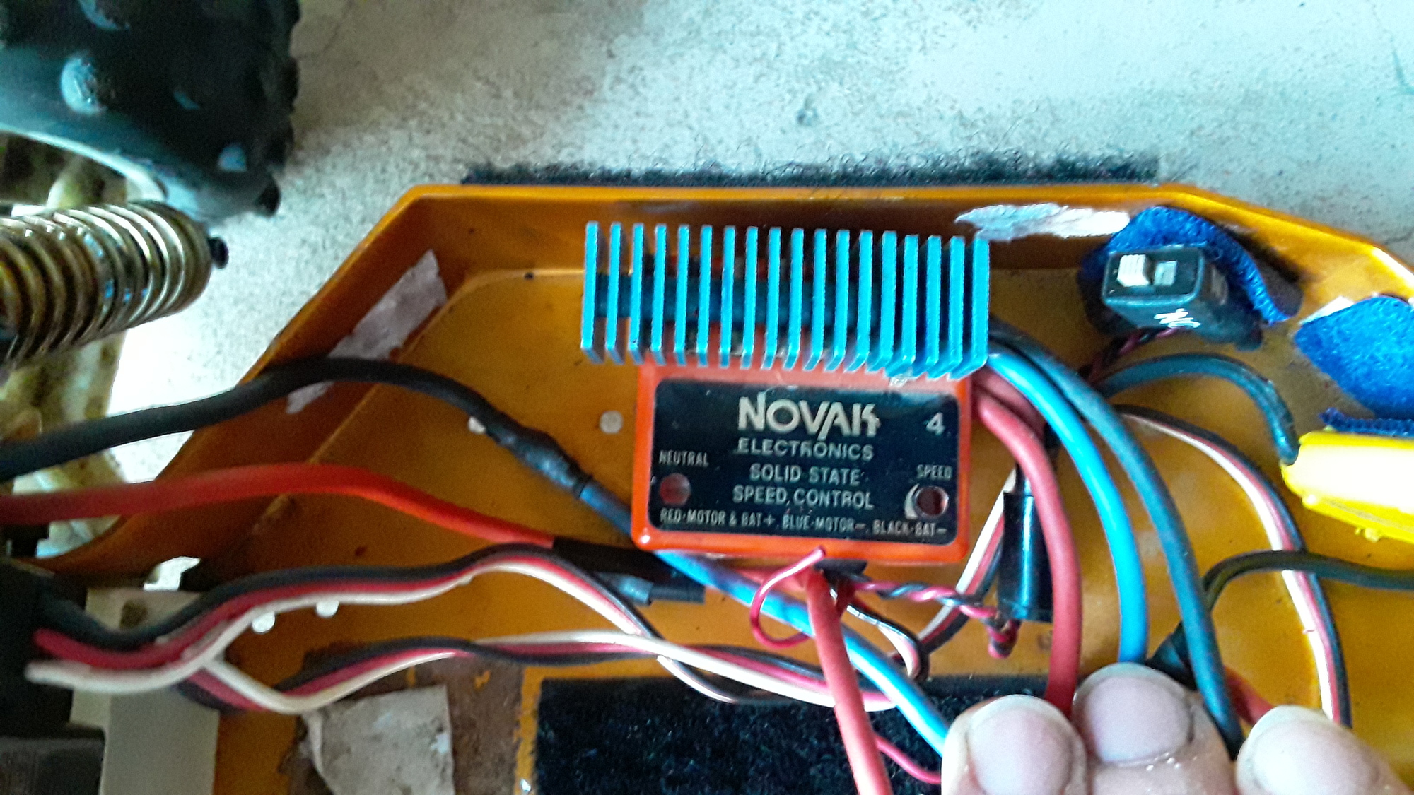

Also I noticed it's got an aftermarket Novak solid state speed controller, so that's a huge plus.
Original Cadillac A stamp AE RC10 with Hot Trick parts! That's how I roll! 8)

that's an associated style connector, made by molex. You won't find any batteries today with that style connector on it.
going to lipo should be no problem, however you need to look for a couple things:
first, that esc is a novak 4, which predates the novak t4, which had tempfets, which gave some protection from overheating. So that esc can be damaged with overheating.
Second, it has the old style connector on it, so you will need to replace with something. I would suggest finding a shortly lipo such as this:
https://www.towerhobbies.com/cgi-bin/wti0001p?&I=ASCC2166&P=FR&gclid=Cj0KCQjwrrXtBRCKARIsAMbU6bGjf3NxEkqySQ3Ds8ds8VCTFLgFYPon2qwlcY2p0Mlsib3DULm2crAaAmFtEALw_wcB
it doesn't have to be that one, but something like it in the 30 ish dollar range. whatever you purchase, swap out the connector on the esc to match the battery. don't forget you will need a lipo compatible charger.
be super careful to watch temps and if you can touch the heat sinks, you are OK. once it gets too hot to touch, stop and let cool. run for 5 ish minutes and check temps.
I would run something only about as hot as a 17-16 turn motor. there is no lipo alarm to alert you to when the battery is discharged, so read up on lipo voltage and safety.
that speed controller should have two heastinks on it, one on the forward fets(6 of them) and one on the brake fet/diode(two of them), if that is a single heatsink on there, don't even apply power, you will damage the esc.

I checked, and it's two separate heat sinks, I was able to remove the small one entirely and reinstall it.
