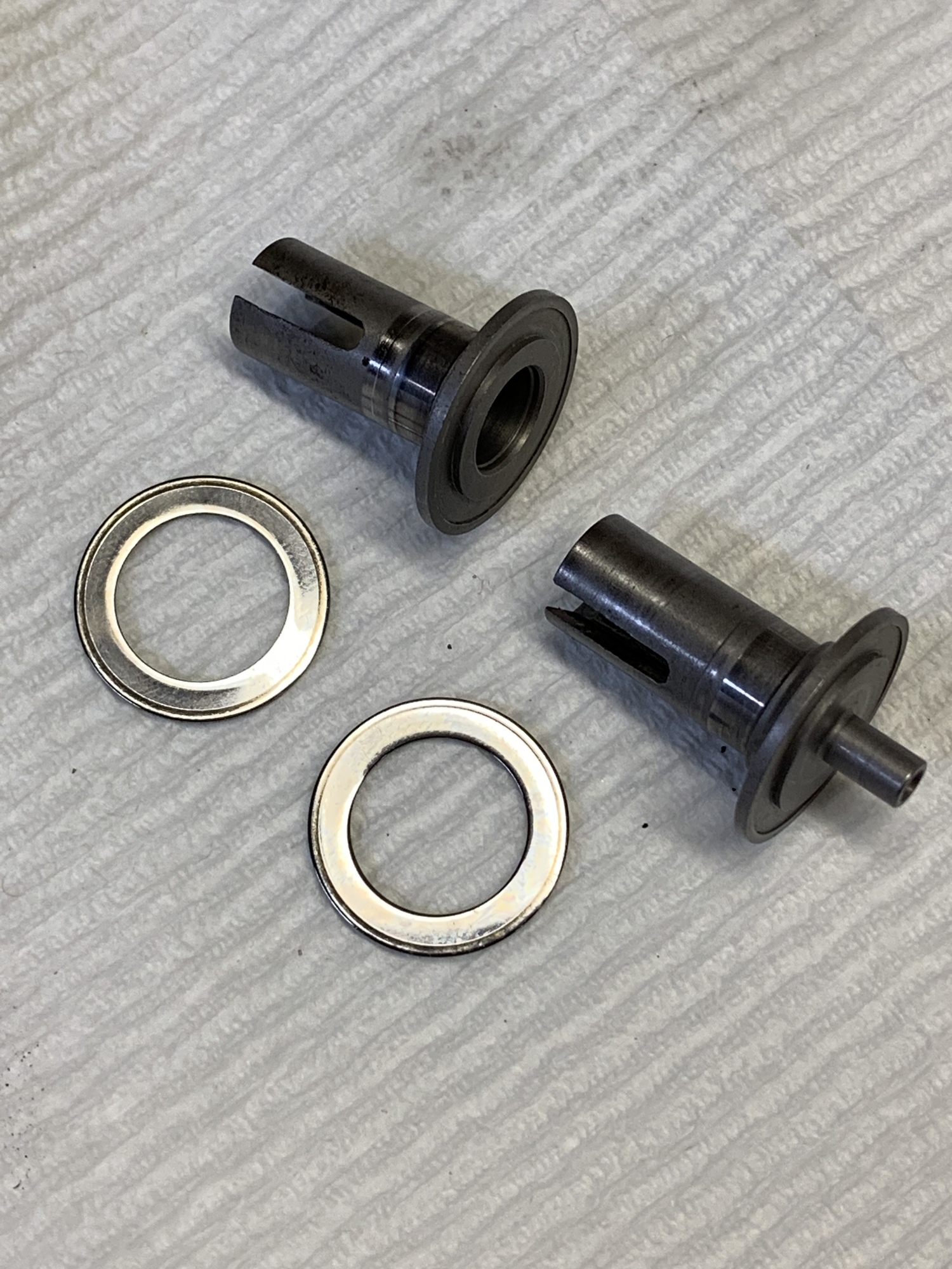

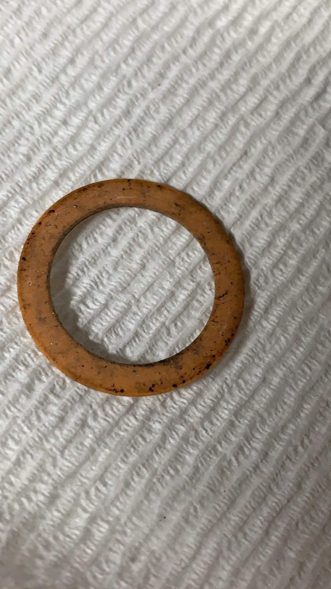

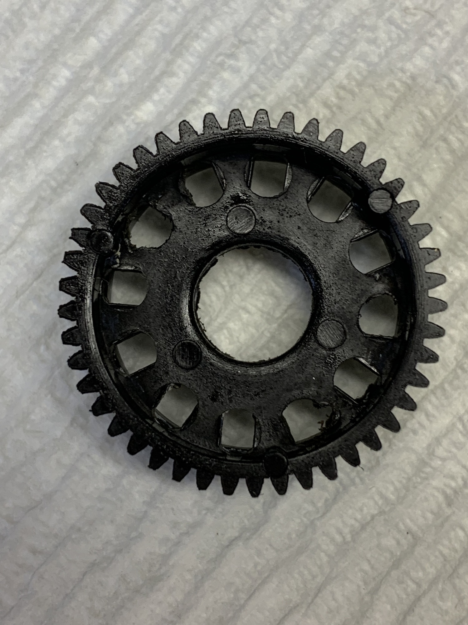

What are the tell tale symptoms that the outdrives are shot? I started hearing a high pitched squeal and pulled the car off the track. I immediately thought it was the diff but the Track/shop owner thought it was idler. After pulling apart my stealth tranny I confirmed the diff gear was shot and there’s wear on the outdrive but not sure if there’s any life left in them. I’m rebuilding the tranny and here’s some photos:
- XLR8
- Posts: 3318
- Has thanked: 1684 times
- Been thanked: 1180 times
Re: Outdrives shot?
FWIW, diff gear looks bad but I've ran worse.
Outdrives look fine, diff rings are obviously shot. Have the outdrive bearings seized?
Looks like classic case of a slipping diff causing the balls to groove the rings and melt the gear.
Just my 2 cents.
Just my 2 cents.
