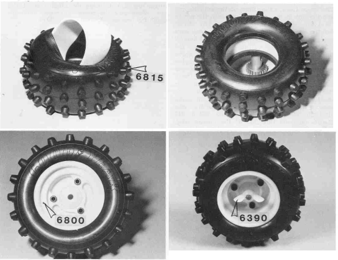

Yeah, the RC10's wheel diameter, axle diameter and pin drive makes its wheels unique.
The 10th scale RC buggy industry has pretty much settled on 2.2" wheel size as the standard. I have that wheel size on all my runners - it makes it much easier to find tires.
It's not impossible to find tires to fit your wheels but the selection will be rather limited.
Oh, I forgot to mention, the RC10 wheels are designed as 3-piece internal bead lock so that can complicate tire selection even further. Modern wheels and tires are meant to be glued on using CA glue.

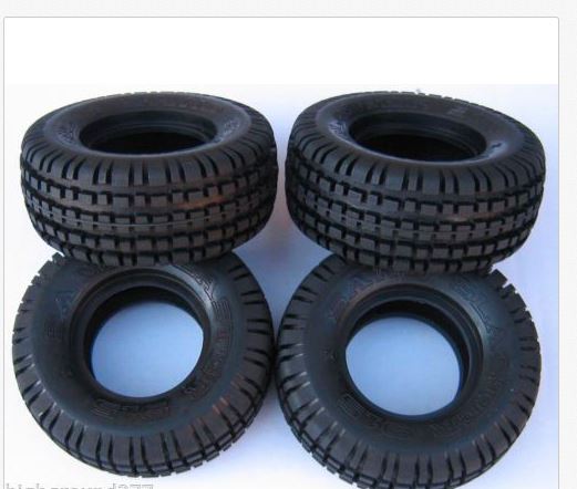

I've had a set of these Tamiya tires in my tire box since the late '80's. The ID and width match RC10 wheels and I'm confident that I had them mounted on RC10 wheels at one time (this would pre-date 2.2" wheels).
https://www.ebay.com/itm/NEW-TAMIYA-Part-Sand-Blaster-4-Tire-Set-for-SUBARU-BRAT-Also-for-Vintage-F150/223715025947?epid=1921002967&hash=item341674641b:m:mmyV_A9Chf-MyoN7UWtjU3g
Anyway, maybe you could search for 1.7" rears and 1.9" fronts and see what's available.

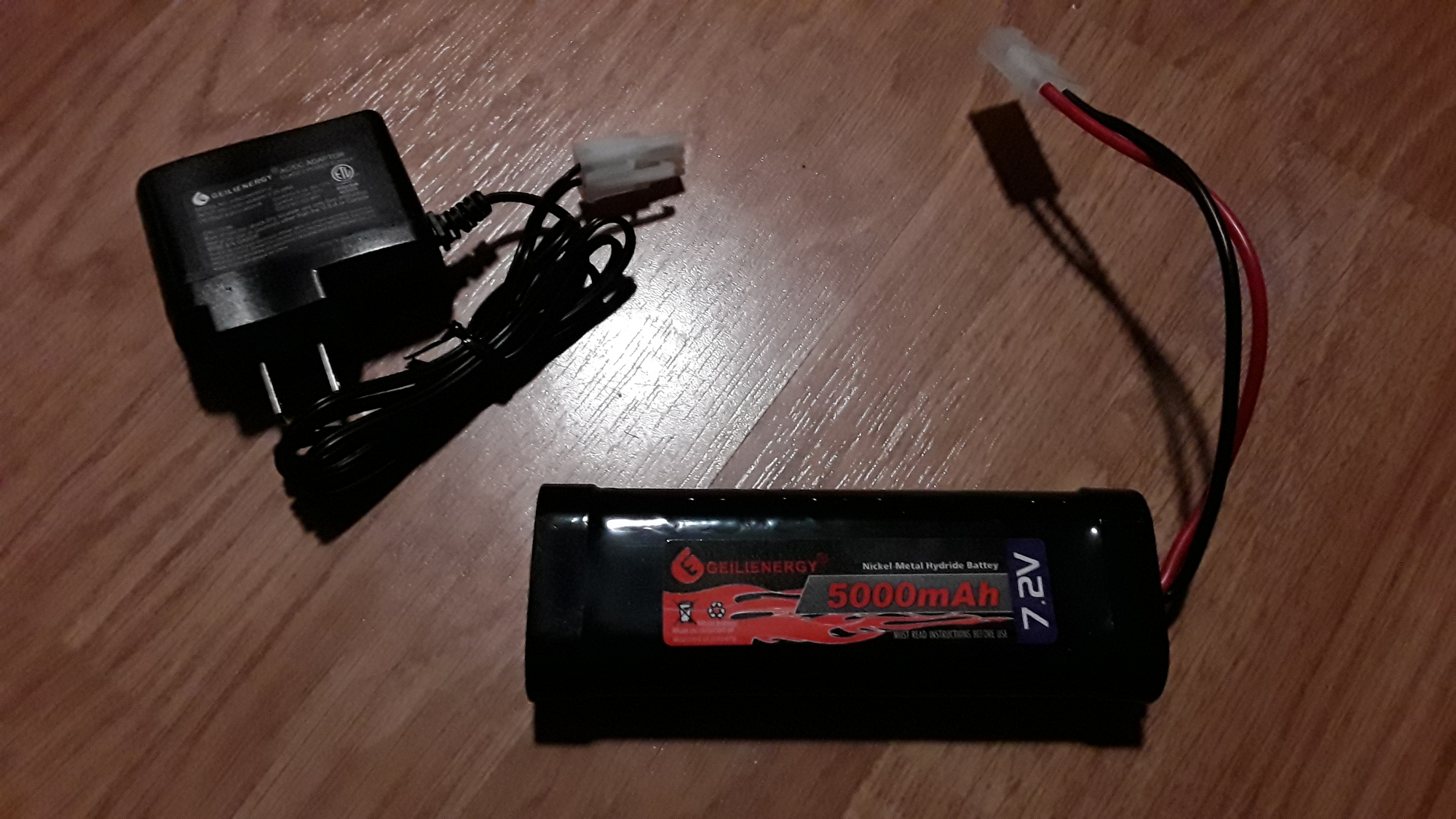

I just realized that the adapter I ordered is Tamiya female to mini Tamiya male!
So, gotta wait to get to correct Tamiya male connector for the car side of things. Unless I could track down two AE Molex plugs for the battery and charger.
Any suggestions? I really want this thing going ASAP.

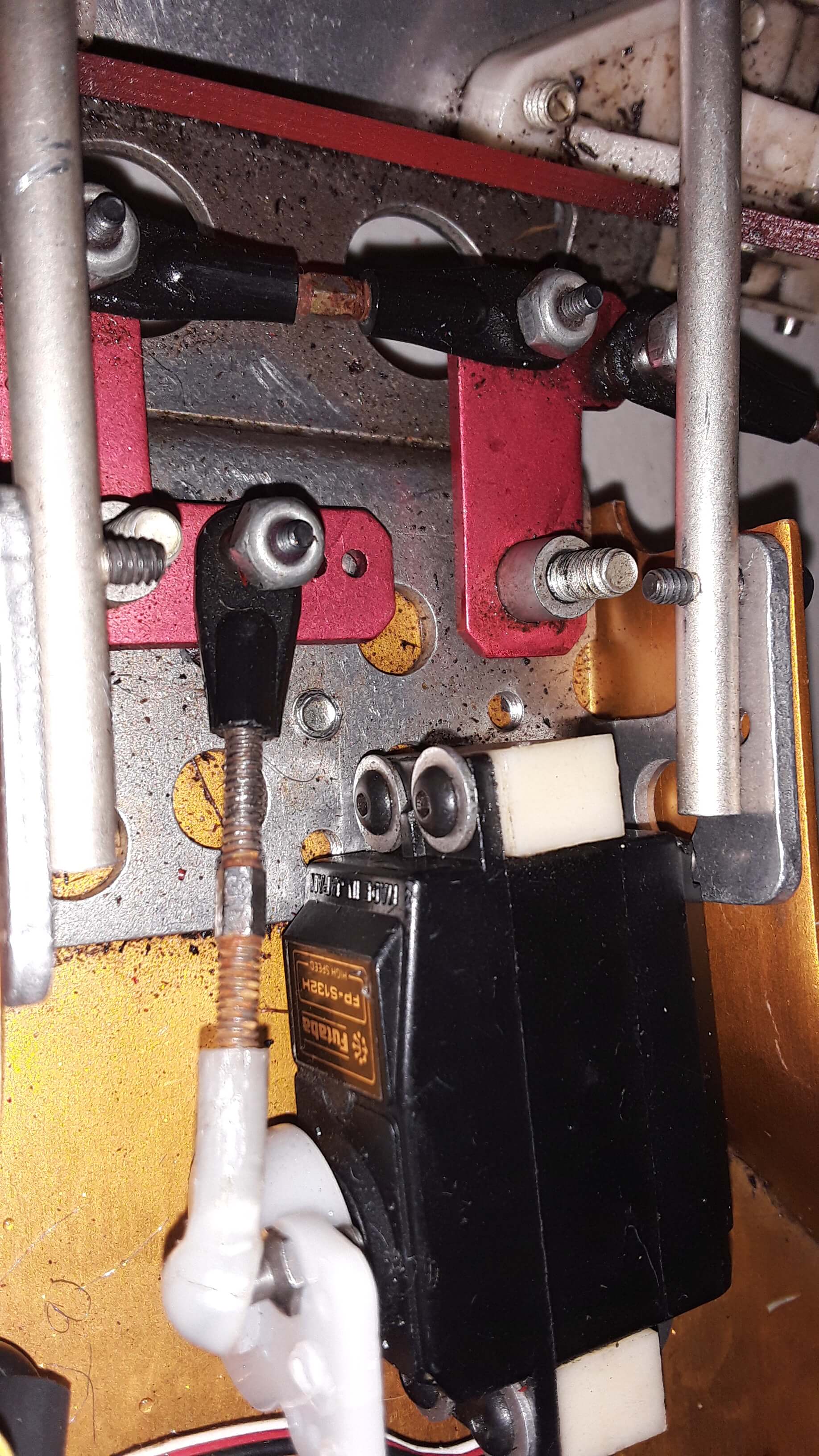

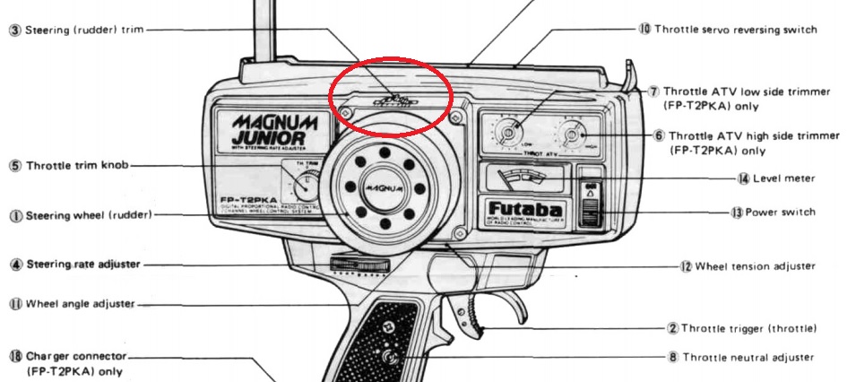

Does the car track straight when you release the steering wheel? If not, there is a steering trim adjuster located above the wheel If it's tracking straight but the wheels steer right more than left then you might take a look at where the steering rod connects to the servo
It appears that it's in the 1 or 2 o'clock position with the front wheels pointed forward when it really should be in the 12 o'clock position. This may be causing the steering rod to "throw" more rearward (right) than forward (left). Hope that makes sense.
Just move the ball stud to the upper center hole on the servo saver and lengthen the turnbuckle to compensate and point the front wheels forward.

Ok I was fiddling with the steering rare adjuster, not that knob, so thanks for that diagram!
And yeah, I figured I might need to move the servo rod back a hole or two.

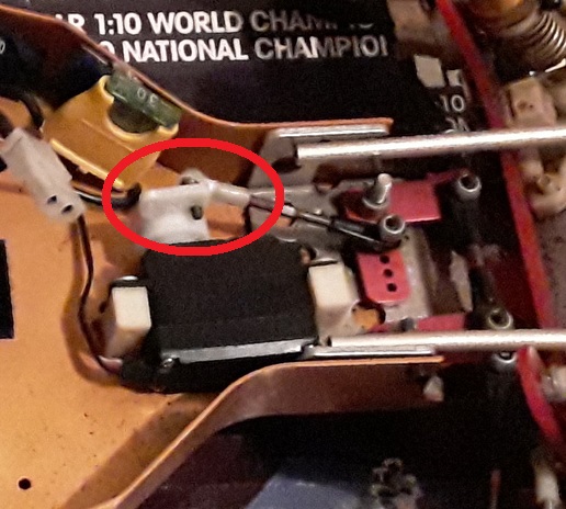

Found the problem!
See that screw behind the steering arm? It was protruding, keeping the steering from turning to the left all the way. I backed it out a bit, and now it has full steering throw.
And since the weather cleared up, I got a chance to take it flat out! It's FAST!
