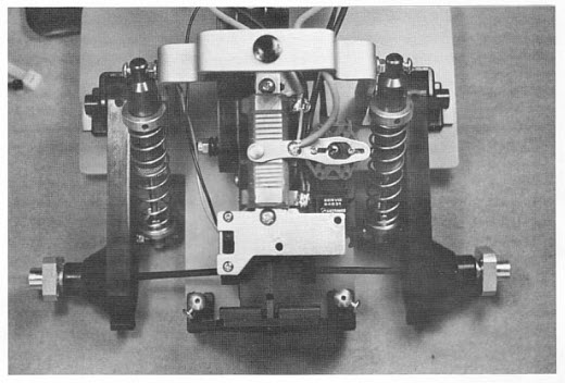

a01butal
Posts: 2397
Location: Shorewood, IL
Has thanked: 34 times
Been thanked: 40 times
Re: YZ834 questions
Post by a01butal »
This is what the msc looks like when installed.
