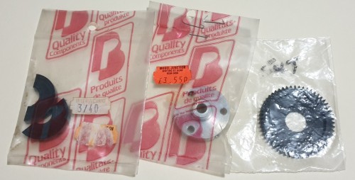

I'm all ears , whatever you know please tell me :D , sometimes I forget how much knowledge is here on offer , and anybody with spares for the 2 speed system , I need the clutch shoes , clutch drum and the 54 tooth gear :D

Dadio wrote: Sat Dec 07, 2019 4:14 pm I'm all ears , whatever you know please tell me :D , sometimes I forget how much knowledge is here on offer , and anybody with spares for the 2 speed system , I need the clutch shoes , clutch drum and the 54 tooth gear :D
I should have all of those parts spare... let me have a look.
How does this look, mate?
:wink:

Incredible_Serious wrote: Sun Dec 08, 2019 5:16 am
:wink:
Looks a bit like Christmas , shoot me a PM with the price :D I like the price of the middle bit :D

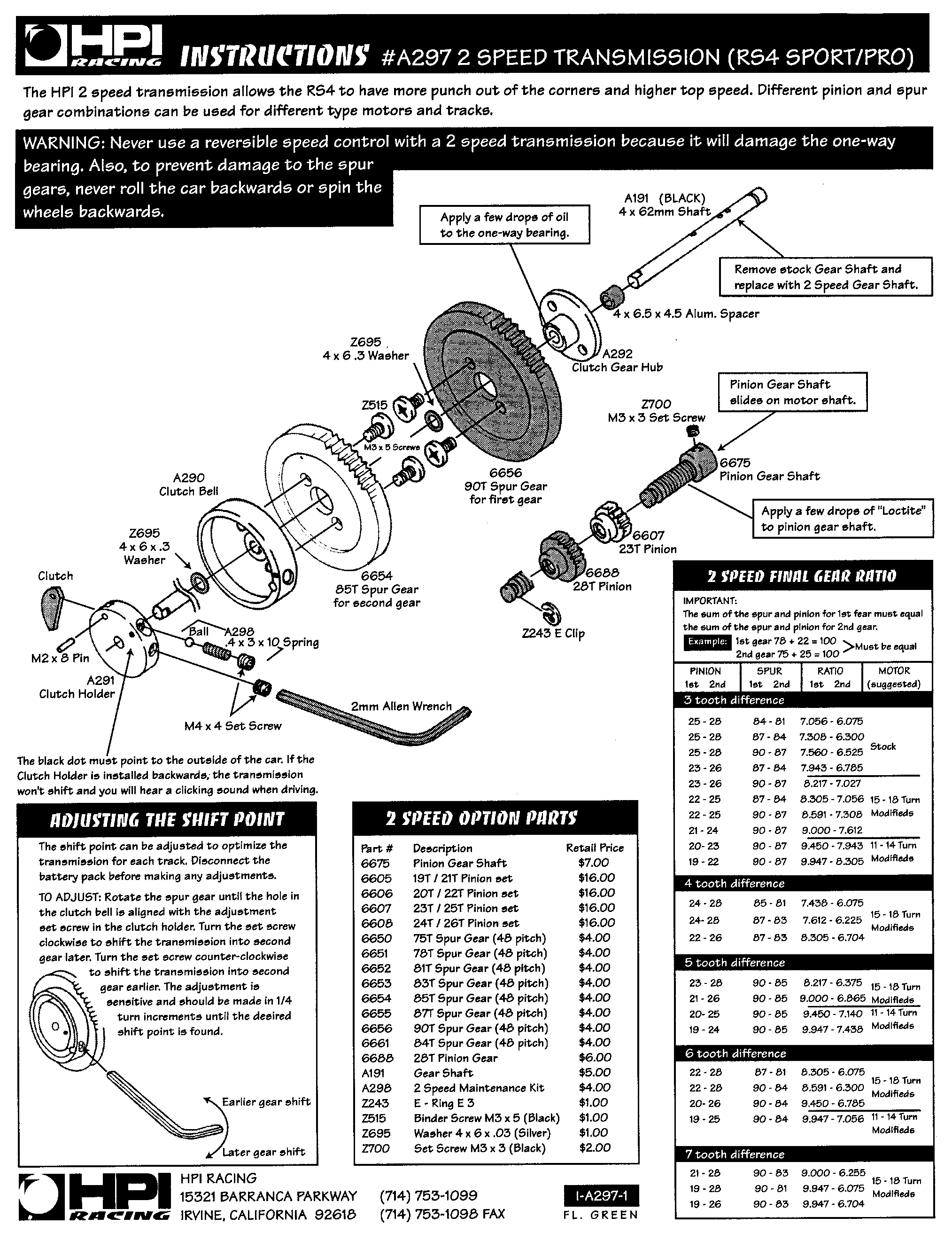

Just a few pictures of the two speed installed and a little description of its function for those who are curious .
The way it works is with a double pinion on the motor that drives two spur gears , the larger spur for low gear is fitted to a one way roller hub that drives the spindle initially.
behind this there is an expanding clutch similar to the centrifugal clutch on a lawn mower although its not a true centrifugal clutch .
this clutch comprises of two semi circular shoes that are forced outward to engage on the inner surface of a drum to transmit drive , the drum is fitted to the other smaller spur gear for the higher gear , when not driven by the clutch the drum freewheels on the spindle on plain bearings , the clutch shoes rotate with the spindle and are forced outward by ball bearings that sit half in the shoe and half in a groove cut into the edge of a central hub that's locked to the spindle , two springs and screws hold the shoes inward around the hub and help control the rpm that a gear change happens .
As the central hub is spun faster the ball bearings move from the center of the groove toward the edge forcing the shoes apart and locking them onto the inner face of the drum , as i said its not a true centrifugal clutch but one operated by a rising ramp effect that's more torque driven .
Once the clutch engages it locks the smaller spur to the spindle for the higher gear , the larger spur is now over driven and so freewheels on the one way roller bearing that it was driving with initially .

I had another drive today with the two speed transmition and was thinking about the lack of breaks , I had a thought , what if I replaced the ball races in the clutch drum with a one way bearing , my thinking was that if I fitted it to engage in reverse then it would not only make second gear work for reverse but also give it breaks ..... It didn't work , it was still fine forward but locked up the transmition completely in reverse ..... Oh well
Posts: 12214
Has thanked: 1084 times
Been thanked: 3762 times
Re: PB Mini Mustang Refurb
That is how HPI designed their two speed, and it works great so long as the car NEVER rolls backwards- under power or not. If you do it will strip the spurs or tear up the oneway as the oneways would be pitted against each other. Its hard to tell in the pic but the "clutch bell" contains the second oneway bearing.
