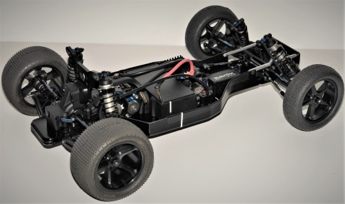

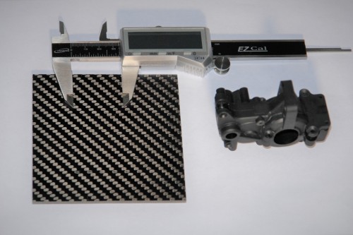

I bought an empty B6.1 laydown empty case. I had a goldpan that I took apart and started taking lots of measurements by eye and digital calipers. Everything looked promising.
I made a template to help mount the case to the goldpan.
When the black chassis went on sale for $20 I bought a couple and earmarked one for the build.
I started hunting for B6.1 trans and found a laydown and a layback on Ebay for an awesome deal.
I have used the B4/B44 carrier/bone arrangement before and the B6.1 trans gave a little more leeway for bone travel/engagement.
The ball stud mount on the trans was almost perfect, I did swap the rear hubs side to side to get a little better camber turnbuckle alignment.
The height of the tall tower mounted on the trans is almost exactly the same as my world’s.
I’ve used B6 rear shocks before and they are very close in length to the 1.18” sale shocks.
I did play with the rear shock length a little, settling with the longer B6 lower eyelet both front and rear.
That said I was hopeful and the results were better than expected.
A predictable happy accident! :o
I still need to change the front springs, they are way too stiff for dirt.
I have started a project to get a little more weight on her tail, hope this one works out.

Wow, excellent build, now I need to resist taking apart my B6.1 :D

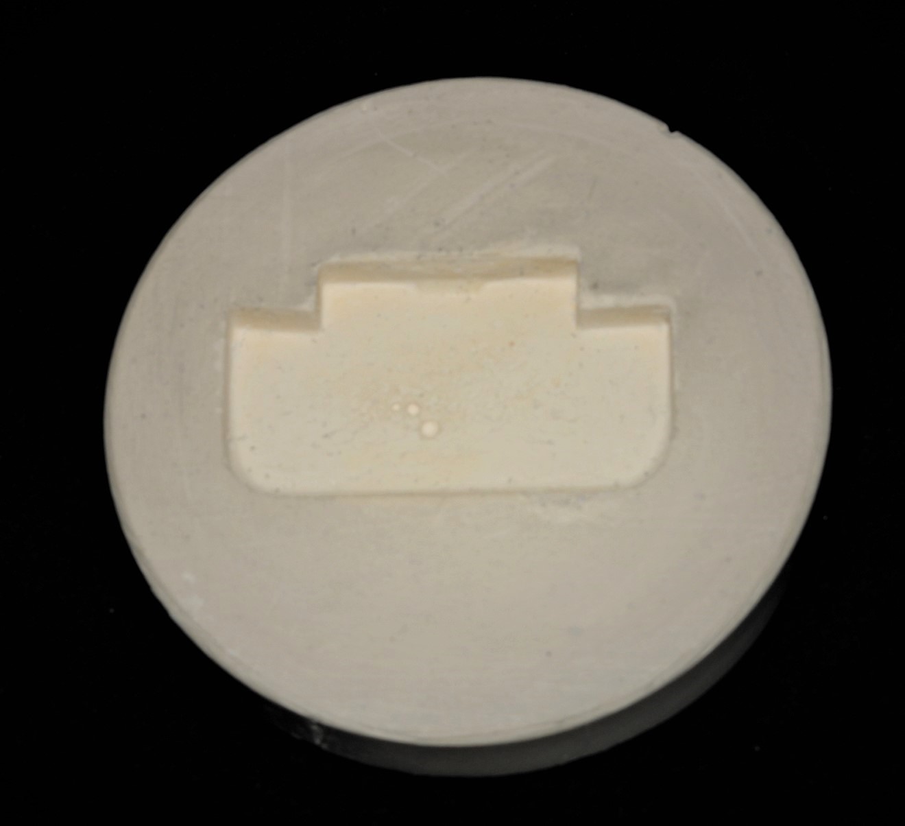

In an effort to shift the F/R bias back a little I made a plaster mold from the epoxy part show above. The original epoxy part came in at about 3/4 of an ounce.
I then embedded lead shot into epoxy and made a second part in the plaster mold. That part came in at about 2 oz.
The parts I made both act as ballast and as a spacer that fits where the B6.1 rear "D" arm mount would fit.
The car with a shorty pack, body, motor, etc. being compensated for is still about 3oz under the 1499g minimum due to the lipo battery weight.
Guess I won't be looking for ultra light body, motor, Esc, servo and receiver :)
Chuck

That's a clever way to add ballast, Chuck.
3 oz is a lot of weight to add but that's a good problem to have - i.e. build the car as light as possible so you can position any necessary added weight where it's most beneficial.
Certainly, it's best to keep the weight on the chassis and as low as possible. Some of the more basic sensorless brushless ESCs tend to be heavy. In my more recent runner builds, I've been resisting the temptation to go the lazy route and simply mount the ESC to the rear shock tower (as I've done in the past) but make room to stick it to the chassis plate instead.
It would be interesting to know to what extent the B6 parts you're using on this build affects overall weight.

The weight savings by going to the B6.1 transmission was not as much as I expected.
I took some estimates early on. A little less than a 1 oz. in total.
That included 6 gear with spur and ball diff, bulkhead, motor mount, trans to bulkhead brace , wing tubes and tower.
B6.1 included trans with spur and slipper, waterfall, tower, B6.1 wing mounts, molded epoxy tower spacer and ballstud mount.
I did not include the leaded or leadfree spacer mentioned above because it could be substituted with a very small plastic spacer that would weight virtually nothing.
I lost a little bit more when trimming the chassis sides and to clearance for the spur.
I did weigh everything with an older letter scale, I really need to get a small digital scale to be totally accurate.
BTW the leaded spacer vs no spacer moved the F/R bias toward the rear about 1/4". Again less tha I expected.
Chuck
