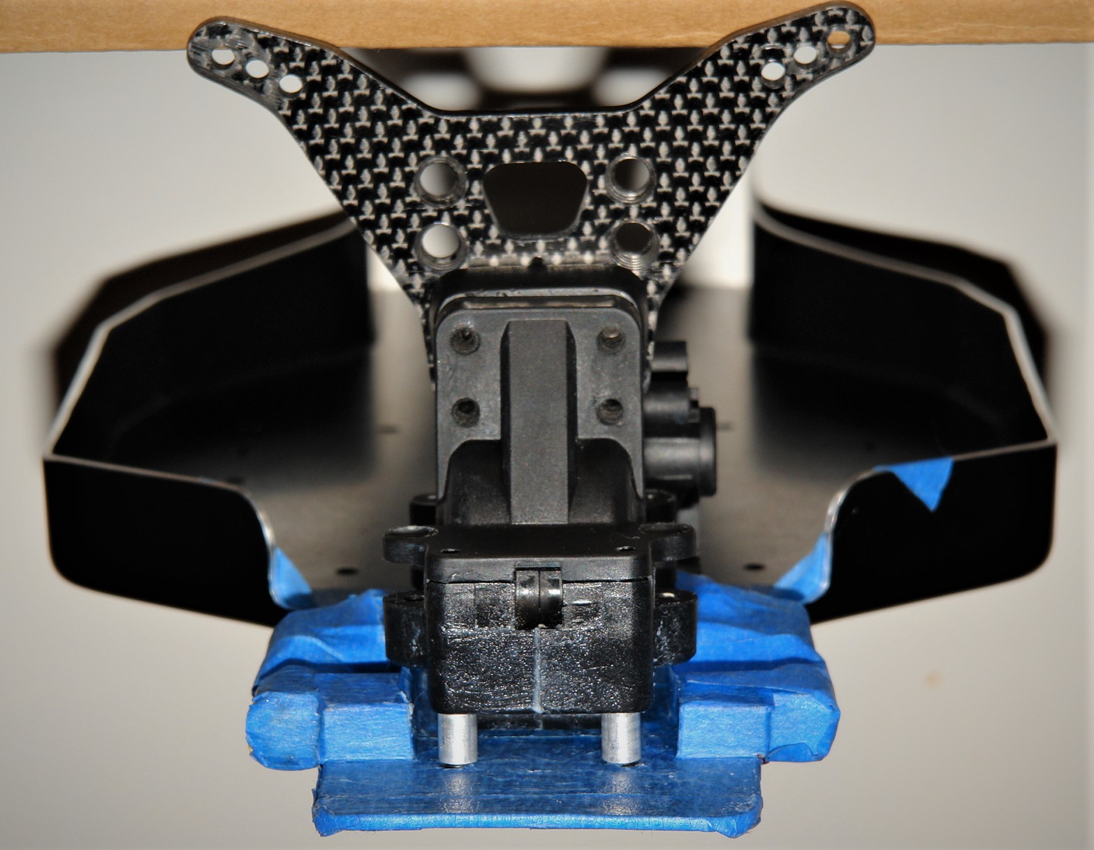

I bought an empty B6.1 laydown empty case. I had a goldpan that I took apart and started taking lots of measurements by eye and digital calipers. Everything looked promising.
I made a template to help mount the case to the goldpan.

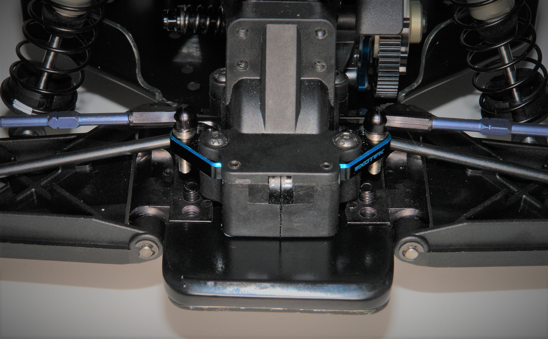

I started hunting for B6.1 trans and found a laydown and a layback on Ebay for an awesome deal.
I have used the B4/B44 carrier/bone arrangement before and the B6.1 trans gave a little more leeway for bone travel/engagement.
The ball stud mount on the trans was almost perfect, I did swap the rear hubs side to side to get a little better camber turnbuckle alignment.
The height of the tall tower mounted on the trans is almost exactly the same as my world’s.

In an effort to shift the F/R bias back a little I made a plaster mold from the epoxy part show above. The original epoxy part came in at about 3/4 of an ounce.
I then embedded lead shot into epoxy and made a second part in the plaster mold. That part came in at about 2 oz.
The parts I made both act as ballast and as a spacer that fits where the B6.1 rear "D" arm mount would fit.
The car with a shorty pack, body, motor, etc. being compensated for is still about 3oz under the 1499g minimum due to the lipo battery weight.

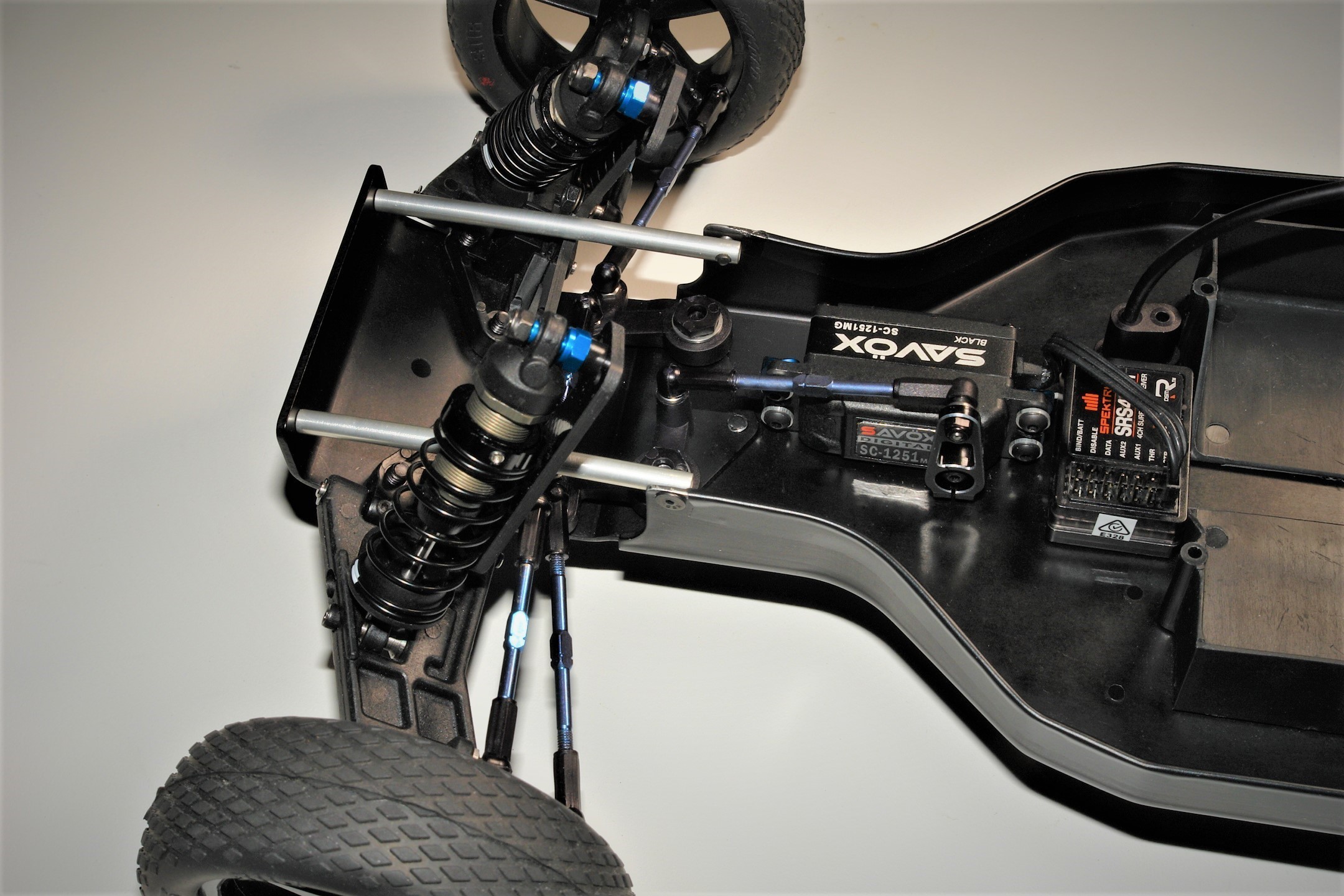

I got a cheap Spektrum receiver that needed repair on Ebay. Fixed it, fired her up and it works fine.
Dug a little deeper in the pocket and popped for a Savox Black 1251mg. Really a nice servo. :D
Servo arm was free.
Looking at ESC motor combos, probably Associated... Black Friday/Cyber Monday is coming up!

I did get a Reedy motor/ESC during Black friday. Saved a little on the two.
Fitting both in the chassis was fairly tight.
I moved the servo forward and to the right to gain a little more clearance.
The sensor wire that came with motor is too long so I have a 150mm on its way.
Got some soldering done and preliminary binding, endpoints etc done.
When the shorter sensor wire comes I'll more permanently mount esc and receiver.
Not really sure where to set timing, seems like 40 on the can marks is close???
