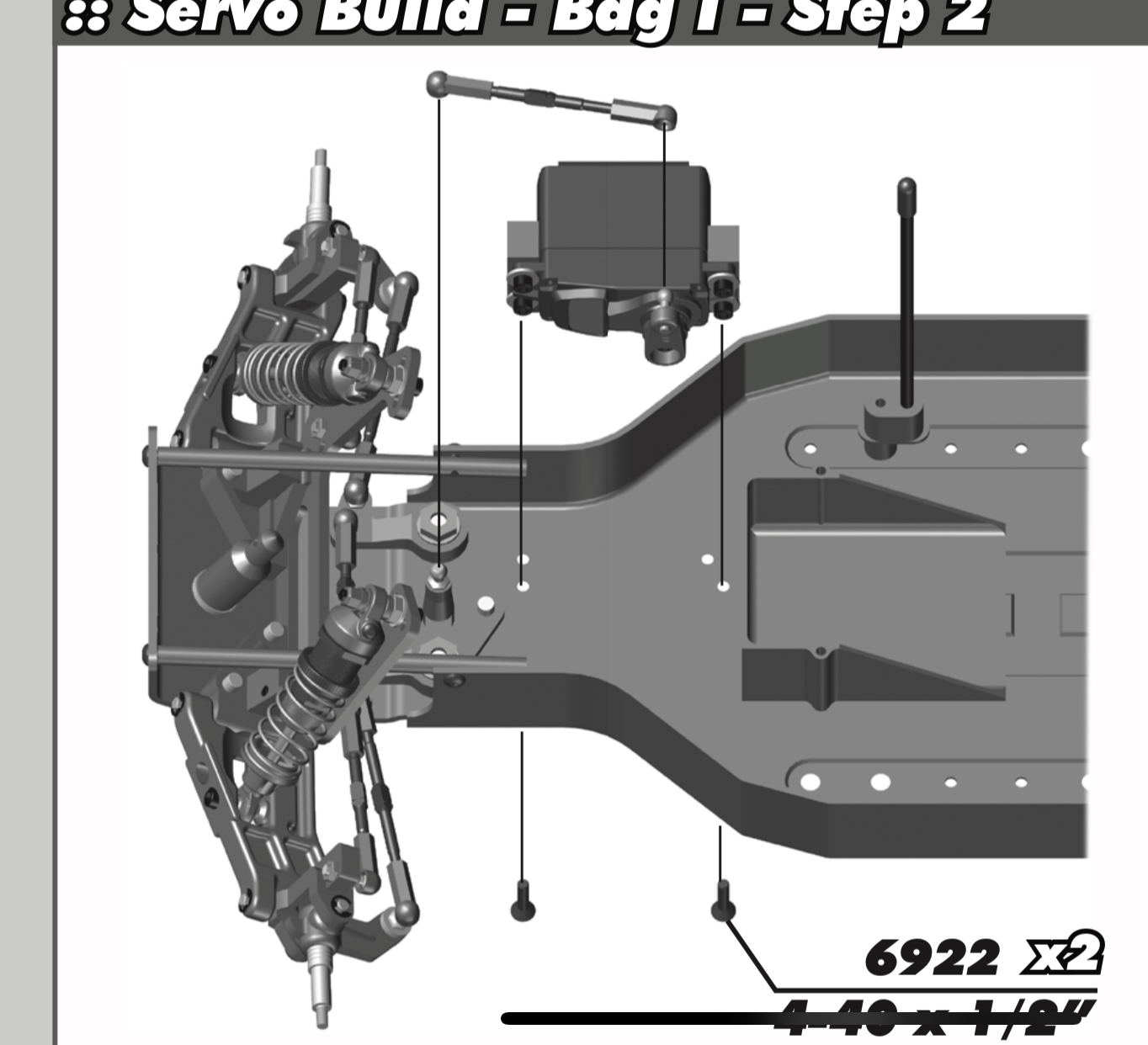

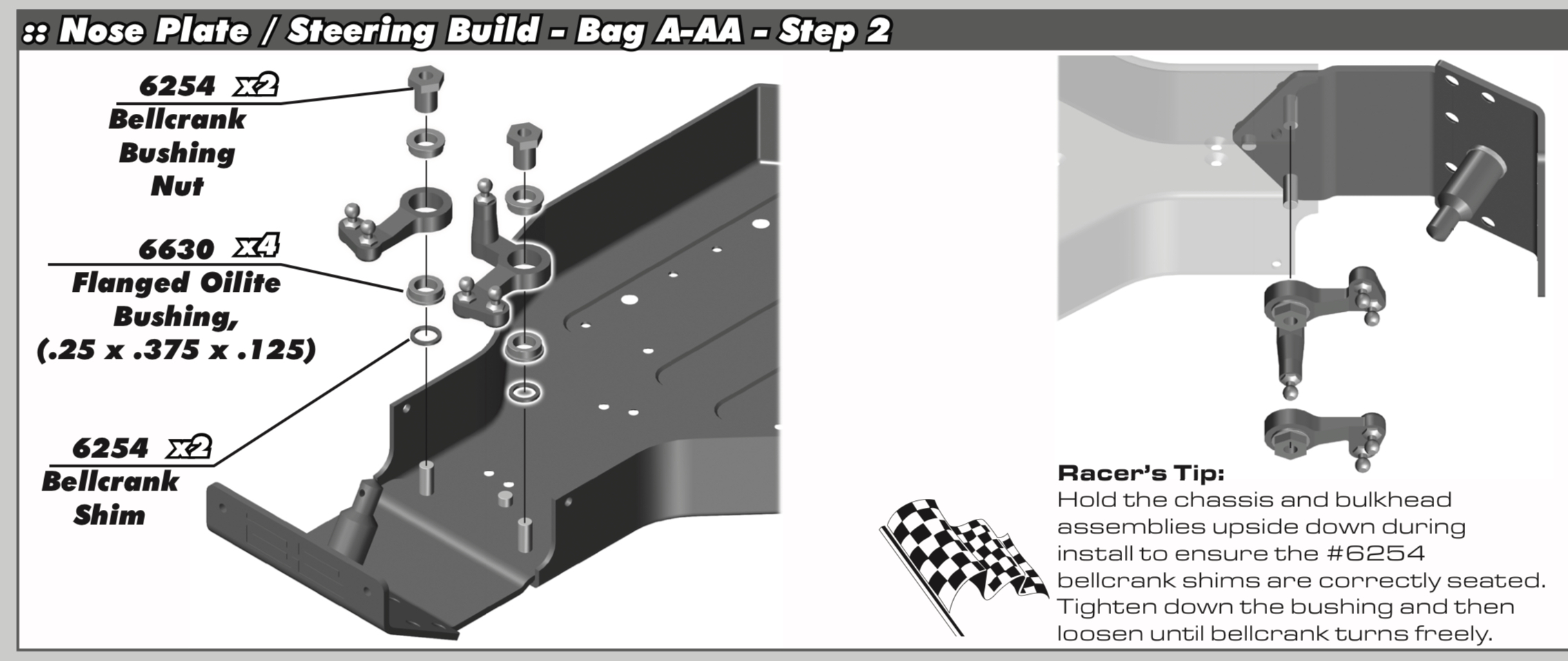

You won’t bend the rod, at least it’s best if you can avoid it. Here is a snip from the worlds car manual showing it’s installation
You can use any 4-40 threaded rod or turnbuckles, I was simply proposing the one listed as it is a common part. If you have threaded rods and/or ball joints you can use all of that in place of what I recommended. (The 497 ball joints are sold individually and also were just recommended assuming you had nothing)
