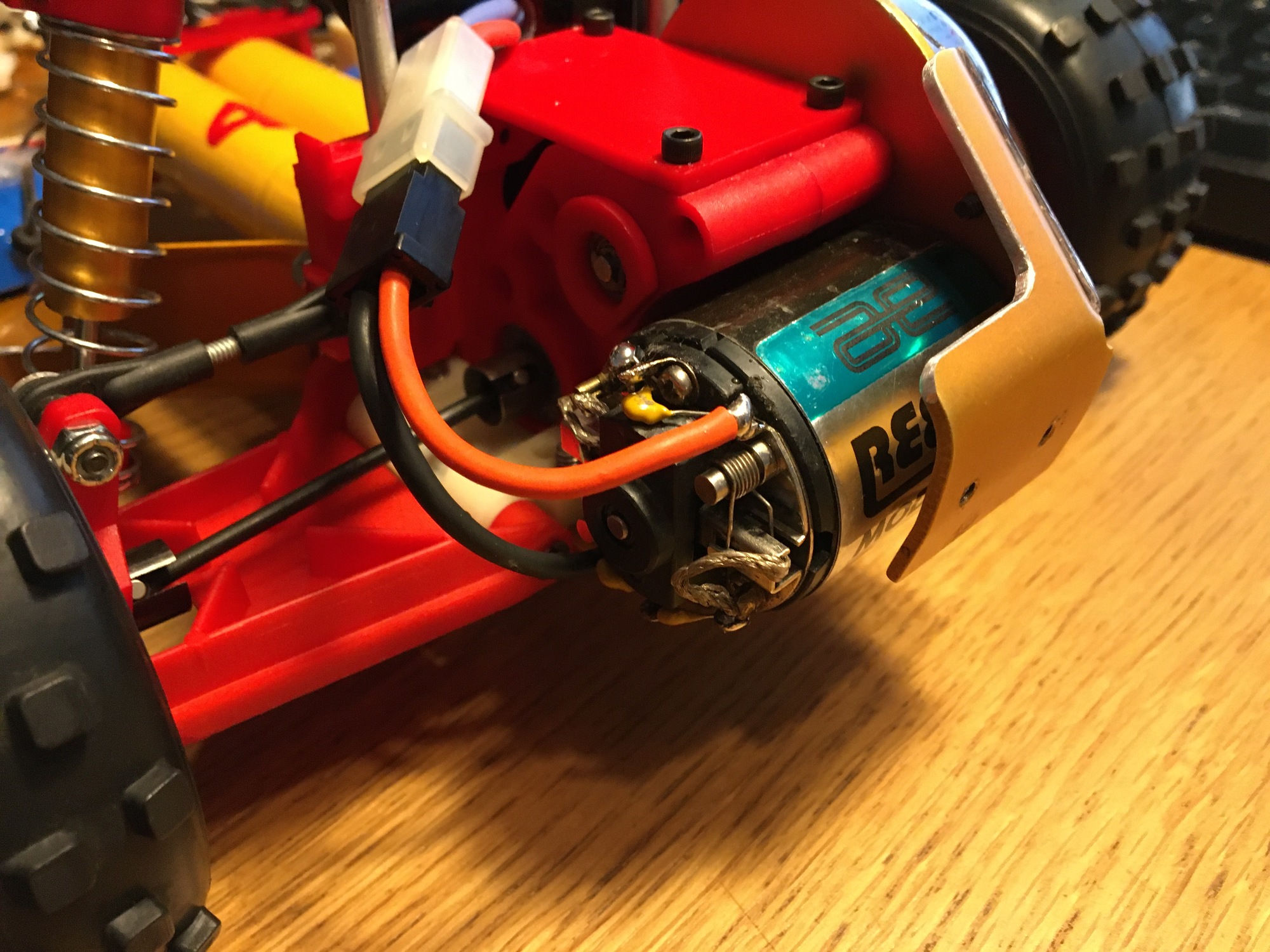

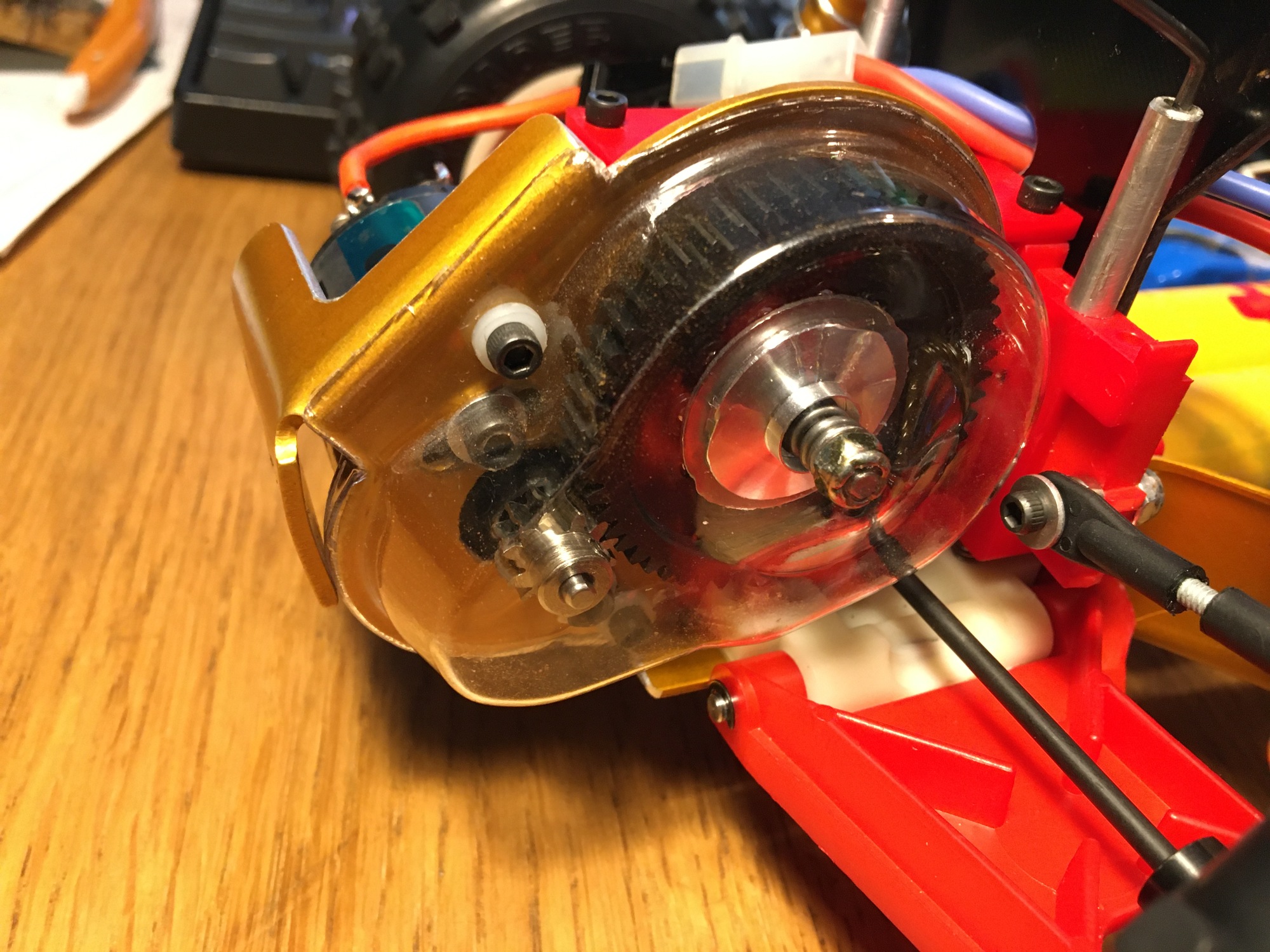

As far as gearing goes... Artistic license will prevail, I will give it an educated guess limited by my stock of pinions.
Back then everybody ran 32dp the readily available spur gears where the kimborough (however that is spelt) Luckily those are still available today :D
The only spur that is large enough for the stock gear cover is the 54T anything smaller does not allow a low enough gearing.
BITD (1988) I used to run 54 spur 9T pinion with a 2x17 1200mAh cells.
Considering that in 1986 cell matching was not en vogue and that the silver dot being a milder motor 2x21 I geared it 54spur 12T pinion (brand new vintage Schumacher pinion).

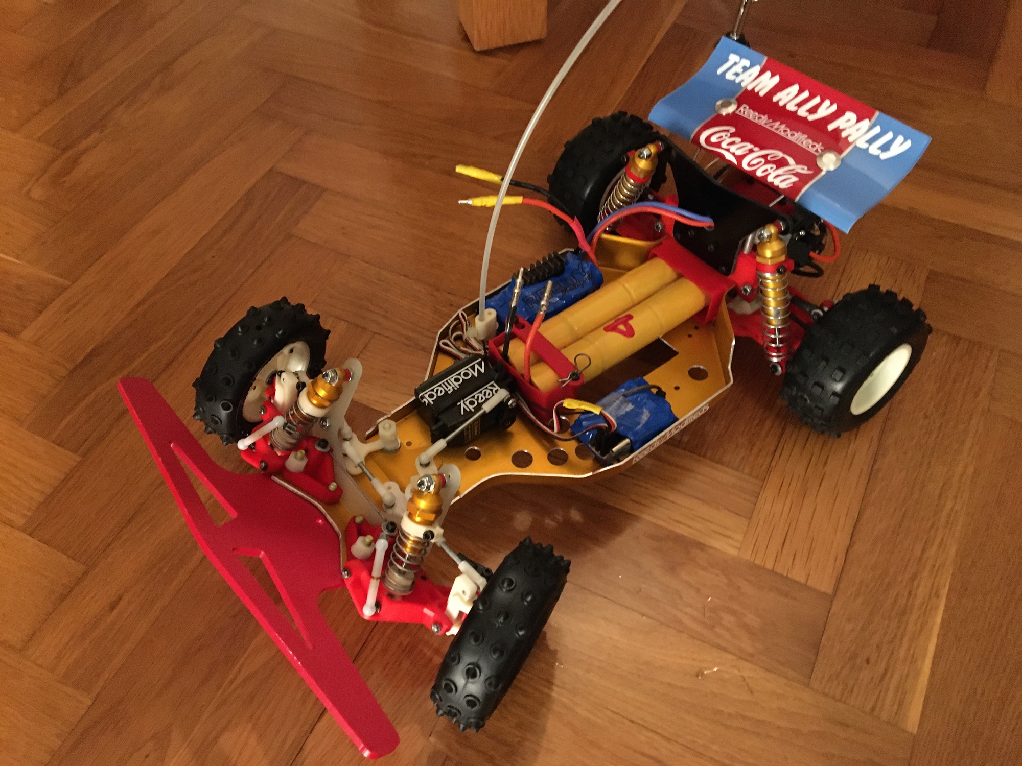

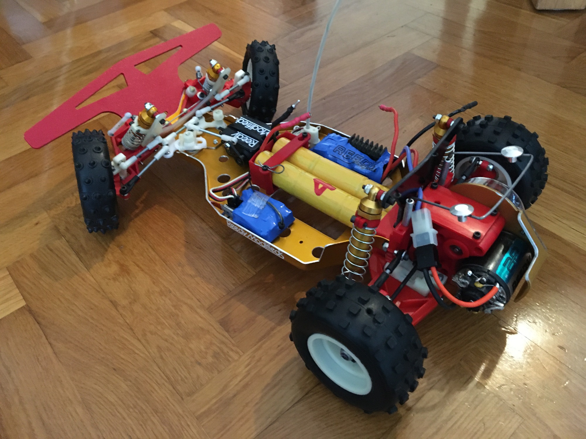

Thanks for the encouragement guys. :D

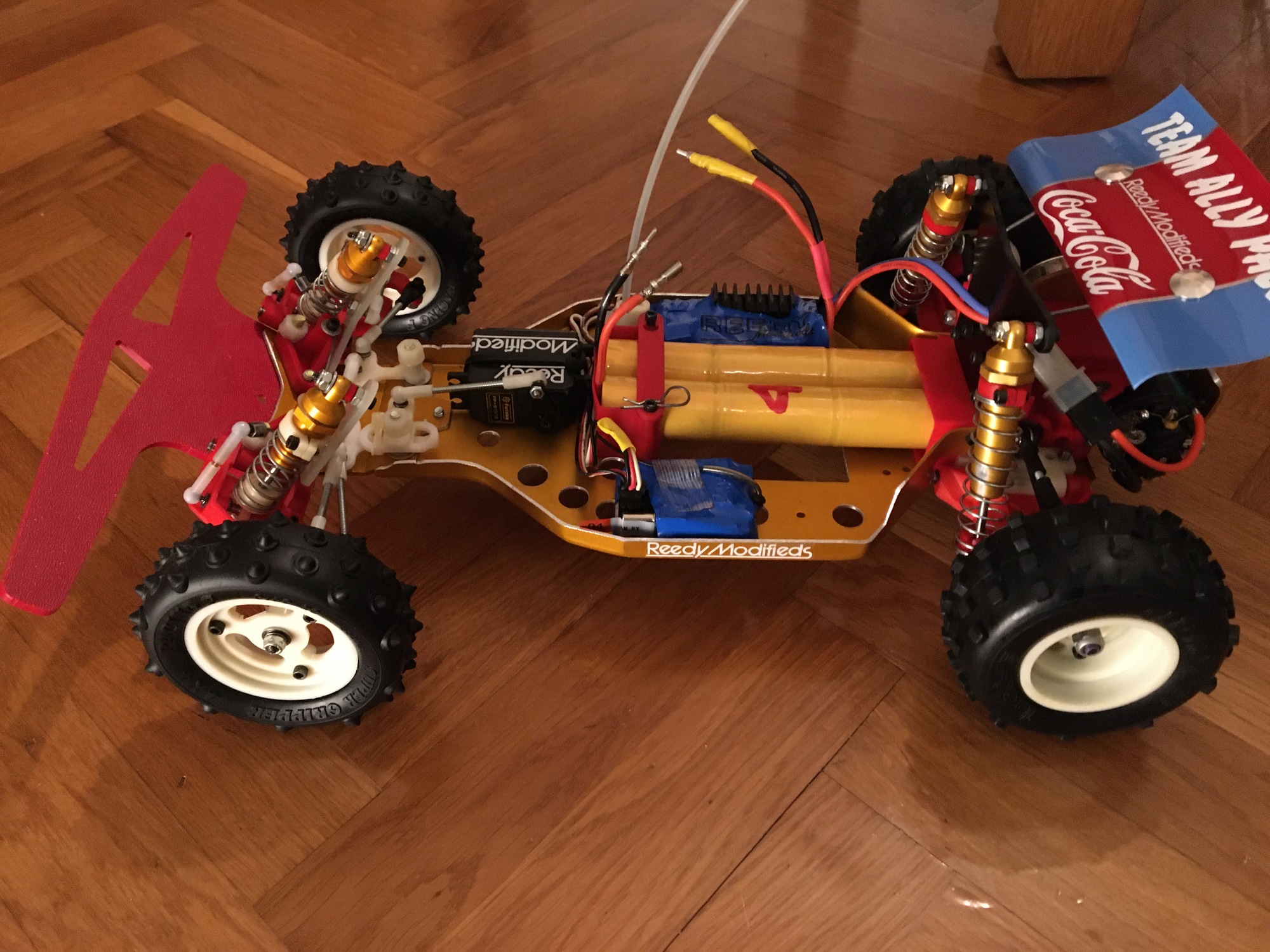

Here from another angle.

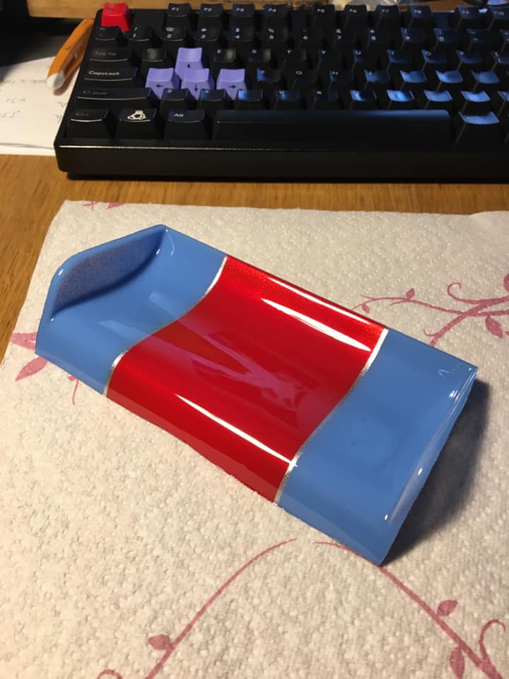

Wing painted. Took me two tries. :oops:

bluewormx wrote: Sat Feb 01, 2020 8:55 am Wing painted. Took me two tries. :oops: 84772775_119522022927184_8957040496354525184_n.jpg
Really great build, +1 for Tux on your keyboard =)
