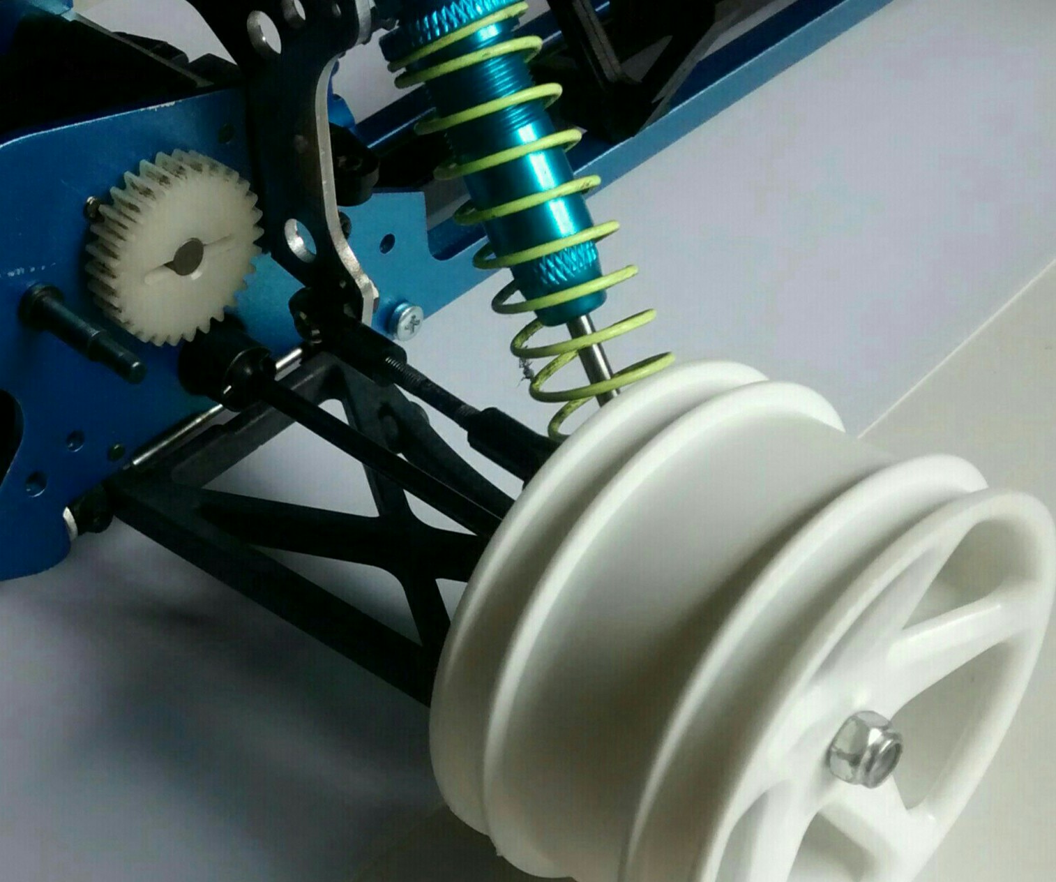

Post by al.48 »

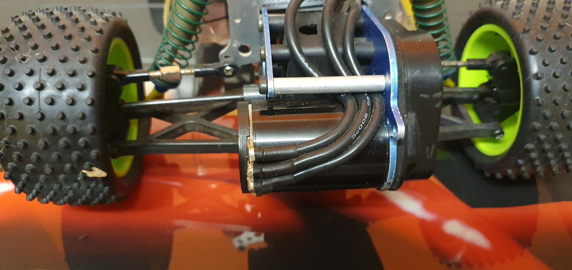

Hi all, use half old diff, ( the one with the gears in) offer up the belt side of the new one you will see its to wide, if you take a sharp knife and cut off the flange up to the step, (sounds complicated but its not) all you have then is a belt pulley, it all screws together, just make sure you line up the two half's correctly, ( the cutouts in the belt pulley line up with the planet gears. Have fun. Take care all.

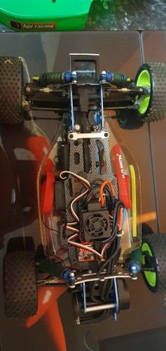

Post by al.48 »

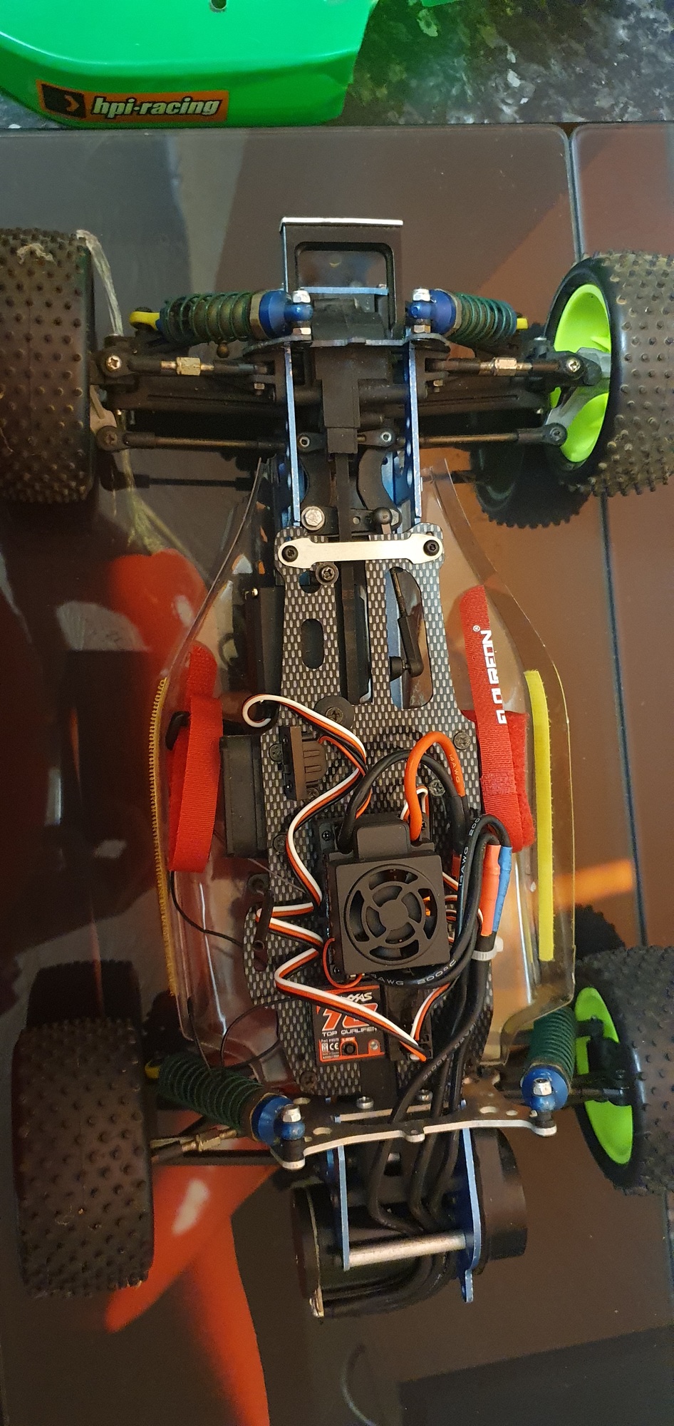

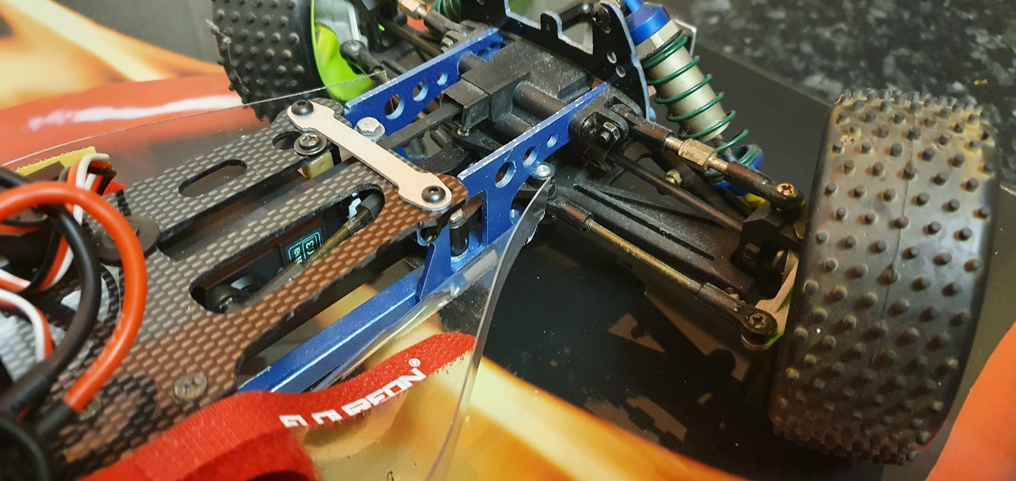

Bit more progress, not final, what do you think, spot the rear arms !
Coelacanth
Posts: 7421
Location: Alberta, Canada
Re: HELP optima turbo ?
Post by Coelacanth »
Looks good...Losi graphite arms? What are your plans for the rear stabilizer? Looks like you'll need to tap or drill holes in the arms.

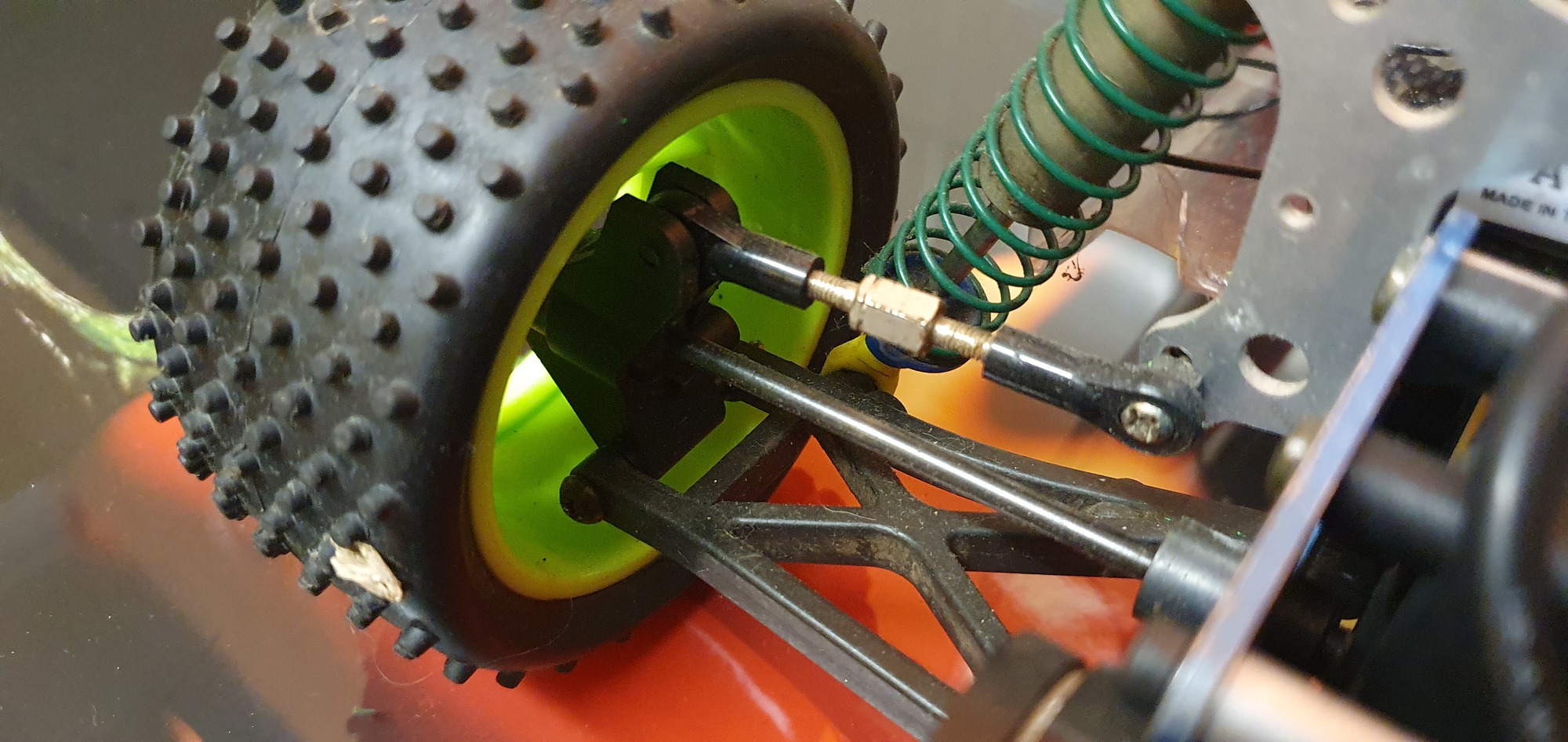

Post by al.48 »
Rear arms are rc10 b2 now with adjustable wheelbase, wheels are fastrax b44. Take care all.

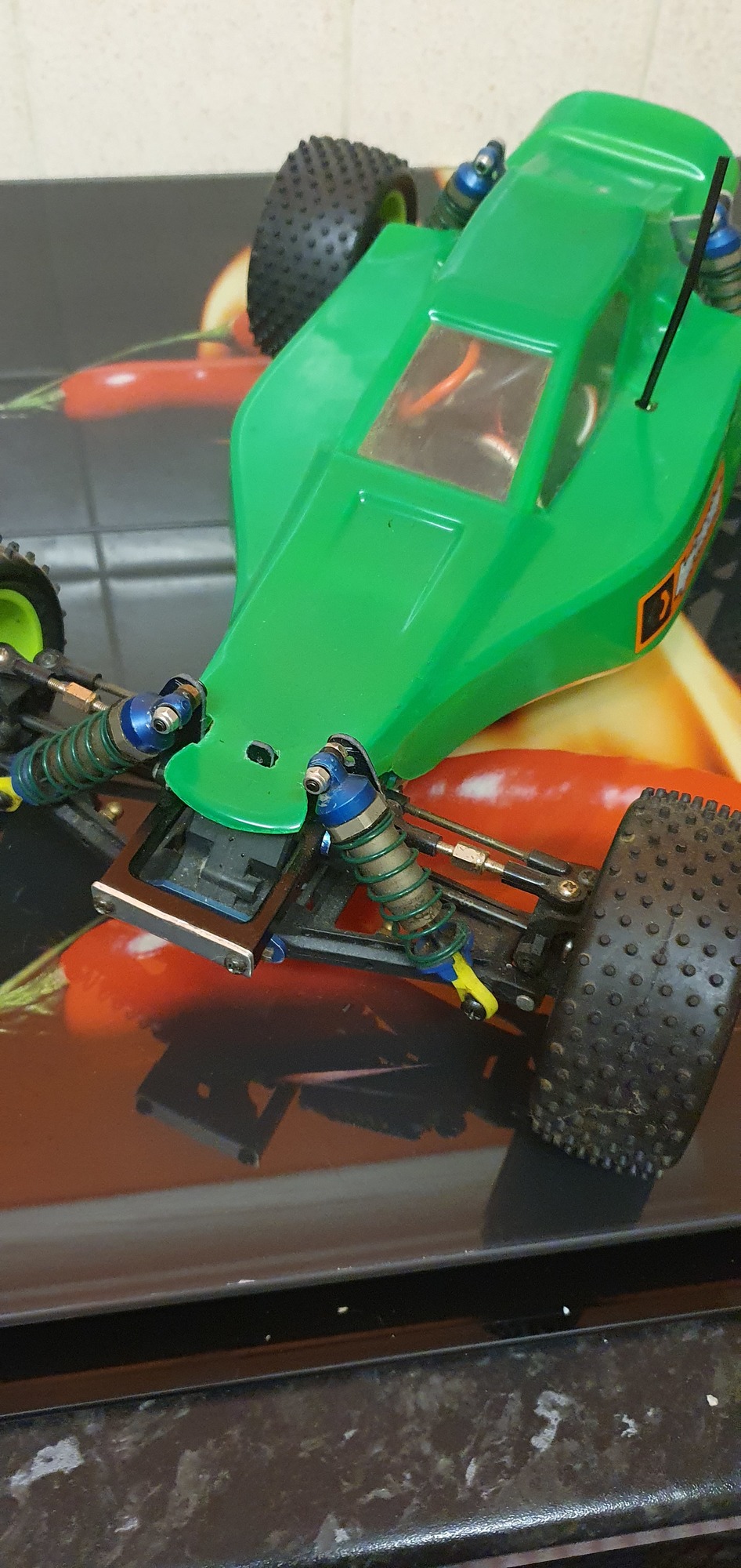

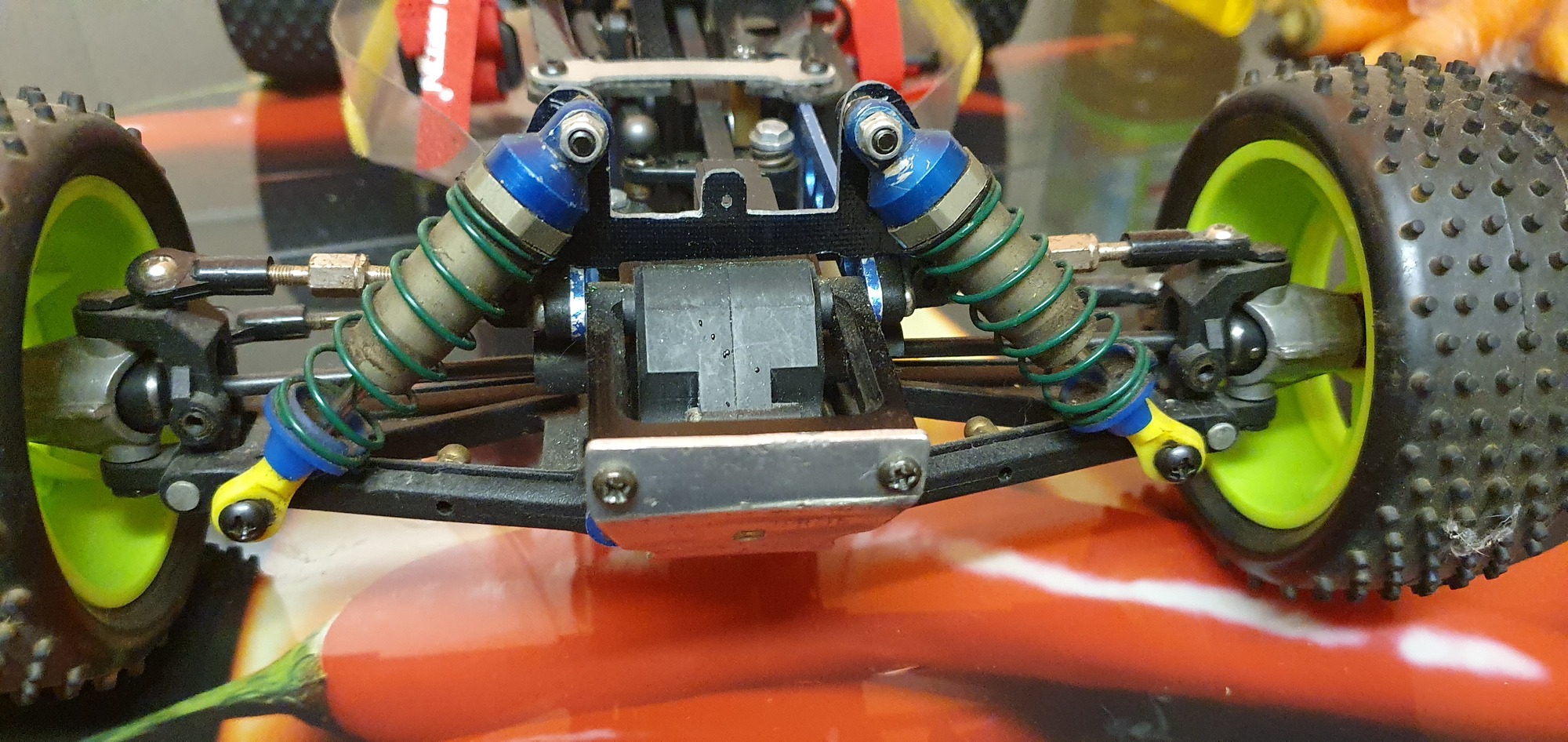

Post by al.48 »

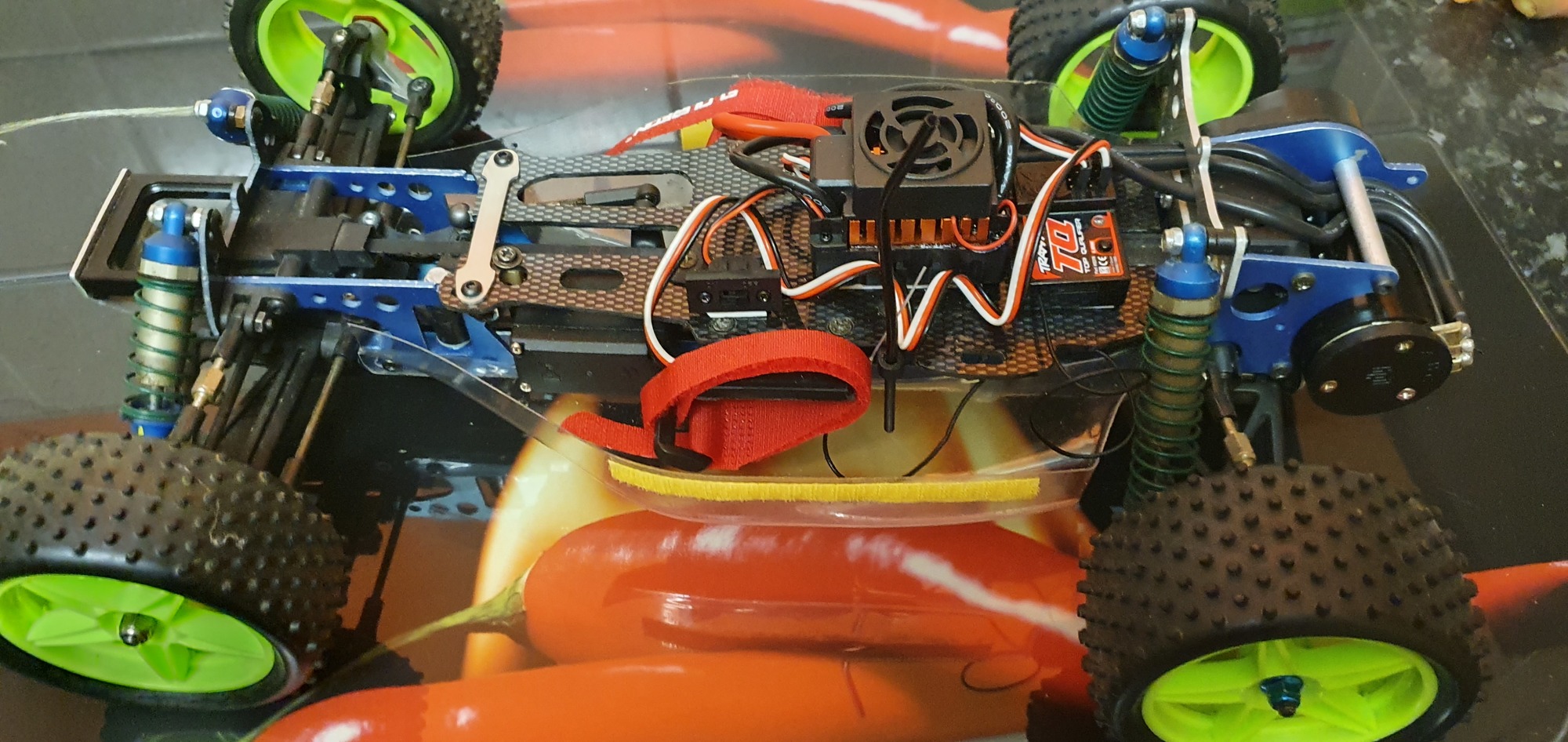

Its finished !!
Almost...you'll want to install a bumper before you run it. 8)
