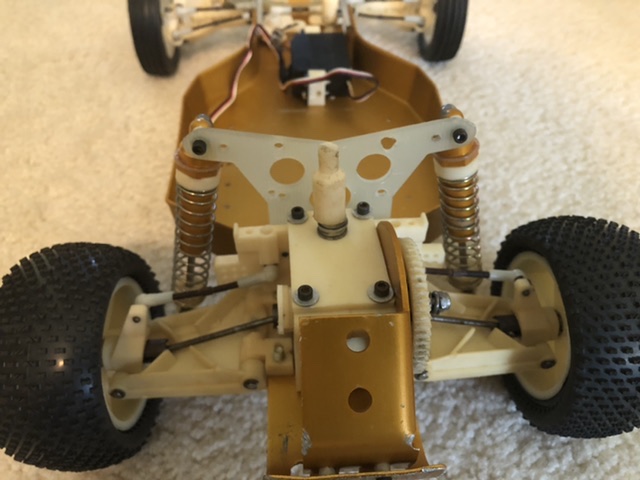

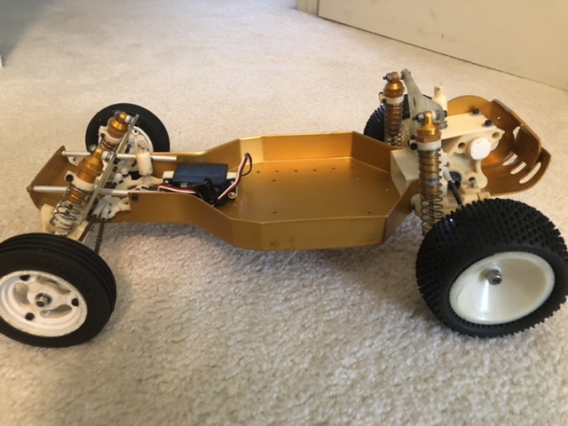

I decided to buy a different RC10 for $179 total (including shipping). The seller says it's an A-stamp chassis. Bottom is pretty scratched, as well as the front and rear edges. It has a 6-gear transmission, which sucks, as I want to use a brushless 10.5T motor at least. What can I do to this car so I can use that motor?
Edit: I'll be able to post more detailed photos once it arrives. The photos shown are what the eBay seller took. I can provide more images from the seller if needed.

I am not seeing the pictures. You may be adding them to your post incorrectly.

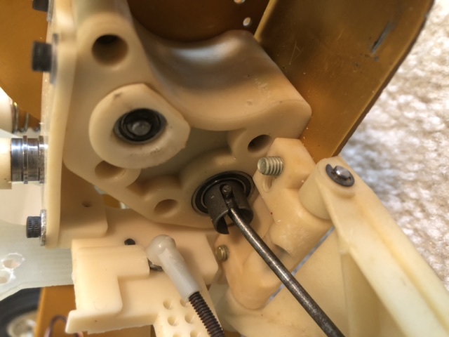

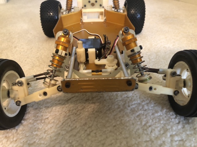

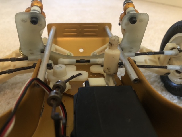

I actually managed to see the pics by right clicking and opening in a new tab.
Anyway, the car actually looks very nice. Yes, it's scratched up underneath, but the rest of of it look good. Suspension arms, shocks, wheels and other parts look very nice. Looks like it's missing the battery holder and the servo mounts. Tires look new.
Also, you'll find that, this being and A stamp chassis, it won't have screw-holes pre-drilled to mount a Stealth transmission. You can see these holes are missing in the underside photo. This chassis also does not have pre-drilled holes to fit batteries lengthwise in the car, but that may not be an issue if using lipos.
Judging by this, the wide front A-arms, and the front shock tower, you likely have an early Championship Edition RC10. But someone else may know better.
Championship Edition RC10s came with bronze bushings I believe, so you may want to consider purchasing a set of ball bearings.

The RC10 arrived today, and I’ve provided more photos.
What really sucks is that the spur gear is 54T, not 71T like the re-release RC10 has.
The wheels are weird. The axles up front are smaller than the rear axles, not all the same like my B6.1. I don’t really know where to start with the restoration.
Sorry if I’m asking too many questions, but what do I need to mount modern wheels on my buggy? All of the conversion kits are sold out.
Is there anything I can do to change the spur gear to 71T?

That looks like a great buggy. Not sure why you'd want to change the wheels already if those tires look new.
I'm not an expert, but a 71t 32p spur would probably be huge. All you need is a 32p pinion. Your spur gear looks super clean, almost unused.
I'm not sure what your expecting from this buggy, but why not just put a brushed, or mild brushless motor in it and see how it goes.
Other than that, it doesn't look like it needs a lot of work.
I would open the gear box to make sure it's all good in there, but if you don't want to, just make sure it's turning freely and run it.

Hi, I would advise against converting to rere wheels as its really a bottomless pit of cash and they have issues. It is way easier/cheaper to get JC racing wheels.
As far as spur gear goes you need need to decide on what you want to run 32dp or 48dp, either way you need either pinions or spur. 71T 48dp spur for 6 gear is too small your gear ratios will be wrong and cause overheating, you need 81T, available at Amain. If you dont already have 32dp pinions this is your best bet.
As far as running the 10.5 with a 6 gear... If its on a track with jumps you will need to reduce the speed and punch with the transmitter.
Bare in mind the 6 gear maxed out with 17 turn motors back in the day once SCE cells came out in 1988 and people started putting in hotter winds that's when the fun stopped and people started breaking idler gears, black idler gears came out much better but....
If you are just bashing tone it down a little to be safe.
I advise you to either pin your diff rings or glue them with either epoxy or loctite 270, cyano is better than nothing. make sure your diff does not slip, any slipping will kill the diff really quickly.
