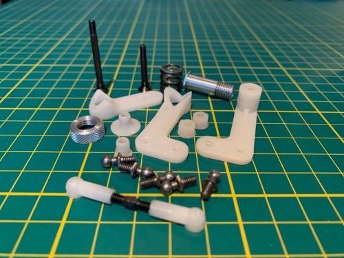

cobalta70 wrote: Sun Apr 12, 2020 8:42 pm We cleaned the metal parts in the ultrasonic cleaner. The cups are shown here as we found them.
Then the universals and turnbuckles were polished.
And finally the turnbuckles and universals were made black again using cold blueing technique. The cups were cleaned too, and while we were at it, the hubs that don't have a hole in them were cleaned as well. :-)

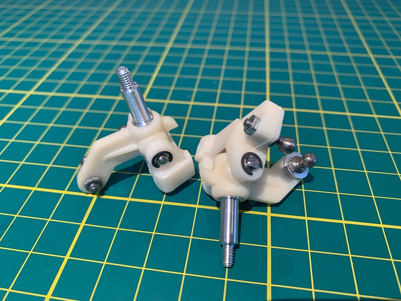

This afternoon we got started on the front end. I don't have a good before picture, but the spindles and pins were all put in the lathe and given a good polish with some fine sandpaper. I think they turned out pretty good:
    And here is as far as we got:

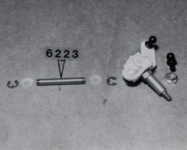

    Question - did Associated change the length of the 6223 king pins at some point? I have some that I think go with the newer style front ends (that use a set screw in the spindle) that seem to be a couple of millimeters too long. I remember the ones on the original cars being just the right length. Did they change them at some point, or are these simply not the right ones?

    cobalta70 wrote: Mon Apr 13, 2020 6:08 pm Question - did Associated change the length of the 6223 king pins at some point? I have some that I think go with the newer style front ends (that use a set screw in the spindle) that seem to be a couple of millimeters too long. I remember the ones on the original cars being just the right length. Did they change them at some point, or are these simply not the right ones?
    I think they are overlong because originally nylon washers were used at both ends before the e-clip. Later instructions/kits omit these so the pin appears slightly too long.

    aakoskin wrote: Tue Apr 14, 2020 11:57 am I think they are overlong because originally nylon washers were used at both ends before the e-clip. Later instructions/kits omit these so the pin appears slightly too long.
    Thanks for the info, that certainly would explain it.

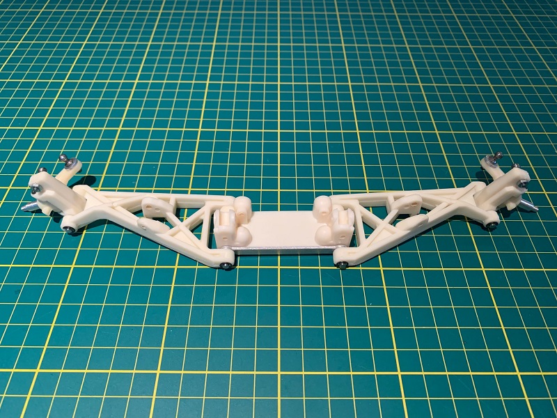

    We didn't get too much work done on this today as we had to make some emergency repairs to my son's Rustler instead. However, we did get a bit farther along on the front end:

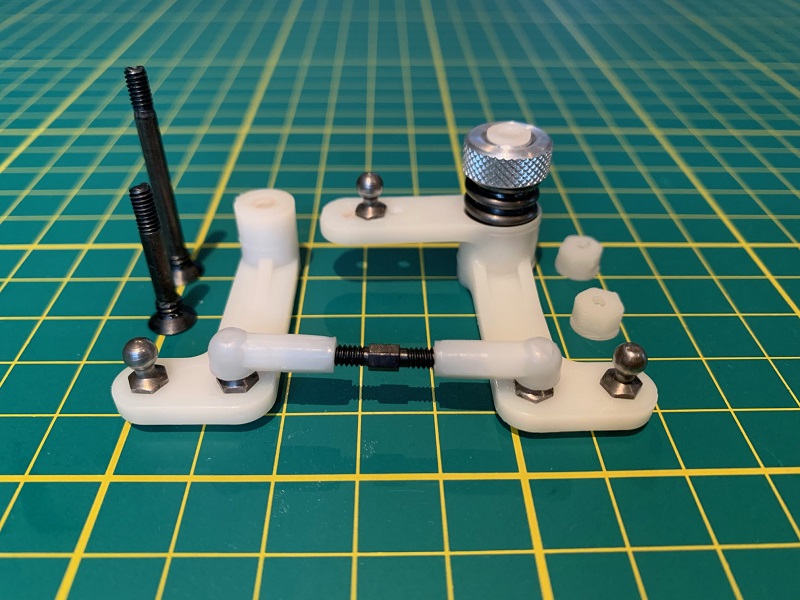

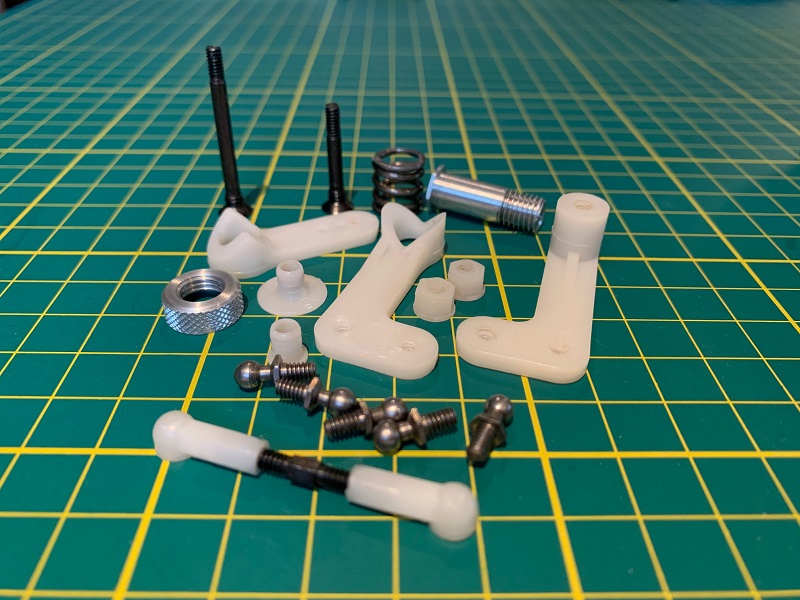

      Today we got the bellcranks all cleaned up and ready to install on the chassis. The hardest part was finding two decent white nylon 4-40 nuts.
          It seems that we are nearing the point were I need to break down and open the NIP b stamp chassis that I have been hoarding for all these years. :-)

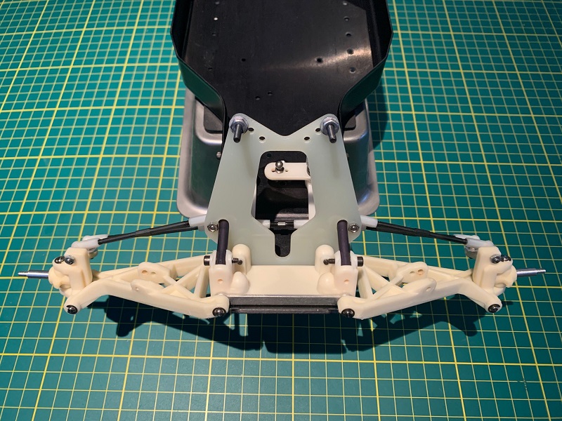

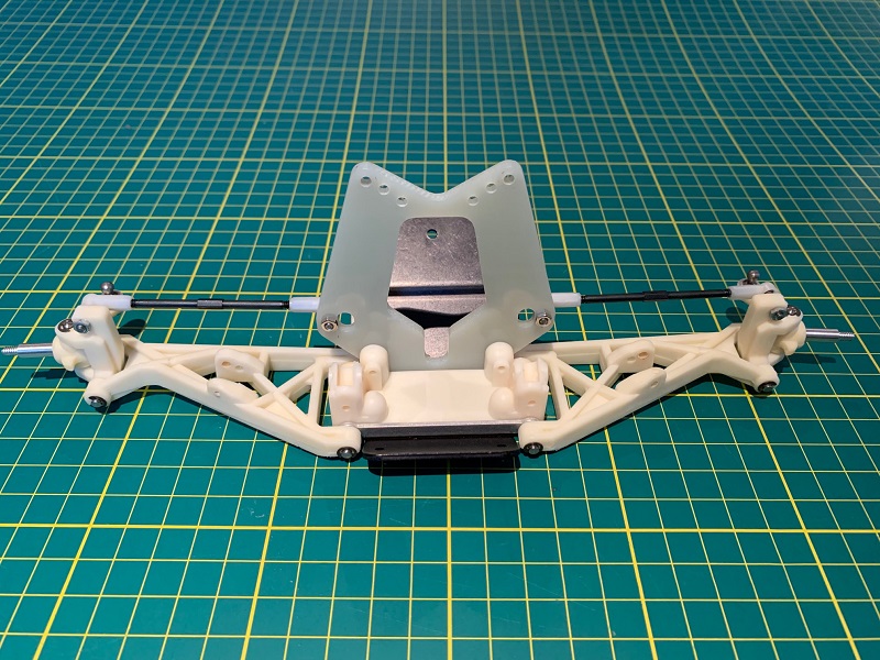

          Last night we got the front end mounted to the chassis. Other than shocks, I think we just need to add a bumper and body mounts before we move onto the back end.
              And yes, it bugs me that the inside corners of the arms are ground off. Somethings you cannot fix...
