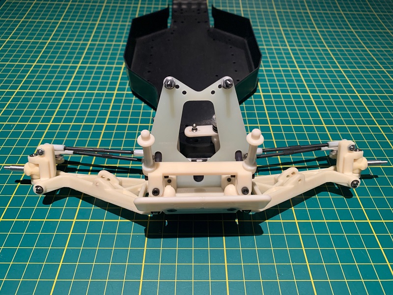

Today we got the front end all finished up:

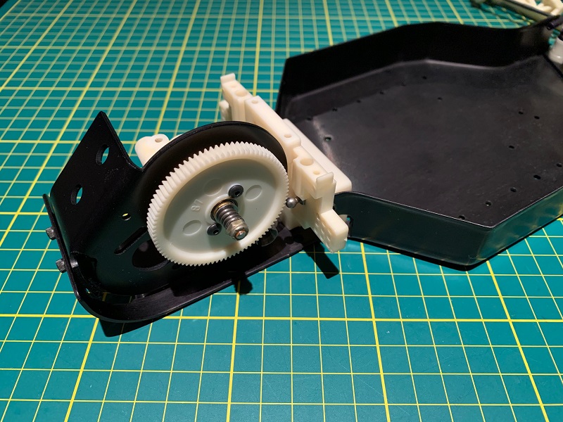

Since the last update we have made a bit more progress on the back of the truck:
