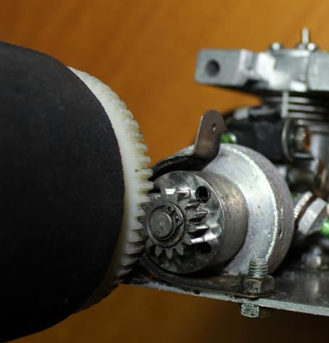

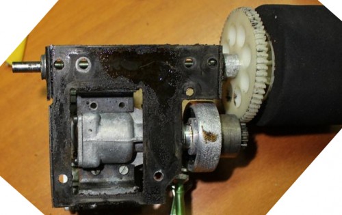

Here are a couple of pics I found online of the gear mounted on the vehicle
But could I use a 24P gear as long as it was 65T ?
The kit came with an optional 63T gear but I do not know the specs and we did not have one
