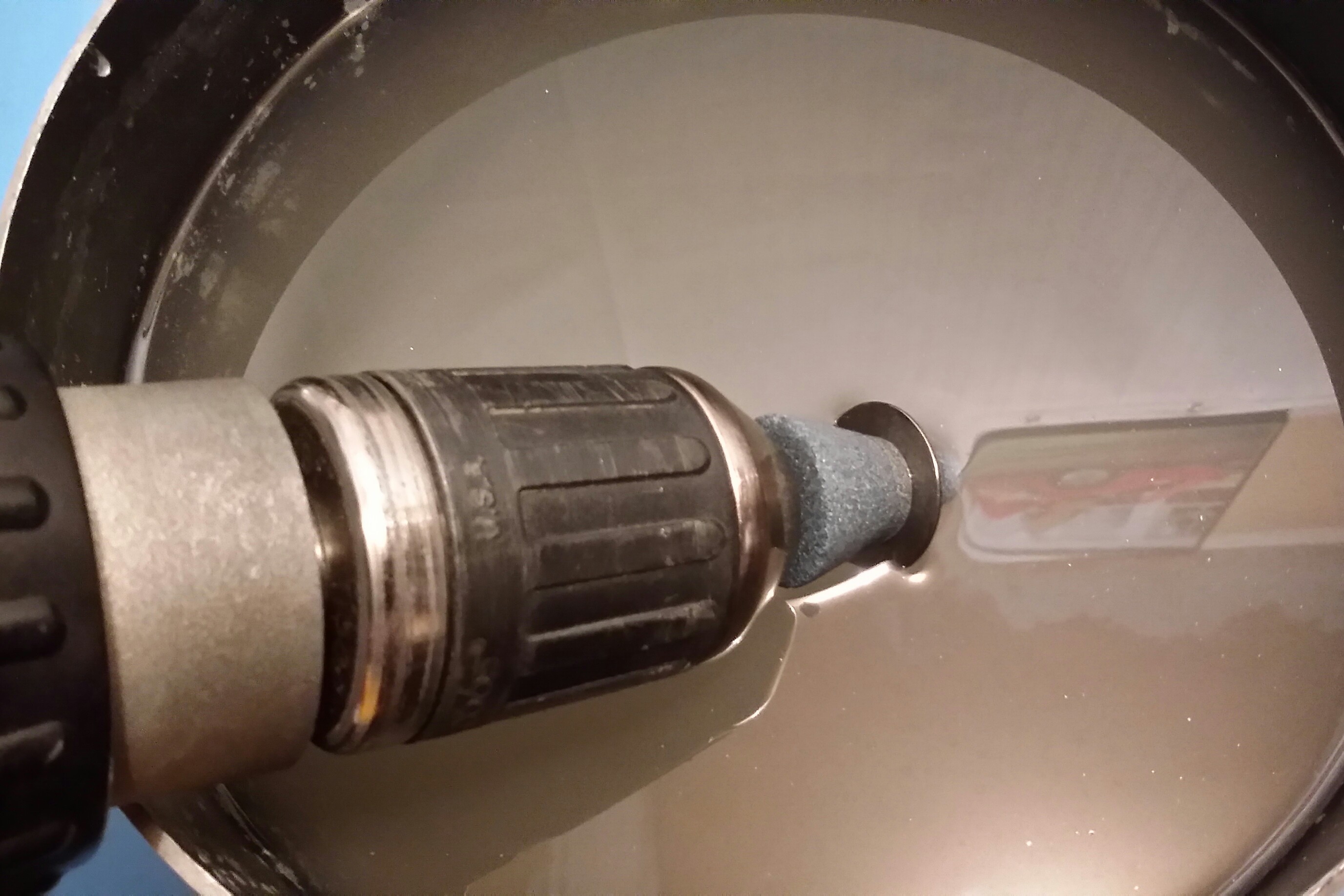

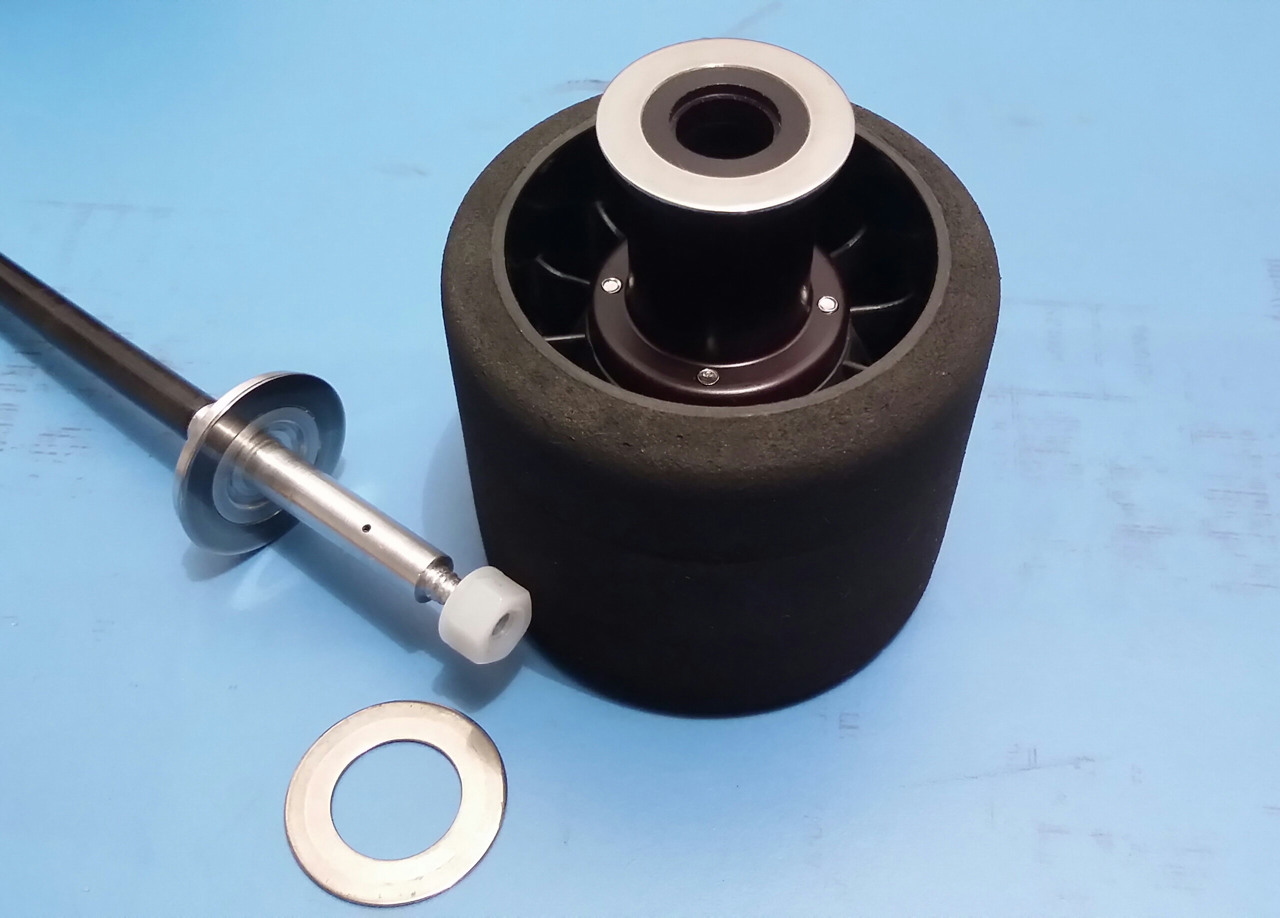

It's time to finally give this car an actual functioning diff instead of the super glue locker it had before. But it seems with this car every part needs attention. This time while putting in a set of diff rings I noticed the Hyperdrive cars must use 16mm or 5/8" inner diameter rings. Nope, don't have any of these so it was time to make my own. Since these are hardened rings, I figured I might use a cone style grinding bit to evenly open up the standard diameter to 5/8". To reduce heat and not screw up the temper, I submerged the bit in a pot of water and used a cordless drill on low speed. It allowed me to slowly widen the ring so it would fit tightly with no play and no run out. It worked quite well but I didn't realize my fingers were contacting the grinding cone and took off layers of my skin with it. Only when I saw blood is when I said "whoops"!

All will go well from this point , its had a Blood Sacrifice
you have appeased the RC Gods , some builds require it

Ouch.
I hope you flushed your hands well after that, because the color of that water doesn't look too healthy...
But you're doing some really nice work on this car!

Blood sacrifice.....hmm maybe the rc gods are appeased! The project should be mostly downhill at this time. The shocks will be a bit of a challenge to find though. That would be my last stumbling block. The diff is being assembled and axle spaced equally on each side. I will set the track width to 220 mm for this car. I can go to 235 mm but it seems for this car 220 is just fine. I'll post a pic once the rear axle is finalized.
Btw- my fingers are healing up nicely. That water was clear when I started grinding, not sure why it turned color later in the process....maybe ground up skin?

Finally, a real working diff! It will need a little breaking in to loosen up a bit but it should be alot smoother than it used to be. I bought some dye more black graphite to try changing the red battery holders to black. I think they were dyed red before so I am not sure how they will accept black now.

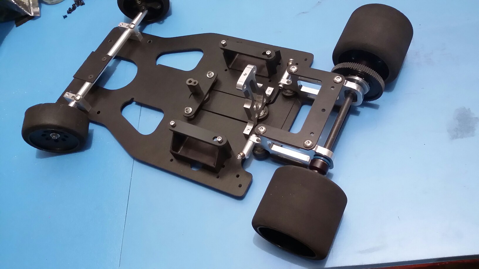

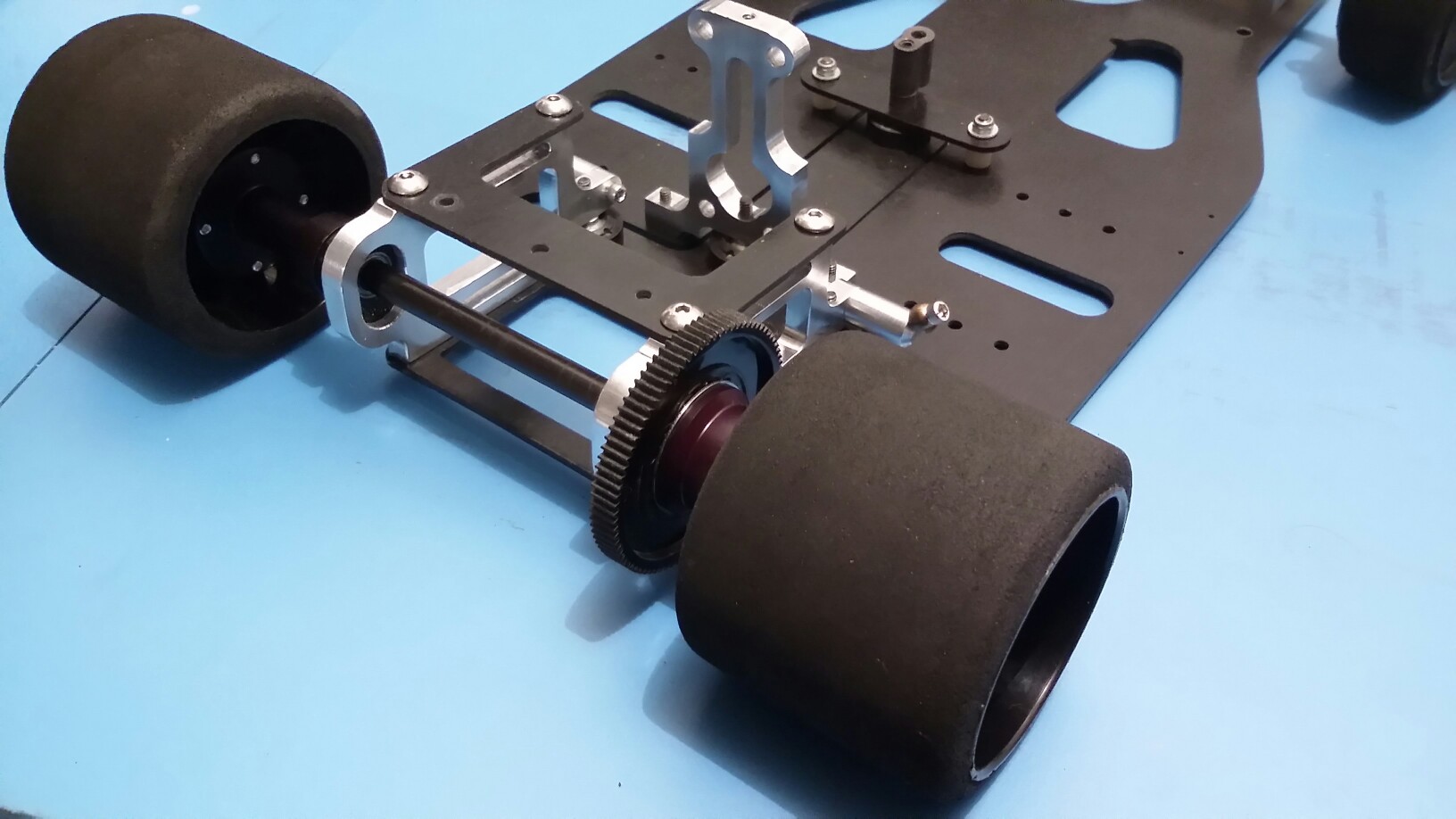

Here is how she sits so far. Parts dyed and came out better than I expected. I decided to make my own battery hold down pieces due to one of the originals had a wallowed out slot and it didn't look quite right on the car. Also worked on the diff a bit to find where it was binding. The buds centering washer was dragging near the threaded part of the axle. Just needed an extra washer to clear the step area near the threads. Hard to explain. Now comes time to decide on electronics layout. Servo may need to sit on the front axle like it was intended.

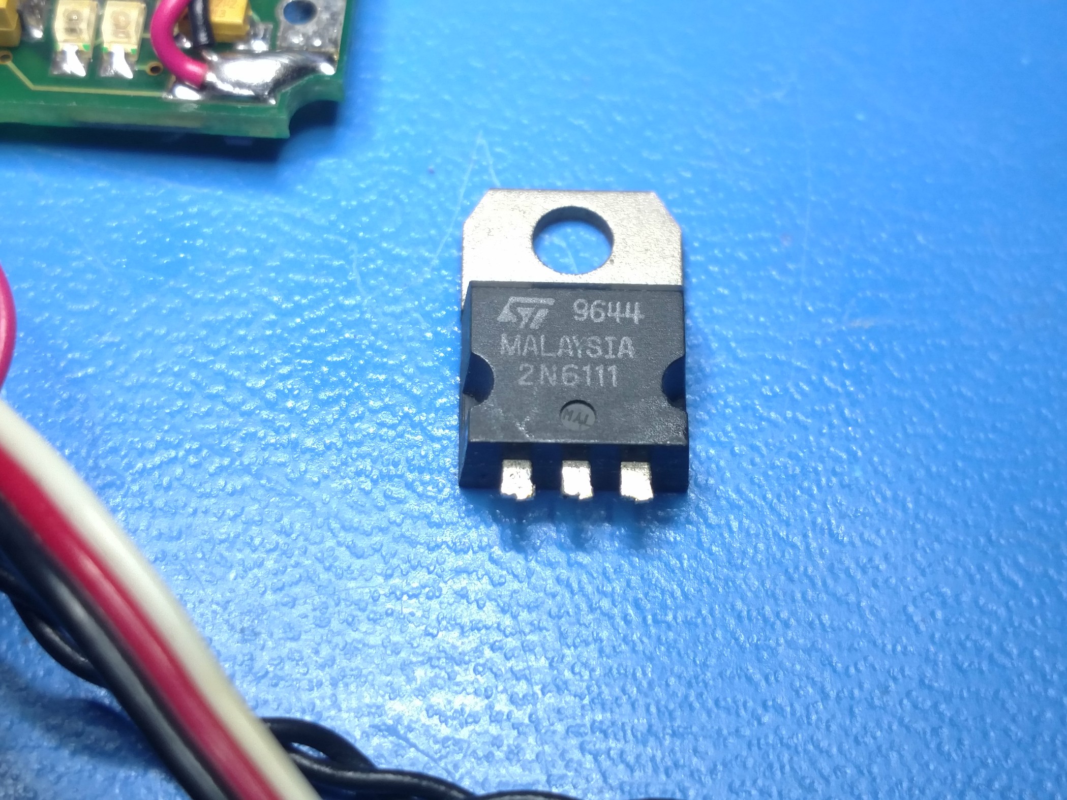

Re: Hyperdrive H10 super glue special

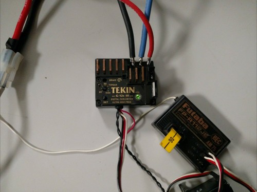

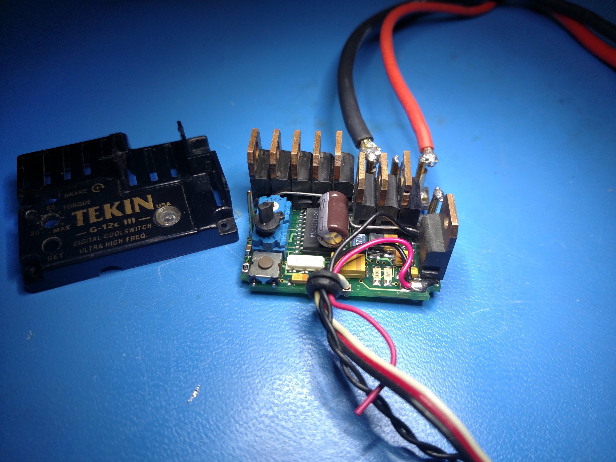

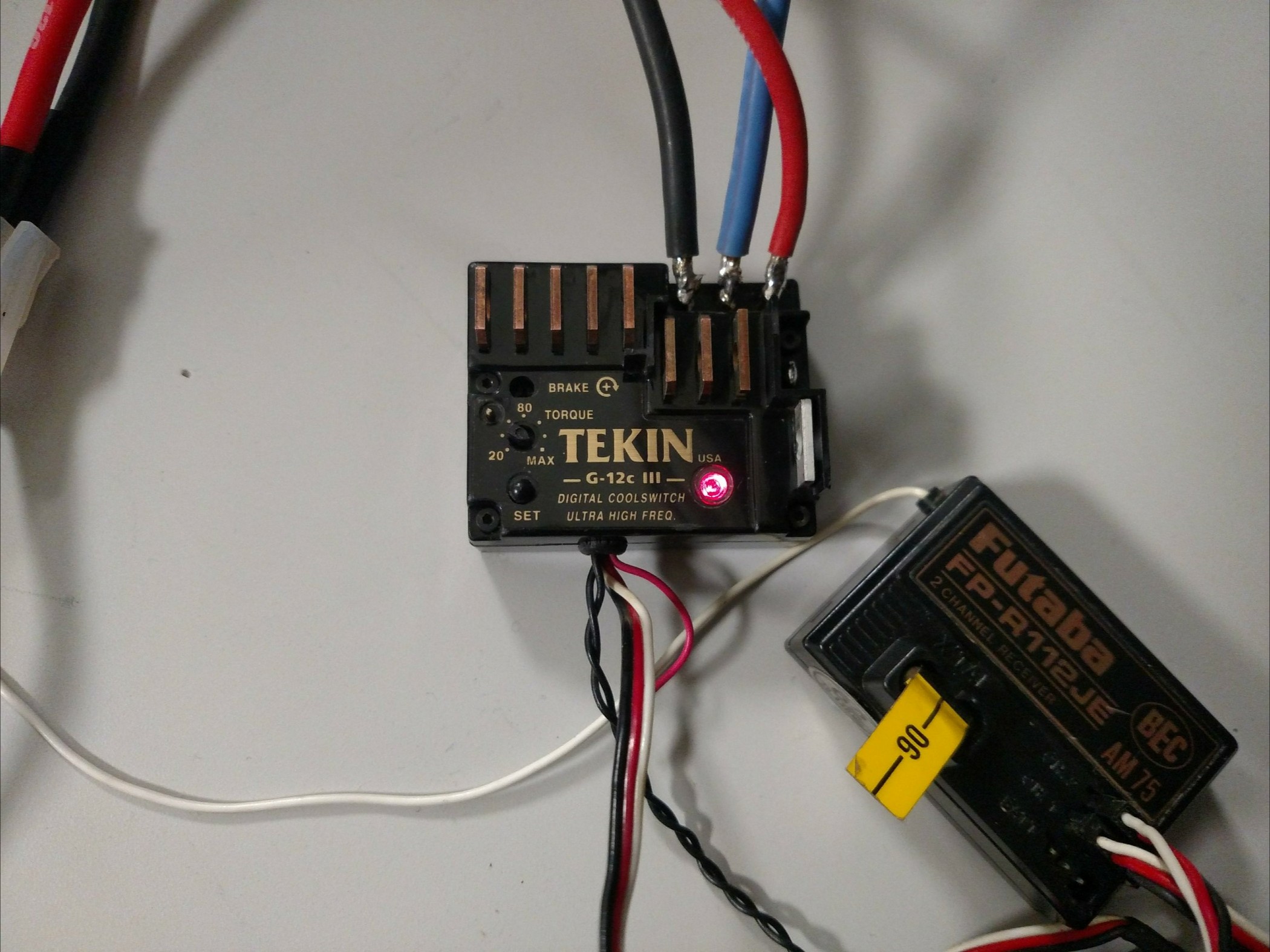

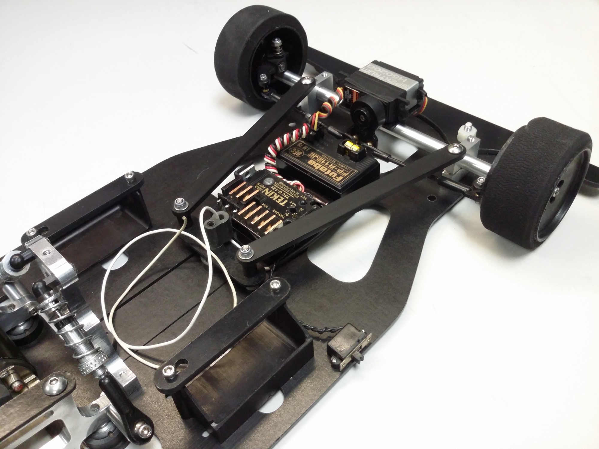

Well I thought the electronics with this car may not need any attention. Wrong....I applied power to the Tekin ESC and discovered no indicator light nor power to the receiver. Time to crack open the case and take a peek. I did the visual and smell test. Nothing stood out. Next, I poked around with a ohm meter and drive FETs seemed OK. Moved to the switching transistor and measured a dead short across the base and collector. That may be the reason the BEC circuit voltage is forced to zero. I desoldered the transistor and verified the short. Yep, its bad. Ordered a few from digikey and hopefully revives the ESC.
- GeneralZod
- Posts: 415
- Location: Colorado
- Has thanked: 150 times
- Been thanked: 162 times
Bingo! Its back from the dead! I then hooked up a motor, servo and receiver. After a quick calibration of the ESC, the servo and motor are now functional. Now, I have to put a new Futaba connector and pins since this one doesn't fit right. Maybe someone crossed the wires in the past resulting in the shorted transistor.

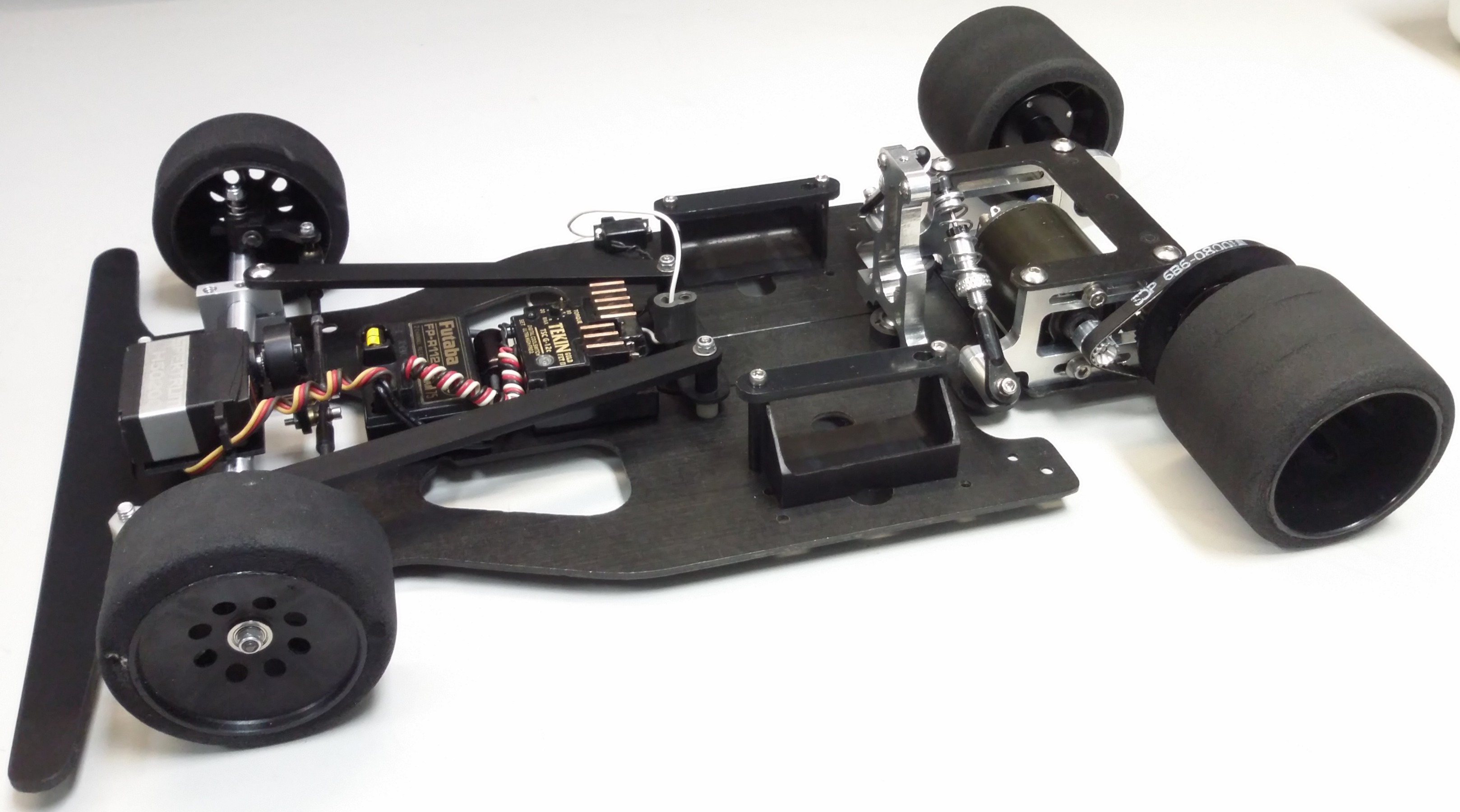

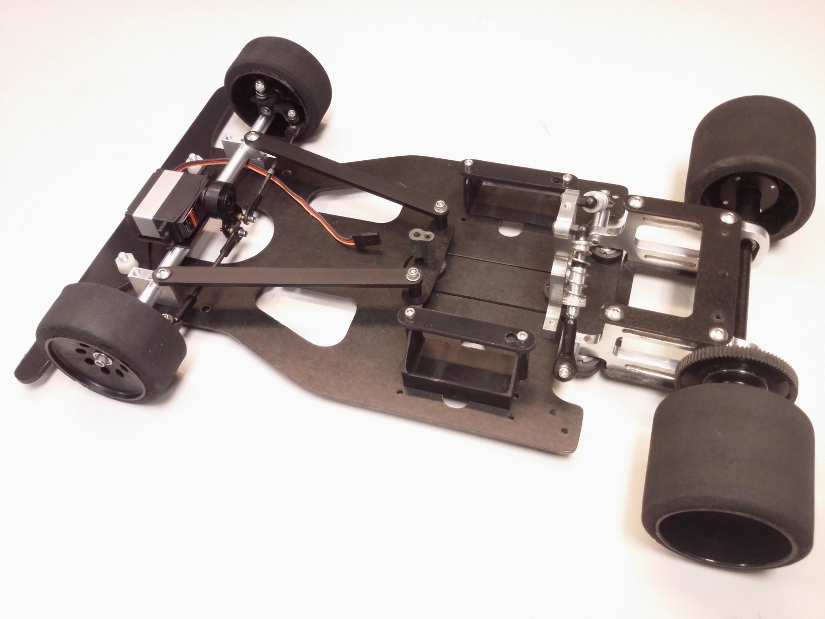

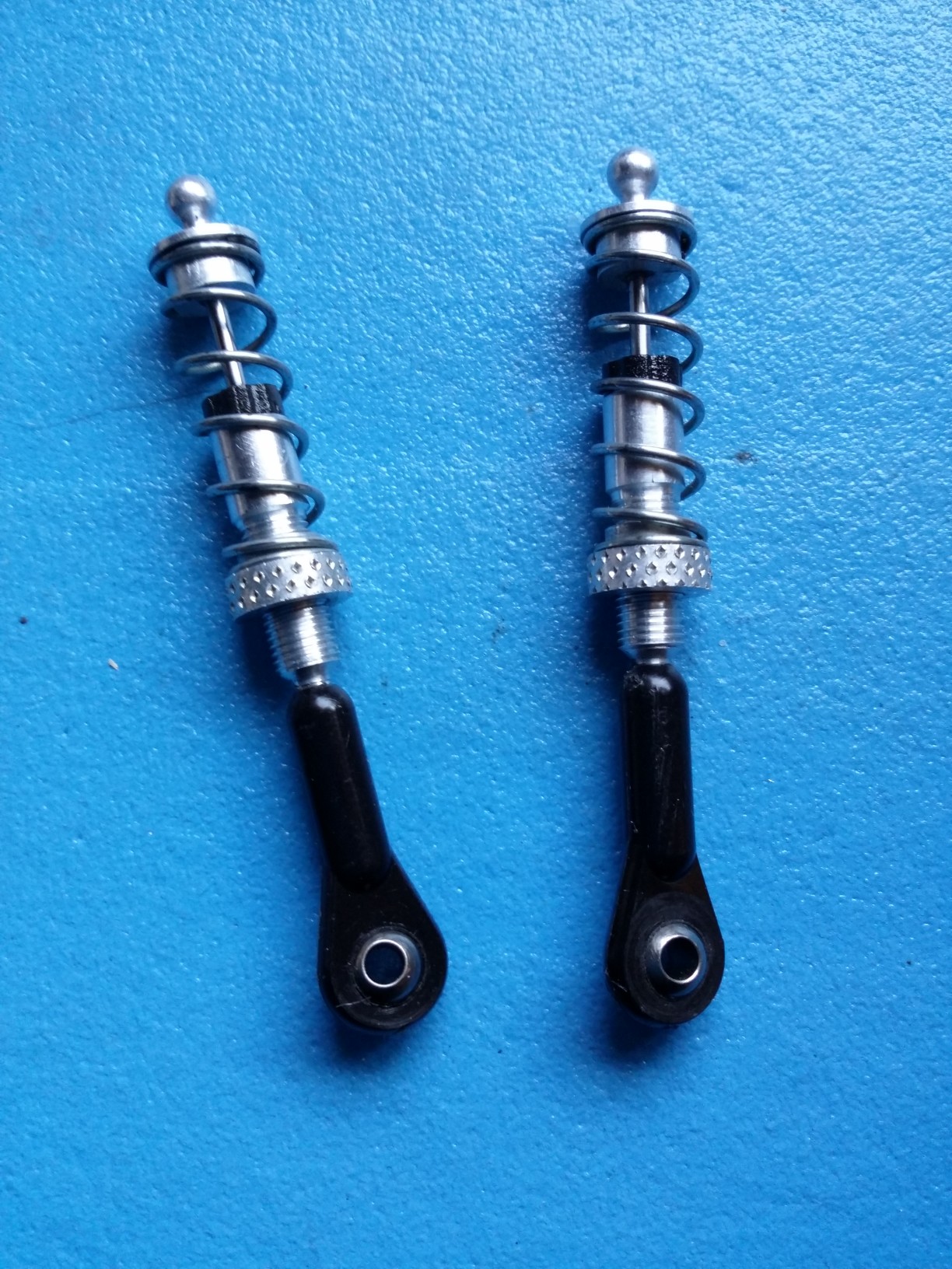

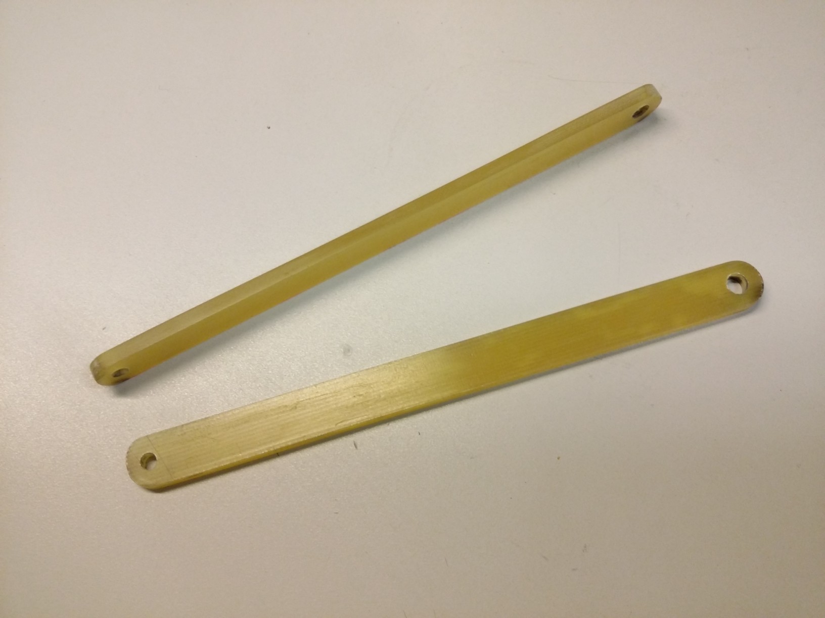

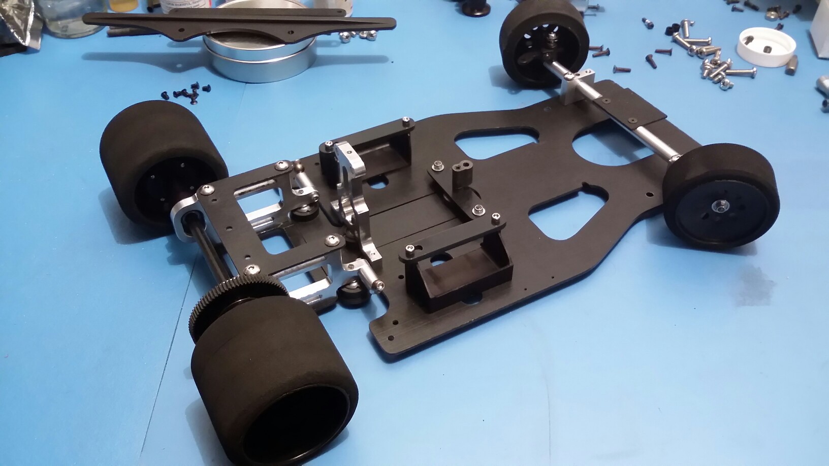

I want to thank our fellow member Phin for sending me a pair of those elusive delta shocks. This has helped me to move on with the rebuild. Only thing left I need is some help to find the larger center main shock and spring. (Anyone have one rollin around in their old parts bin?)
Made a couple of chassis braces from layers of fiberglass sheet glued and pressed together then shaped with dremel and hand filed. I then sprayed ceramic black engine paint. When fully dried, I rubbed them with paper napkins to give them a worn look to match the old sheen of the main plate.

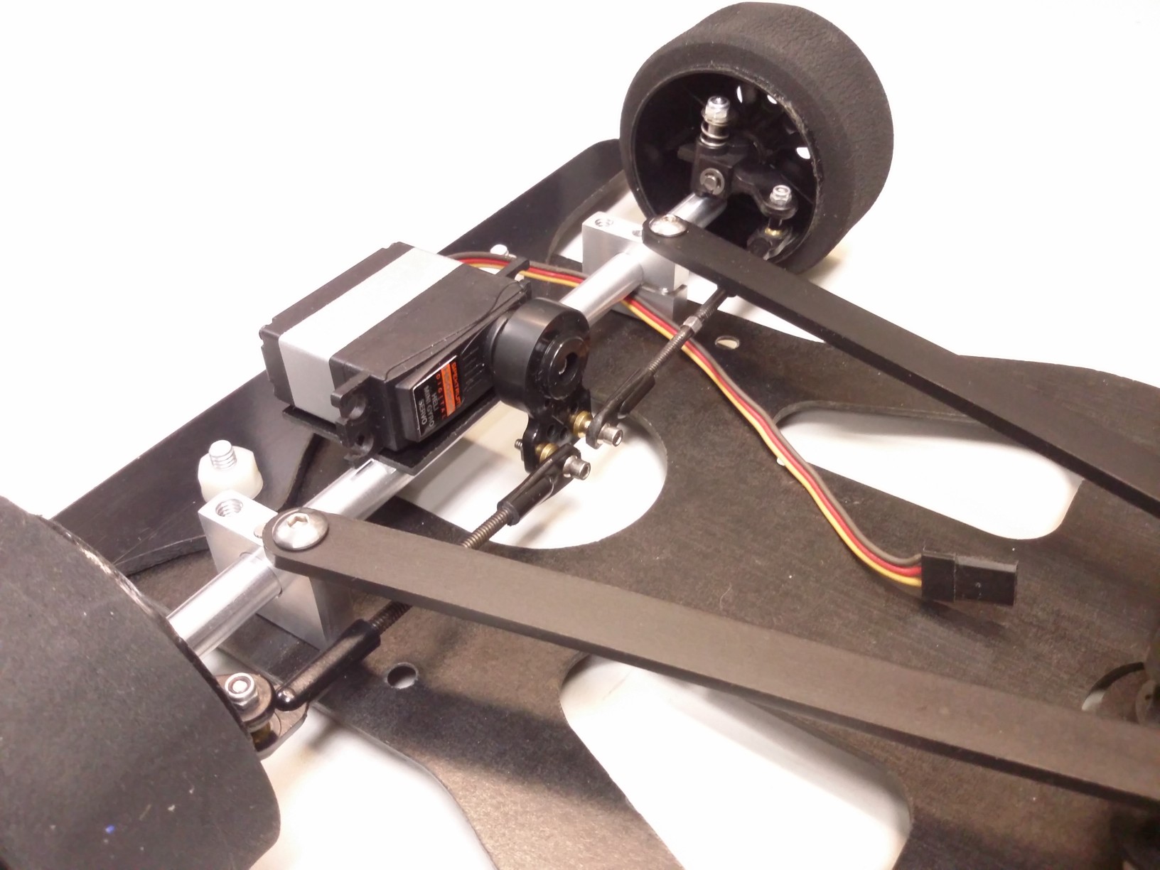

After some thought, I decided to mount a very fast heli servo on the front axle and adjusted the tie rods and steering angles. A tedious process but I think I was able to get everything pretty well lined up.
Also moved the diff to the other side of the pod to get it ready for the belt drive setup. ESC and receiver are being prepped for install as well as choosing a period correct motor. I tried using a correct era servo but it just didn't look good. The metal geared heli servos appearence is nicer and its small size made it fit better on the axle along with its quick transit speed.

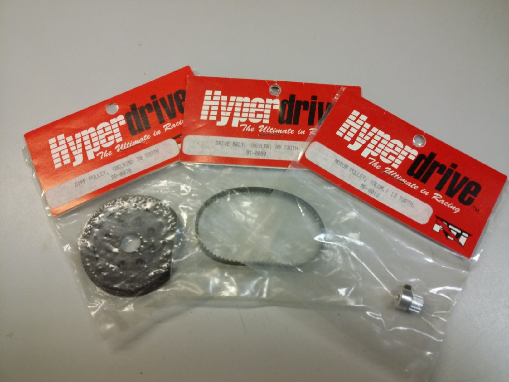

I was able to obtain a few Hyper goodies. Belts, spurs and pinions. Time to fit a set on this car and several others needing them. I never messed with a belt setup so this is new to me. Cant wait to try it out!
The vintage smell was overpowering upon opening the box! In a strange way, I kinda liked it
Selected a combo that matched my target ratio.
Now time to pick an appropriate era motor.......

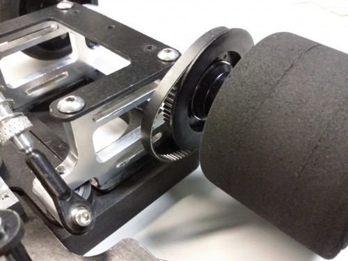

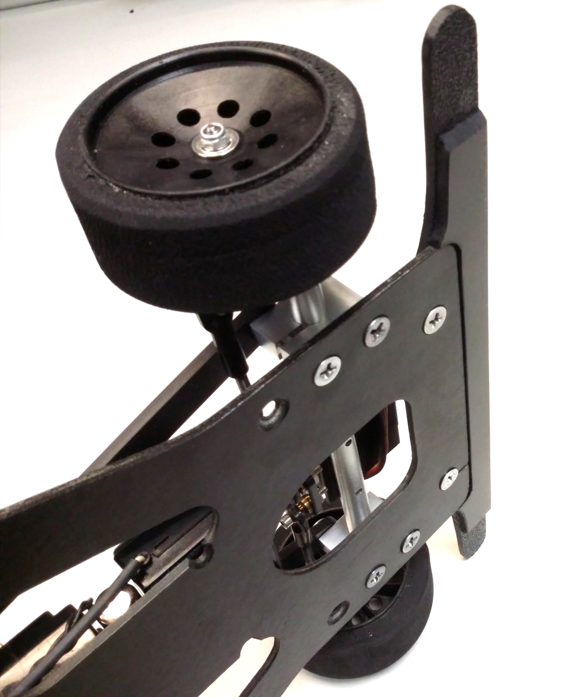

Worked a bit more on it tonight. Rebuilt an old Yokomo motor for checking alignment of the belt and pinion. For some odd reason, the motor did not fit up against the aluminum mount. The factory design was off a bit. The top plate on the pod was sitting too low and interferes with the motor. I had to use 4 small washers between the motor mount and top plate to bring it up a bit so the motor would fit. Weird the factory overlooked this. Wired up the motor to the power supply and turned on. Wow, she's real quiet! Though I could hear a strange clicking near the diff. Tracked it down to the old ball cage. Got rid of it with an Associated axle spacer and now it is silent.
Also had some time to install the electrics. Just have to build a NiMH pack and wire it up. I will go lipo later but for now, its old school mostly.

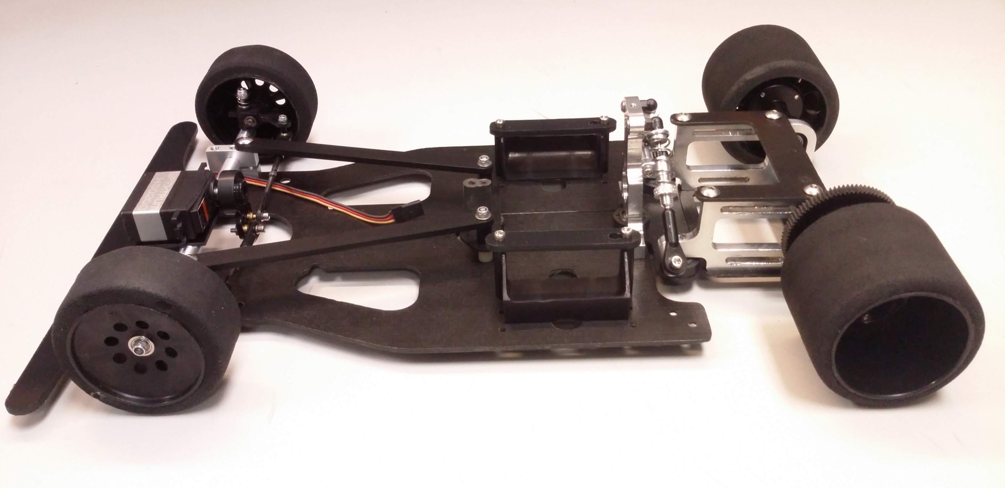

Worked to finish the front bumper and front underside chassis guard. Its slowly starting to get back to how it should be. Now I have to find the main center shock. That is the last part I need to get this thing up and rollin.
