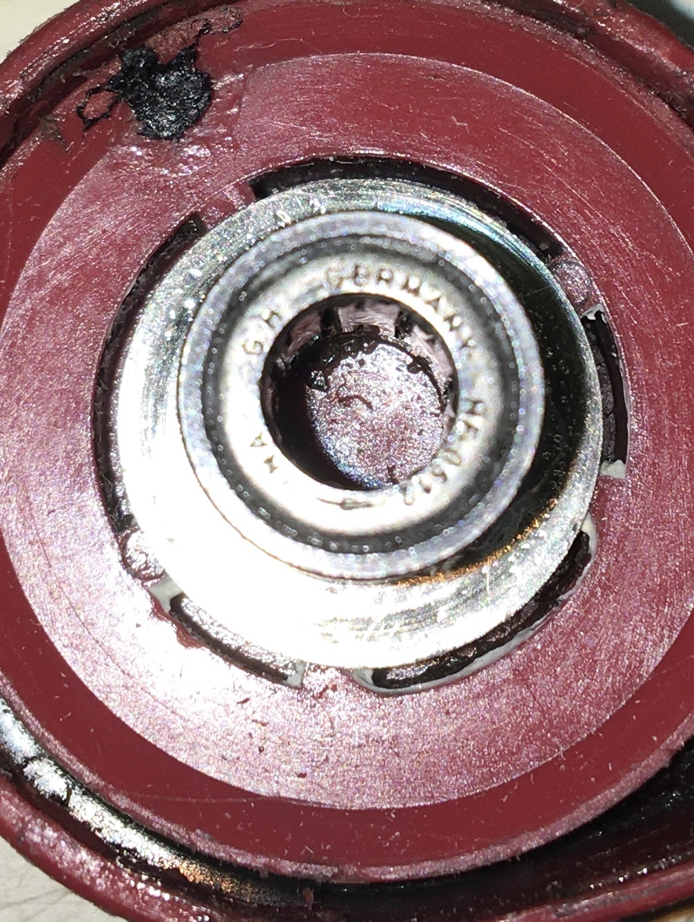

OWB is inside the pull start - have tried it with the backplate off the motor and it’s fine ..
Hopefully photos attached ..
I’m stumped 🤔

Post by coxbros1 »
that one way is in there like it should be
