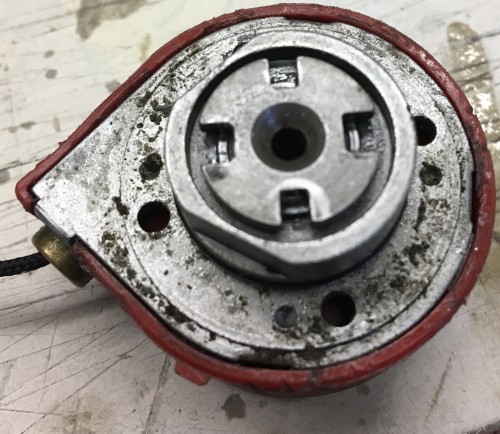

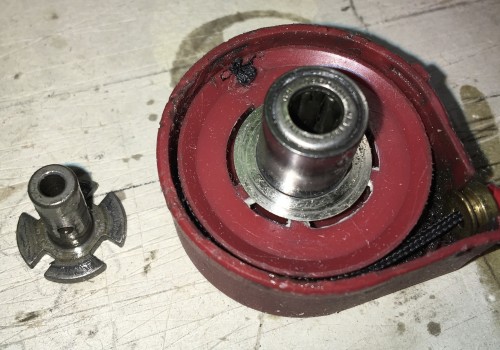

Hi - I had the backplate off briefly and the shaft that mates with the pull start had a very Heath Robinson ‘thing’ that engages with the crankshaft but I don’t remember a bearing ... I will dismantle it again and have another look and maybe take some photos
Re: Kyosho GS11X - pull start recoil issue

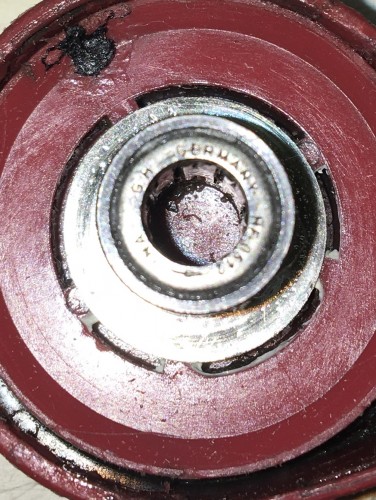

OWB is inside the pull start - have tried it with the backplate off the motor and it’s fine ..
Hopefully photos attached ..
I’m stumped
I’m stumped
that one way is in there like it should be
