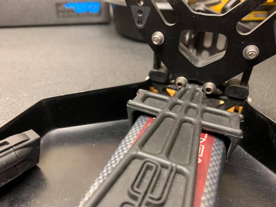

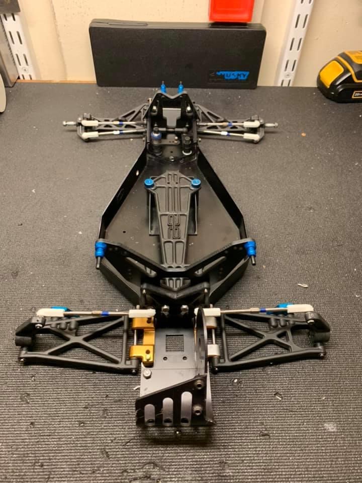

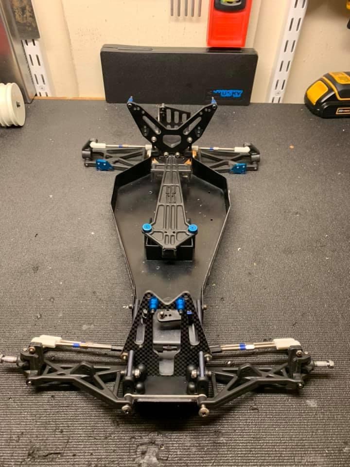

Nothing too exciting, just started to throw stuff at the Chassis, modified the battery strap and shock tower, so I can mount the tower in front of the bulkhead...

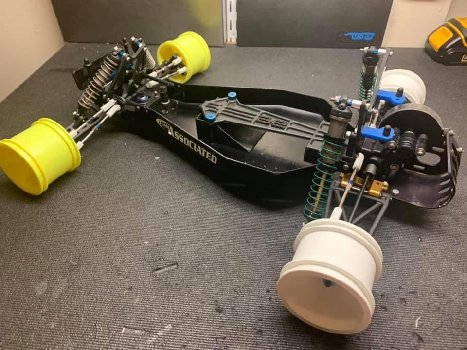

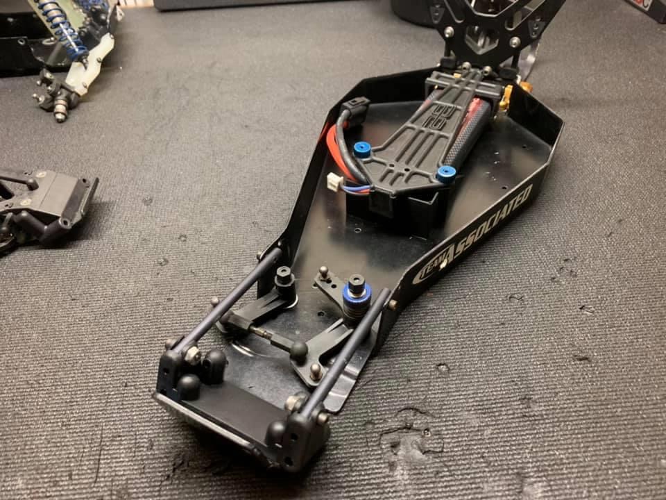

So finally got my carbon shock towers and some other bits, so instead of waiting until everything comes in, I’ll piece in whatever part I get as I get it....keeps me sane
Aluminum turnbuckles and rpm ball cups, while I wait for the Lunsford kit to come in

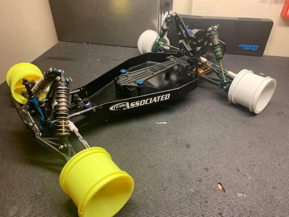

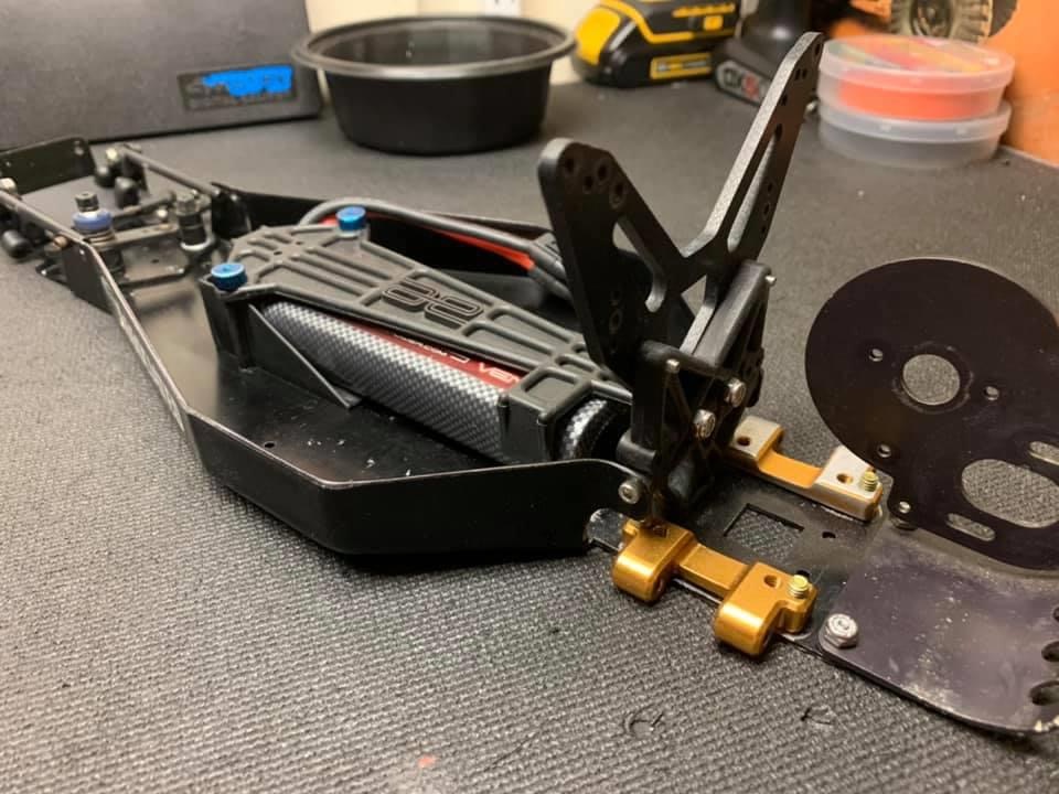

So.......
Decided to mount the tower on it’s normal location, and added spacers on top to make the shocks sit nice and straight up and down.
Fitted the shocks, 1.32 rears and 1.18 fronts (since couldn’t find V2 shocks in 1.02 length.

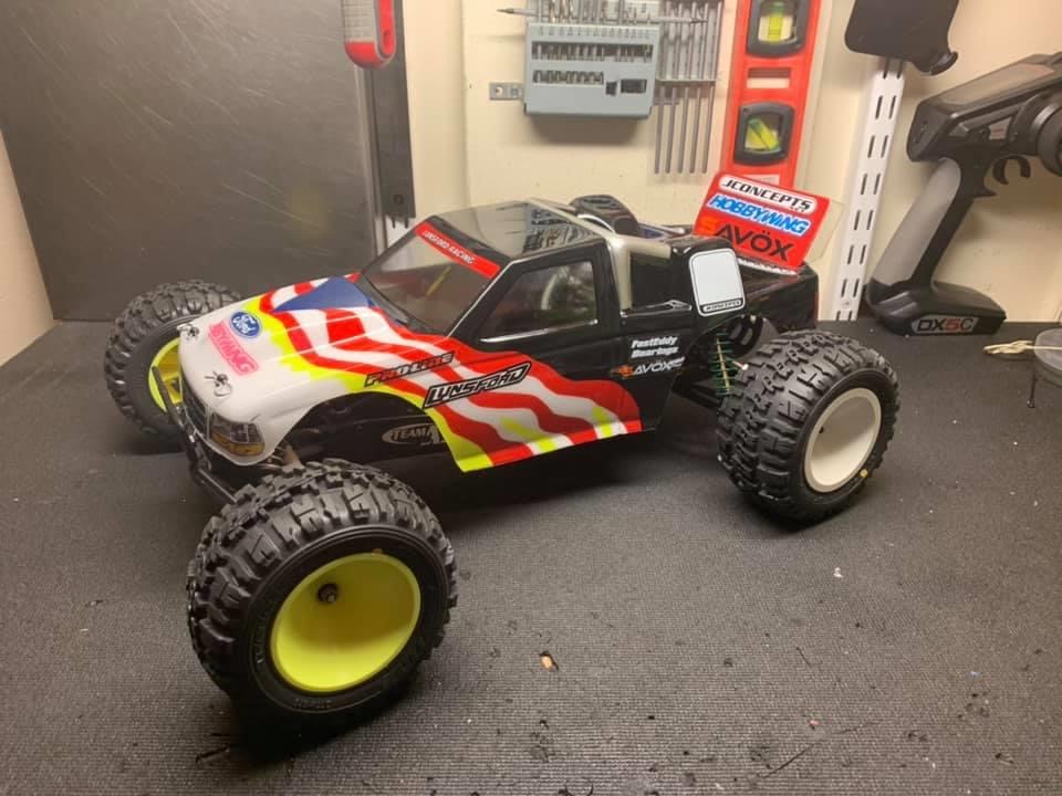

Re: Tecnica’s 2020 VONATS RC10T2

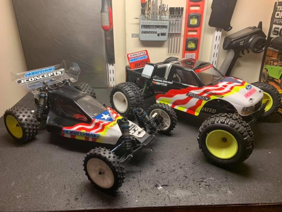

Here it is, painted and awaiting electronics
Thank you,
I’ve always had a soft spot for this truck, it’s my second favorite RC10 truck

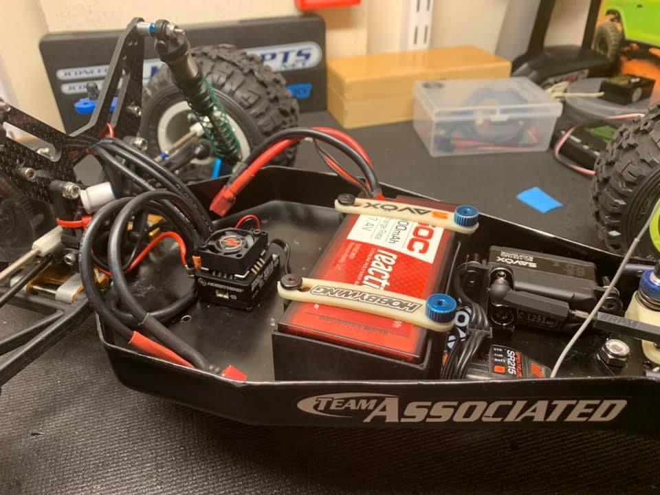

Electronics Complete
Hobbywing Xerun XR10 Pro Stock ESC
Hobbywing 17.5 VR10 G3R BL Motor
Savox SC1251 MG Servo
Spektrum Receiver
78/26 gearing
Spektrum Receiver
78/26 gearing
They worked great, I rant it at the VONATS and they performed awesome
I did limit the travel to make them 1.02 stroke.
Can you tell me the exact parts list for the electronics you used, mines currently 1994 vintage. Need Some more zzzzip!! Thank you
- Posts: 1047
- Joined: Mon Jun 30, 2008 3:17 am
- Location: East Haven, Connecticut
- Has thanked: 19 times
- Been thanked: 29 times
ESC:
Hobbywing XERUN XR10 PRO Stock Spec V4 Brushless ESC 30112401
MOTOR:
Hobbywing XeRun V10 G3R Competition Spec Brushless Motor (17.5T) (HWA30401131)
SERVO:
Savox Black Edition Low Profile Digital Servo w/ Black Alum Horn / Glitch Buster (didn’t use the glitch buster)
BATTERY:
Associated Reedy Wolfpack HV-liPo 7.6V 4200mAh 50C Shorty ASC27318
MOTOR:
SERVO:
BATTERY:
