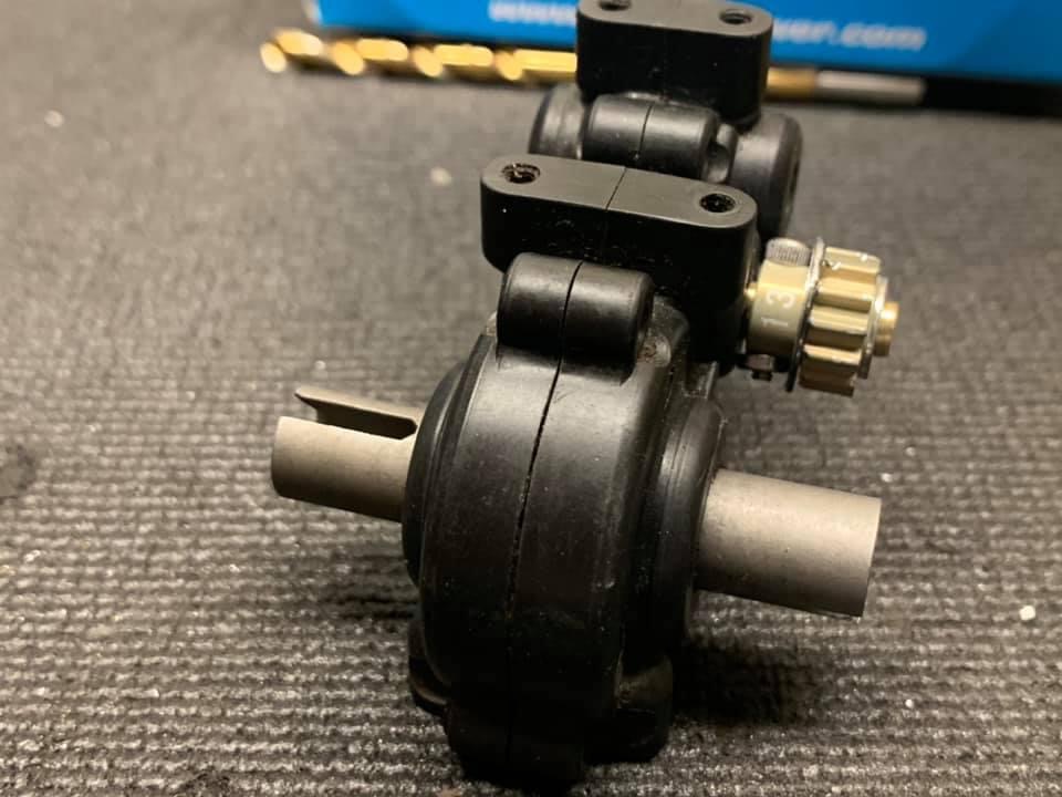

Here’s the starting point:
Had to find a long enough shaft that would protrude out of the transmission to be able to mount a pulley onto it.

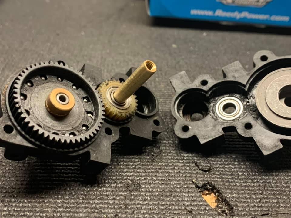

These are 1.2” long, 4-40 threaded standoffs with an outer dimeter of 3/16”, PERFECT RIGHT?? Nope? They are actually a bit larger than 3/16, had to ground them down a bit to fit in the bearings
