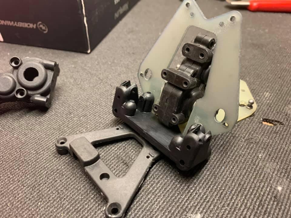

Here’s the starting point:
Had to find a long enough shaft that would protrude out of the transmission to be able to mount a pulley onto it.

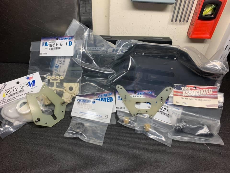

Ordered some STUFFS👍

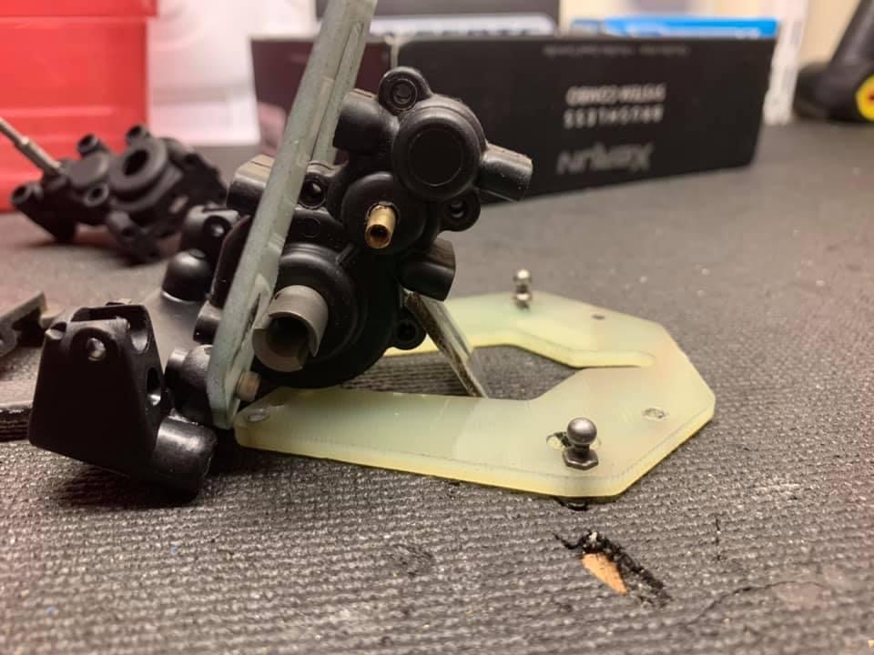

I cut down the front tower and tried a couple of mounting options for the tranny....
I can mount it onto the Nose plate, and onto the shock tower.
This way would give me nice steering clearance👍

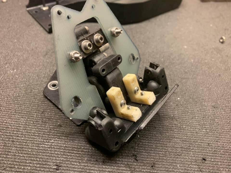

This way, all 4 mounting points would be on the nose plate, and I could brace it to the tower also, and theoretically, gives me good clearance....👍

So this will be the final resting place for the GT gearbox, everything from here on out will have to work around this.
It’s tied to the nose plate using a par of Traxxas servo mounts that will either be replaced for something a bit stronger or just dyed black😁
I made a carbon brace to tie the top of the gear case to the shock tower.
Without the nose tubes, it all fill pretty stiff👍
