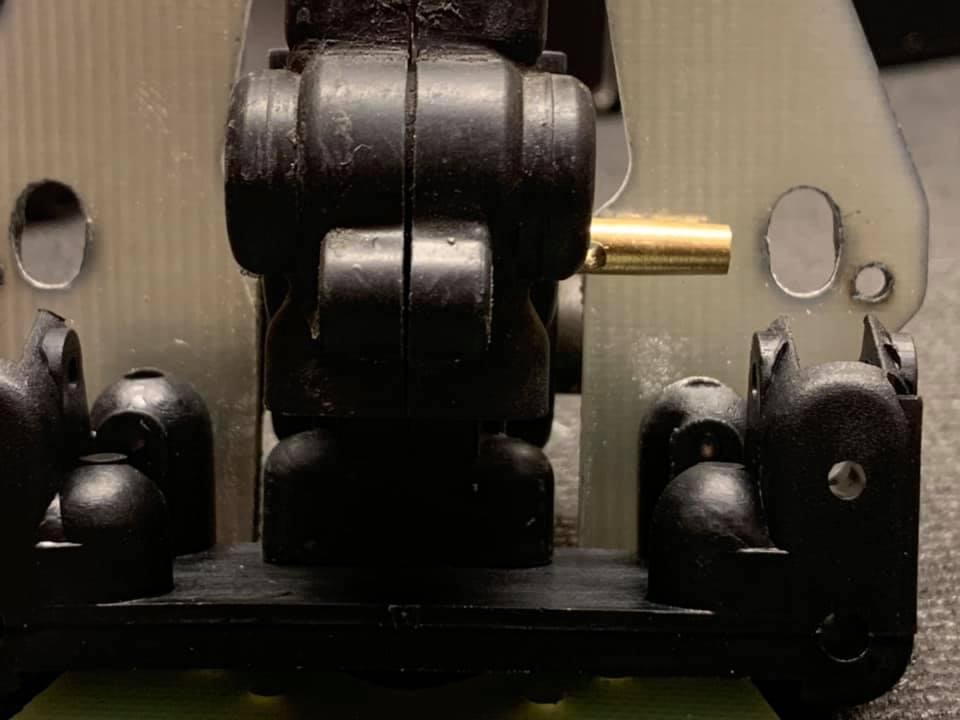

Had to find a long enough shaft that would protrude out of the transmission to be able to mount a pulley onto it.

These are 1.2” long, 4-40 threaded standoffs with an outer dimeter of 3/16”, PERFECT RIGHT?? Nope? They are actually a bit larger than 3/16, had to ground them down a bit to fit in the bearings

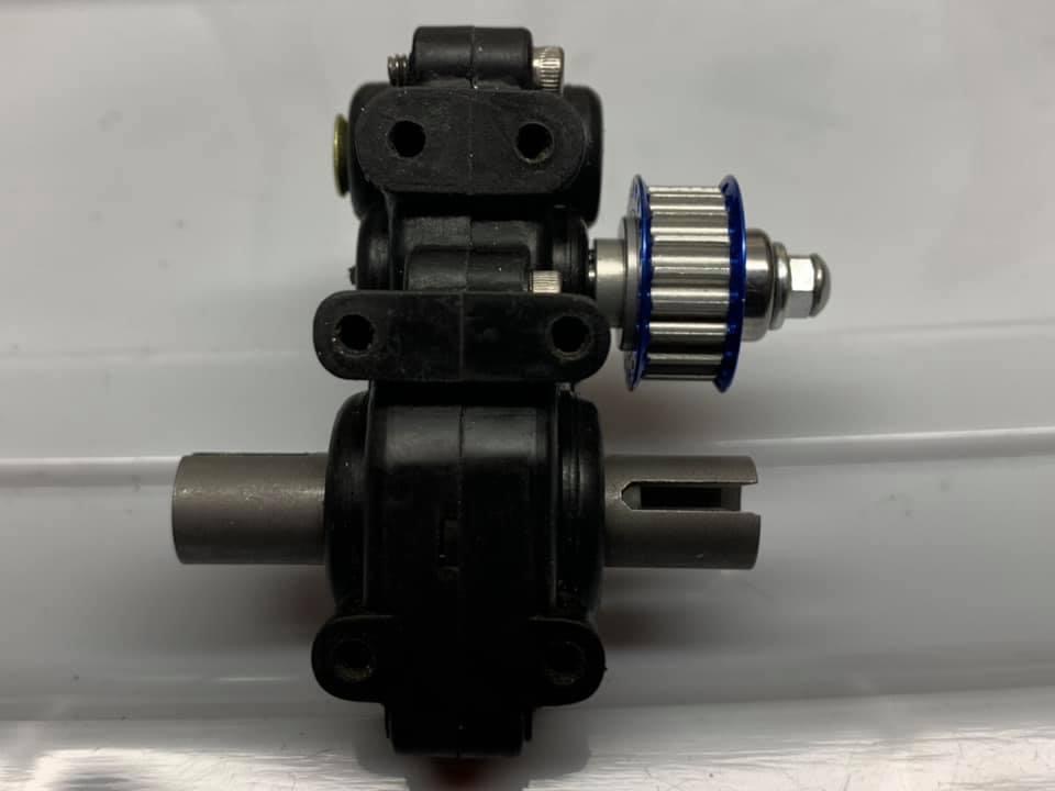

The pulley is a Sakura drift car 13t center pulley, and the inner diameter is 4mm, so I had to grind down the outer portion of the shaft to fit in the pulley, drilled through the shaft using the set screw hole as a guide, and fastened it on the shaft using an m2 screw and nut.

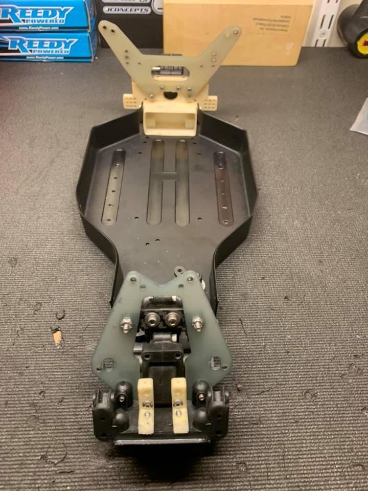

I cut down the front tower and tried a couple of mounting options for the tranny....
I can mount it onto the Nose plate, and onto the shock tower.
This way would give me nice steering clearance👍

This way, all 4 mounting points would be on the nose plate, and I could brace it to the tower also, and theoretically, gives me good clearance....👍

Bought a one way pulley for an SC10 4x4, just to have that option, it’s a 19t pulley from hot racing.... had to make a new input shaft(idler gear shaft) to fit the larger diameter of the one way.

So this will be the final resting place for the GT gearbox, everything from here on out will have to work around this.
It’s tied to the nose plate using a par of Traxxas servo mounts that will either be replaced for something a bit stronger or just dyed black😁
I made a carbon brace to tie the top of the gear case to the shock tower.
Without the nose tubes, it all fill pretty stiff👍
