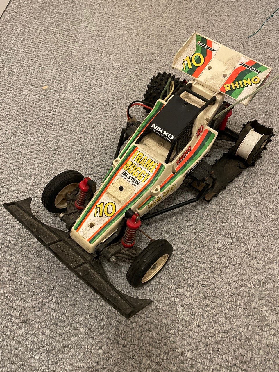

Whilst clearing the loft I found this Rhino F10 which was given to me back in 1987.
Unfortunately, one of the rear dampers got broken and it was put into storage. I'd love to get it going again, I will create another thread to seek spares or alternatives.
