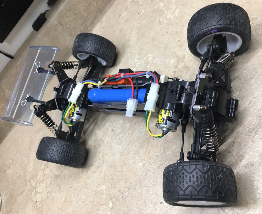

i had this nikko dictator sitting in a box for a while, and started restoring it to its former glory!
i like strange rc cars and with the dual motor set-up this old nikko has, it fits right into my collection and interests!
i watched clips of brushless 4s dictators, (COOL!) but since my gearbox is cracked i stick with the original 380 motors.
i also bought a nikko bosscat/dominator car to act as a donor car for parts and spare parts,
unfortunately the parts i needed were broken on that car.
the rusty donor car:
the front gearbox screwholes, are prone to breaking and cracking on these cars....
at least i have some extra spares such as arms and gears :D
cleaned up the chassis, bosscat/dominator body in the background:
lots of soldering to make the double motors work, standard tamiya esc, nimh battery and flysky receiver
installed everything in the plastic tub, IT WORKS!!

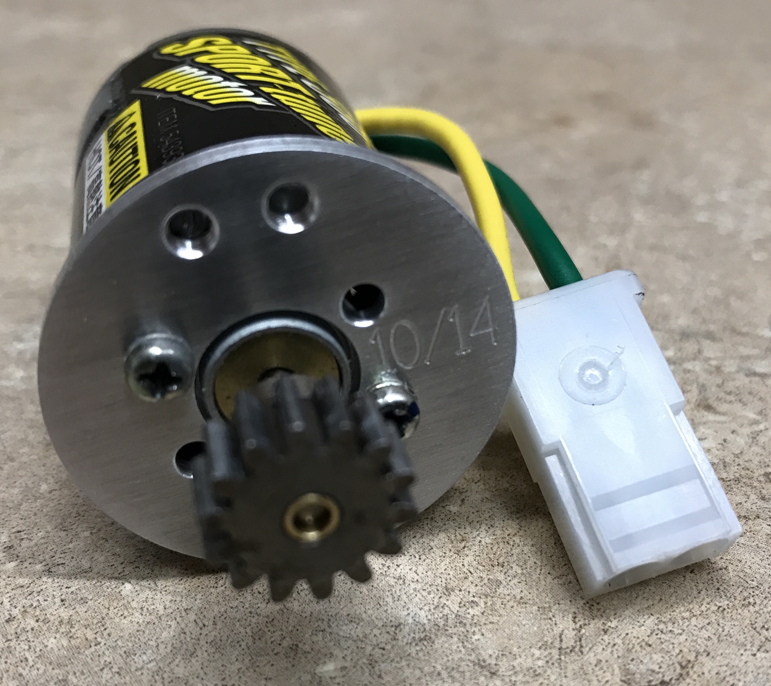

Tamiya makes some hotter 380’s if you want to step up a little but not kill it ;-) This is my Dictator (not much Dictator left haha)

i will keep that tamiya motors in mind! will ineed motor mounting plates?

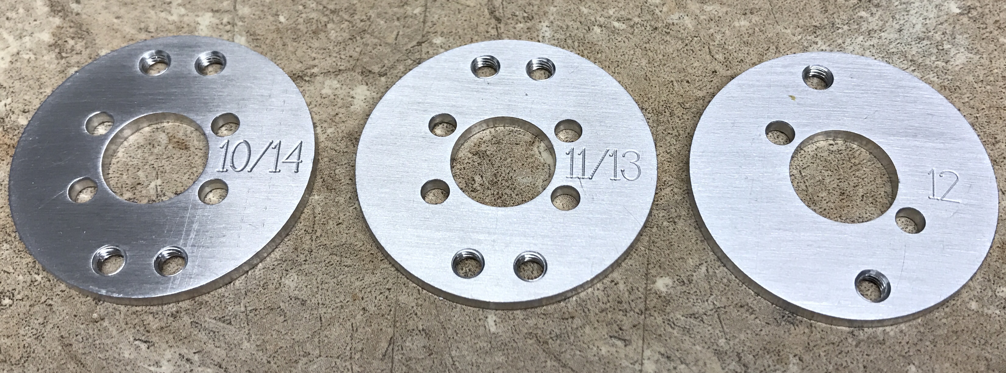

The taniya motors bolt right up with stock gearing, however I decided to make up some adjustable plates

GoMachV wrote: Sun Aug 26, 2018 10:54 am The taniya motors bolt right up with stock gearing, however I decided to make up some adjustable plates
Skills man, you got some skills. 8)
