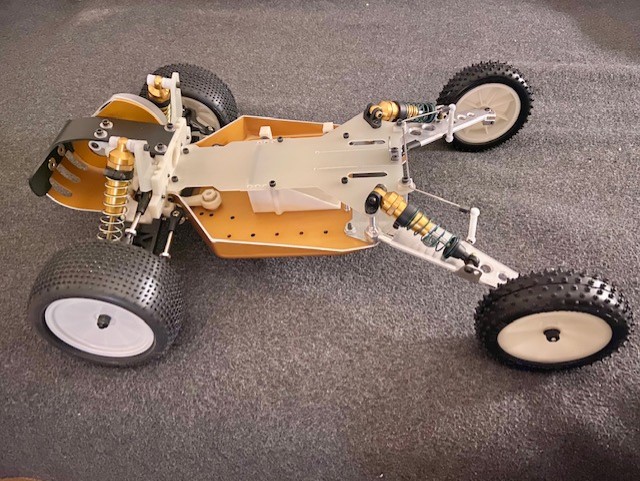

Is there a Yokomo wheel that has a offset that is between ZC-827C and ZC-835?
I have a pair of ZC-827C and they rub the steering knuckles and at full steer the shocks.
and I tested a pair of ZC-835 and then the car becomes too wide.
Picture with Kyosho 2.2"

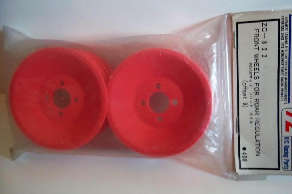

Thank you for this, aip47-2008. I have now updated above.aip47-2008 wrote: ↑Sun Jan 17, 2021 3:20 pm ZC-822 has completely different off set compared to other front wheels!
Are the ZC-822 2.15" or 2.2" wheels?
