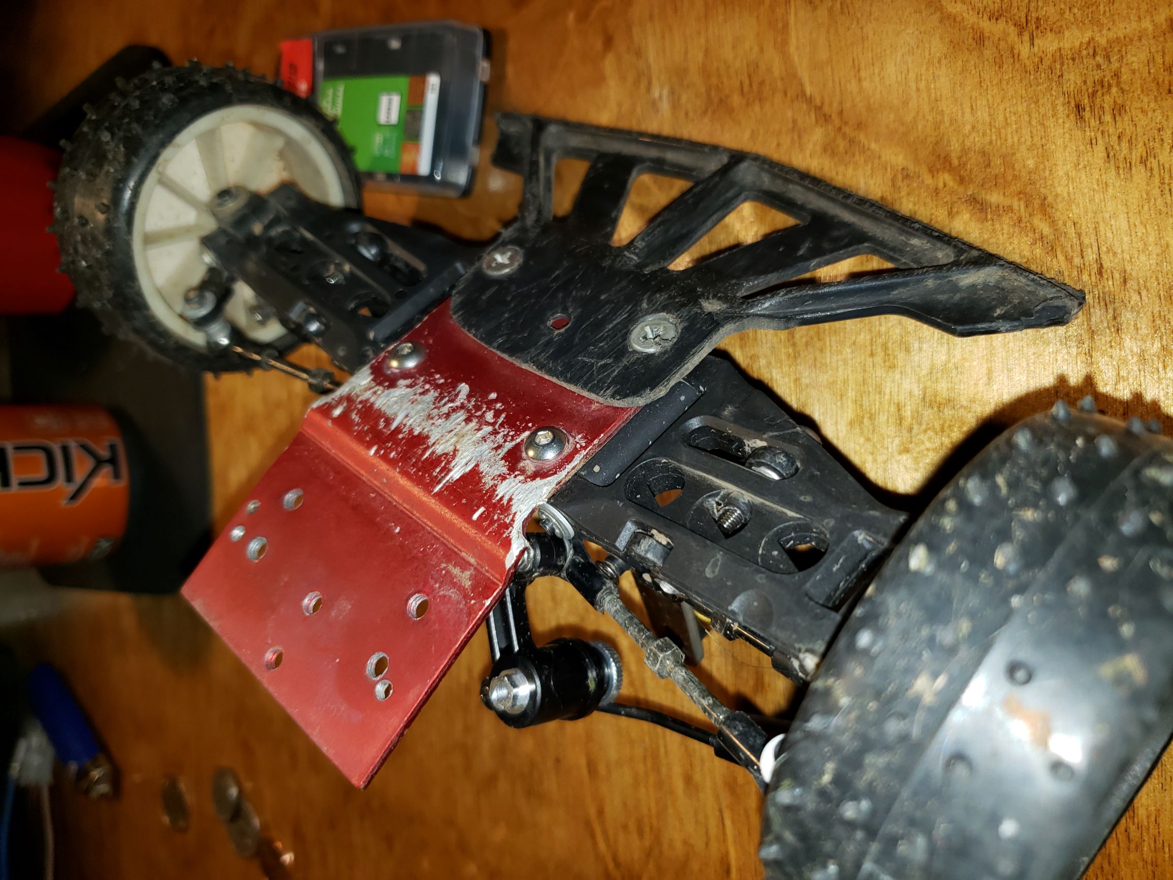

I am going to rebuild this Ultima all NEW the front Aluminum piece that the steering bolts onto I will have to find a metal shop that can do the plate offset bend and the nose up bend???

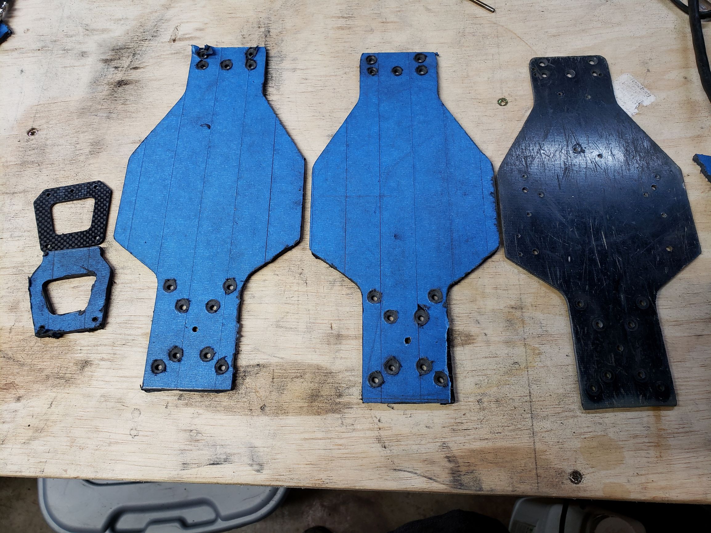

Well here I Go Rebuild time.
Got the carbon fiber dragon plate. My old plate was like 3.3mm thick! So I ordered 4mm? Thinking 3mm thick was smaller best to go a bit thicker ?
Got out to the shop and taped up the new carbon fiber plate both sides then looked at how I was going to cut it with the curves and all? I did not want to spend hours fine sanding this
dragon plate so a high speed router type tool and a bit.. Off to home depot, looking at the Dremel stuff, they did not have nothing that looked up to the job, then Roto Zip
had what I needed, 1/8 Carbide will tile bit!
I have a DeWalt roto tool for cutting out the holes in sheetrock for the outlet boxes, so I figured that would work for a router!
So-Sorry Moderator or Moderators!!! But working with Carbon Fiber as in cutting it is a Bitch and dangerous to anyone's Health!!
Kn95 Mask or a respirator is needed along with safety glasses and latex gloves!!!!
I also have a Dremel with a cut off hobby disk, this by far made the most DUST in the AIR!!
I set the bit in my dewalt so the smooth part of the bit would run along the edge of my old plate to us the old plate as the template to cut the new plates!
this worked very well !!! the cutting would just drop to the floor or just pile up, up on top! no dust in the air! when done just vacuum up what's piled up and done!!!
Then all is left is some fine sanding the edges then frilling out the hold to mount everything back up.
I did one mod to the plate from the old plate I countersunk all my mounting hole so the screw are countersunk when everything is mounted back up

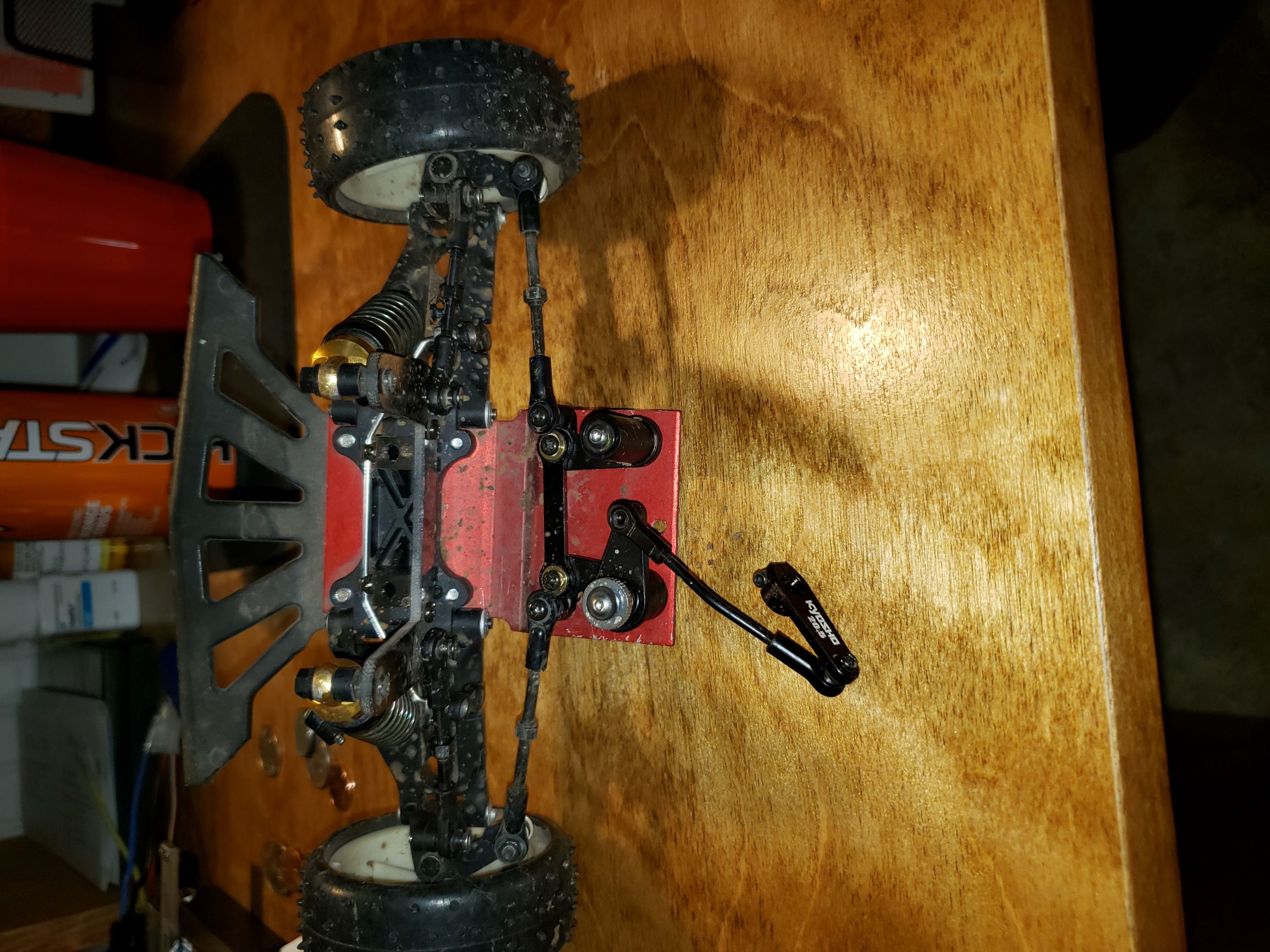

As for the Aluminum piece up front where the steering bolts up to?? I think I will take this to a Sheet Metal shop and see it they can Bend/Make me two or three of them or see if they
can be made out of titanium if the cost is not that high!
Oh if you do this carbon fiber work at home?? DO NOT USE A AIR NOZZLE TO BLOW THINGS OFF!!!!!!!!
when done take off your work clothes and put them in the washer then shower!!!
When I was all done! I went to wash my hands and looked into the mirror and dam even using just the carbide bit black carbon was all over my face and neck!!!
Safety First!!!!
