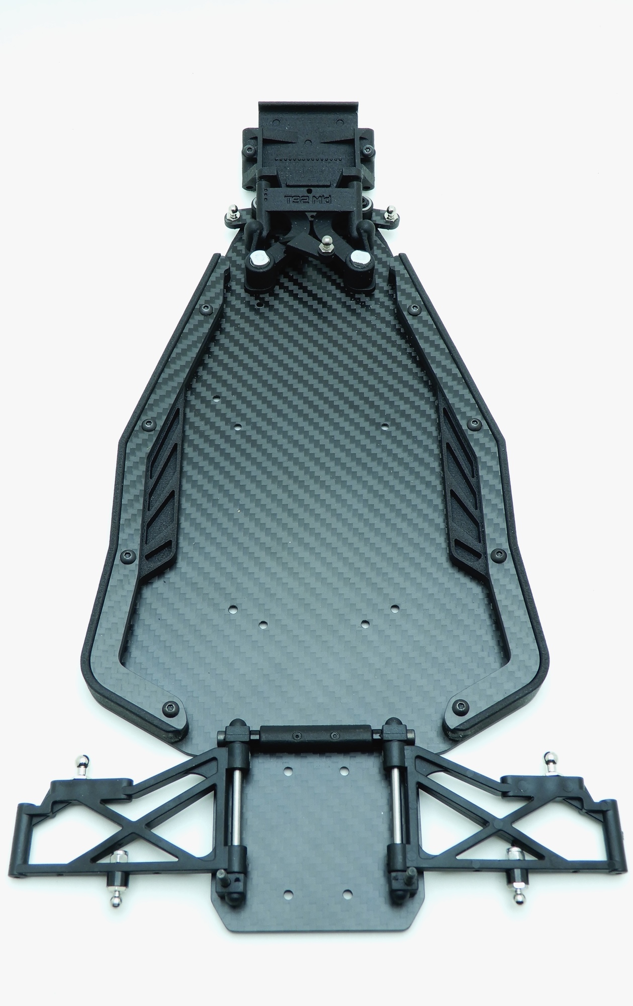

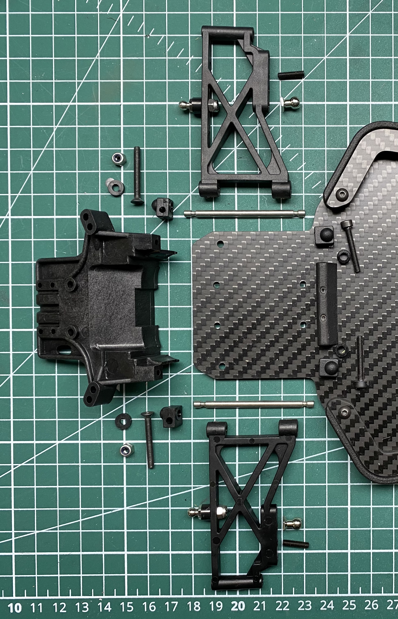

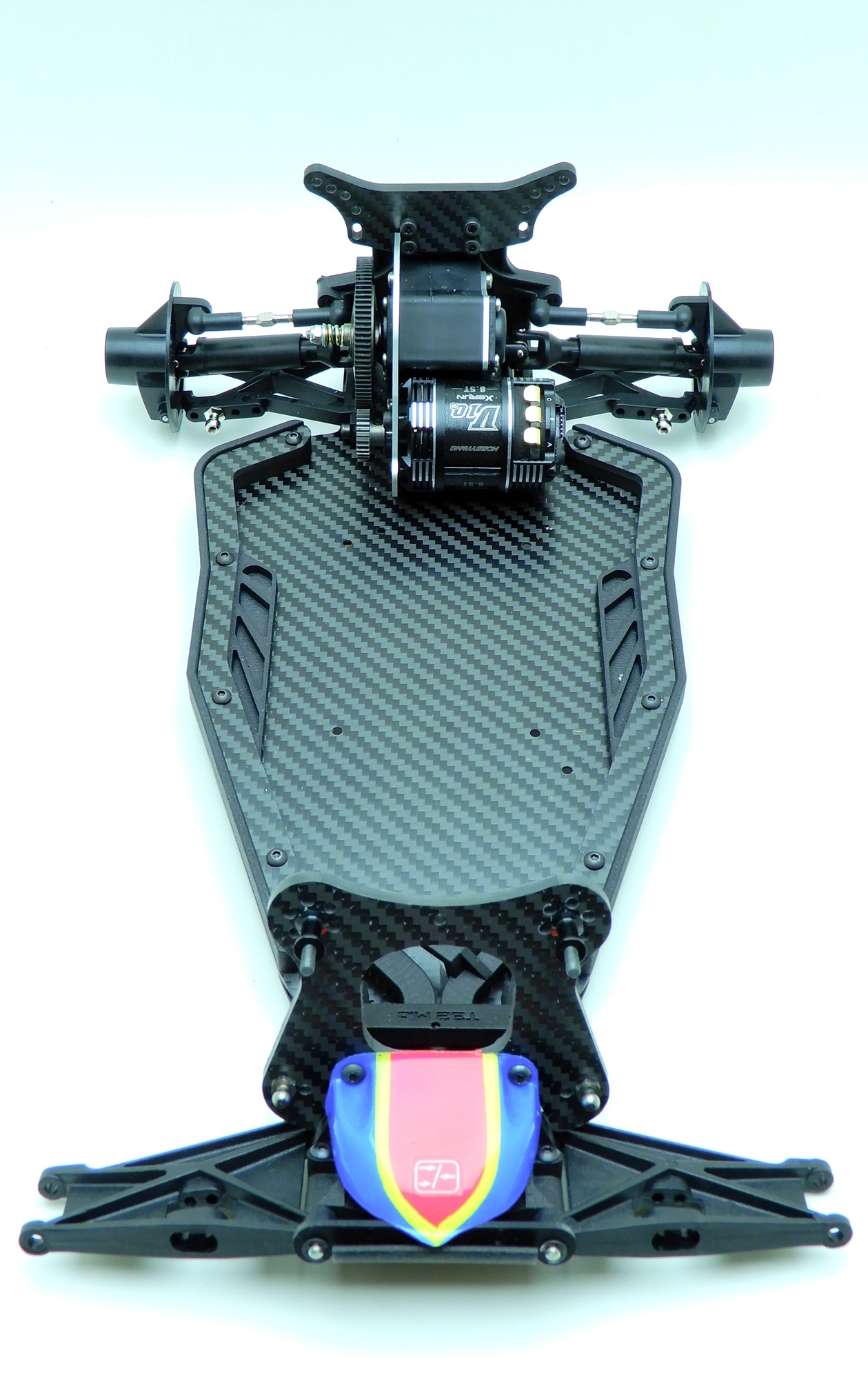

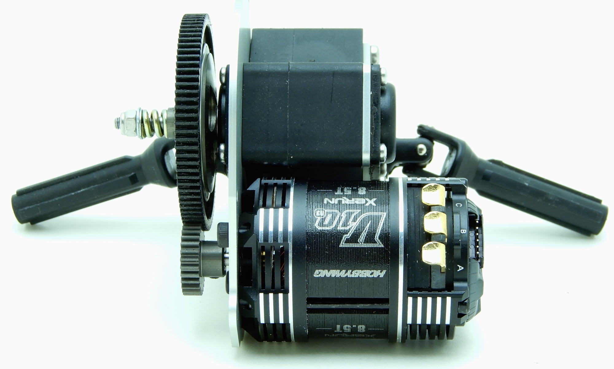

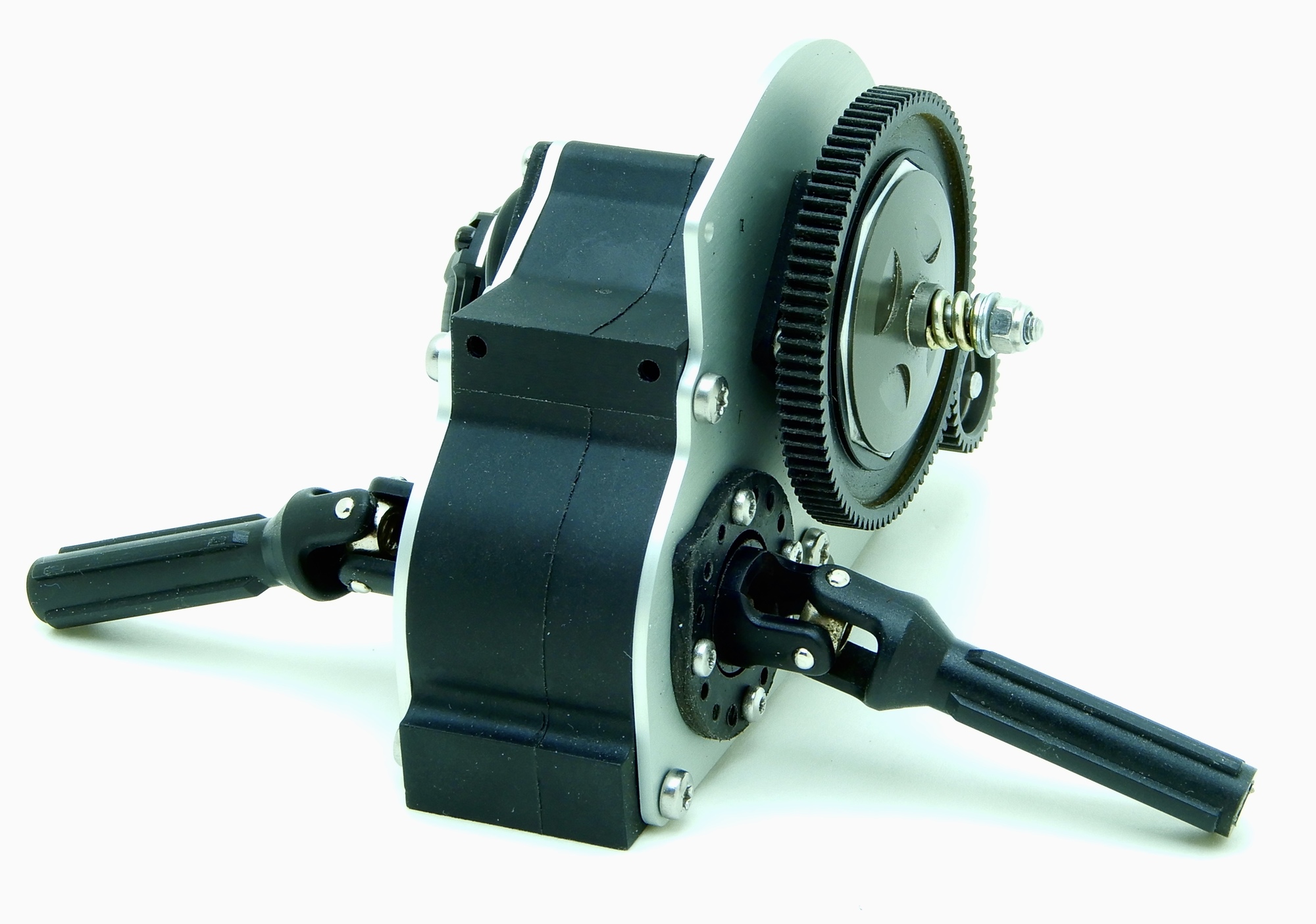

First part build.
Using the Pro Trans, pinion 23 and spur 89
Motor will be the Hobbywing V10 8.5T
Hard anodized the side plates in plain matt finish.

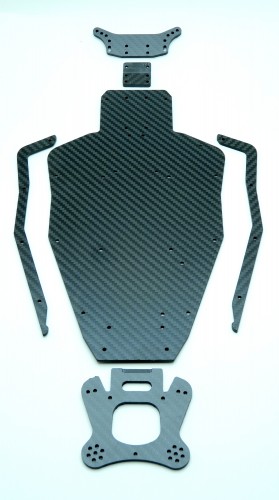

Post by Djerk »

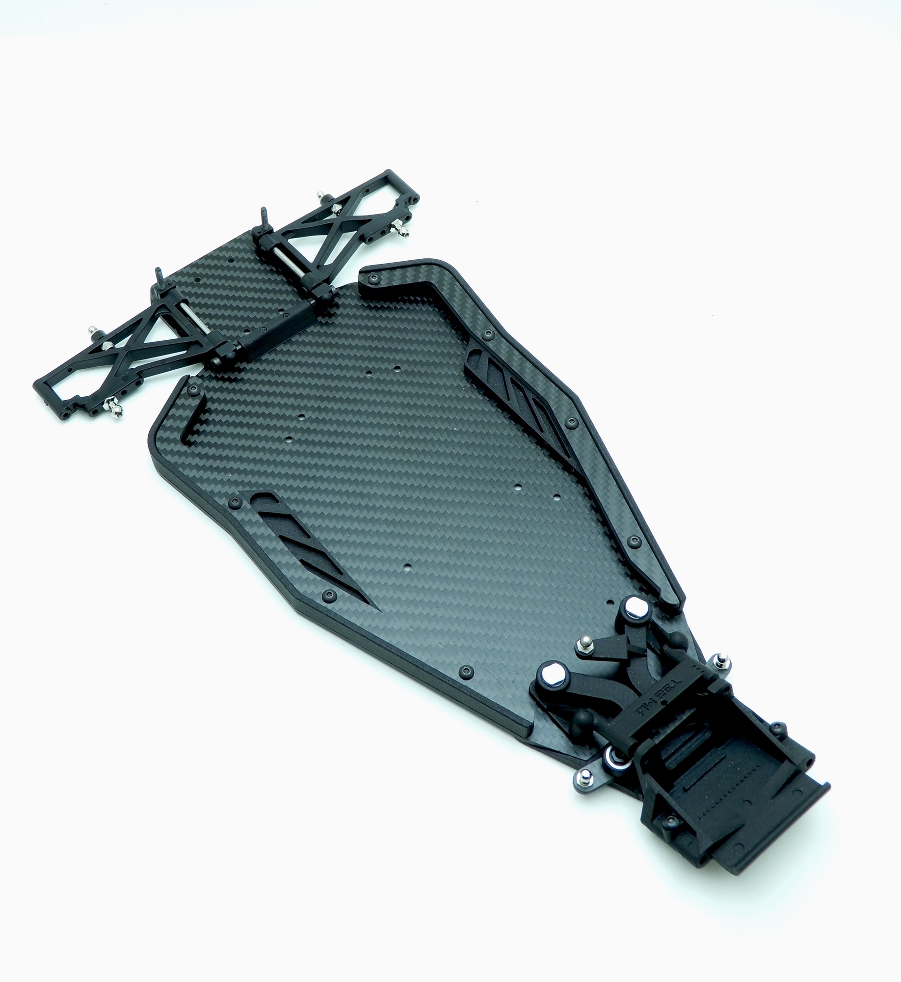

Carbon fiber parts and 3D printed parts all together.
Assembly can begin!

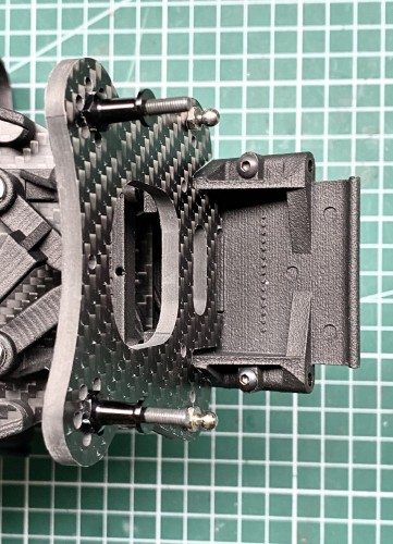

Post by Djerk »

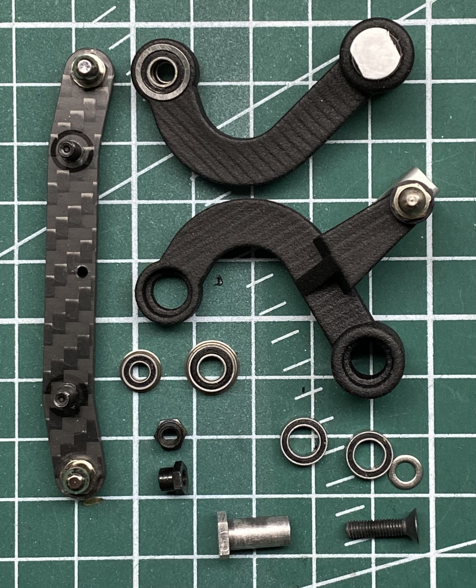

Putting the front end together.
New designed ballrace steering system.
8 bearings inside, original steering posts, carbon Ackerman.

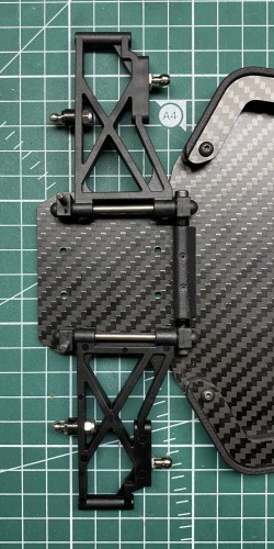

Post by Djerk »

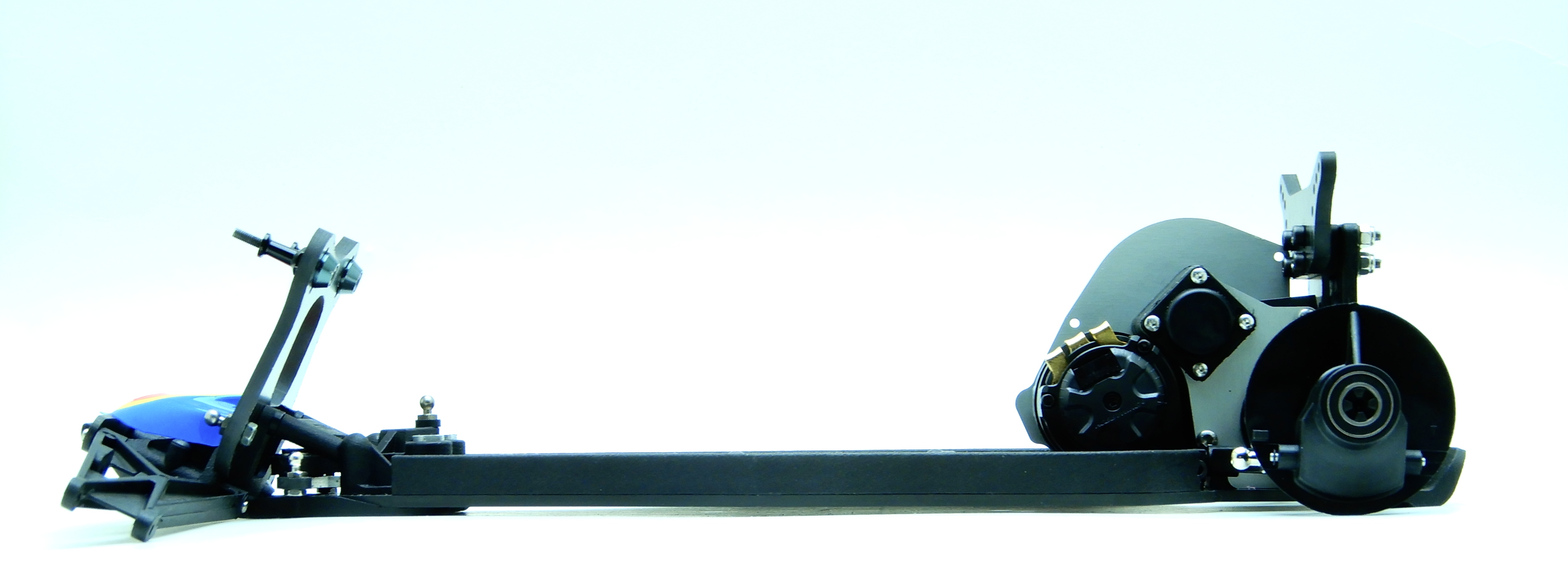

Building the rear end.
Created an easy way to adjust toe inn-out and Antisquad.
Using all original Schumacher parts for suspension.
Djerk

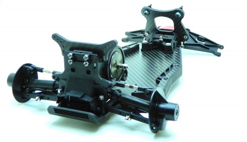

Post by Djerk »

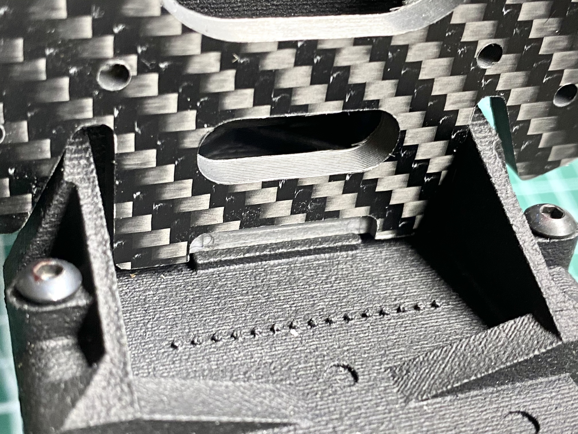

Getting the transmission on, building the rear shock tower and placed them on the chassis.
(Rear tower will be adjusted, needs a new design).

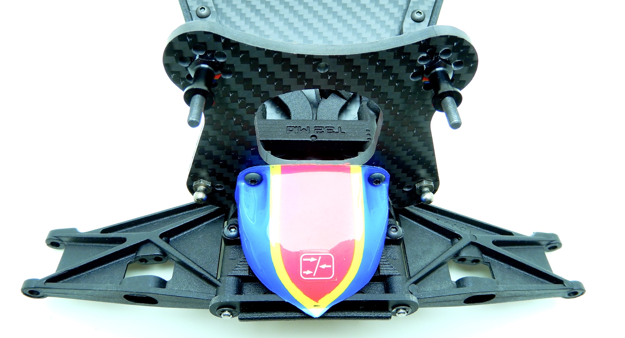

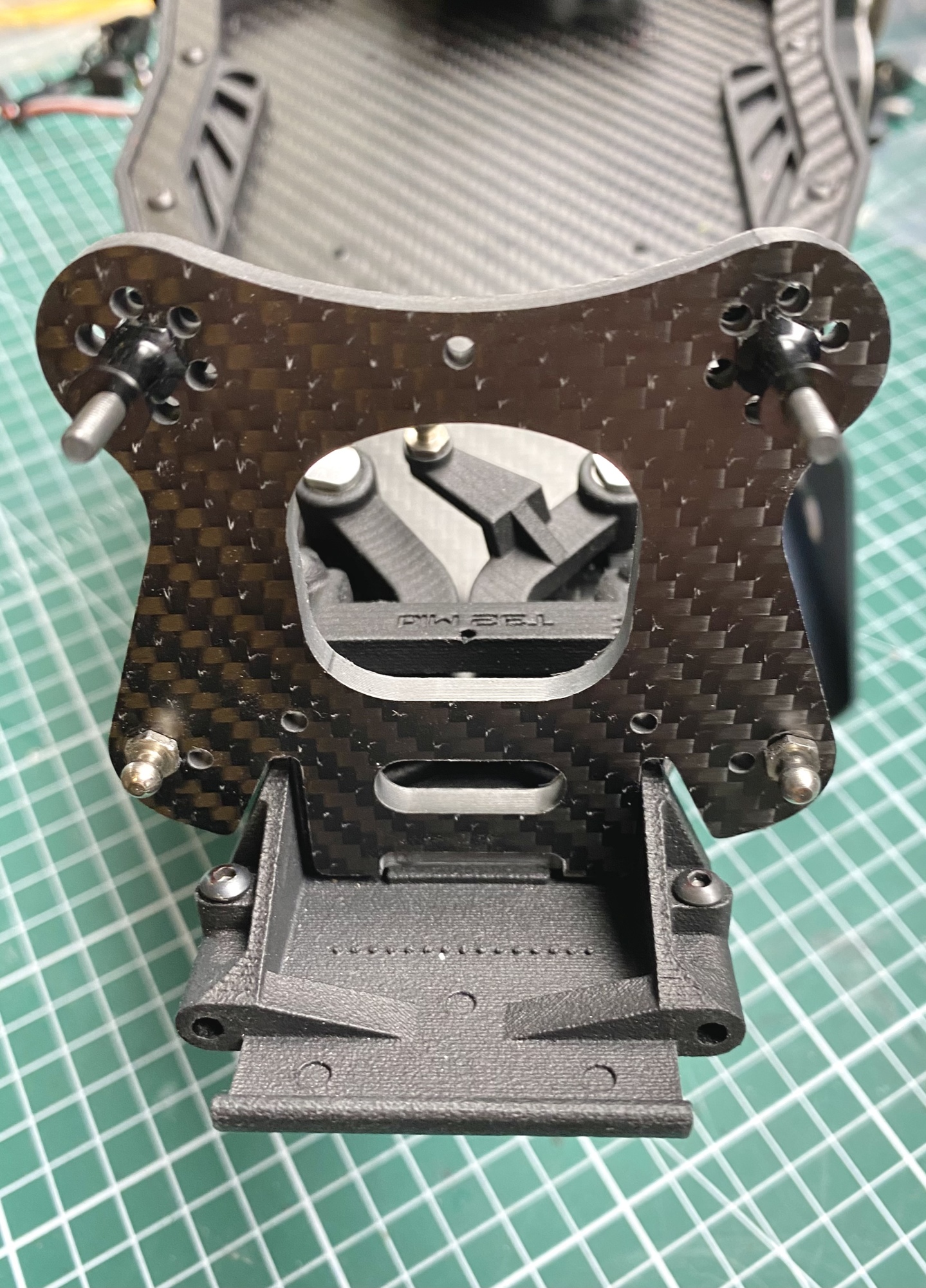

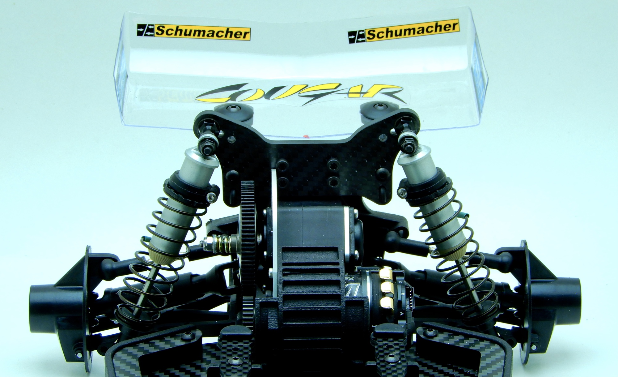

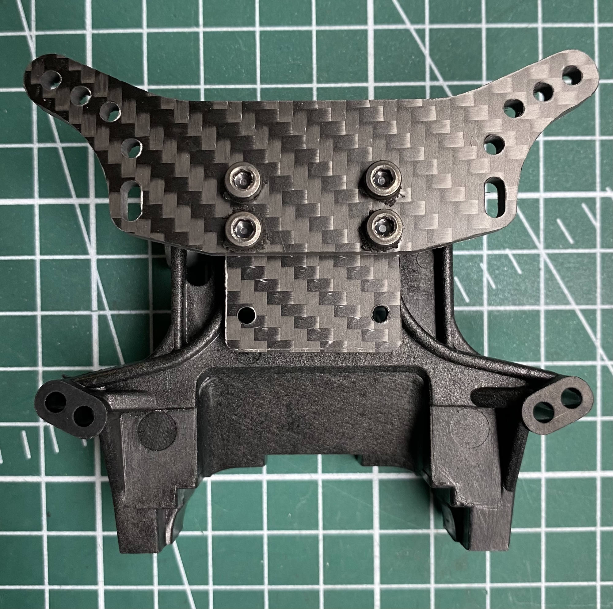

Mounted the new front shocktower.
4mm carbon, and fully adjusted so it will fit the original (U322) front plate too.
Djerk

Added most of the NIB suspension parts.
Still need to tweak some things, but close-as for now.
Also you have a sneak preview of the paintsceme on the nosecone... ☺️

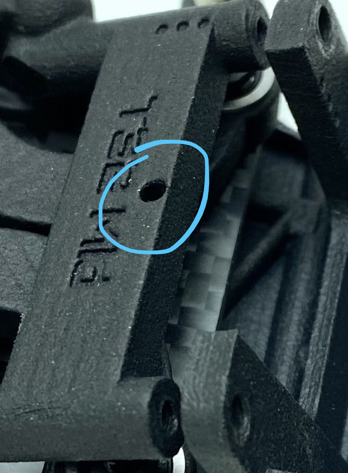

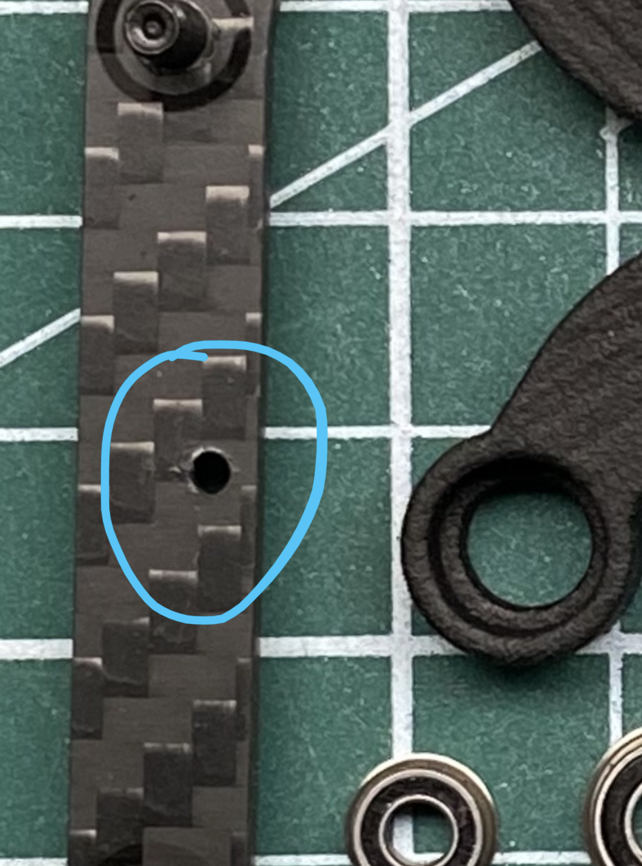

Just a minor little detail on the Sunday afternoon...

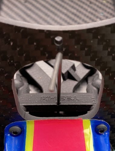

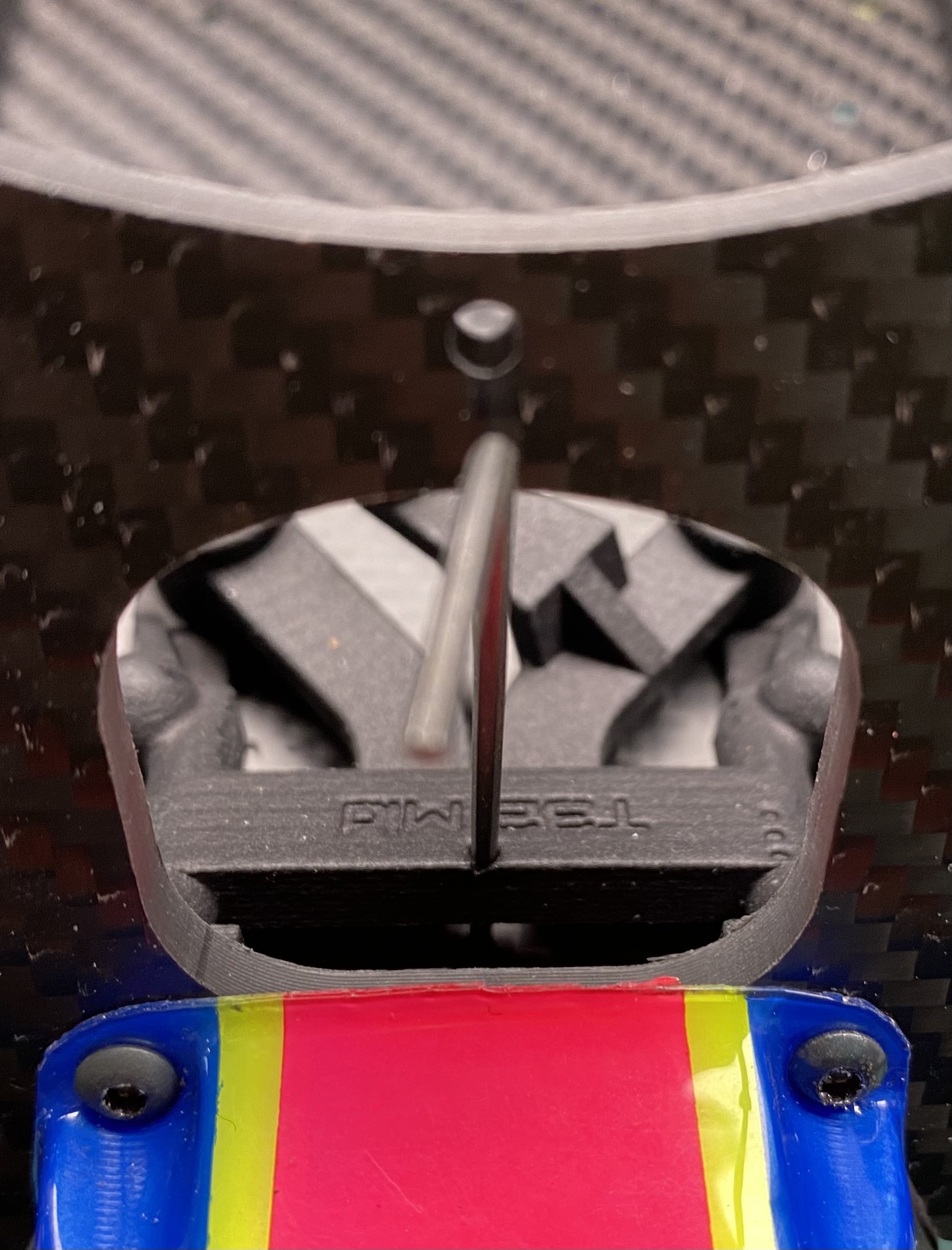

My friend Marshky came up with an idea when CAD designing the front end (which other brands do..).
Put some holes in the Ackerman, and brace, make a reference hole in the tower... so you can easily set up the middlepoint of the steering.
Smart, easy, simple!

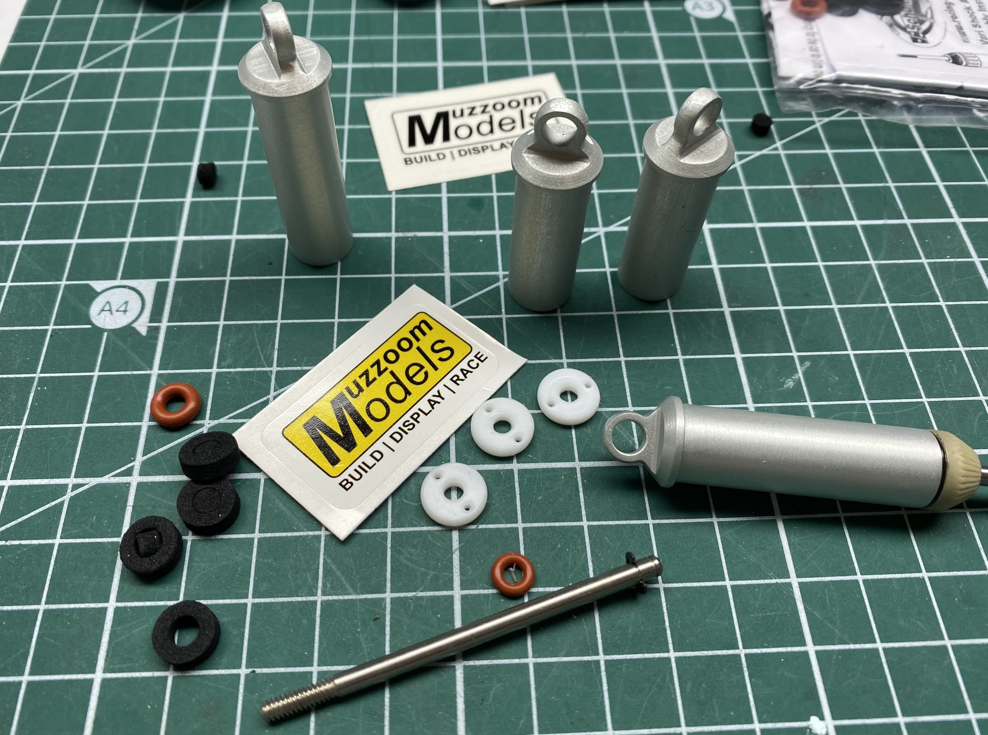

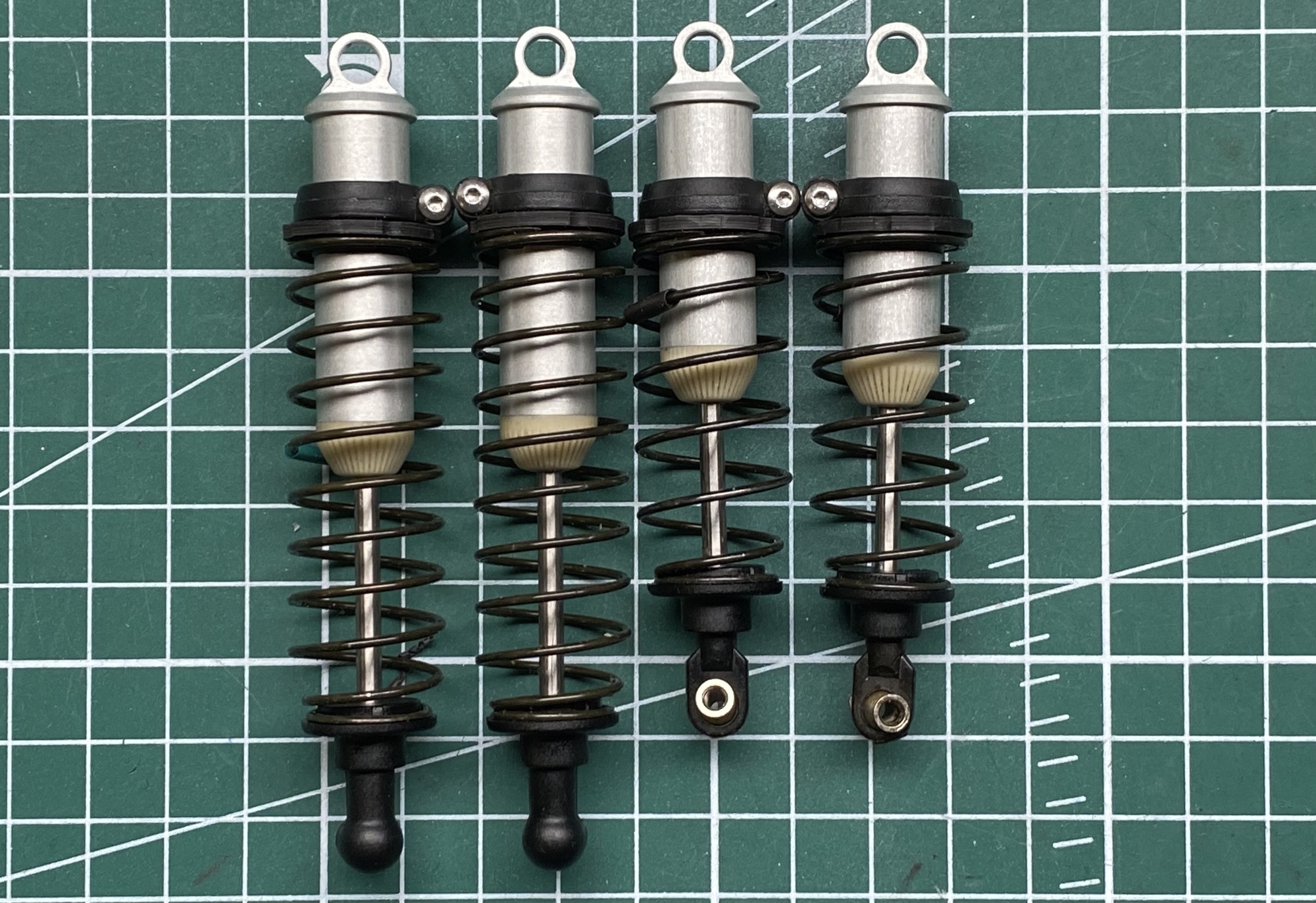

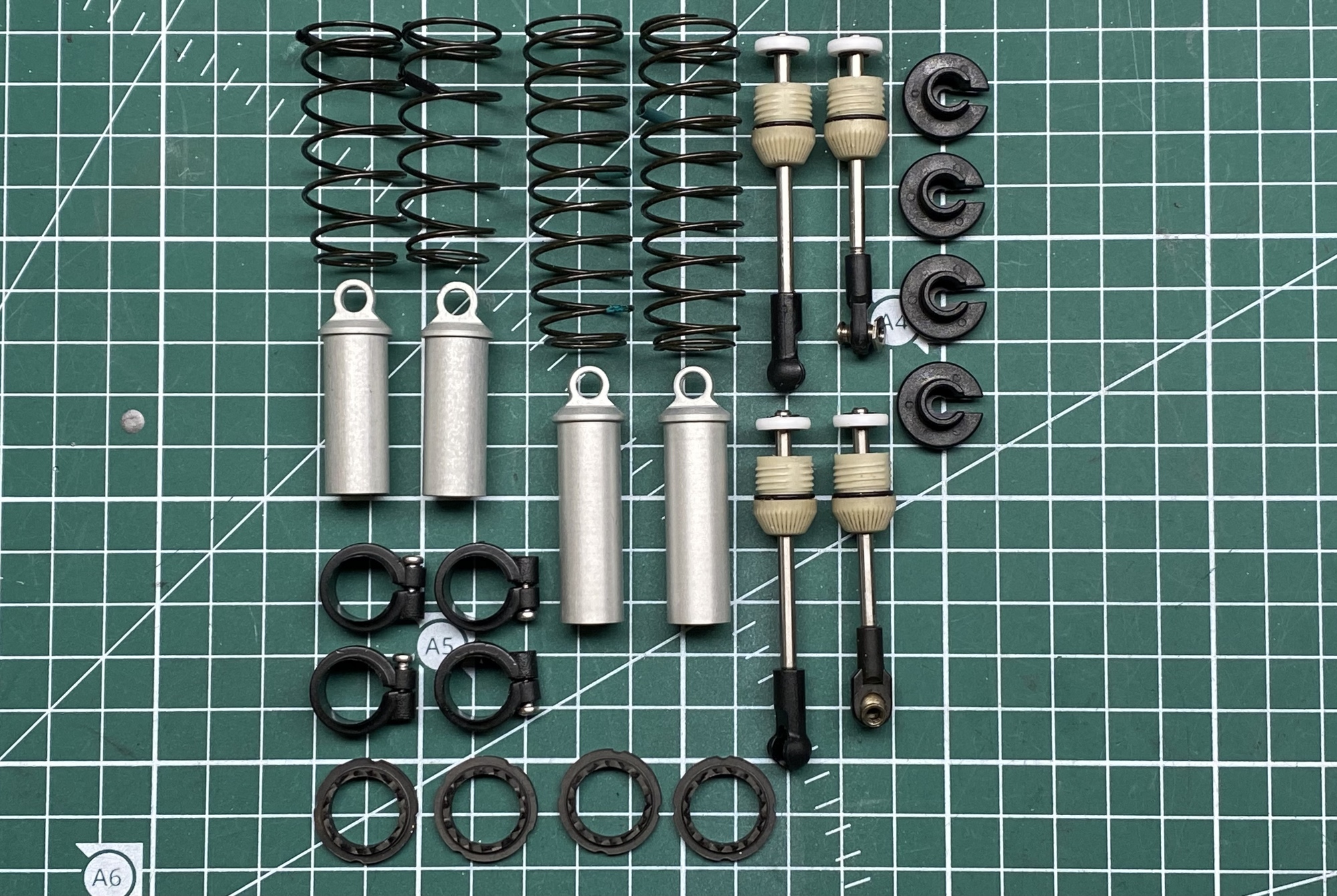

Rebuild the Vari-shocks.
The shocks have been re-anodized, so that all aluminum parts on the build have the same color.
Used the Muzzoom Models Motorsport teflon pistons (2 holes).
All new seals, and new shock shafts.
Went for the bigbore springs on this one, and they look pretty cool i must say!

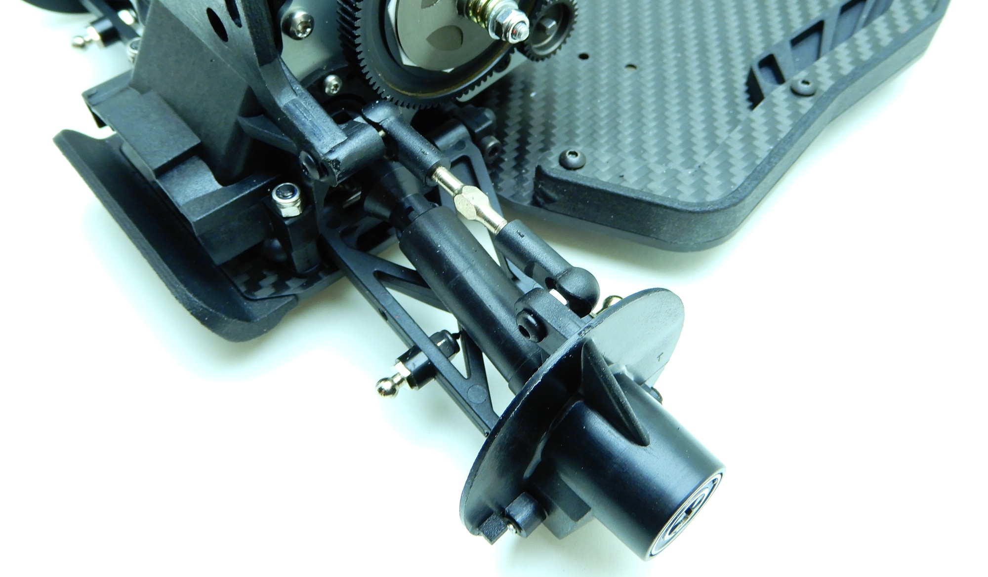

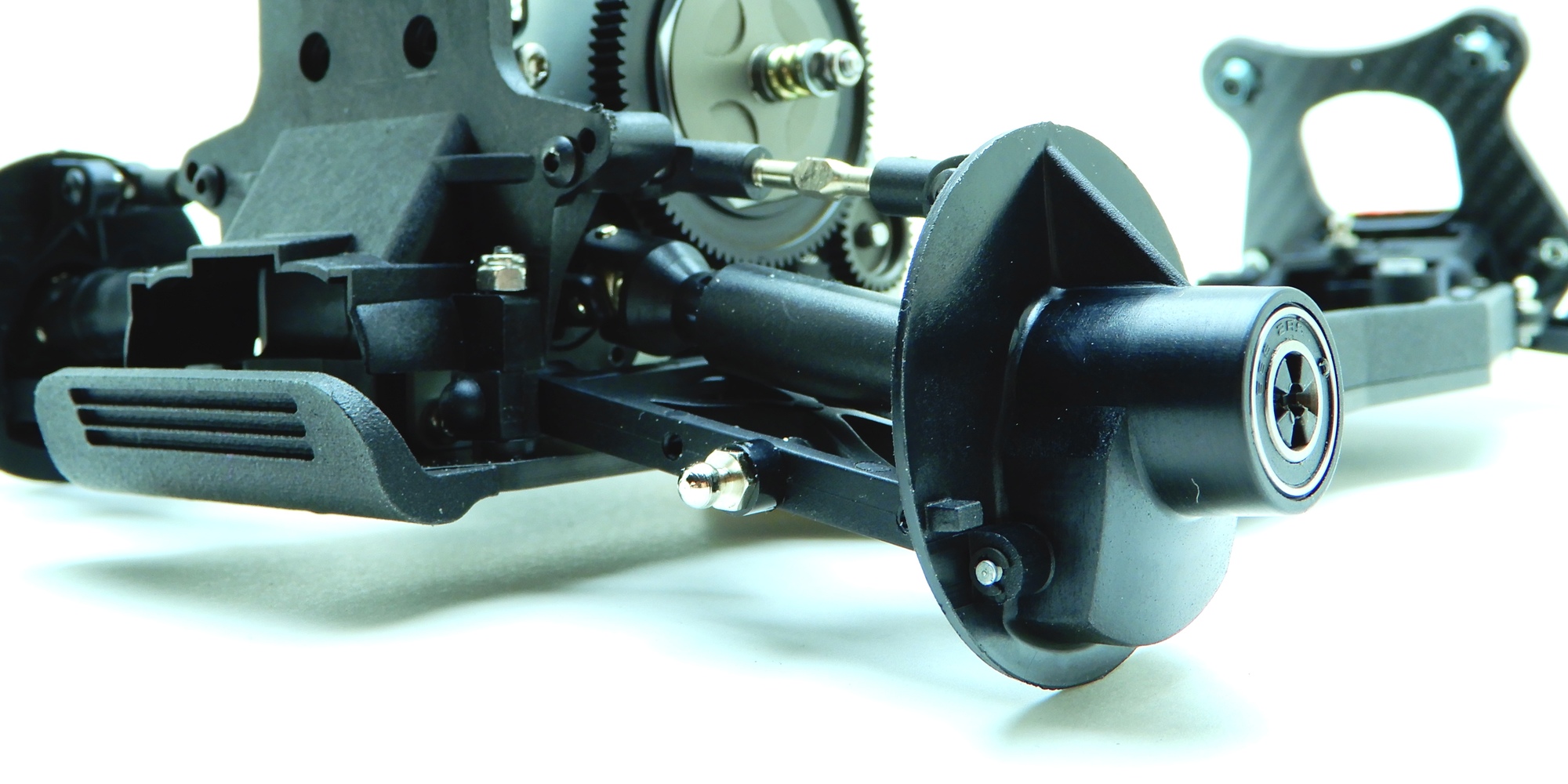

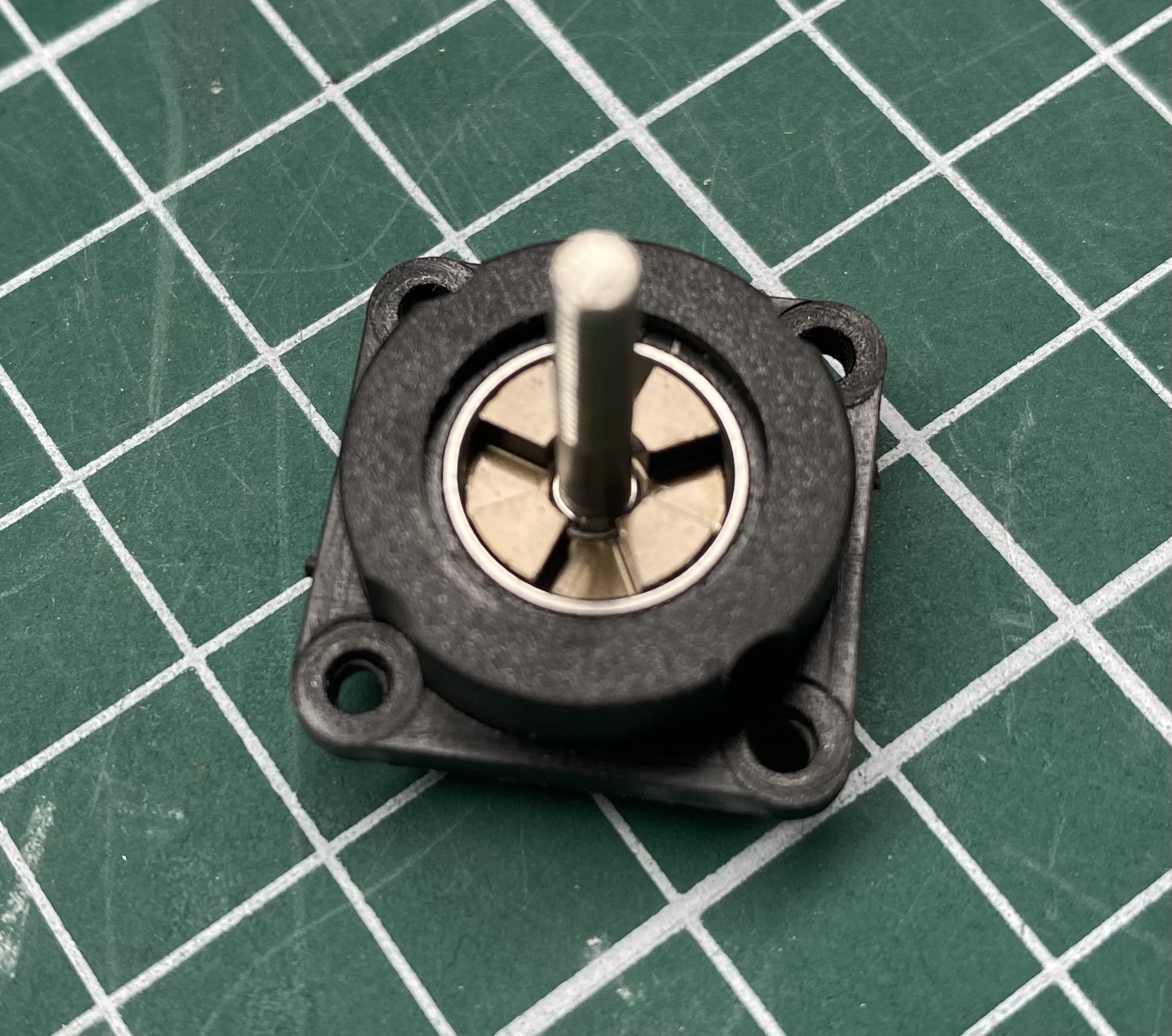

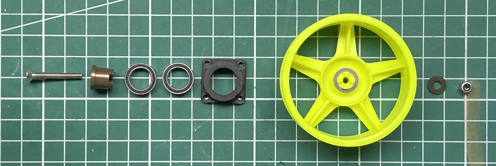

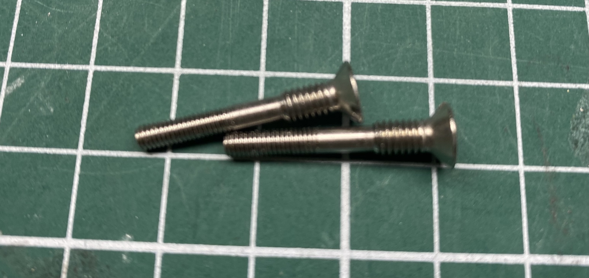

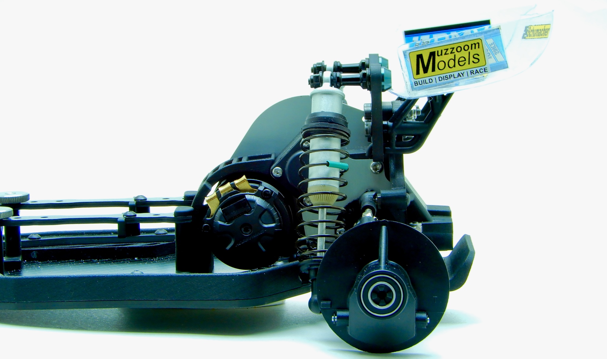

Right... this is something i always wanted back in the day...
Double bearings in the front hubs!!
I used all standard Schumacher parts for this piece of long thinking-engineering... haha.
Not sure how it will work when racing, but i like the feel how it came out.
10mm alloy castle axles
2 bearings
Squeezed a 3mm o-ring in the wheels
Milled a stainless axle shaft to fit the 10mm caste axles
Used a washer to get rid of the play
In the end, it feels very solid, and no play left.
When testing we will see how it works! Haha.

Post by Djerk »

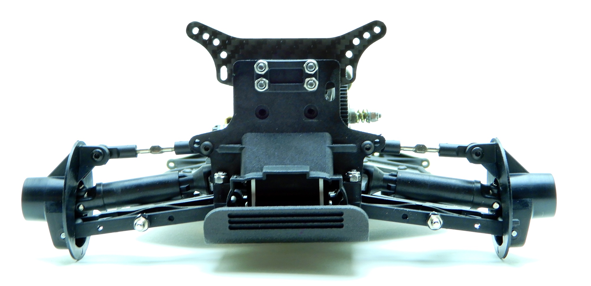

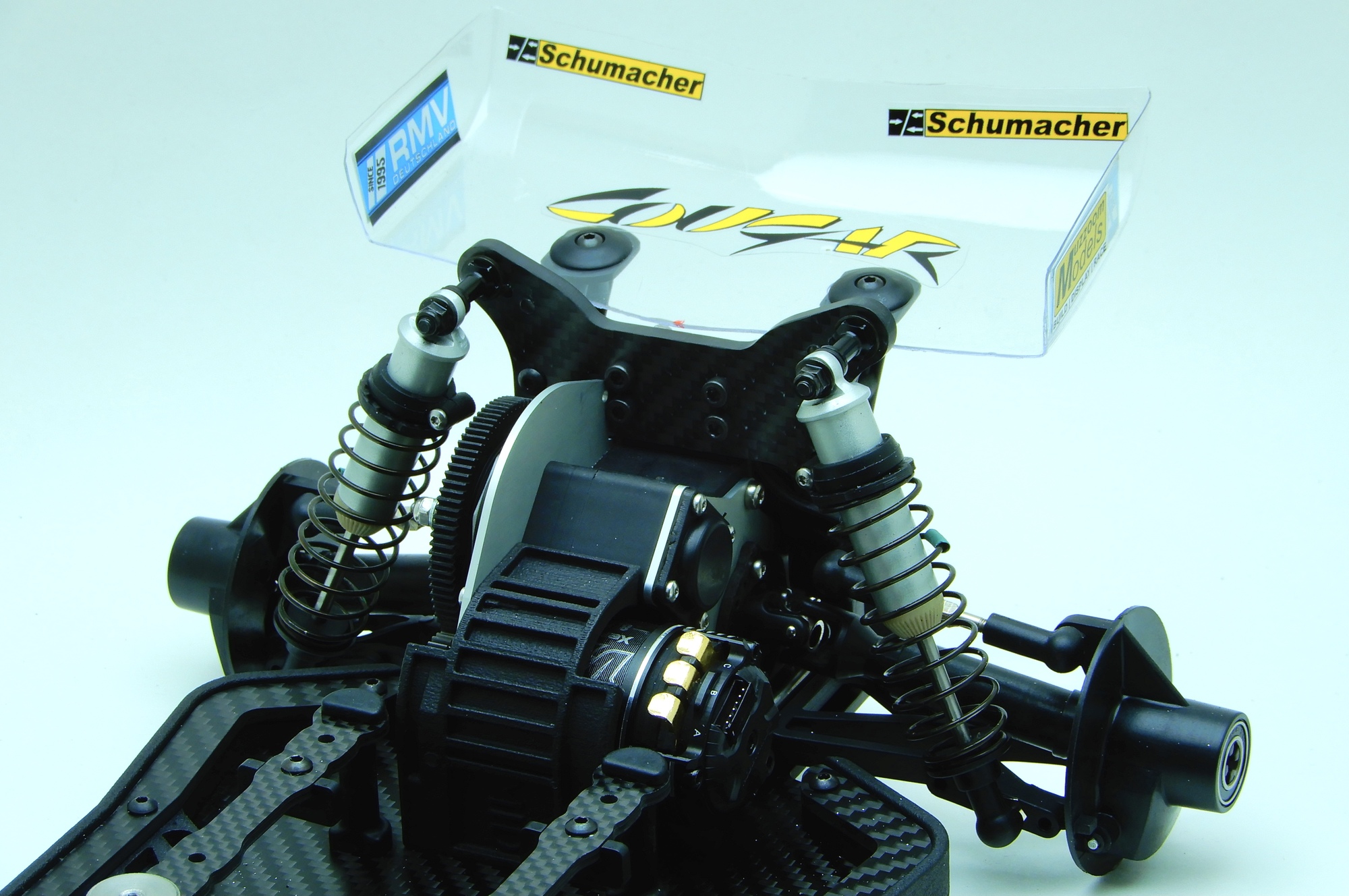

Today finally the postman arrived with the new designed rear shocktower!
So, mounted it, and finished almost the whole rear end.
Together with the carbon milled washer plate, the whole rear bulkhead, and carbon shock tower is realy solid. Pretty happy about how it came out, plus the way it looks.
The Schumacher wingmounts are positioned as low as possible, to create a really streamlined appearance.
Fitted the rear shocks, and all fits nicely!
What do you all think?
