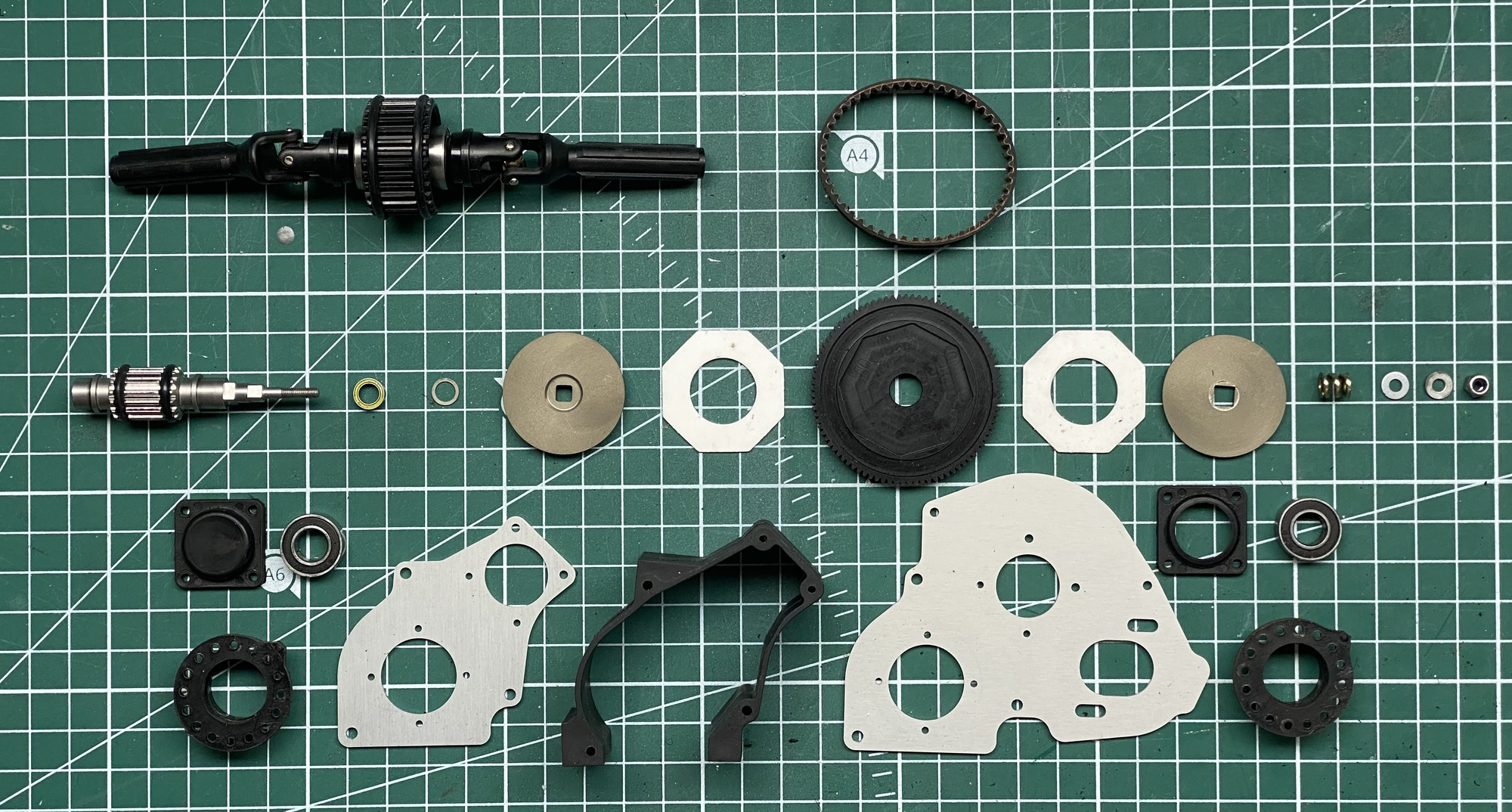

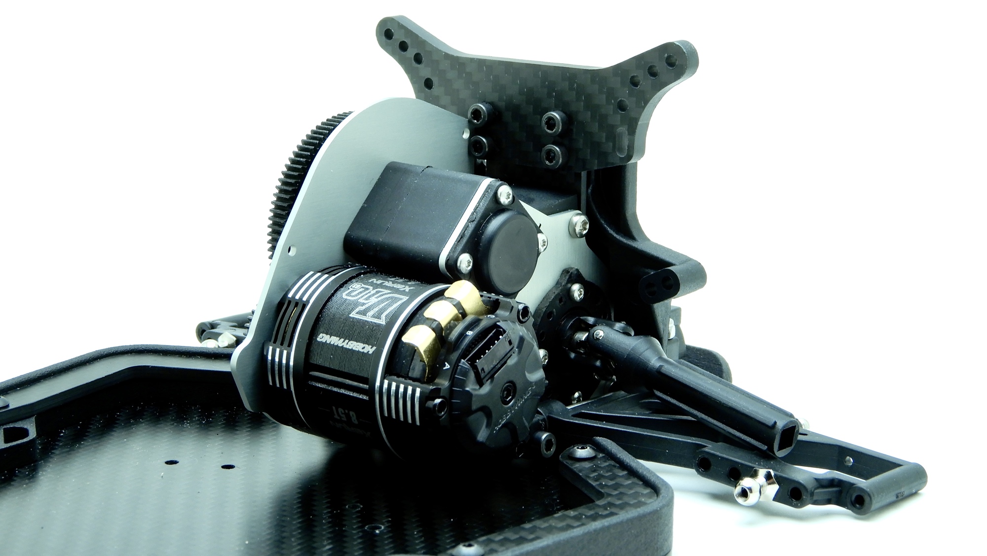

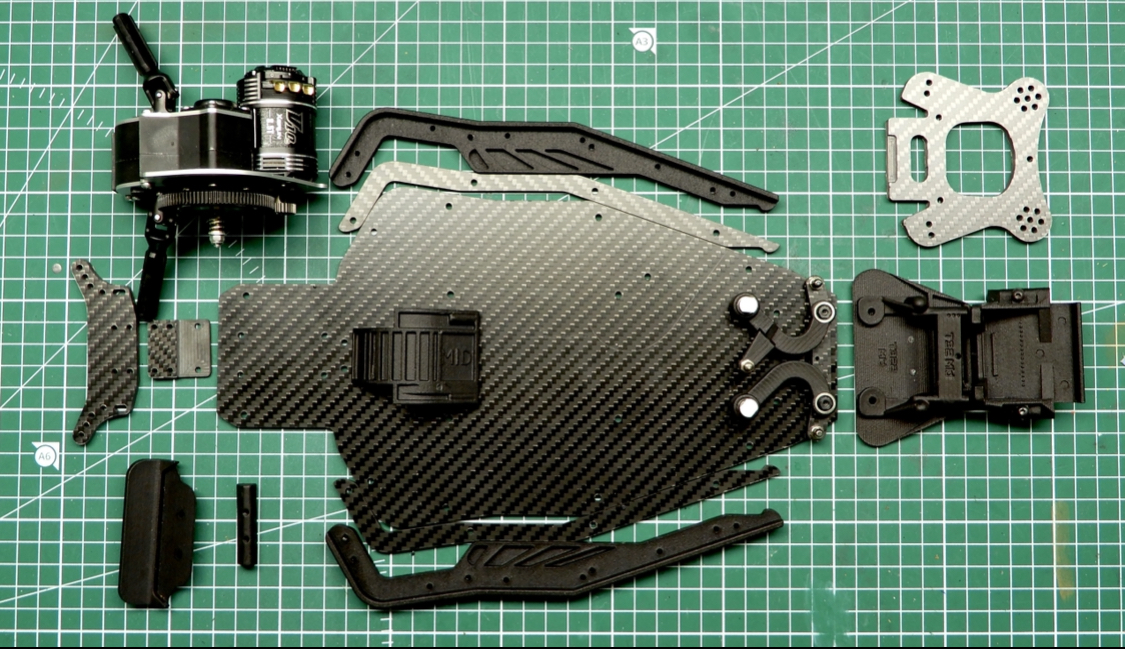

First part build.
Using the Pro Trans, pinion 23 and spur 89
Motor will be the Hobbywing V10 8.5T
Hard anodized the side plates in plain matt finish.

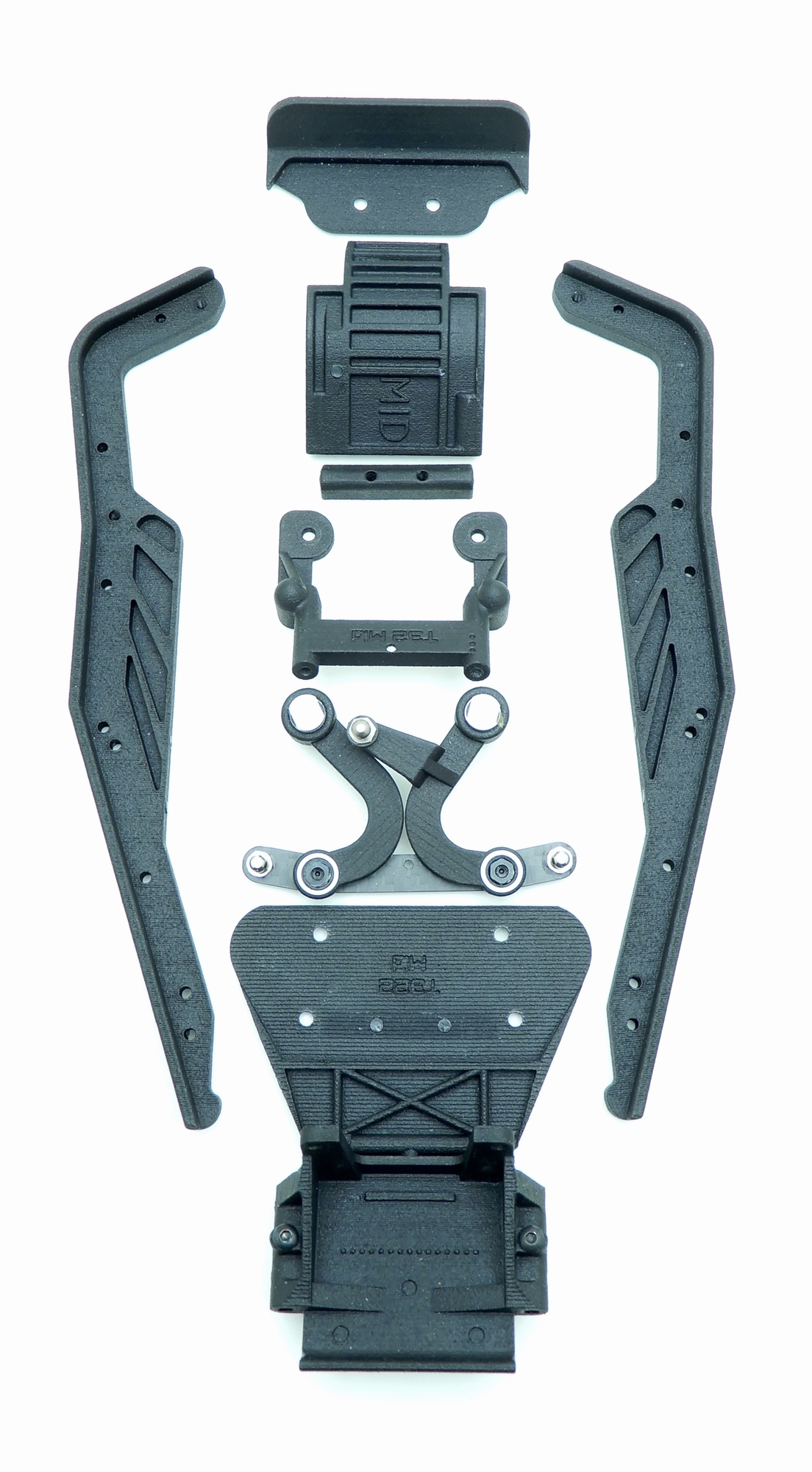

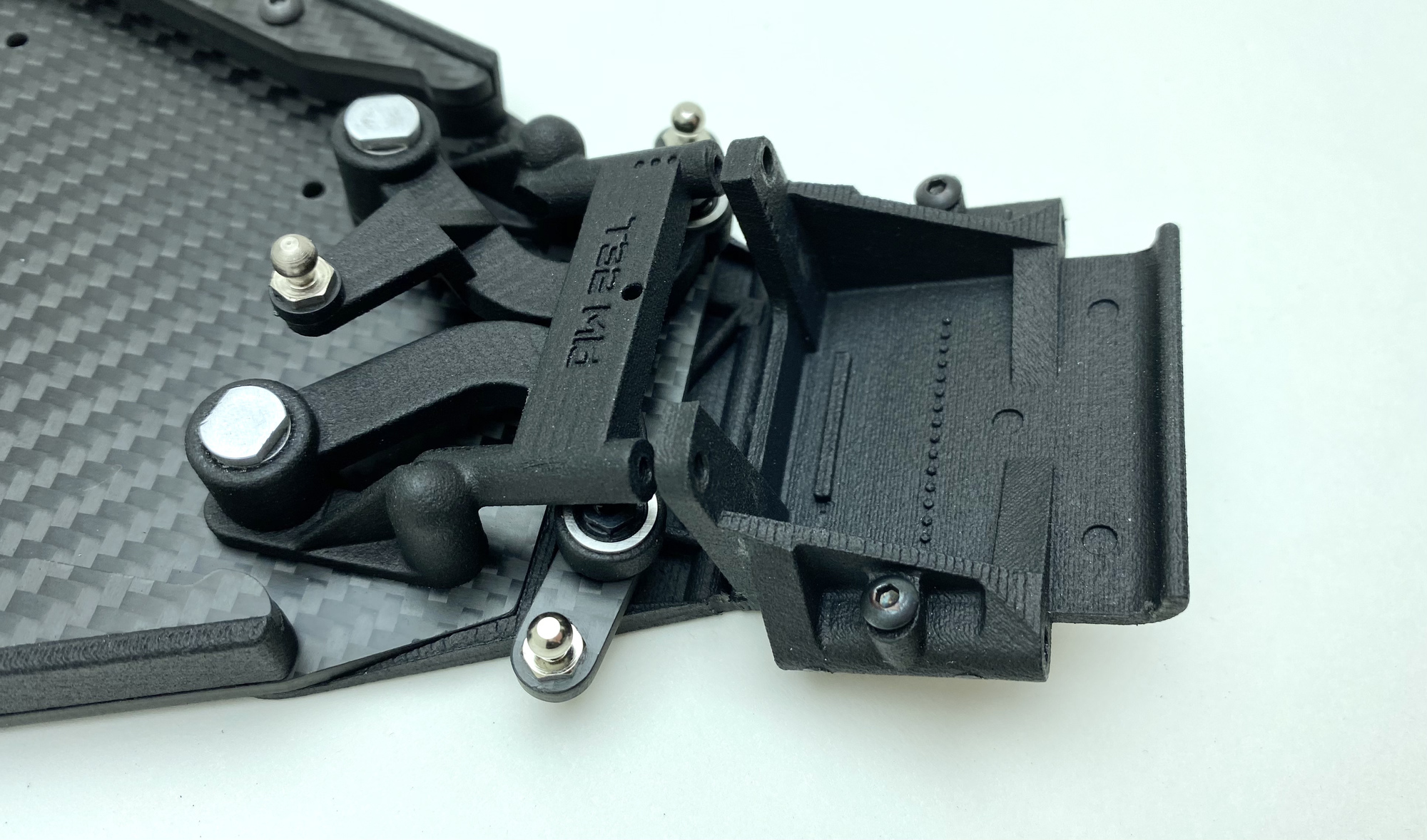

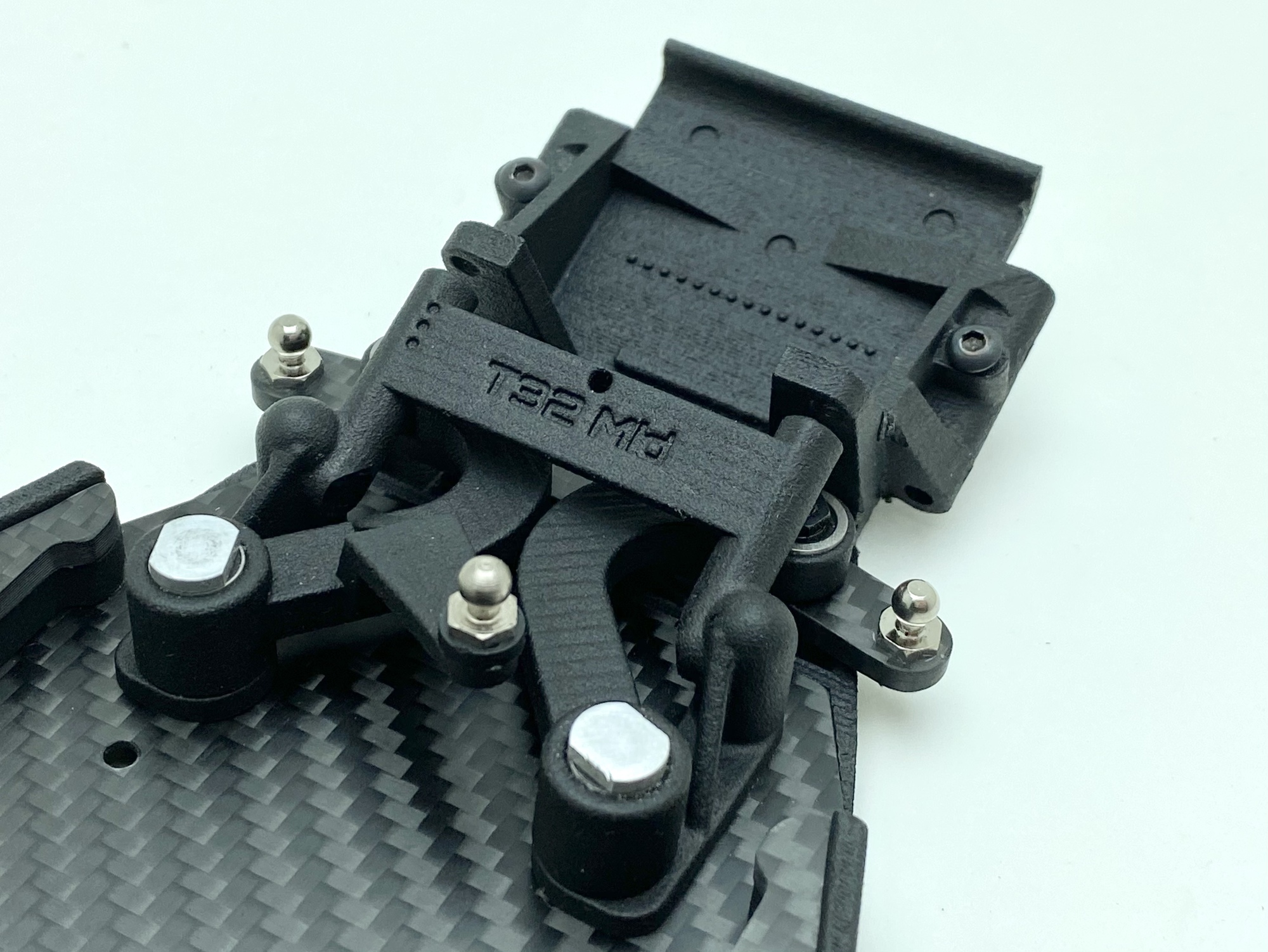

Putting the front end together.
New designed ballrace steering system.
8 bearings inside, original steering posts, carbon Ackerman.

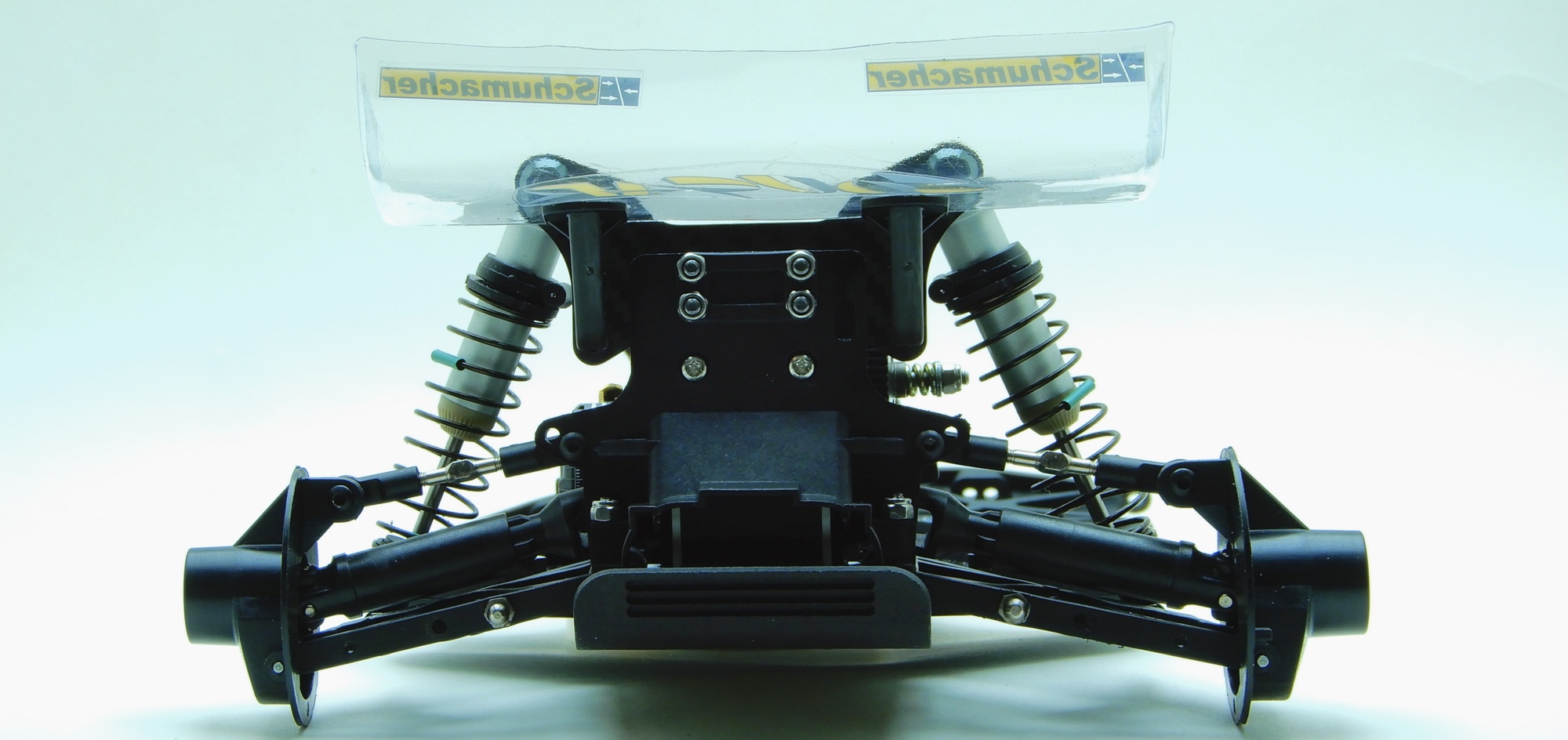

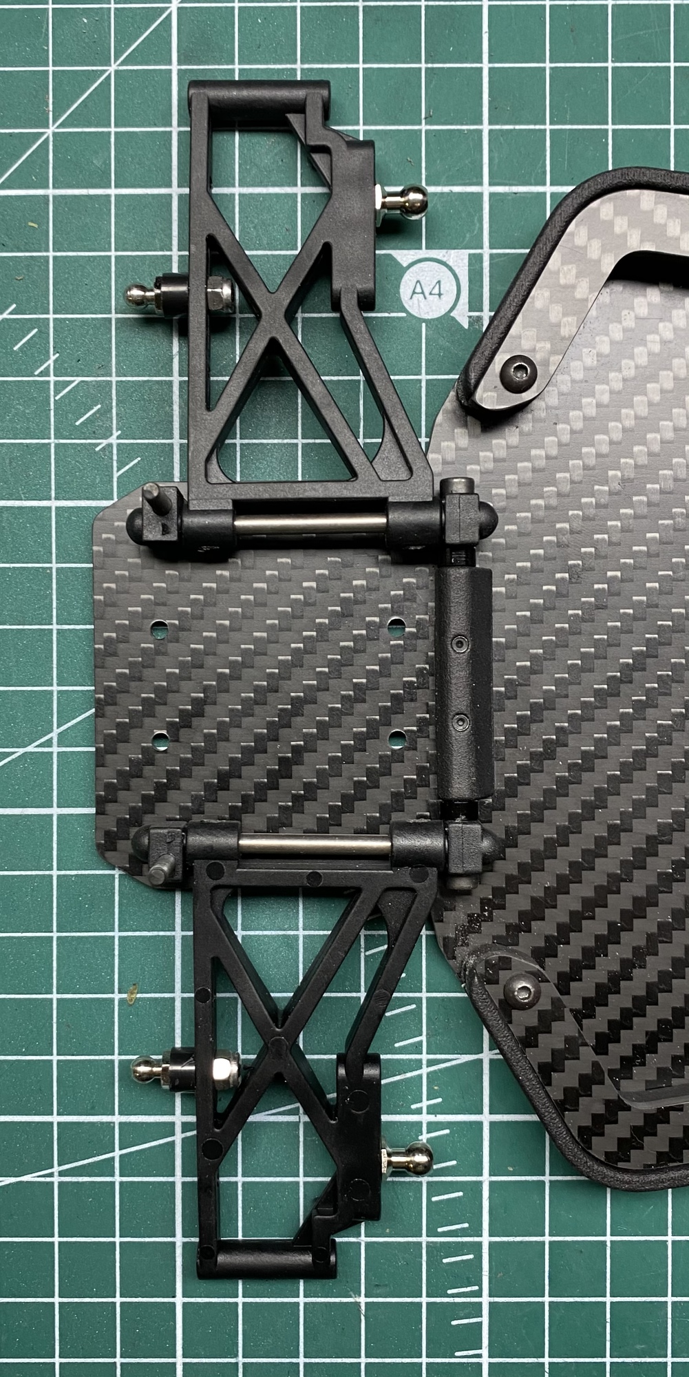

Building the rear end.
Created an easy way to adjust toe inn-out and Antisquad.
Using all original Schumacher parts for suspension.

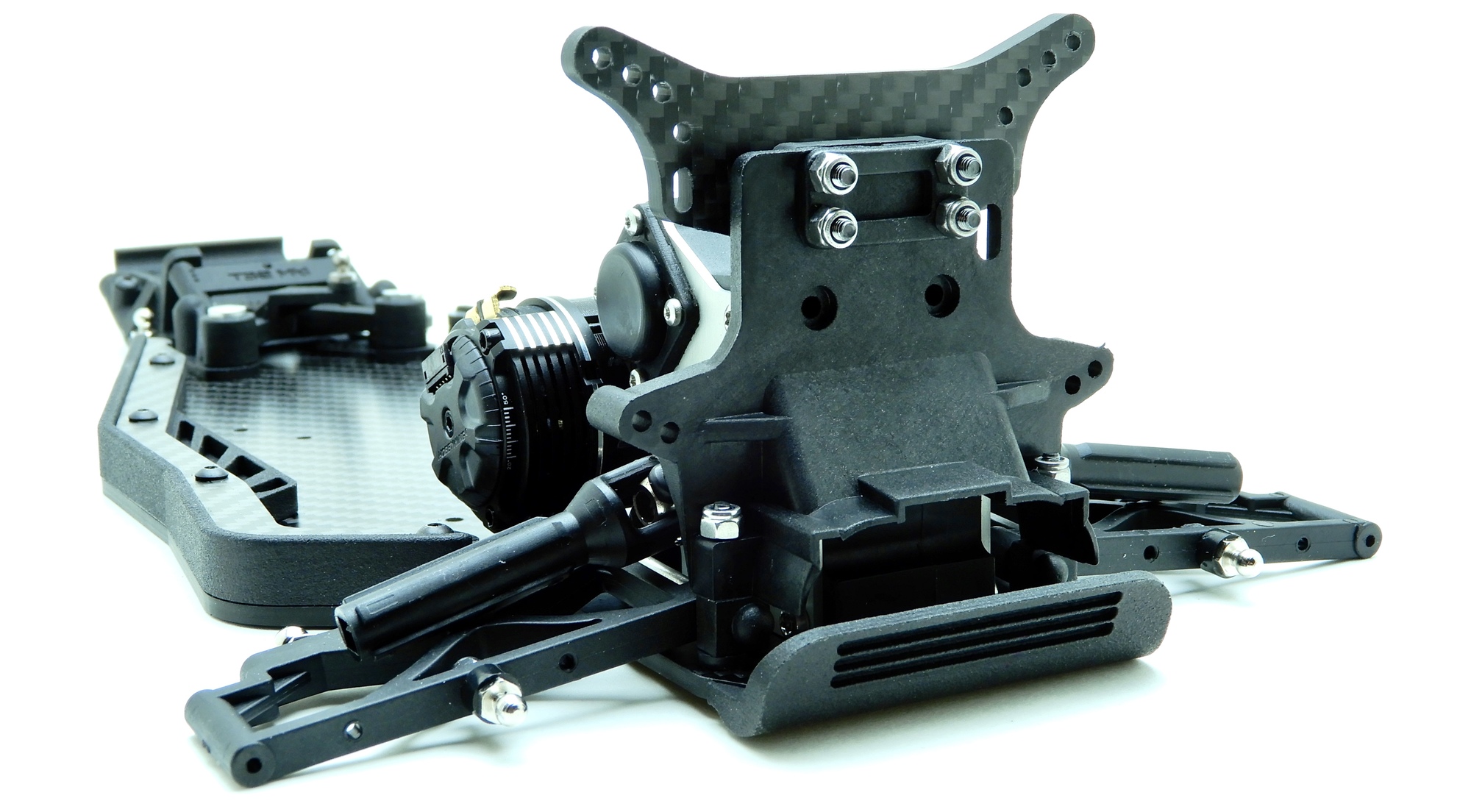

Re: DSPPC EXP3 MID kit Cougar
Getting the transmission on, building the rear shock tower and placed them on the chassis.
(Rear tower will be adjusted, needs a new design).

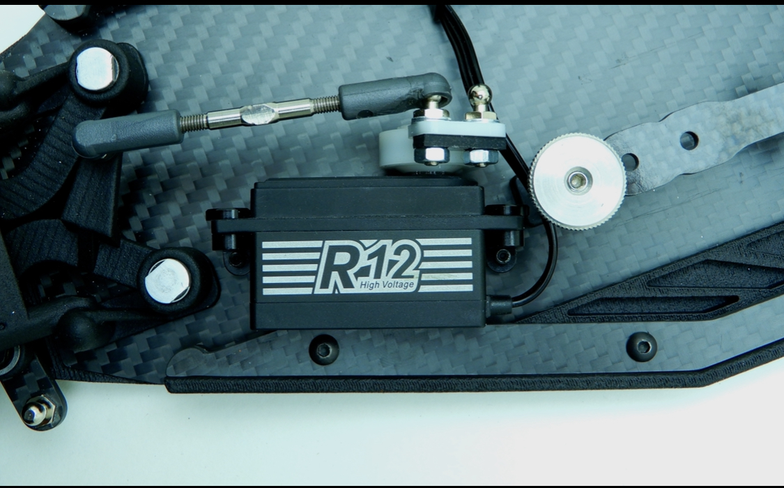

Just a minor little detail on the Sunday afternoon...
My friend Marshky came up with an idea when CAD designing the front end (which other brands do..).
Put some holes in the Ackerman, and brace, make a reference hole in the tower... so you can easily set up the middlepoint of the steering.
Smart, easy, simple!

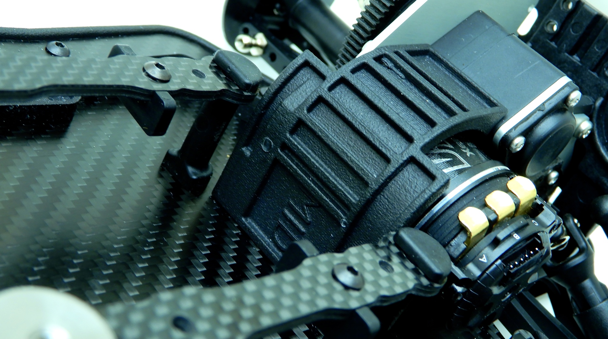

Some tiny updates in between today.
Mounted the waterfall motor guard. This was was needed to stabilize the motorplate. And just looks really nice!
Also mounted the battery straps.
And put the servo in place (the most thight-spot-on-fit ever!)

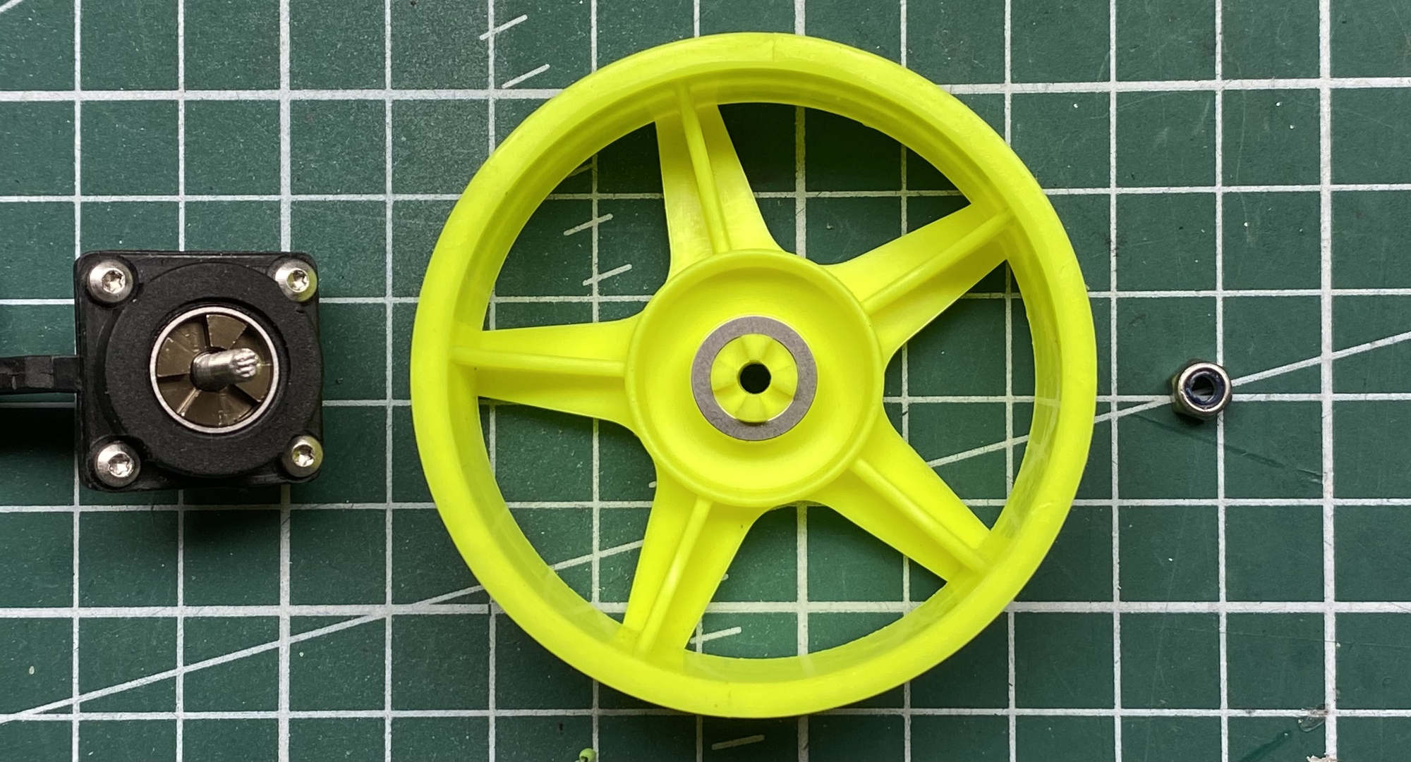

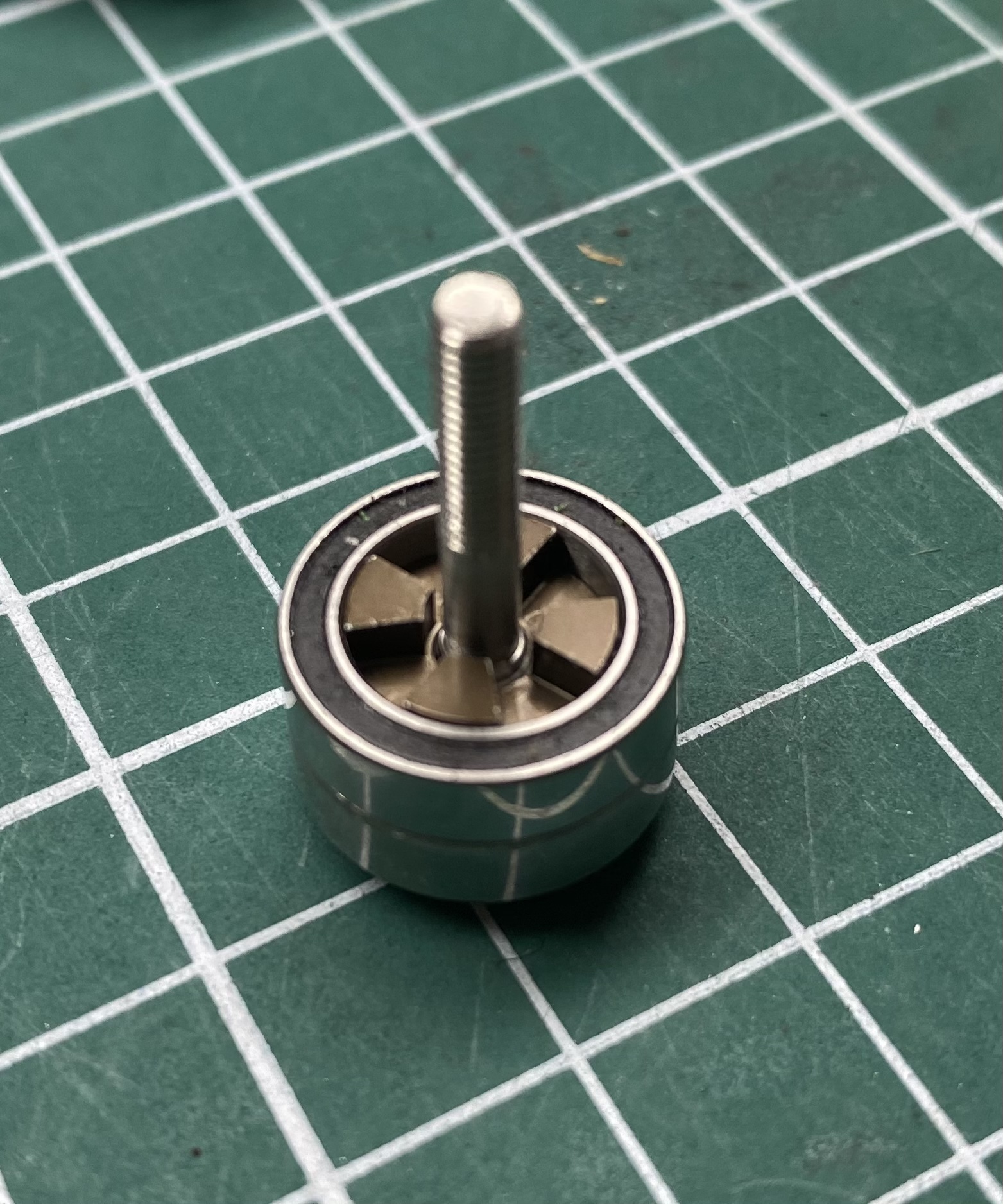

Right... this is something i always wanted back in the day...
Double bearings in the front hubs!!
I used all standard Schumacher parts for this piece of long thinking-engineering... haha.
Not sure how it will work when racing, but i like the feel how it came out.
10mm alloy castle axles
2 bearings

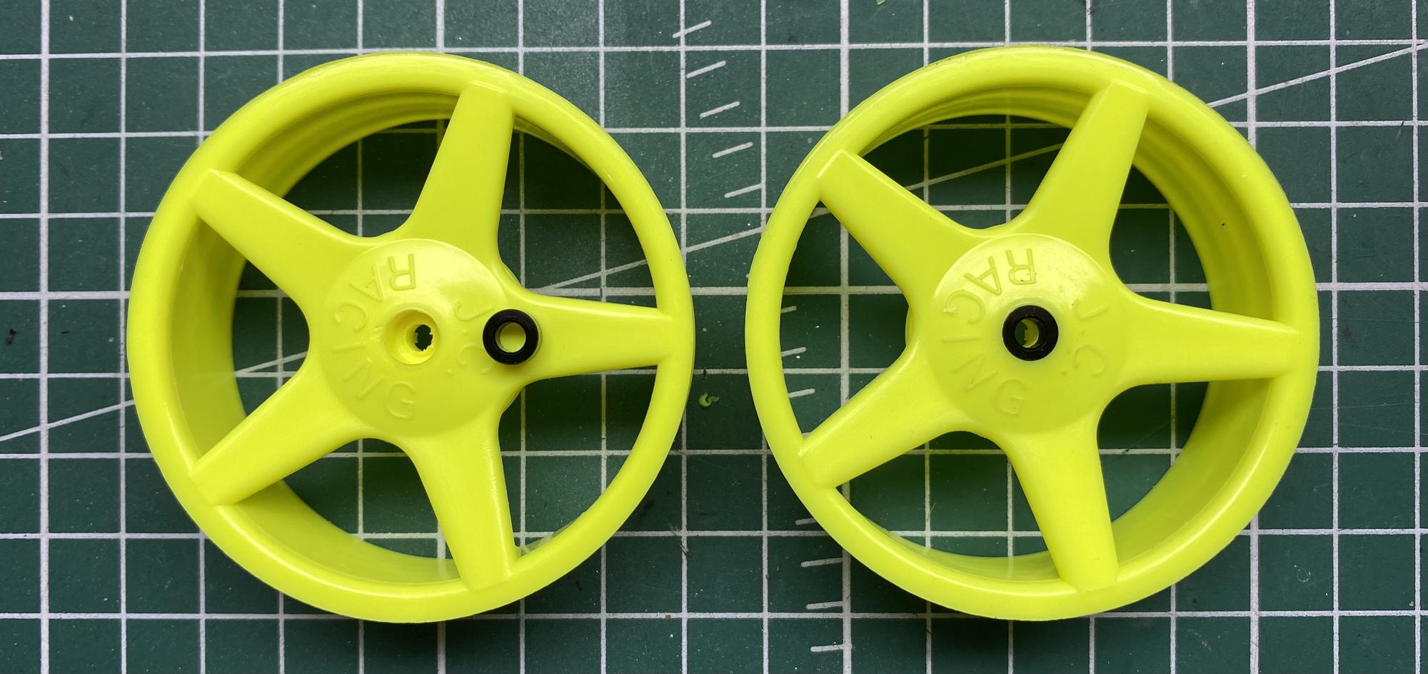

Squeezed a 3mm o-ring in the wheels
Milled a stainless axle shaft to fit the 10mm caste axles
Used a washer to get rid of the play
In the end, it feels very solid, and no play left.
When testing we will see how it works! Haha.
2 bearings

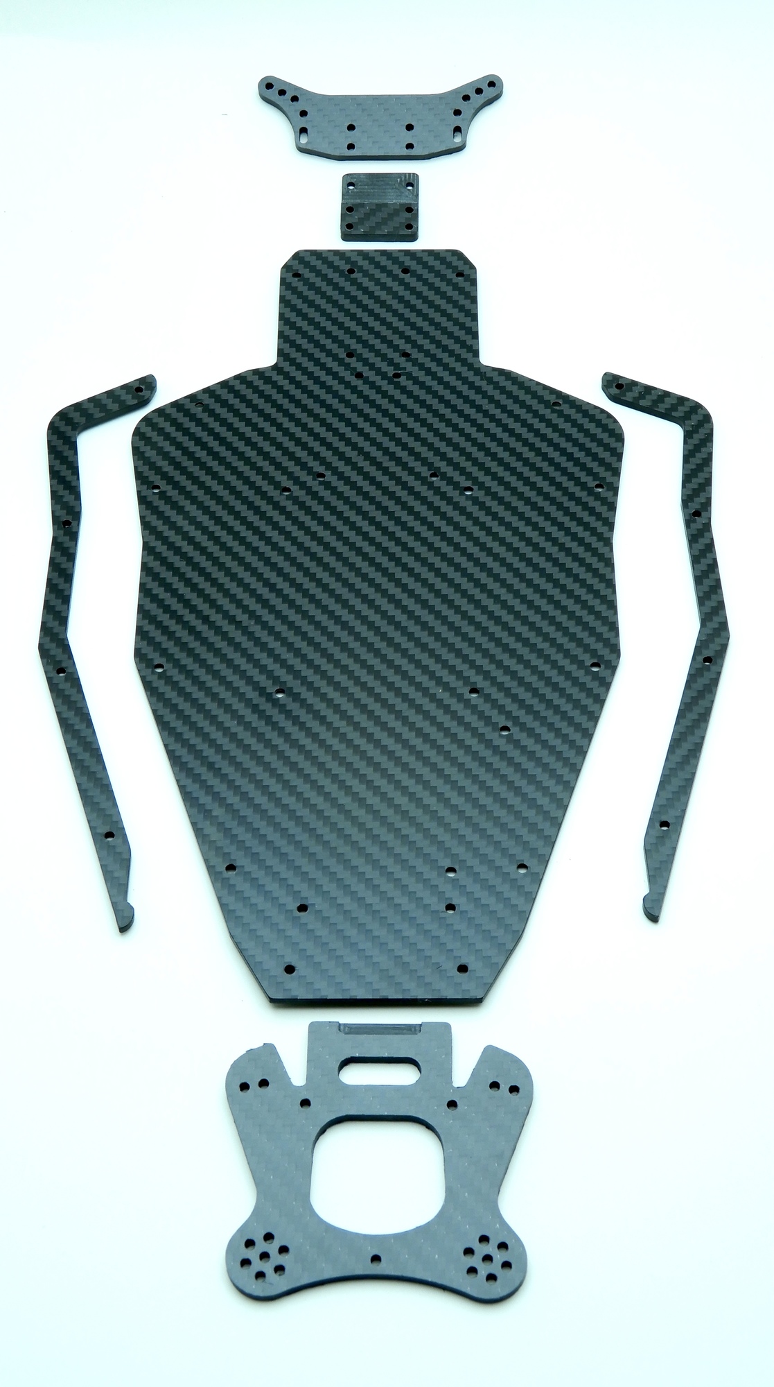

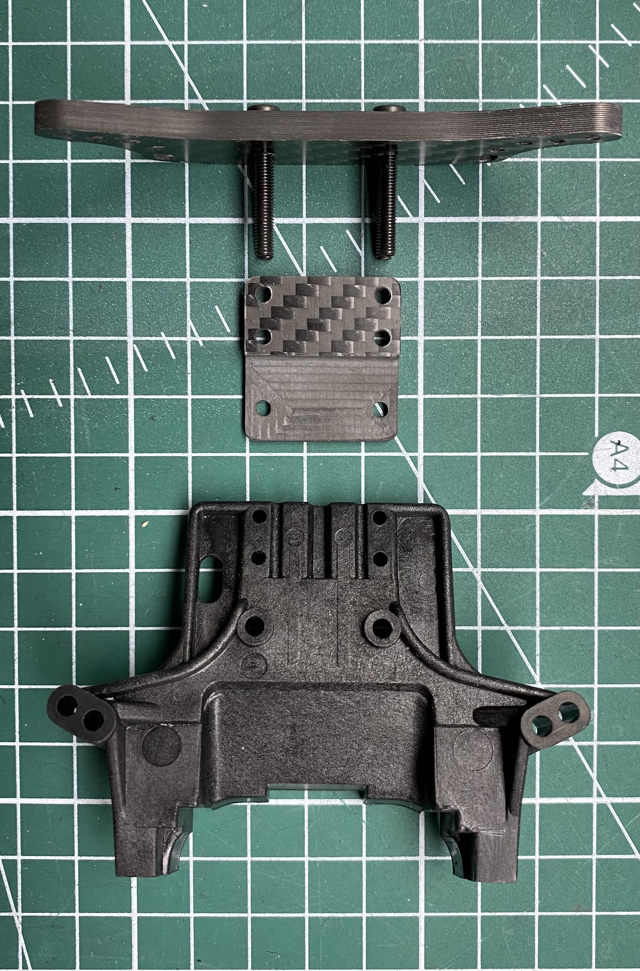

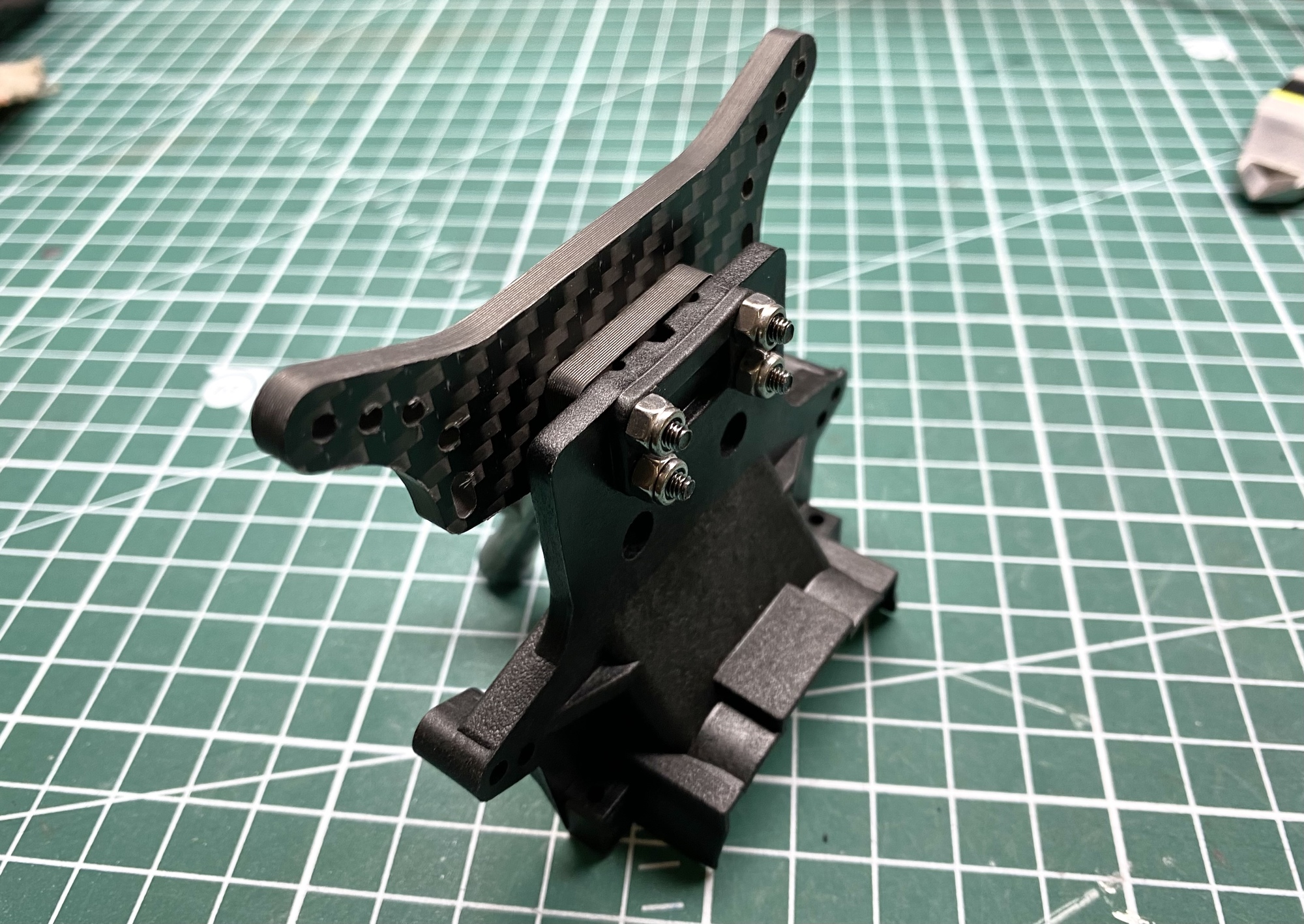

Today finally the postman arrived with the new designed rear shocktower!
So, mounted it, and finished almost the whole rear end.
Together with the carbon milled washer plate, the whole rear bulkhead, and carbon shock tower is realy solid. Pretty happy about how it came out, plus the way it looks.
The Schumacher wingmounts are positioned as low as possible, to create a really streamlined appearance.
Fitted the rear shocks, and all fits nicely!
What do you all think?
