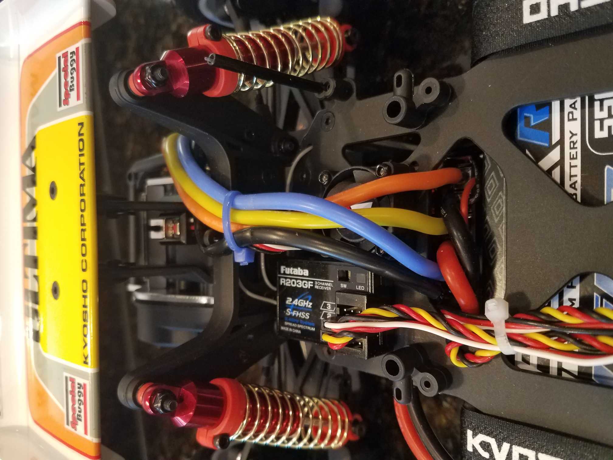

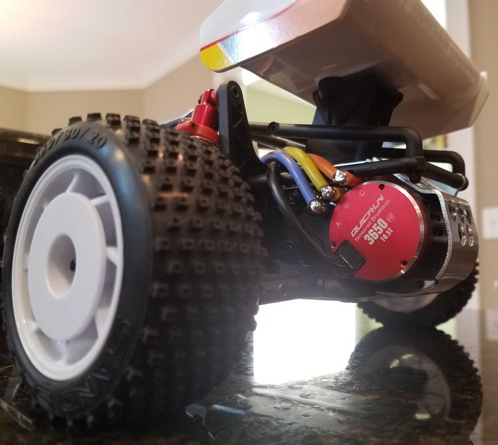

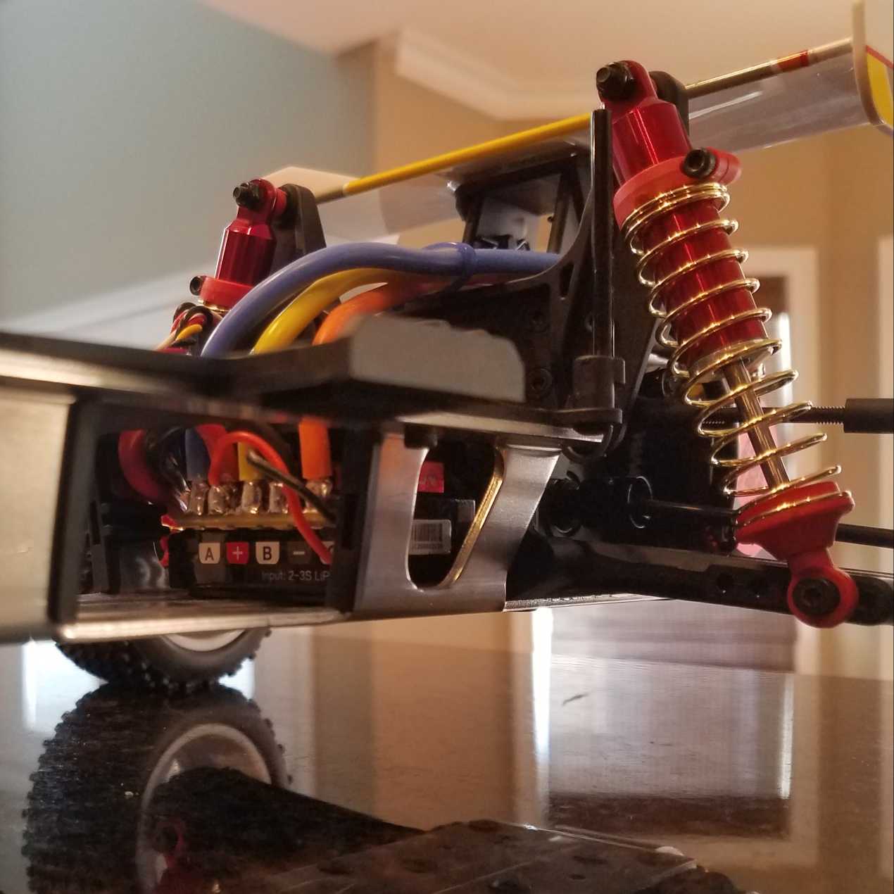

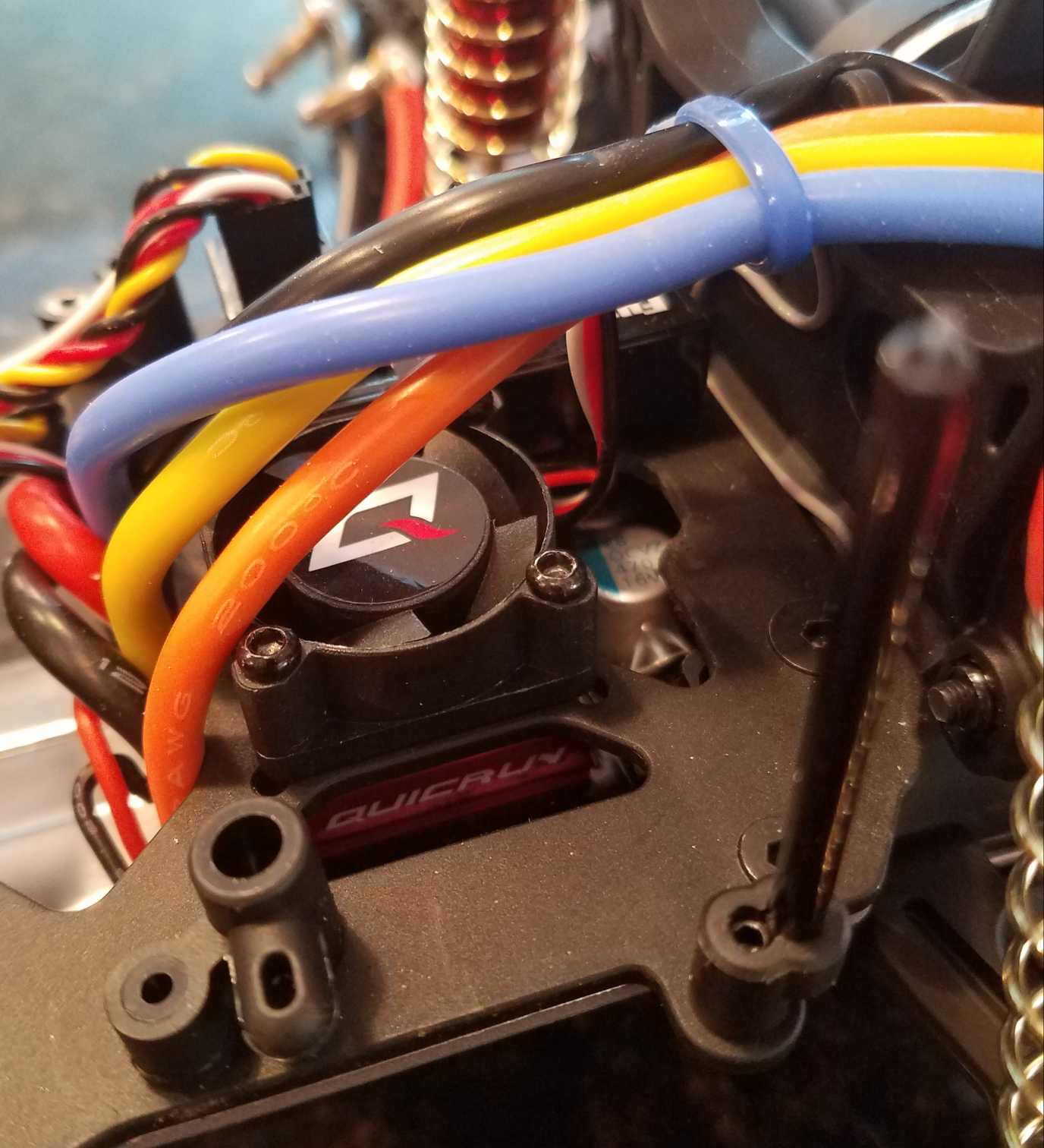

I've got a Hobbywing Quicrun 10BL120 esc & sensored Quicrun 10.5 in mine. It's plenty fast to be fun & isn't very expensive.
https://www.ebay.com/itm/Hobbywing-Quicrun-G2-Sensored-combo-brushless-Motor-120A-ESC-10-5T-3600KV-RC-CAR-/173195578925?_trksid=p2349624.m46890.l49292
It's a tight fit but I managed to shoehorn it all in there.

Your pictures are very helpful.... I just got the same setup (but 60 amp ESC) and was trying to figure out what angle to put the motor at as it is tight (so far I found if the motor tires are at the back it sticks out a little too far to be protected and with the sensor on the bottom it hangs too low.... I didn't think it would fit how you have it but I will have to look again as that looks perfect). I am going to try to copy what you did in my Ultima Pro XL.
How fast would say it is? I hope to be close to my son's Traxxas Bandit (VXL brushless totally stock - I just got it for him). What pinion are you running?
Did you turn the punch down on it? I plan on it (I got the programming card) as I don't want to tear up the trans (plus seeing what my son's Bandit does to tires!). I would love to hear your observations and how it has worked out for you!
Also, in the instruction manual it shows the little bullet fittings for the motor (I guess you solder the bottom half into the little mounts on the motor?) and it also shows a quick connect to attached the 3 wires to the ESC (but I don't have them in my kit!). It looks like you just soldered yours direction to the motor?
I think I have a ball diff in my car and am thinking about ditching it. I heard the gear diffs are better? Are the ball diffs in high demand?
