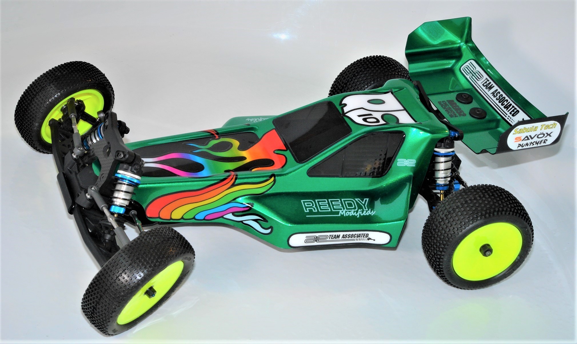

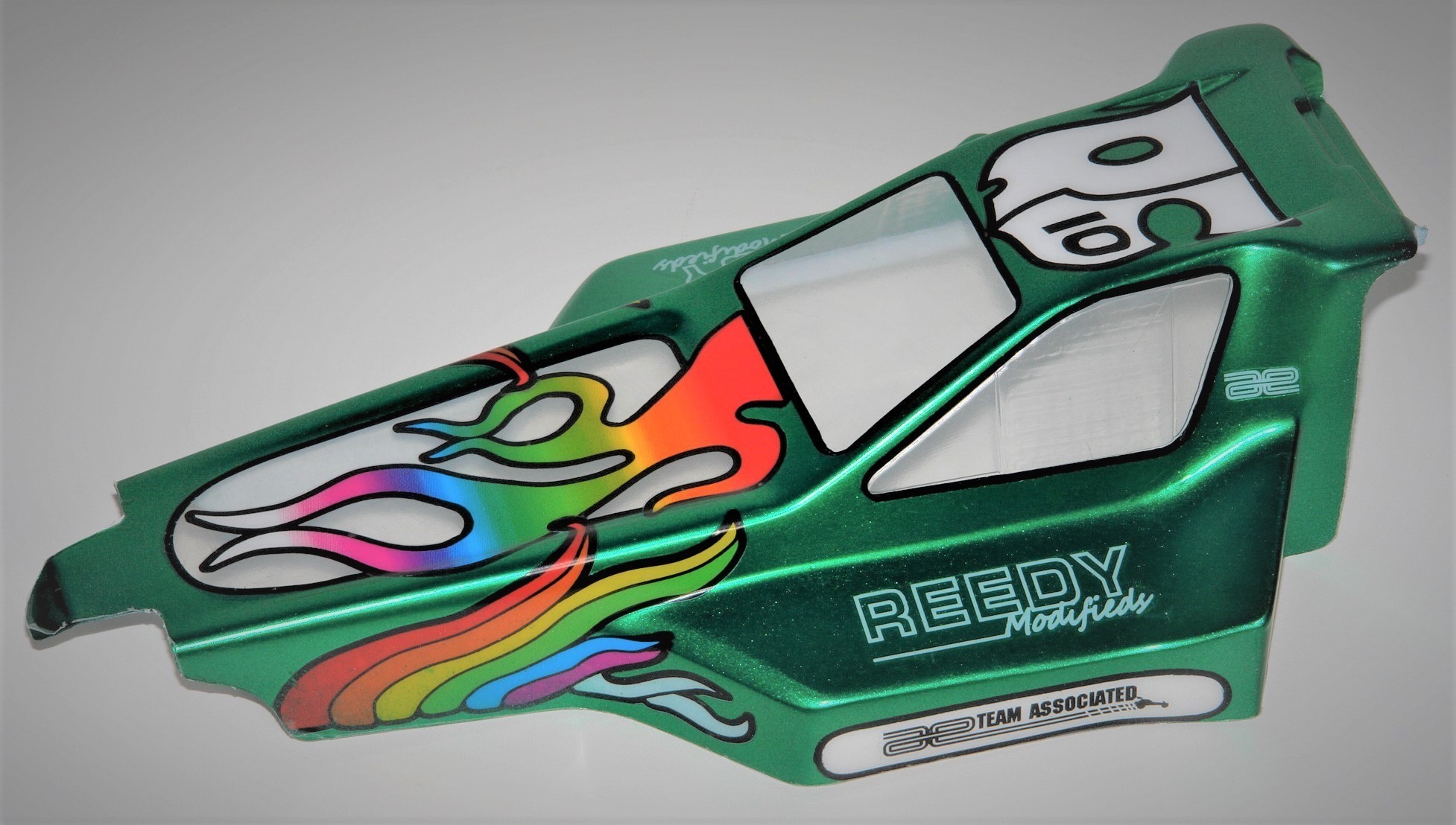

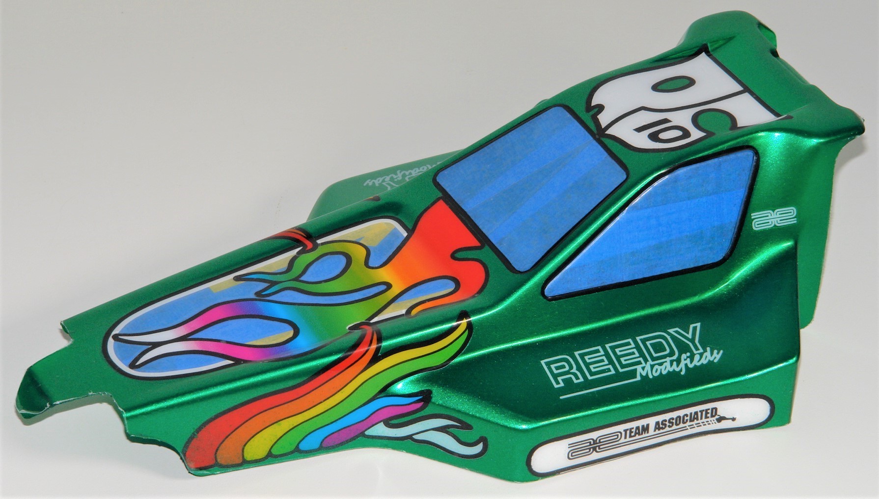

Getting on with the paint...
I wanted an identifiable "classic" paint scheme with a few twists and some personalization.
Always liked the Masami/Takatani themes but too busy for me.
The front shock tower arrangement also kinda reminds me of the Masami builds.
So going with only the flames, and RC10 roof decals from the original. Then a portion of an AE team associated for the side.
The side "decal" was trimmed with a black paint border then backed with white paint.
The flames and RC10 roof are reverse decals that were put down dry very carefully and ended up with no bubbles, either lucky or my new method.
In the past I've placed the decals wet with mixed results.
Chuck

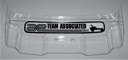

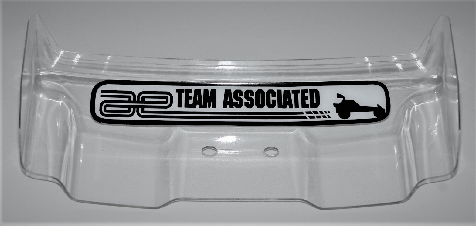

Wing decal modded and trimmed with black border like the side body decals.
Trying to keep a theme going as the RC10 roof decal and the flames decals are bordered in black.
Chuck

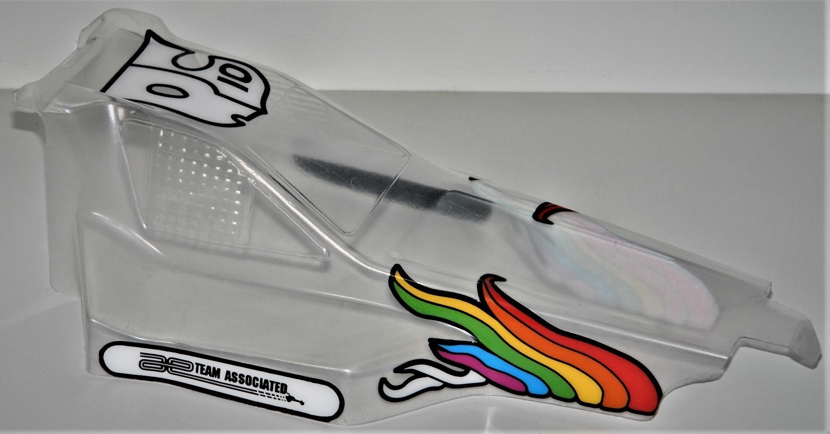

Masked every thing but the windows and hood outlines and shot them black. Really happy with the nice crisp outlines.
Then all the decals, which are all reverse decals, were masked including the "hood" area and the body was shot with Tamiya PS17.
Overspray film is still on at this point.
Chuck
radioactivity
Posts: 854
Location: Dripping Springs Tx
Has thanked: 383 times
Been thanked: 608 times
Re: Mid-motor B1, B4, B6 V2
Post by radioactivity »
Re-masked and backed the green and decals with white.
Then pulled the the masking off!
Next is PS31 Tamiya window tint...
Chuck

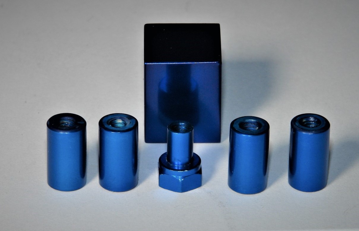

Been awhile
Recently got a Carbon fiber RC10 LiPo battery holder. The aluminum spacers that came with it were raw aluminum.
Even polished they didn't look right, so anodize them...
The spacers are small and cylindrical so they are relatively easy to bring up to a mirror finish.
It did take four or five attempts to get them to match the AE Factory Team blue.
Adjusting anodization depth and dyeing times were critical.
The larger "cube " in the back is a failed, too dark and too purple, attempt try to get a matching dye for the servo mounts.
The "cube" was in the dye for 30 minutes and the spacers were in the dye for 20 minutes.
Chuck
radioactivity
Posts: 854
It took 3 more attempts, but I got it!
Anodized to .8 mil and 25 minutes in the dye bath.
Almost perfect match to the 91668 RC10B6 FT Aluminum Steering Bellcranks.
The "test'' cube above was anodized to 1mil and 30 minutes of dye bath.
The curiosity is when the same Electric Blue dye is used at varying anodization depths and dye times it can be anywhere from a lighter teal to a darker purple.
It seems more yellow (teal) when lighter and more red (purple) when darker????
Chuck

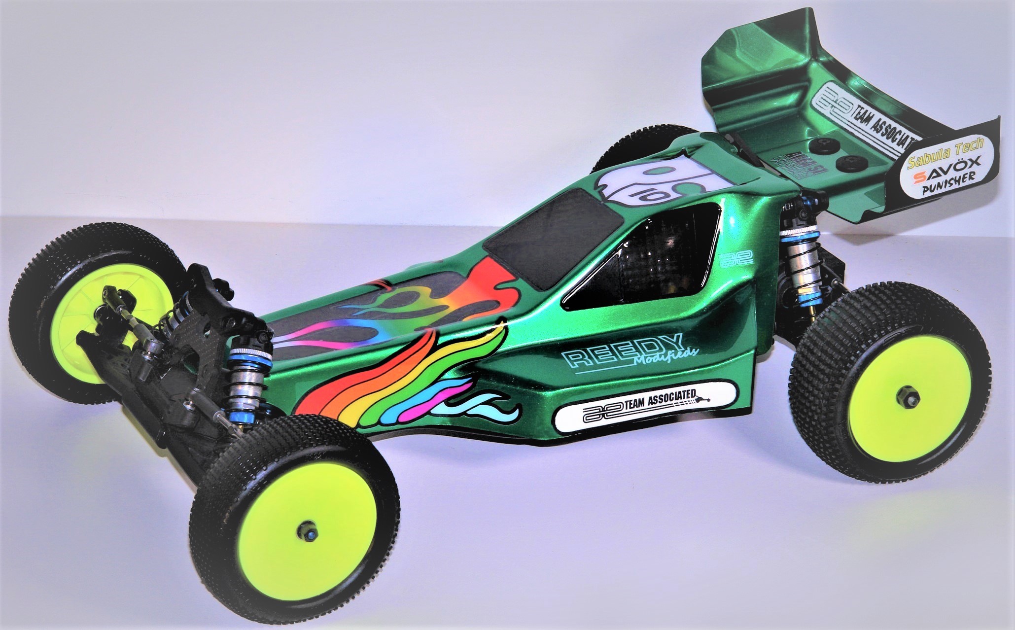

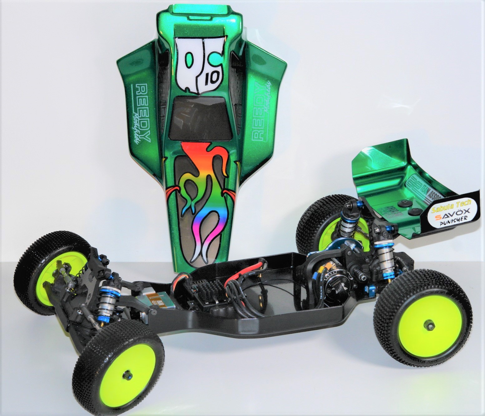

Got too focused on anodizing and just realized never gave any updated body pics.
Pics were taken before anodizing was started.
I had sprayed the Tamiya PS31 tint and removed the protective film.
Still have a few items to work on and a few parts on their way.
But it's getting a lot closer to being done.
Chuck

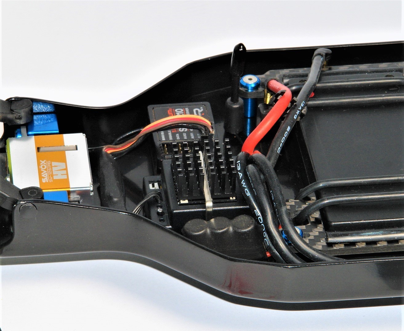

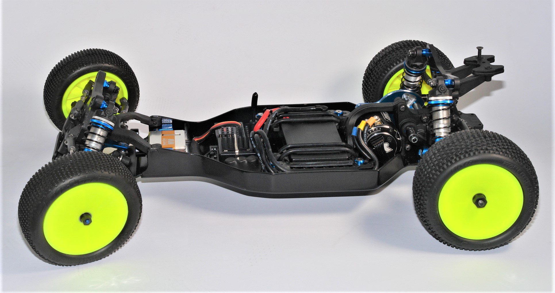

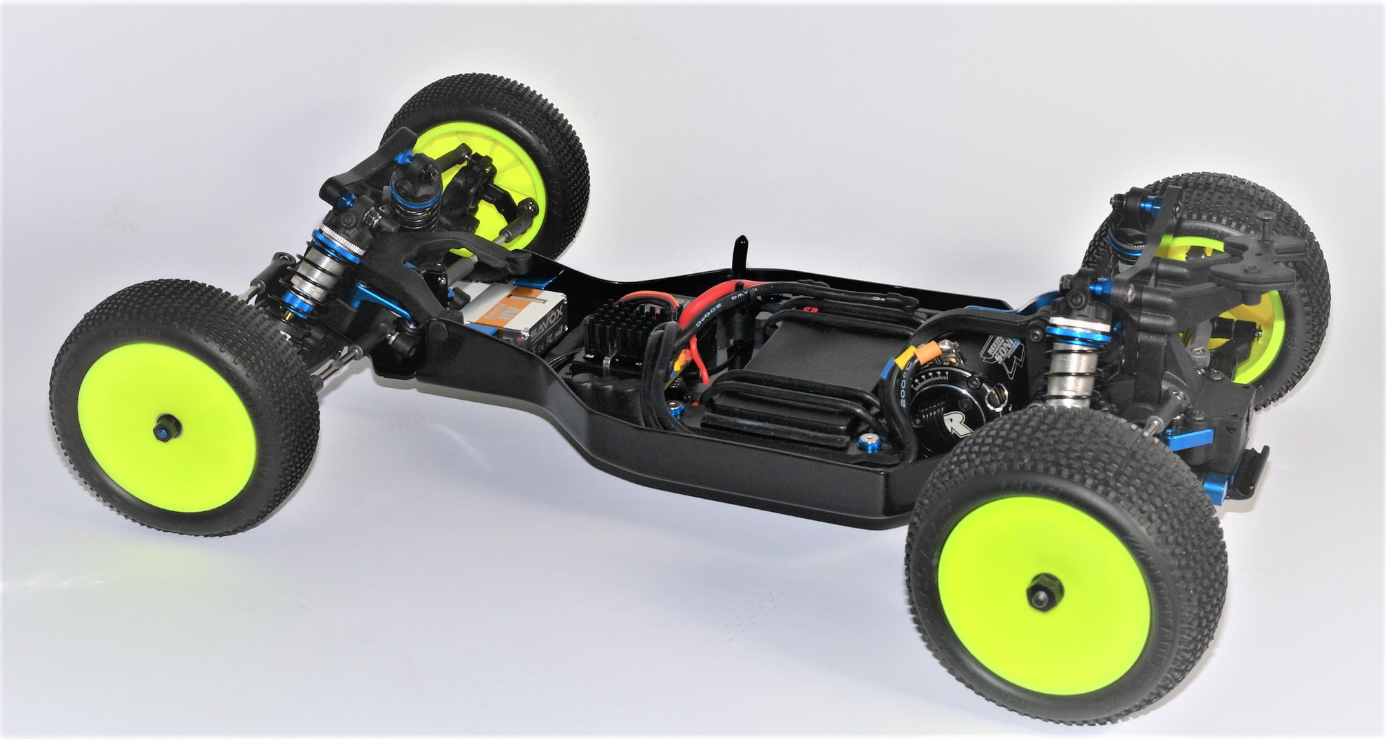

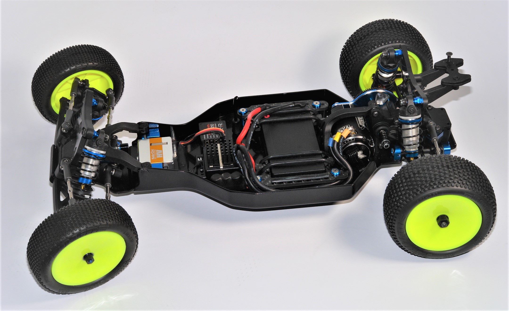

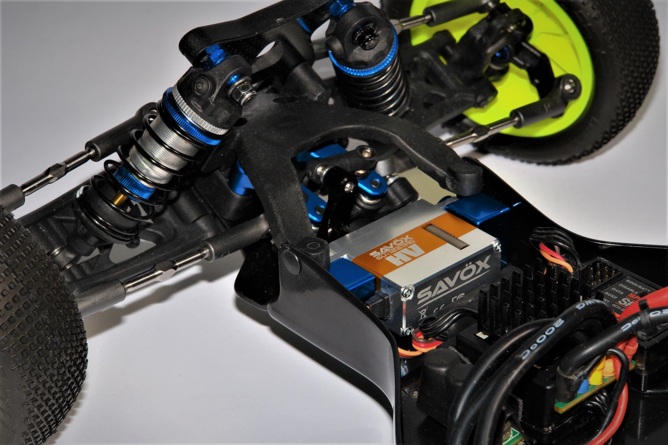

A bit out of sequence but...
The battery hold down is actually made to place a shorty lipo in a vintage RC10.
With the layback trans and waterfall, placement was a bit different.
Some trimming on the carbon fiber was also necessary for clearance.
The LCG battery is not quite so long as some others so I added a split piece of silicone tube on the inside edge of the mount to make a snug fit.
Remounted both the ESC and receiver in slightly different orientation as well.
The Esc housing was cracked and top and bottom pieces were separated so I replaced the housing with a new one.
The body just falls on the chassis with no clearance problems at all.
Took a final weigh-in including body and wing. With the shorty LCG battery 1450g, with a standard shorty 1500g.

For anyone curious...
A Mouser heatsink with very thin adhesive graphite thermal pad was added to the top of the Reedy 800z ESC.
I'm not sure that it needed it but the OEM flat aluminum just didn't look adequate.
The "retention clip" was bent from the spine of an old windshield wiper blade.
Chuck
