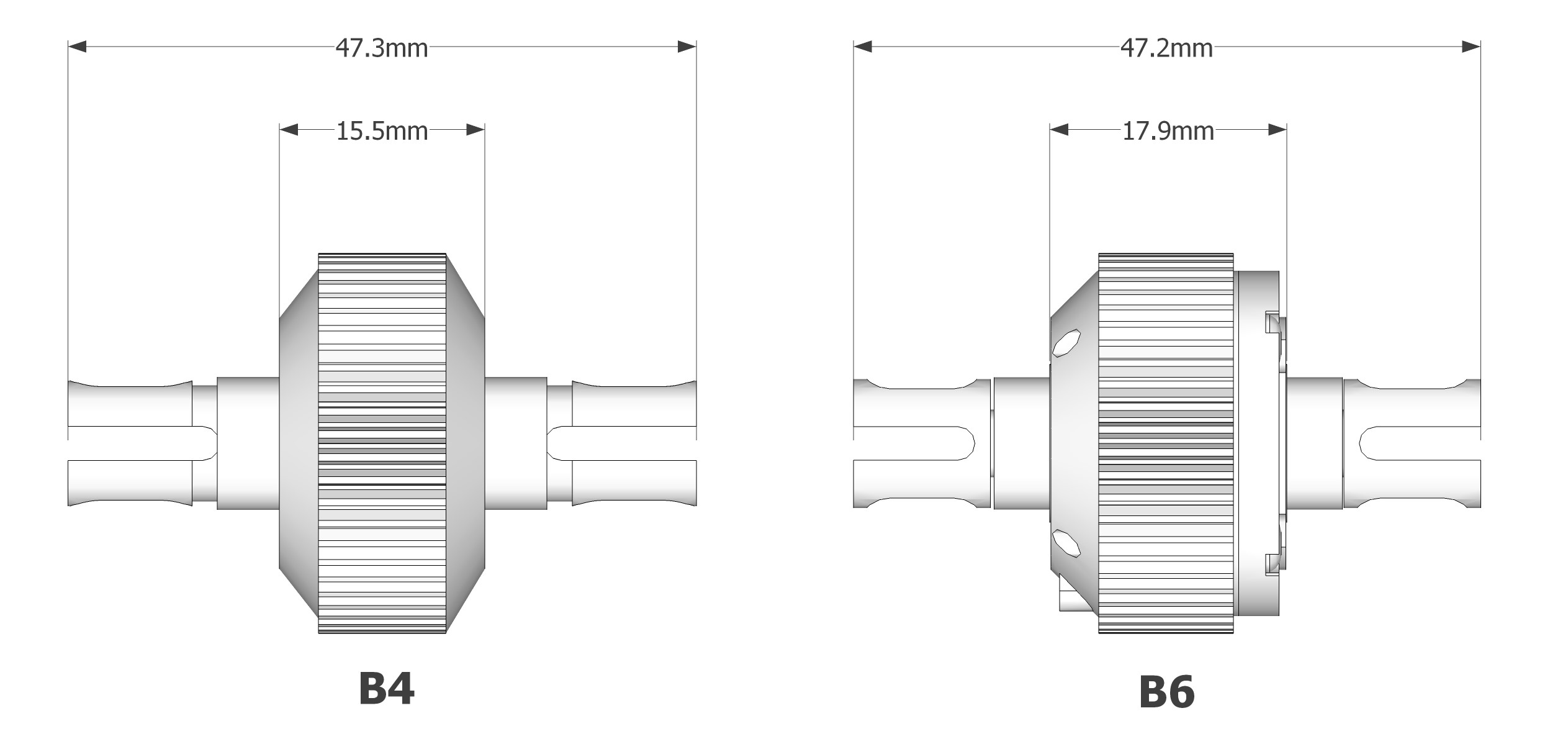

Ah, I see what you mean Jeff.
I've just assembled a new B6 gear diff and the housing is wider than the B4's by about 2.4mm.
In addition to requiring a wider trans case (with bearing bores spaced farther apart), the added housing width will effectively limit the length of the front chassis mounting screws to about 5/16" max. As it is, the standard 3/8" long screws will interfere with the diff housing. Unfortunately this will reduce screw thread engagement to around 1/4" but I guess it is what it is; there's no way to use longer screws without raising the diff or moving it aft and this will only create more problems.
I will revise the printed case design to accommodate the wider B6 diff. It could still be used with a B4 diff if 1.2mm wide shims are installed in the bearing bores to keep the diff housing centered in the case. I will include these shims with the printed cases.
