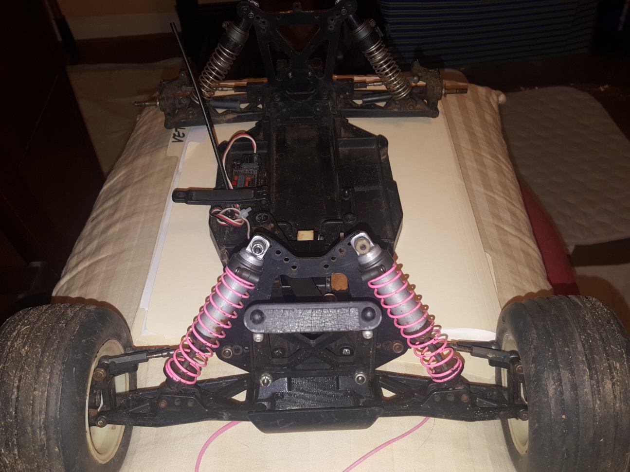

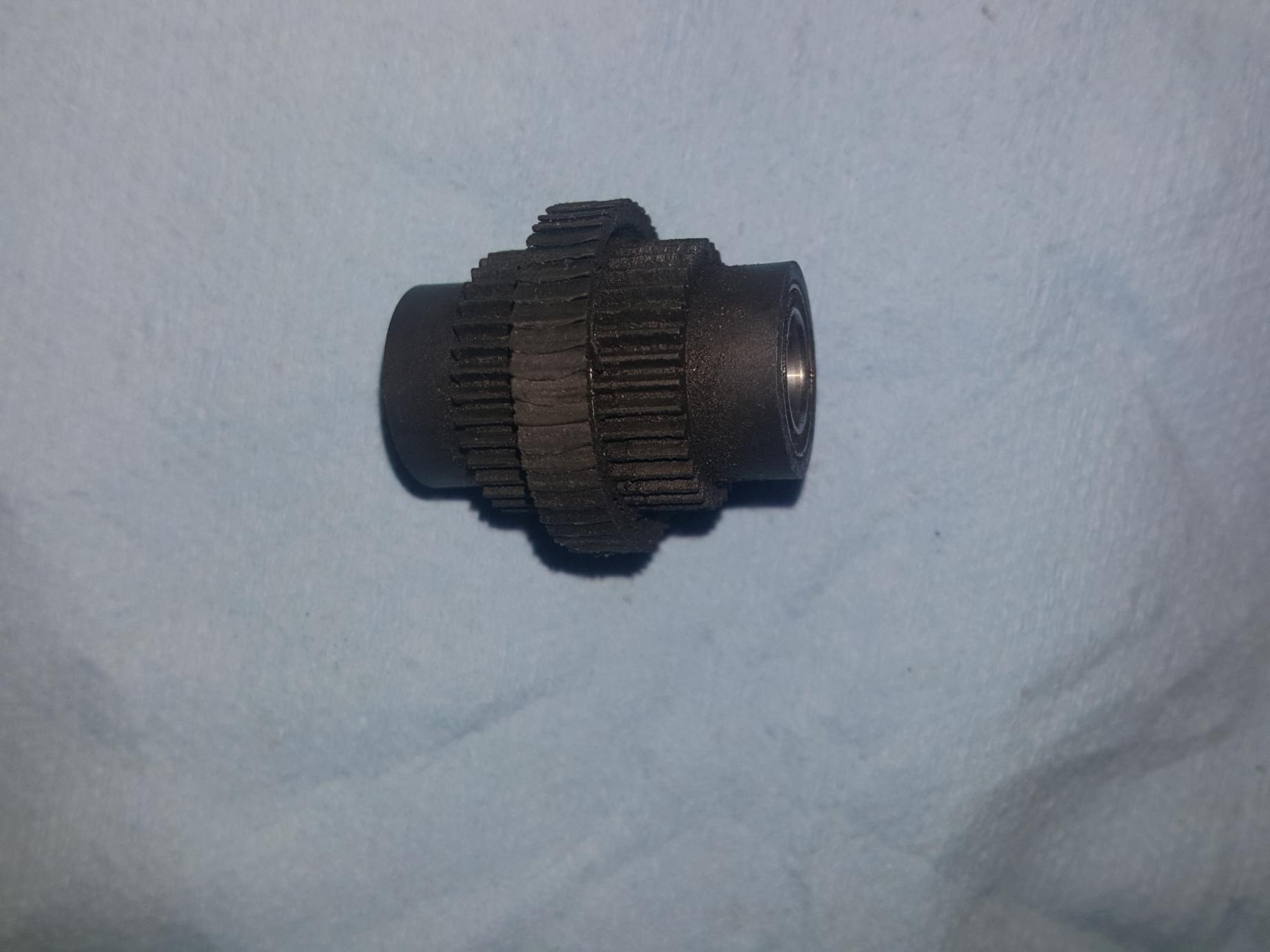

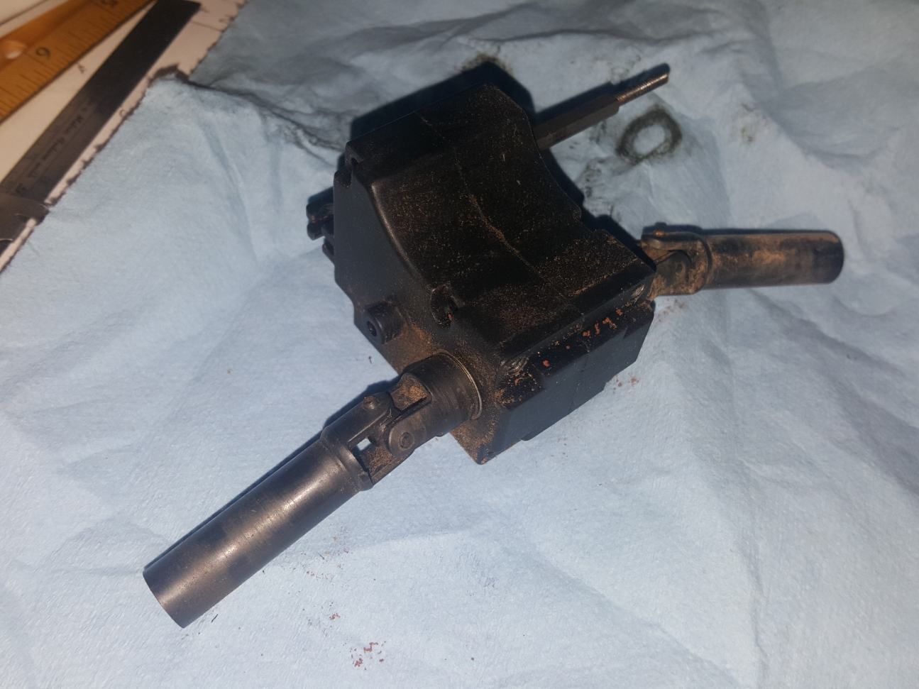

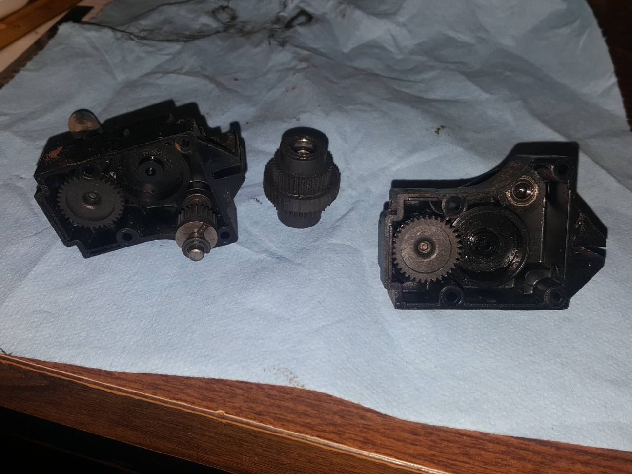

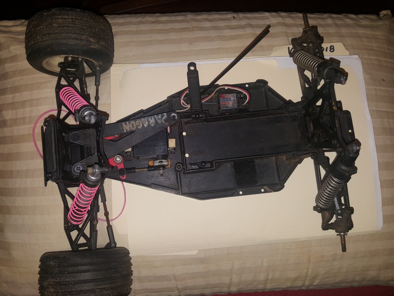

I had this running the other day with a new brushless motor and lipo batterie. Sure was nice. I didn't adjust the slipper clutch and as the pictures will show, I stripped a gear. The chassis battery box holder says Team Losi on it but I can't find what type it is in order to see where I can find a new or better gear. Or if there is an upgrade that will fit that is stronger. I did not buy this car new but at an auction back in the late 90's.

Looks like a Losi LRM transmission, and I believe that was a common failure. There were several upgrades for that transmission back in the day, you might be able to locate some.

Looks like a Losi LXT with the LRM transmission which came standard with the truck. The LRM transmission is shared with the JRX series of buggies

I wonder if this is an early LXT kit, or a conversion from a Junior T or something. In the last image you can see two holes on either side of the chassis where the early Losi 5-ilnk posts would be. Neither my LXT (which was a JRX-T conversion kit) nor my JRX Pro SE have those features. In fact, now that I think about it, the shocks look like what came with the JRX-T, before the friction coatings, or the Junior T.

The trans is the Losi LRM used in the JRX2 to early LXT. This looks like an LXT that has a Junior 2/T chassis. It has the low friction gears which points more towards an LXT also.. The only stronger gears to upgrade this would be the Thorp aluminum ones but they will be expensive if you can find them. Just find some stock replacements and use the slipper.

I did find this at Amain hobbies ; https://www.amainhobbies.com/robinson-racing-aluminum-ball-differential-gear-rrp9404/p-quarq2qagz2xactz , but it is on a back orders status. And Thorp did have one alum side for the outer gears from that diff. Now the weak point will be the output shafts which are plastic geared too. There will always be weak points for sure with brushless. I don't know how the other pieces will react after I manage to get it together but the slilpper clutch will be used a lot. And I think BattleTrac is correct that it is an early LXT conversion as trucks were all the rage before it died out here.

The LRM remains a fairly capable transmission, IMO. I run a couple brushless ones in my local track races. As long as the diff is kept adjusted properly, and you don't use too much power and/or use the slipper, the LRM will hold up just fine. There are aluminum gears available on eBay often, and there are always diff gears and complete/partial transmissions for sale, too. As mentioned, these transmissions were used on many vehicles including the Jrx2, Jrx-Pro, JrxT, Junior 2, Junior T, Jrx-Pro SE and LXT. So you have many options to use when searching. The XX retro-fit transmission is a great upgrade, and there are other brands that bolt in as well such as MIP and Factory Works, but all these may be hard to find, not to mention more expensive.
The basic gear you need is the main diff gear, part number A-3006. Here is one on eBay now: https://www.ebay.com/itm/373688003734?hash=item57018a6c96:g:A~8AAOSwnPtgfbh8.
Here is an aluminum one: https://www.ebay.com/itm/303835814880?hash=item46be069be0:g:sFQAAOSwaJlf81Lu.
Oh, and while I'm at it, here is a ball bearing version: https://www.ebay.com/itm/303937933837?hash=item46c41cd20d:g:bTQAAOSwjopgYRdU.
