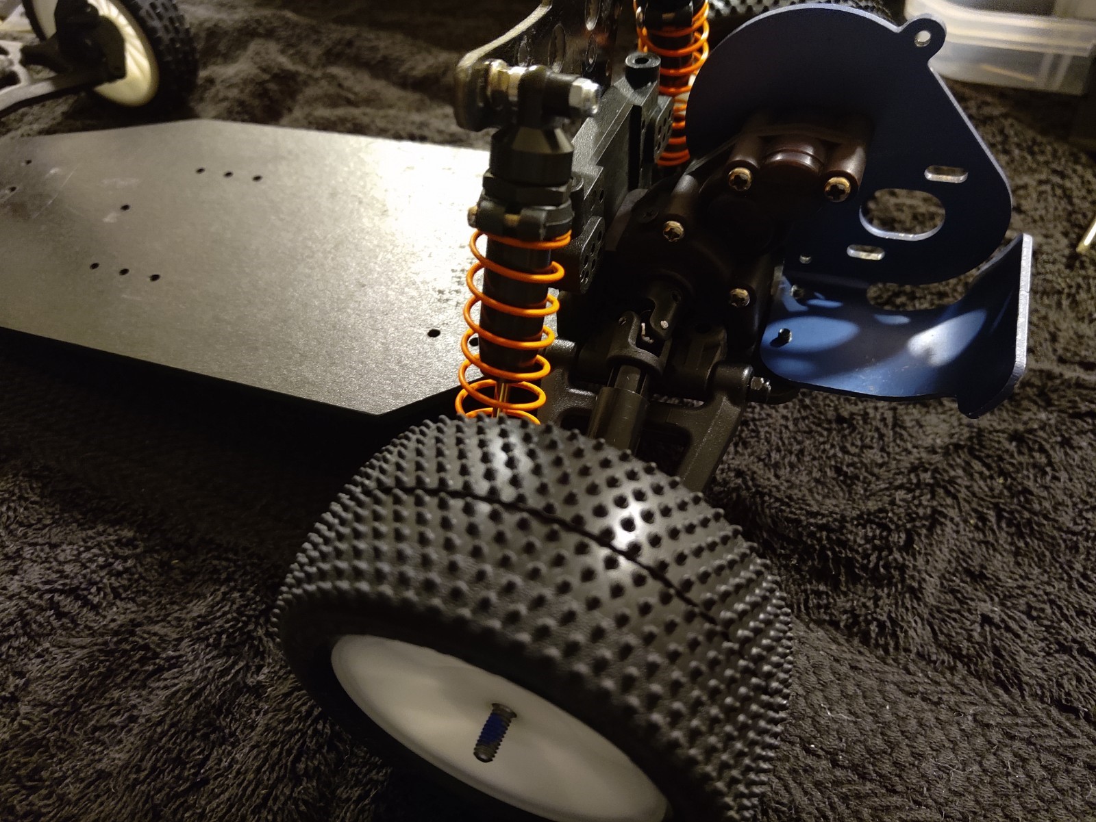

Looking to resurrect the TRX-1 I used to race when I was a teen. This car has some club race wins on it, as well as a 92' Mountain States Off Road Championship 1st place finish in 2WD Stock A-main. I was a kid back then, and bought one of the first available kits from Bob Stormer with my Paper Route money. I've sourced another car from a guy on E-bay, and after stripping down his and my old car, I'm left with a pile of parts... many of which I wont be re-using because they're the old, brittle white parts. So, cross-referencing and comparing parts from newer kits has become my process... and, I'll post pics along the way. RPM arms, Nitro truck bulkhead, Bandit parts and NOS stuff found on the 'Bay... as well as a TBG body I've just finished painting... And, YES... I plan to race it!
Stay Tuned......

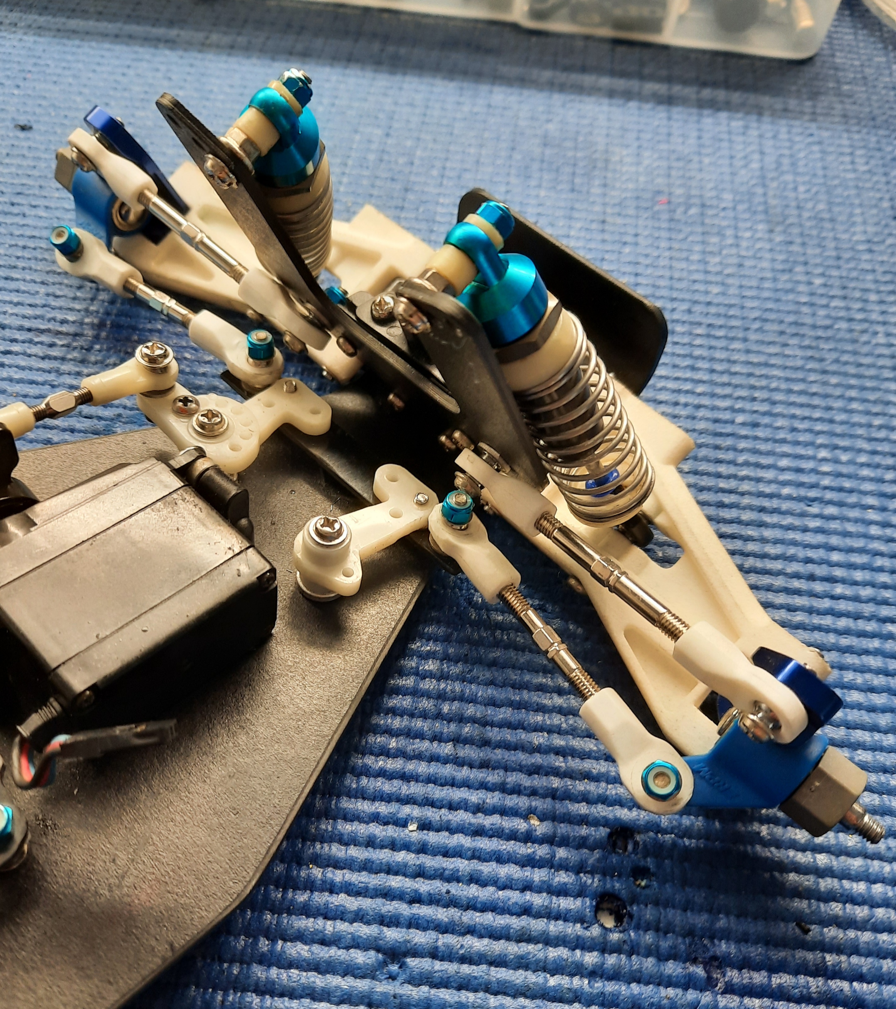

I'm learning as I go... Bandit parts arent necessarily a direct fit for the TRX-1/-3 architecture. I tried to put the Bandit front spindle on the caster blocks... no fit. So, off to the good ol 'Bay for a set of Slash caster blocks... also no fit. DREMEL to the rescue! LOL... now, with Bandit spindles on Slash casters at the end of my RPM Bandit arms, and a few alloy spacers to allow "tuning options" for front arm placement (AKA The arm spacing isnt perfect on the TRX-1 arm mounts)... we have an "assembled" front end! LOL... The Saga continues with the rear end and the nitro truck bulkhead that doesnt directly fit the TRX-1 transmission without some spacing up off the chassis...

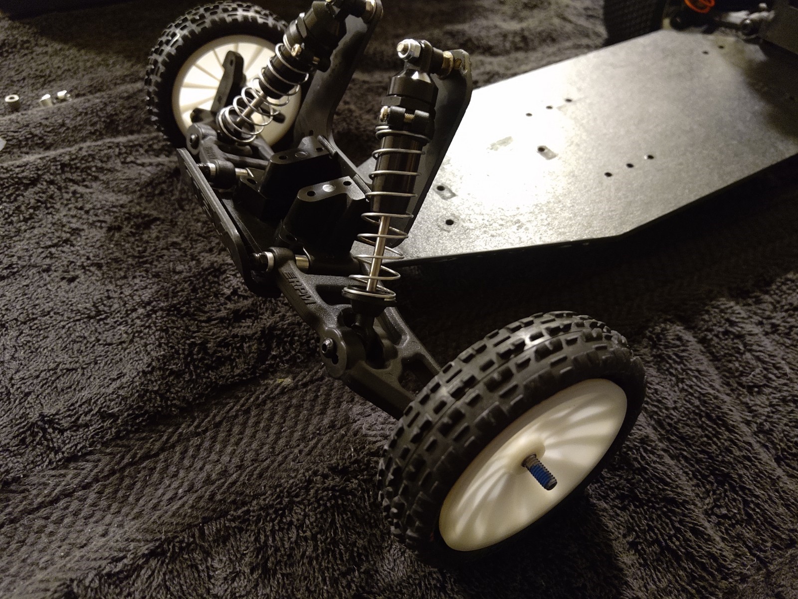

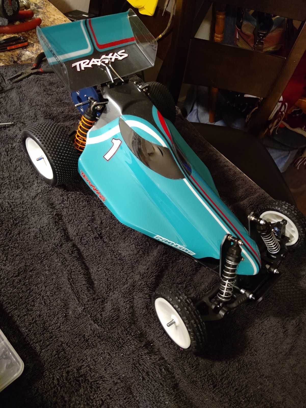

The chassis needed a little love... there was a pretty hefty ding in the CF that I filled with a mix of epoxy and CF dust from sanding another old CF piece I had. Got it straight and tidy... then modified some Slash front caster blocks, and put some Bandit spindles and axles so i can use old "pin-style" wheels or put a hex in and use modern 12mm hex wheels. The aluminum steering rack is for a Bandit/Slash, and is still not mounted... trying to figure out a way to mount it on long screws, but with something like a brass/steel/aluminum sleeve so the bearings will ride on it smoothly. The old TRX1 is coming along with it's body and wing done... just a few more random items and it'll be ready for electronics. Otherwise... this is where we're at now!
Thanks for looking!
