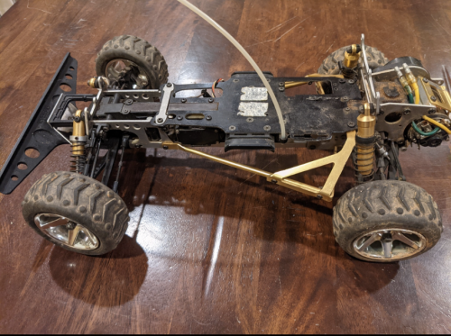

So here is what I have to start with. The gold trimmed one is in far better shape. The other one was... well loved.
I know they are all pretty similar but I I want to do a Turbo and a Pro body with a gold and CF color scheme. Not sure if they will be mirrors of each other, once the parts start arriving I will make some more decisions.

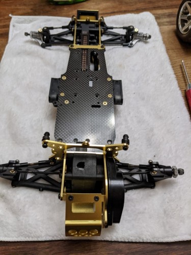

Boom, #1 done!

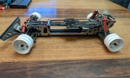

Lol, ok I'm not that bad.
Broke down the first one to prep for cleaning. I am going to keep the second one assembled for reference until this one is rebuilt.

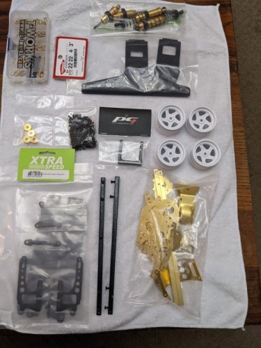

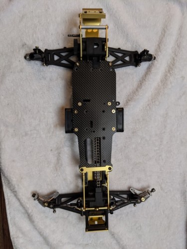

Ok, so I finally received my order from Pargu for the largest part of the first build a few days ago.
I jumped right into the build but have been taking pictures as I go.
Here are my new parts:
I am not overly impressed with the alloy set from Pargu. Full disclosure I had issues with the order from the start from not getting combined shipping to the month of waiting for him to ship.
Anyway, the fit and finish was a bit lacking. A lot of the holes needed to be reamed out for the screws to fit. The towers were nice but the braces were much thinner than stock and pretty flimsy.

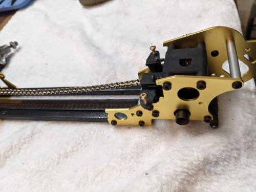

Trans went together fine, bone stock, no belt conversion and not much to it but some screw changes

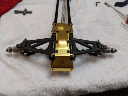

Font end assembly
Burniefloyd
Posts: 248
Location: North Carolina
Has thanked: 85 times
Been thanked: 92 times
Re: Kyosho Optima build x2
Post by Burniefloyd »

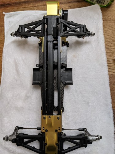

Rear end assembly
Ending point for yesterday
