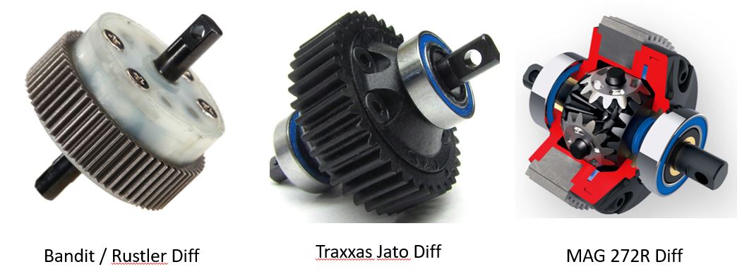

GoMachV wrote: Fri Aug 06, 2021 4:50 pm The sealed diff in the new drag truck looks very promising and will swap into old cases if you don’t want to convert (from what I hear). I need to get one on back order to play with.
I did look at the manual of the drag slash Diff and somehow recall that it might need a bigger bearing at the outdrives. I’m too lazy to confirm on my phone right now.

Chewbacca wrote: Fri Aug 13, 2021 5:33 pm
I just cross checked some manuals, the new Magnum 272R diff LOOKS like a Jato diff with 48dp but is not quite that. BUT the 272R diff rides its' case in 10x15mm bearings, the classic Bandit diff runs the outdrives directly in 5x11mm bearings. So you MIGHT beable to adapt the old diff into the new tranny (why would you want to do that?!?) but not the other way around. Perhaps one could ream a classic case to accept 15mm flanged bearings.
So the only QUICK swap there is is changing out the whole transmission.

here is a comparison of the different Traxxas diffs.

juicedcoupe wrote: Tue Sep 07, 2021 1:03 pm At current prices, the Pro-Line transmission would be more appealing.
In the long run, I'm sure the Traxxas transmission would be the smarter choice, as replacement parts will be around for decades.
I just checked out the Pro-Line Transmission. Looks like Traxxas copied that design. Here in Europe 100€ vs. 140€.
@ nitrous36 just to be clear, that new diff is NOT a drop in, you'll have to swap the whole transmission.
