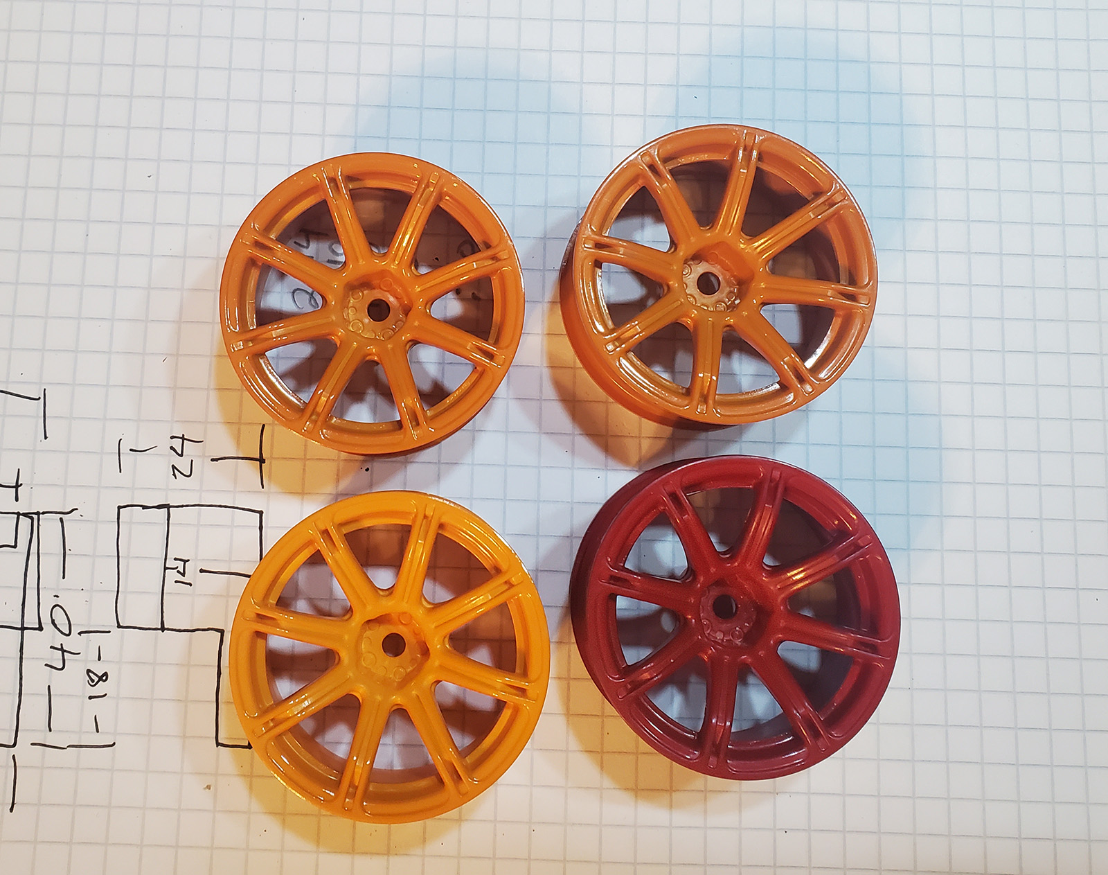

Not super stars, but here are some cheapy white HPIs that I was experimenting with recently. I would think that if you have the chrome off and down to plain white plastic, they should dye just fine.

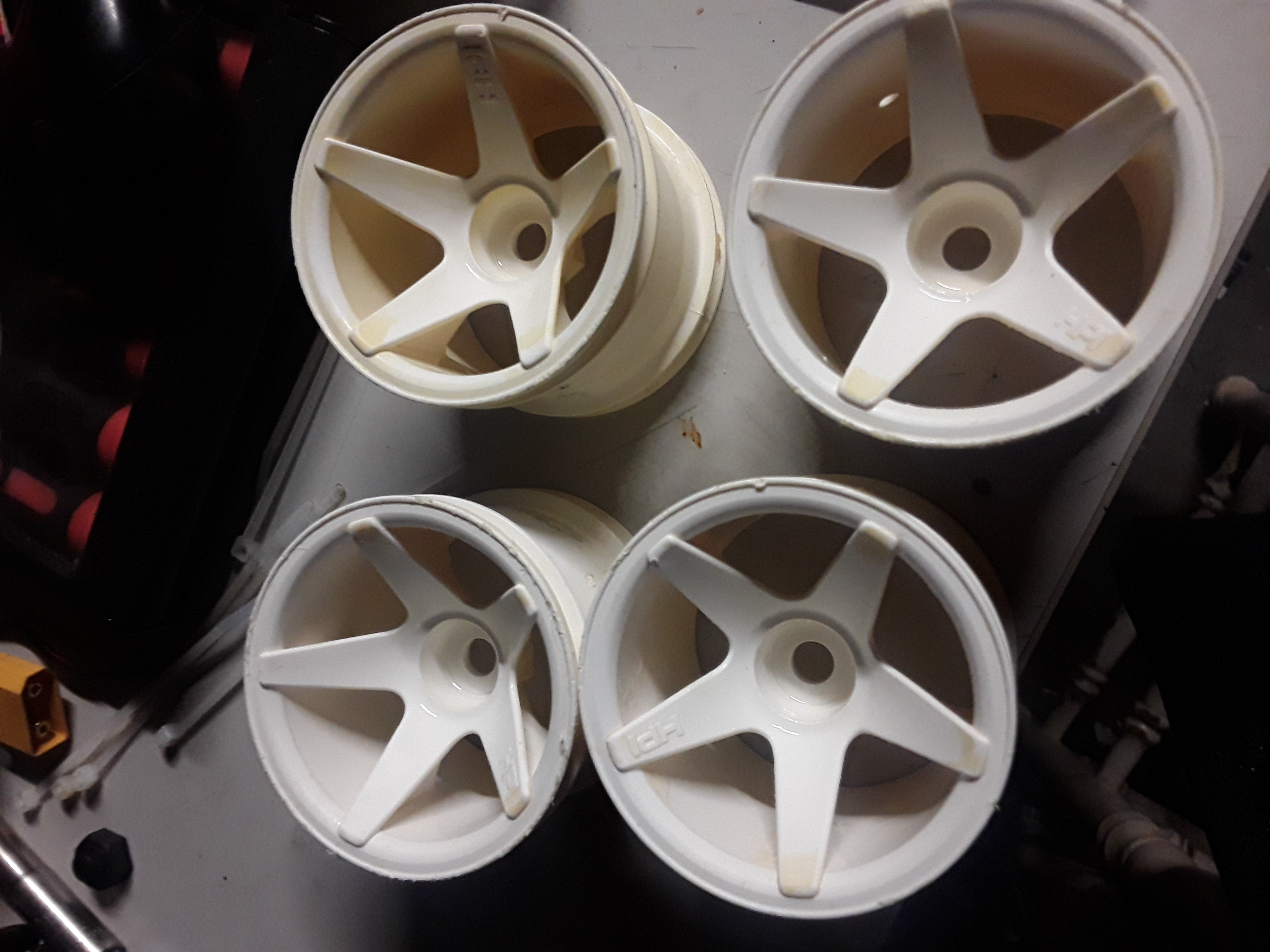

These are the wheels. I soaked them in dollar store bleach for a few hours, and gave them a quick wipe down with a rag. No scrubbing involved.
It's an old trick I learned building static model kits.

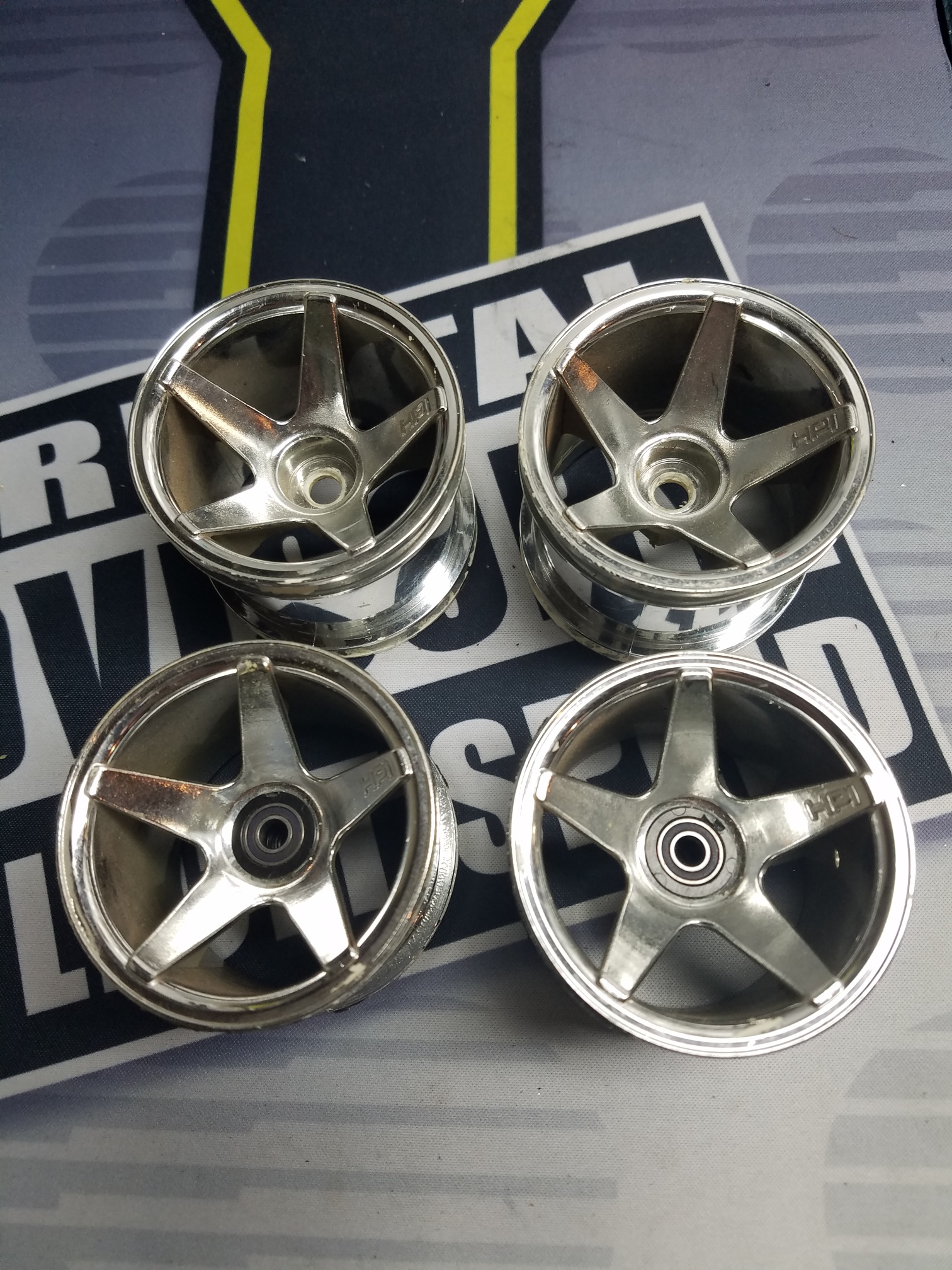

Nice. Here's a set I have, the other set went to my brother (he wants his de-chromed as well). I'll give 'em the ol' bleach bath treatment and see how it works. But I have to assume the bleach the wife gets is likely walmart bleach so I hope it'll perform similar to dollar store bleach. If it were up to me, I'd go for the hardware store bleach :lol:
