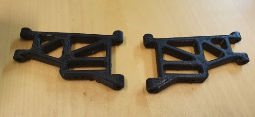

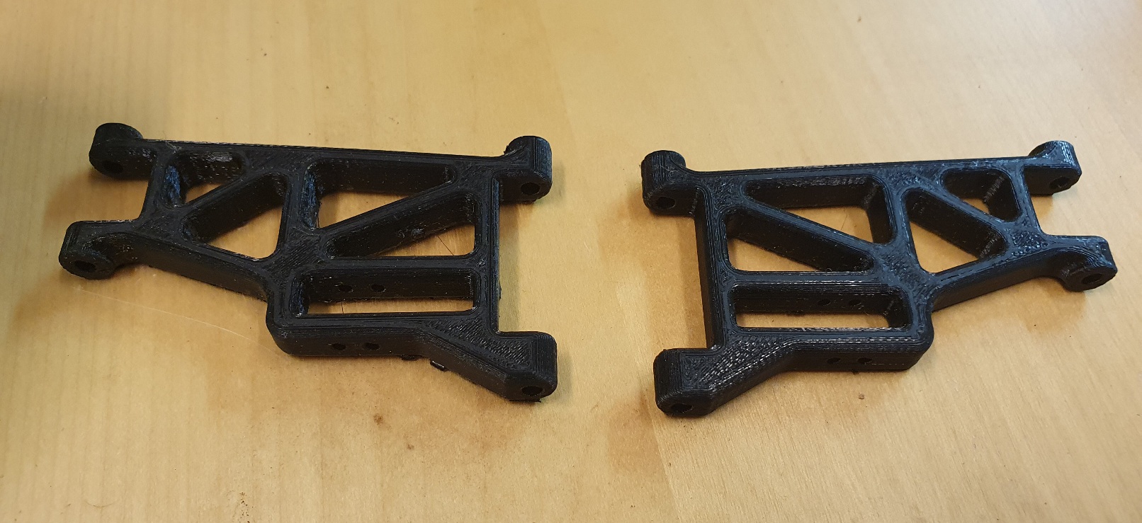

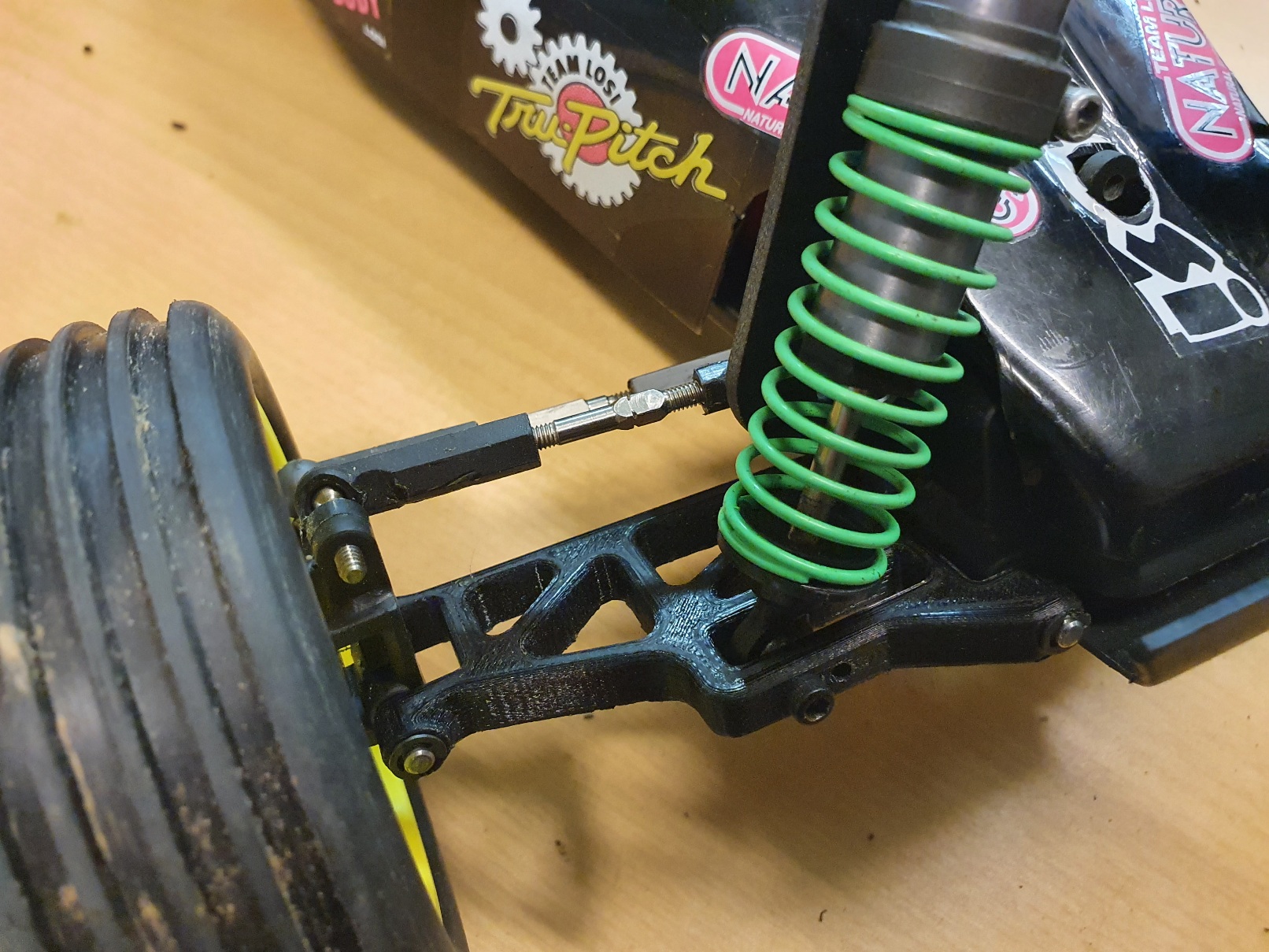

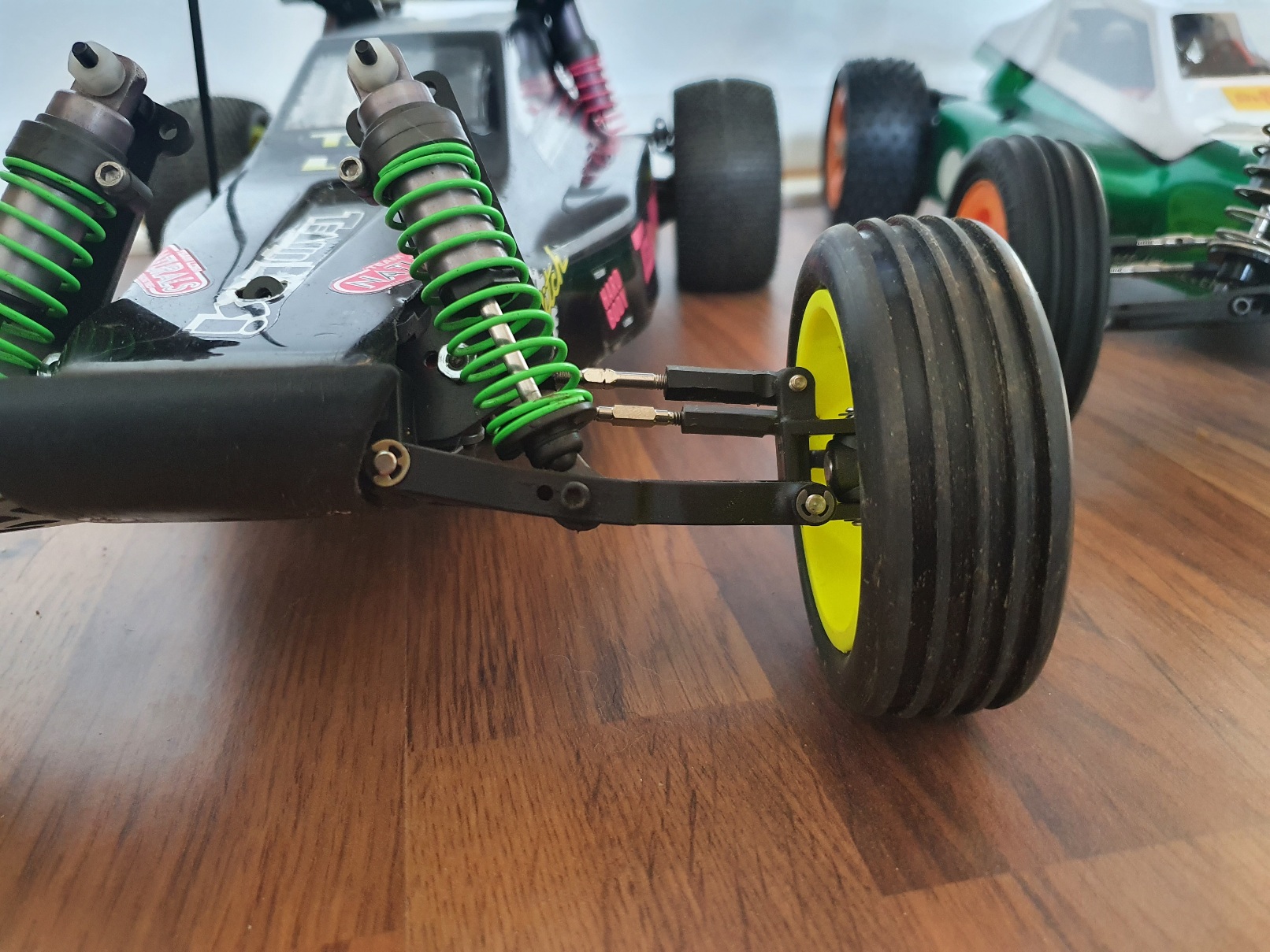

The car has been sitting on the floor in my home office for a while now. Was looking at it the other day and something in the front end was a bit off.
Had a closer look and I think I found the problem.

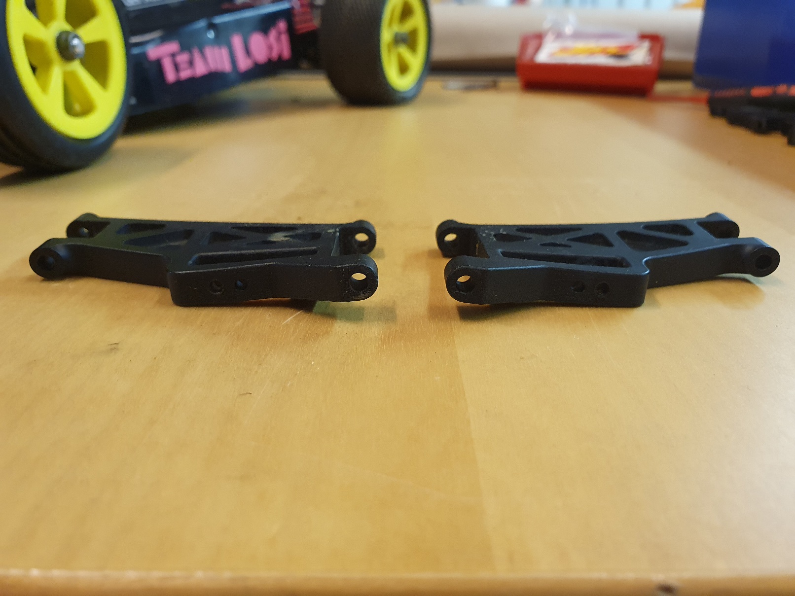

3D printed arms using SLA (I don´t know what material was used) might not be optimal. They bend over time!
So let´s try FDM this time. Printed using PETG filament. Not the same finish, but they seems stronger.
Quite rough from the printer.
Somewhat cleaned up and on the car.
Let´s see if this works better.

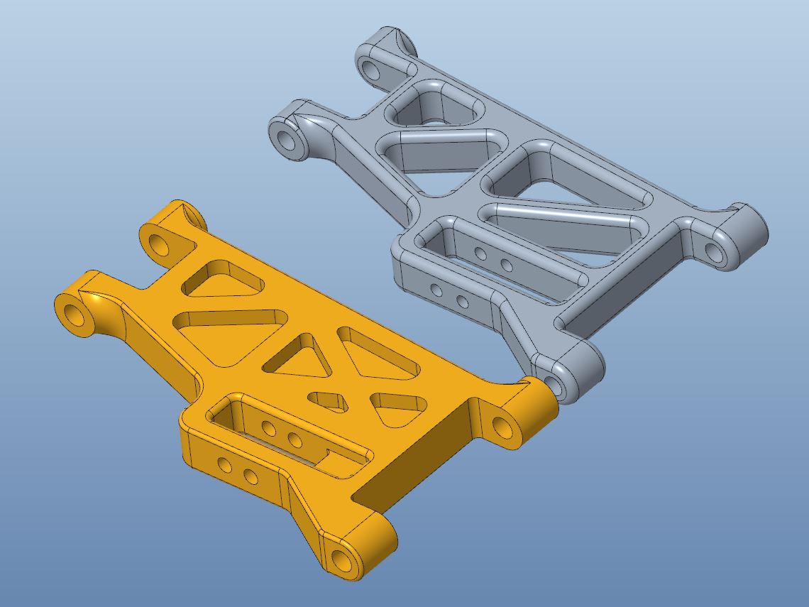

those look good , did you model them yourself or download the file ?
- Posts: 90
- Joined: Sun Jun 28, 2020 3:15 pm
- Location: Sweden
- Has thanked: 52 times
- Been thanked: 100 times
Re: Scrapheap Junior
The one I got printed in my first attempt was a downloaded file. Can´t remember where I found it, but they are out there.
I never really liked the look of all the extra strengthening, although I totally understand why they are there. And the arms where totally ok after some light running.
For the secont print I did my own model. I skipped the strengthening and made them look more like the original arms. But they are not exactly like the original since I don´t have any to take actual measurements from.
I figured since I´m only doing some occasional running the arms should be ok for that.
Orange in picture is the downloaded one. My model is the grey one.

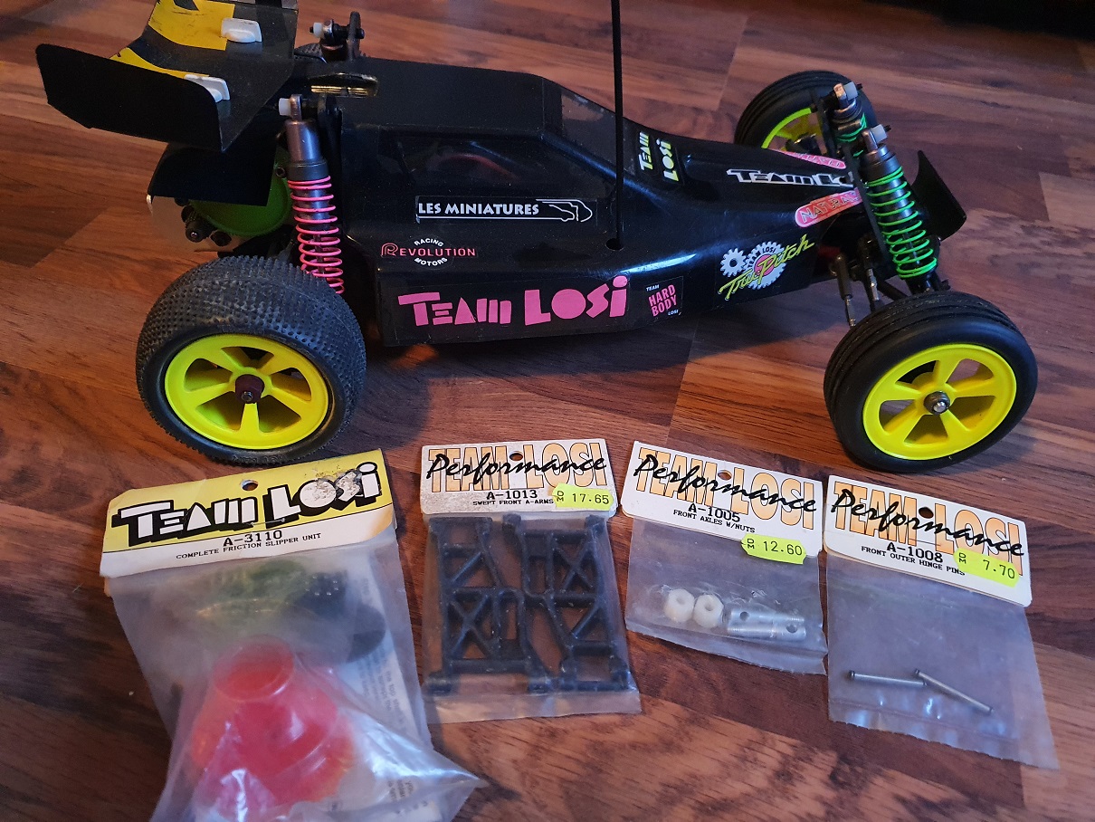

Autum is here and I decided to make some upgrades during the winter.
Got some new parts to put on the car.
Complete Friction slipper
Swept front A-arms
Front axles
Front outer hinge pins
The slipper came from the US and the rest from Germany.
Note that the original price tags on the parts from Germany are still in place and they are in DM (Deutsche Mark). I think Germany went to the Euro currency in 2002.

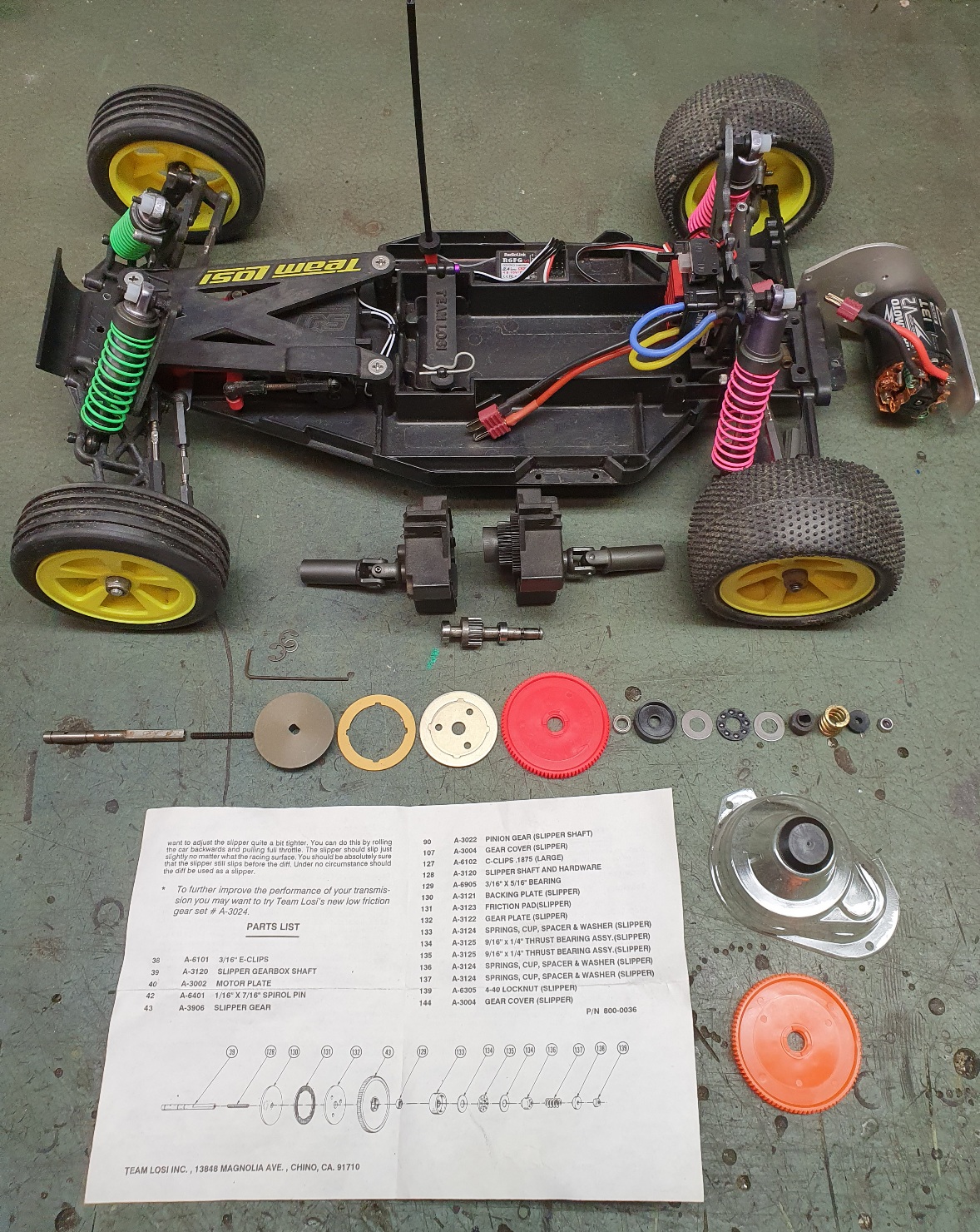

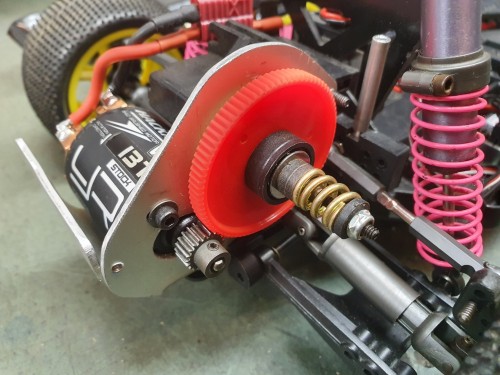

So I finally found the time to assemble the slipper.
Got a bit scared when I saw this in the instructions:
And sure thing, I had the early gearbox case.

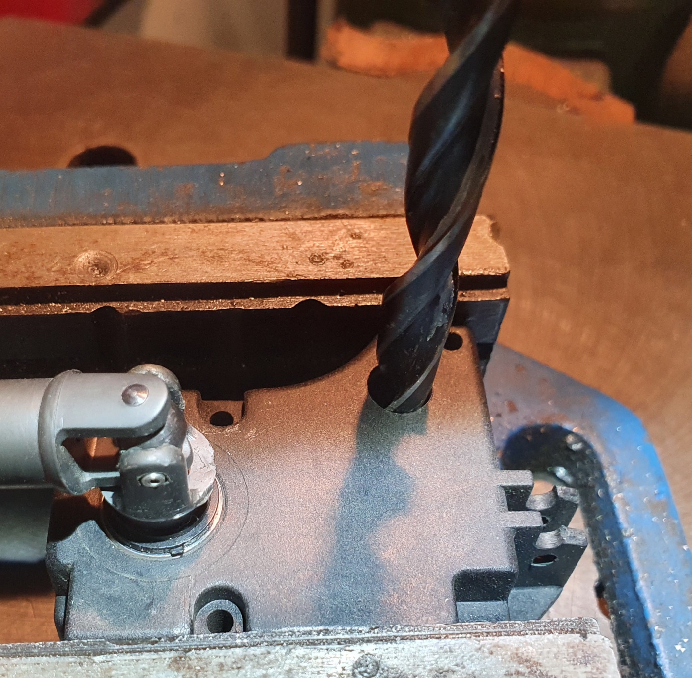

So 5/16" is 7.94 mm. Very close to a 8mm drill bit then.
Deep breath and here we go:
Worked out nicely.

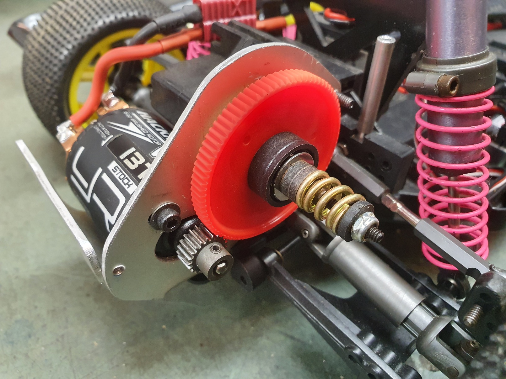

Slipper now assembled in the car:
Worked out nicely.
