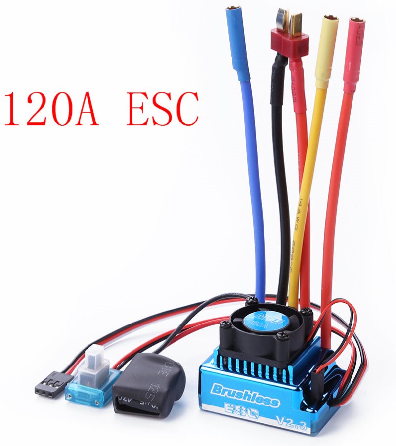

I'm sure you guys have seen these particular ESC's all over the 'net. I happen to have 2 of them. 120A v2.3 generic waterproof brushless ESC's. I can't for the life of me figure out how the hell to calibrate & reset these things! Unlike a bazillion earlier versions of this same ESC that have a reset button by the power switch, these have a rubber boot covering the button and there's no reset button ANYWHERE that I can find. I even removed the plastic power button end cap and boot and there's no reset button inside the boot, either! WTF?? I've tried holding the transmitter throttle down while powering up the ESC and it makes beeps but it still doesn't seem to be letting me properly calibrate the bloody thing.
Back story: When I first connected everything and tested it, I had instant throttle response, but then I started reprogramming it with the program card and something got out-of-whack, I was trying to tone down the punch for the car I'm building for my 10-year-old daughter. Now, when I hit the throttle, it takes a good 3 seconds before the motor starts to turn. I've messed with every setting I could think of, done a reset through the program card, but nothing gets rid of this annoying throttle-on delay. What am I missing here?? There MUST be a way to properly recalibrate the transmitter throttle trigger endpoints!

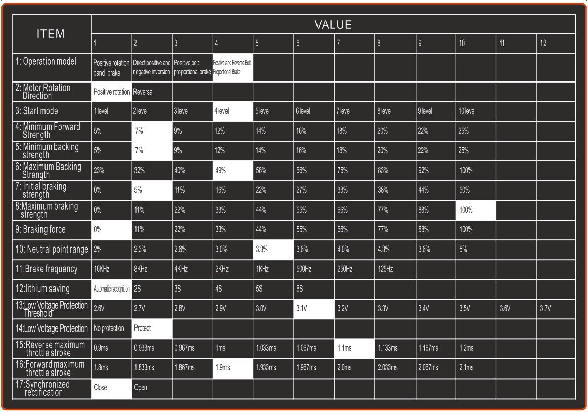

Secondly, I did manage to track down a correct programming chart, and I also already had a program card, which has the chart printed on a sticker on the back of the program card. Unlike most ESC's which have only a half dozen, or up to 10 programmable options, these units have 15 or more.
Whilst I could find no documented procedure anywhere on how to do a reset--the program card has a Reset button--I discovered the correct way to do a reset is as follows:

Now, on to the issue with the weird couple-seconds lag when you pull the throttle trigger, before the motor would begin to spin. I messed around with just about every setting on the chart (attached); "Start Mode" is effectively the same as "Punch". But changing that didn't make any difference to the lag. The motor would spool up faster, but only AFTER it lagged for a couple seconds before starting to spin. I didn't originally mess around with "Minimum Forward Strength", which is defaulted to 7%, because I wanted this car to be tuned down for my 10-year-old daughter. That turned out to be the problem. I don't know what the percentage relates to, but what this option appears to be is the latency before the throttle comes on, and when I set it to option 7, the throttle came on with almost no lag. (I honestly don't know why the DEFAULT value for the ESC results in such a big throttle lag; I mean, who the hell wants to wait a few seconds after they give a car throttle, before the motor actually starts to spin??)
I would imagine the "Minimum Backing Strength" functions the same way, it affects the amount of lag between when you push back on the throttle, and the motor actually stops spinning & reversing.

Firstly, unlike many similar ESC's, this particular unit with the rubber boot over the power switch, CANNOT be reset the usual way (by pressing a Reset button adjacent to the power button while turning on the power and holding your transmitter throttle trigger down to enable recalibration). There simply IS NO Reset button! So for this reason, I don't recommend this ESC.

Re: Reset/calibrate generic 120A v2.3 brushless waterproof ESC
Hey super helpful post and has saved me a bunch of frustration that I didn’t experience with this ESC this time around, I just installed it in my daughters M-05 as we are going brushless, she has a Noble NB4 radio and I experienced the latency, working through the different mode settings to find the best. But also the brake comes on super hard regardless of what setting I program using the card. Can you run me through the calibration steps again please? I’ve got the reset to factory defaults down but don’t really understand the calibration steps when using the program card.
Thanks in advance
Thanks in advance
- Coelacanth
- Posts: 7421
- Location: Alberta, Canada
- Been thanked: 325 times
That info was in my second post; to reset this particular ESC:Cocky472 wrote: ↑Sun Feb 09, 2025 11:18 pm Hey super helpful post and has saved me a bunch of frustration that I didn’t experience with this ESC this time around, I just installed it in my daughters M-05 as we are going brushless, she has a Noble NB4 radio and I experienced the latency, working through the different mode settings to find the best. But also the brake comes on super hard regardless of what setting I program using the card. Can you run me through the calibration steps again please? I’ve got the reset to factory defaults down but don’t really understand the calibration steps when using the program card.
Thanks in advance
1) Connect ESC 3-wire cable to program card;
2) Connect battery power;
3) With ESC powered OFF, press and hold the Reset button on the card while turning the ESC power on;
4) All the LEDs on the card light up for a second, then all settings should be returned to defaults.
I hope that helps. You need the program card to do this. Changing settings works the same way with all program cards, you will see each program option with a number of settings to adjust, and use the program card lights to help you adjust the setting you want to change.
