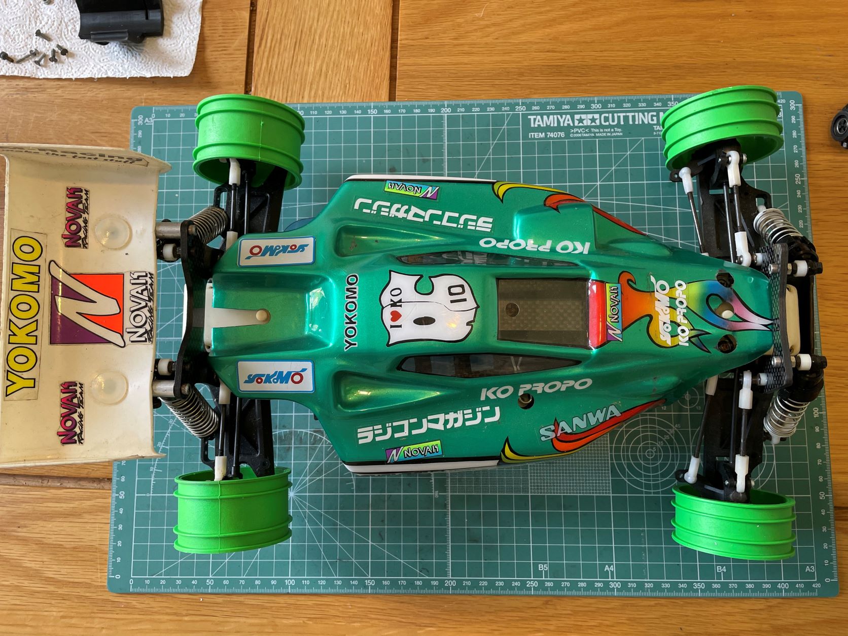

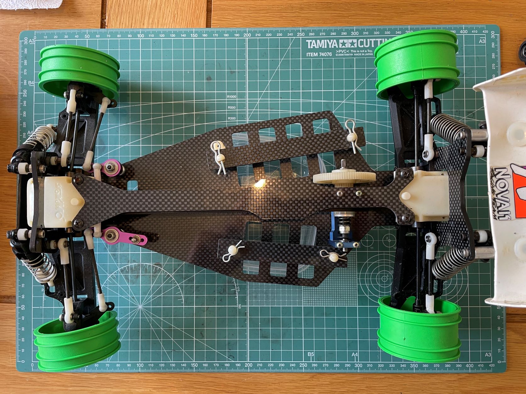

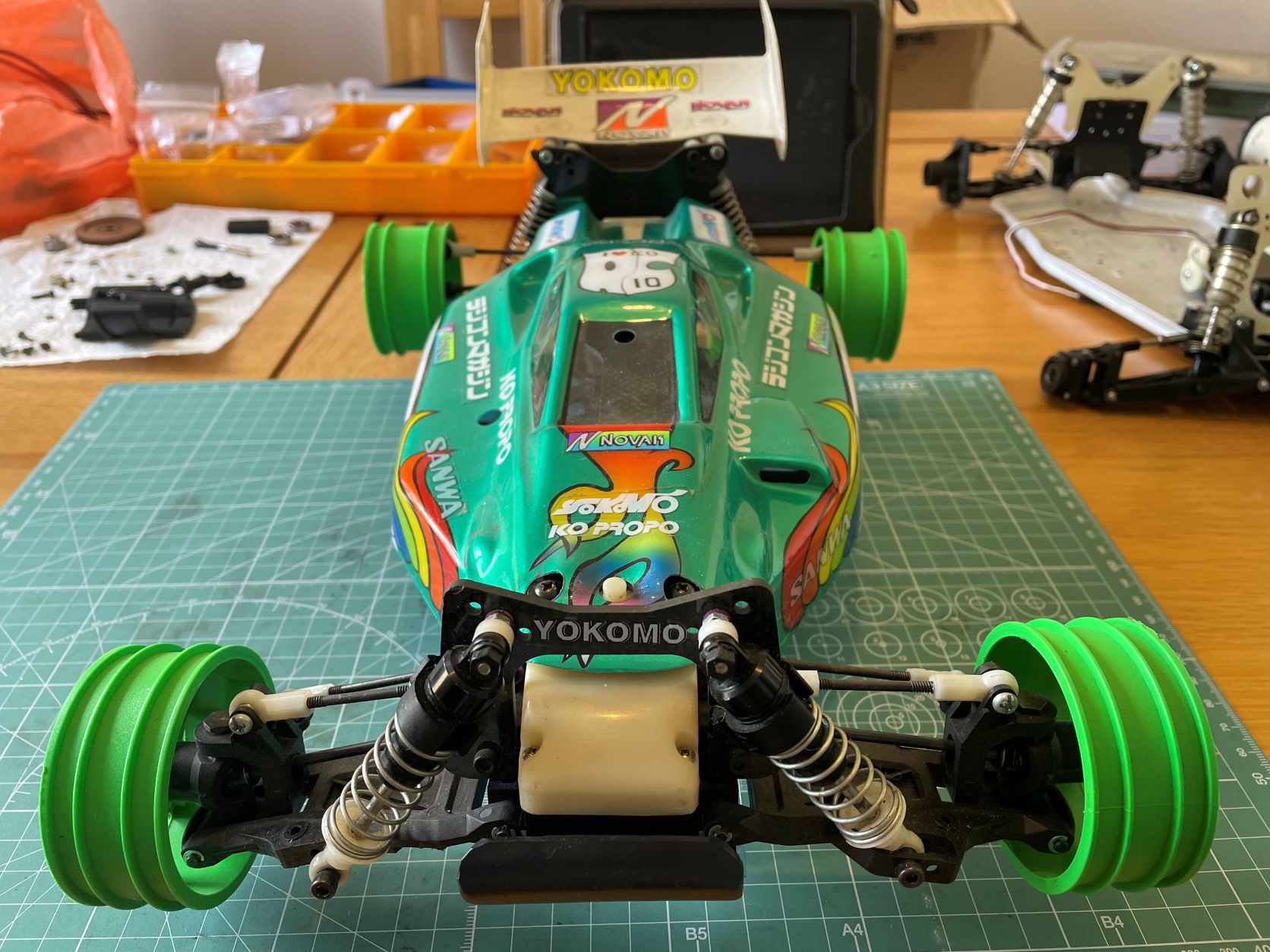

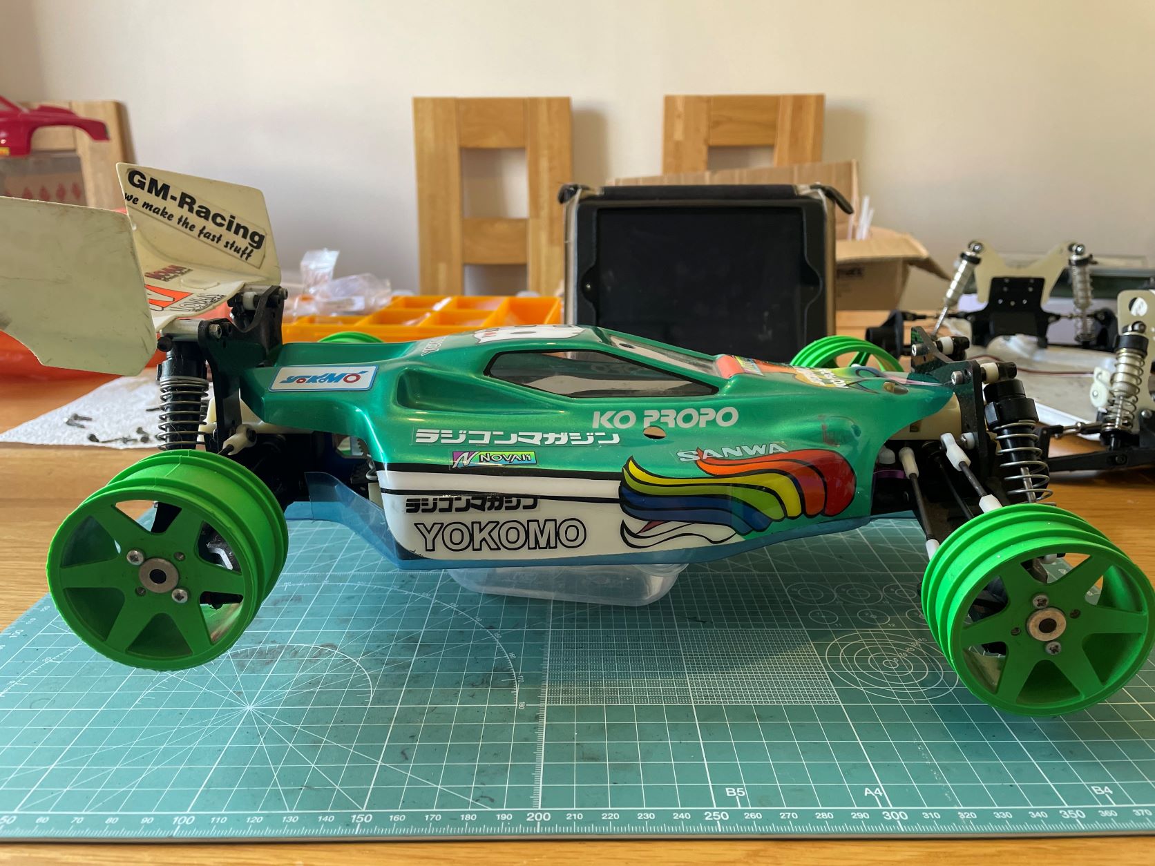

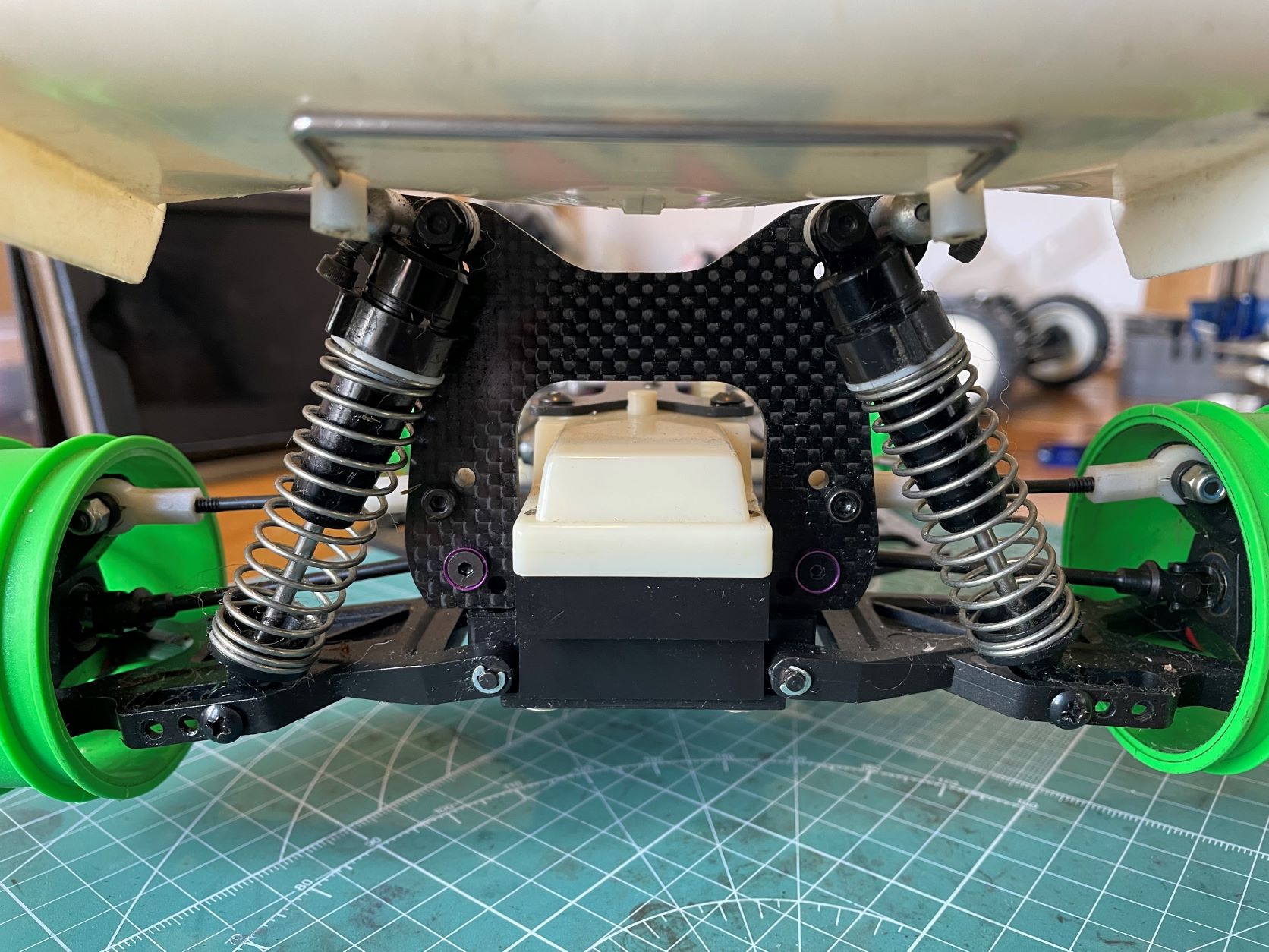

It's landed...
A few non-standard bits I think. Looks like nylon bulkheads. If anyone spots anything that's not Works '91, please let me know.
Looks reasonably clean, so a brief tidy up, fit it out and see how she runs.

Re: Works 91 completion
Not a lot of factory parts left…..
The chassis, top plate, shock towers and battery straps are all aftermarket, as also the steering rack and the motor mount. The nylon bulkheads as you pointed out are YR-4
Hey, congrats on the pickup, 91’ is a personal favorite of mine, iconic car. Don’t be disheartened by the aftermarket parts, the shocks, arms, turnbuckles, ball cups, diff caps, diffs, belts etc etc appear original or at minimum period/car correct. The bulkheads are nylon but the alloy versions aren’t impossible to find as is the motor mount.
The body is a 95’ but again, fairly easy to find a repo body these days and the blue alloy motor mount some use in the 93-95 versions as a replacement and I am pretty sure they are fairly sought after (heck I am sure someone would trade an original for it).
IMO the hardest ‘original’ part to get your hands on is the top chassis deck/brace (I honestly think someone is hoarding them lol) but a close second are good condition shocks which you already have. Looking forward to watching your build.
