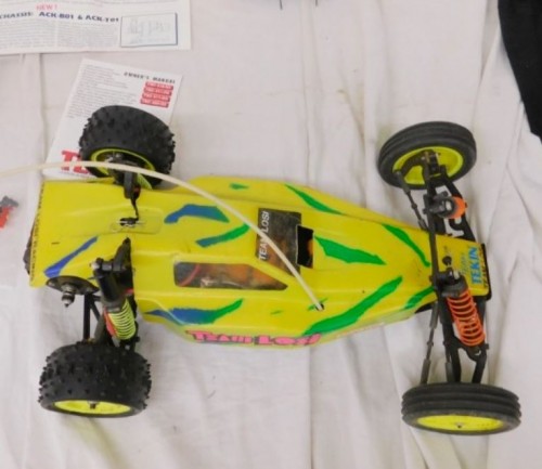

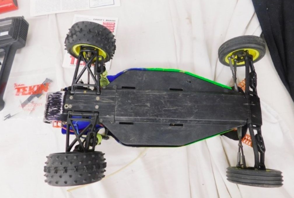

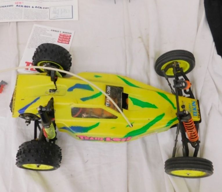

This car won't be concours quality but it is in fairly nice condition.
Early pics as received...

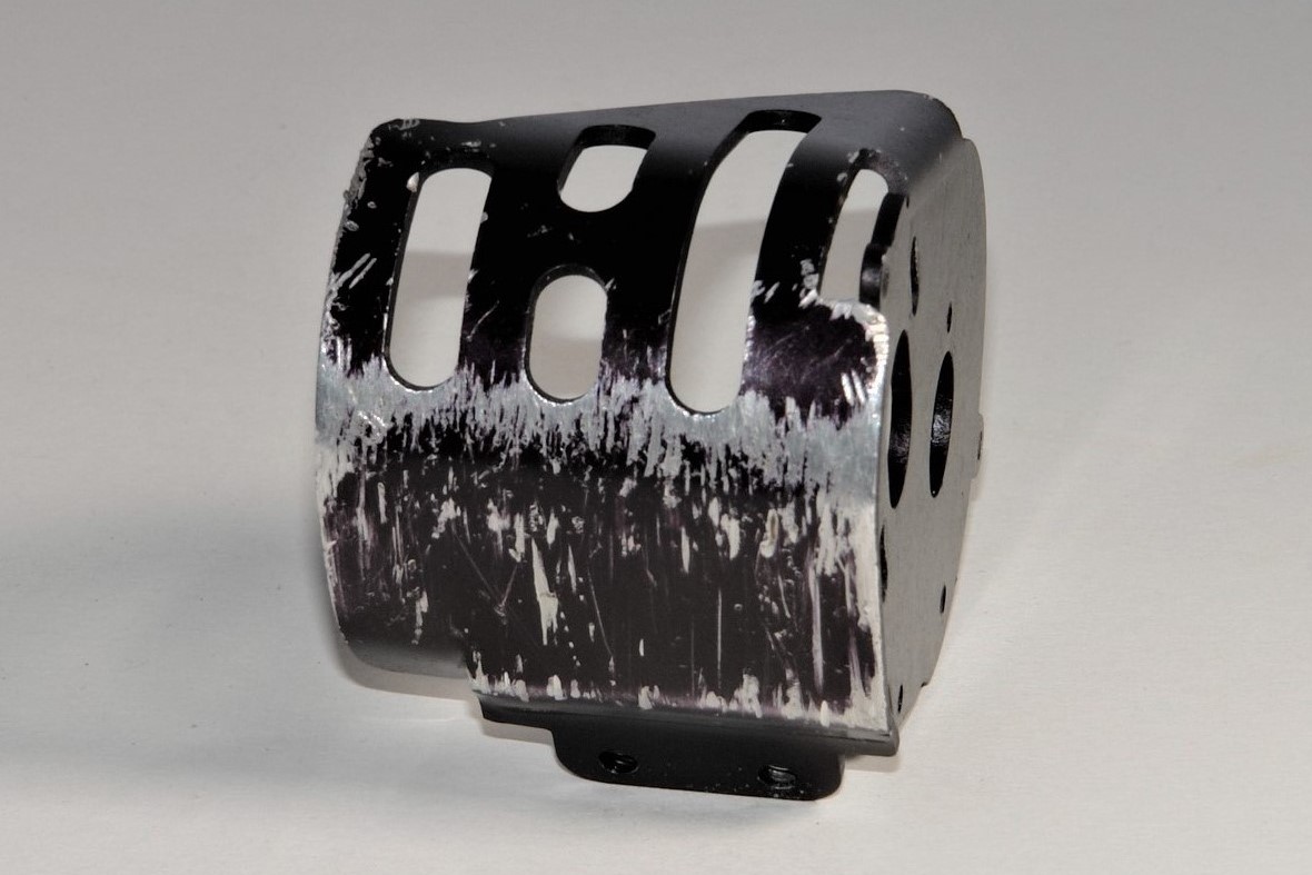

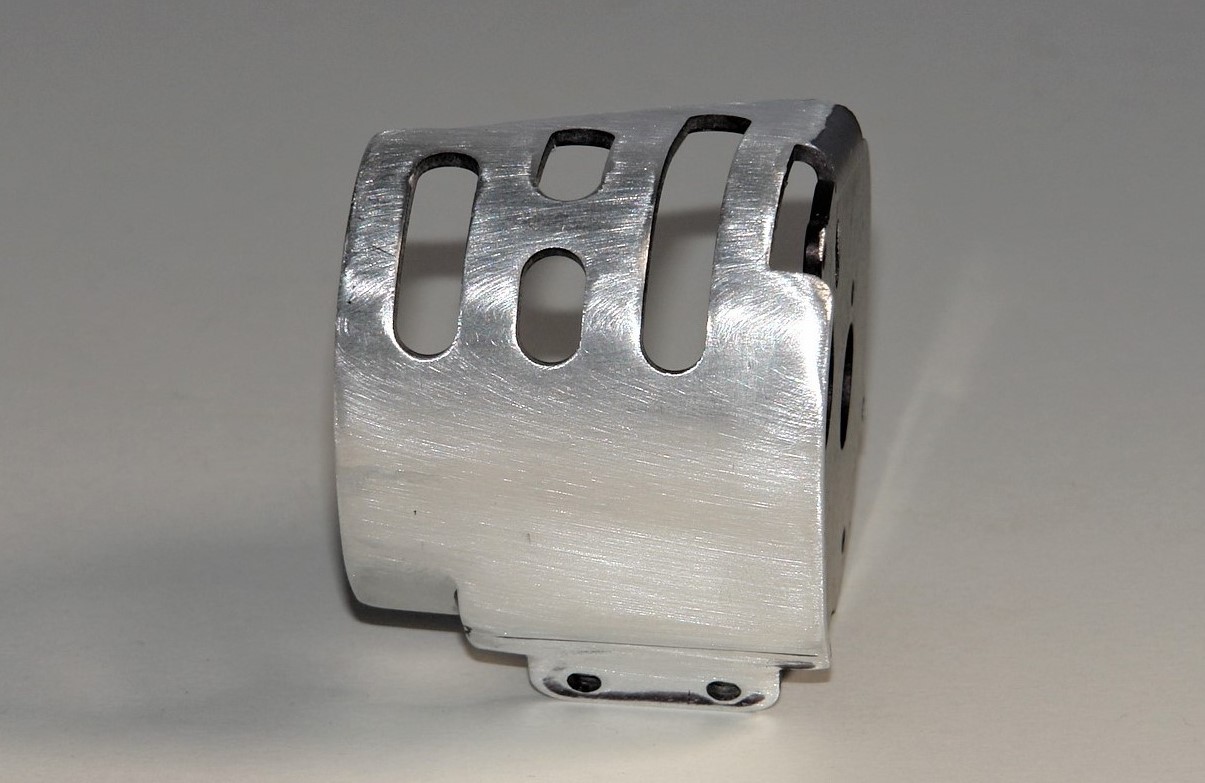

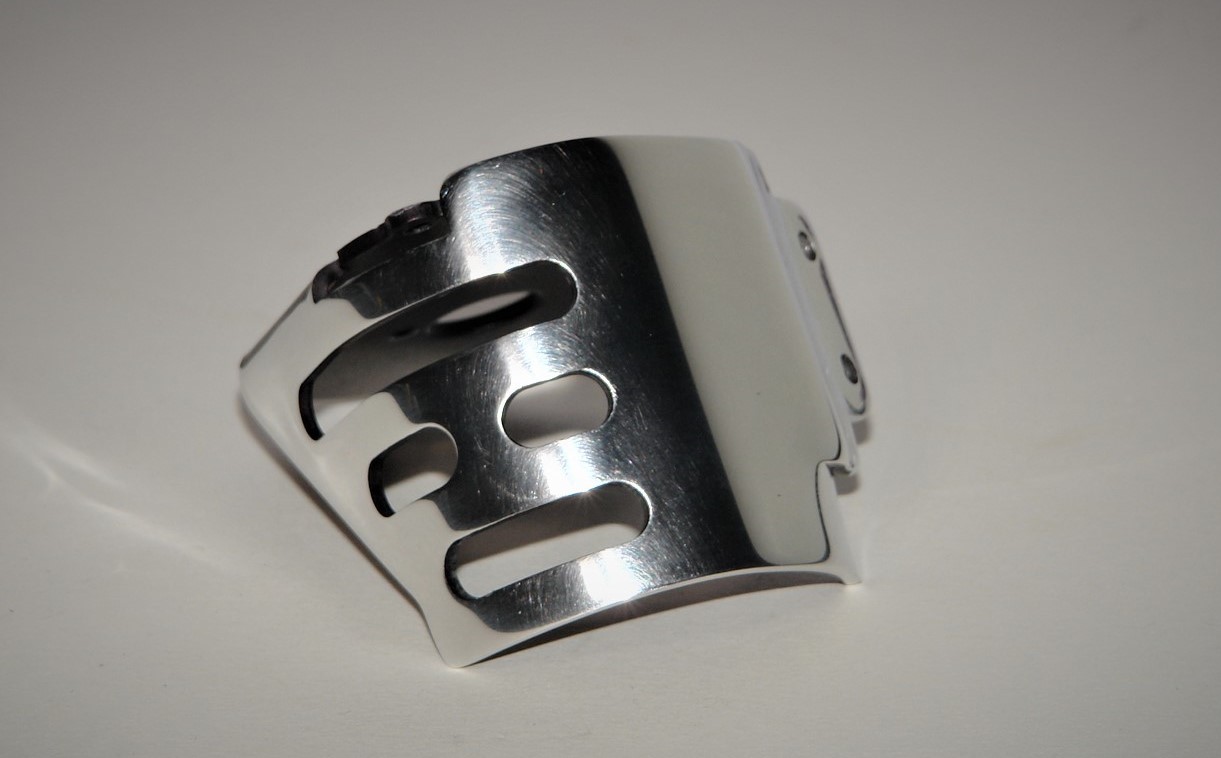

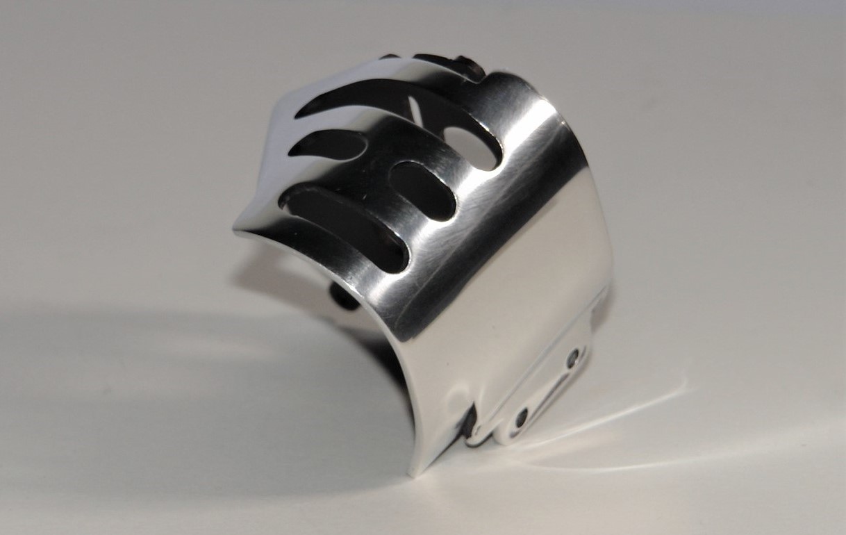

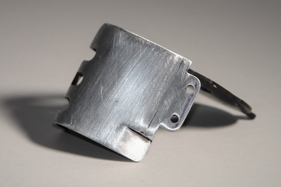

The motor plate is probably the roughest part so I started there.
Then onto sanding... Only the rear portion seems really bad so I am trying a 2 tone anodize.

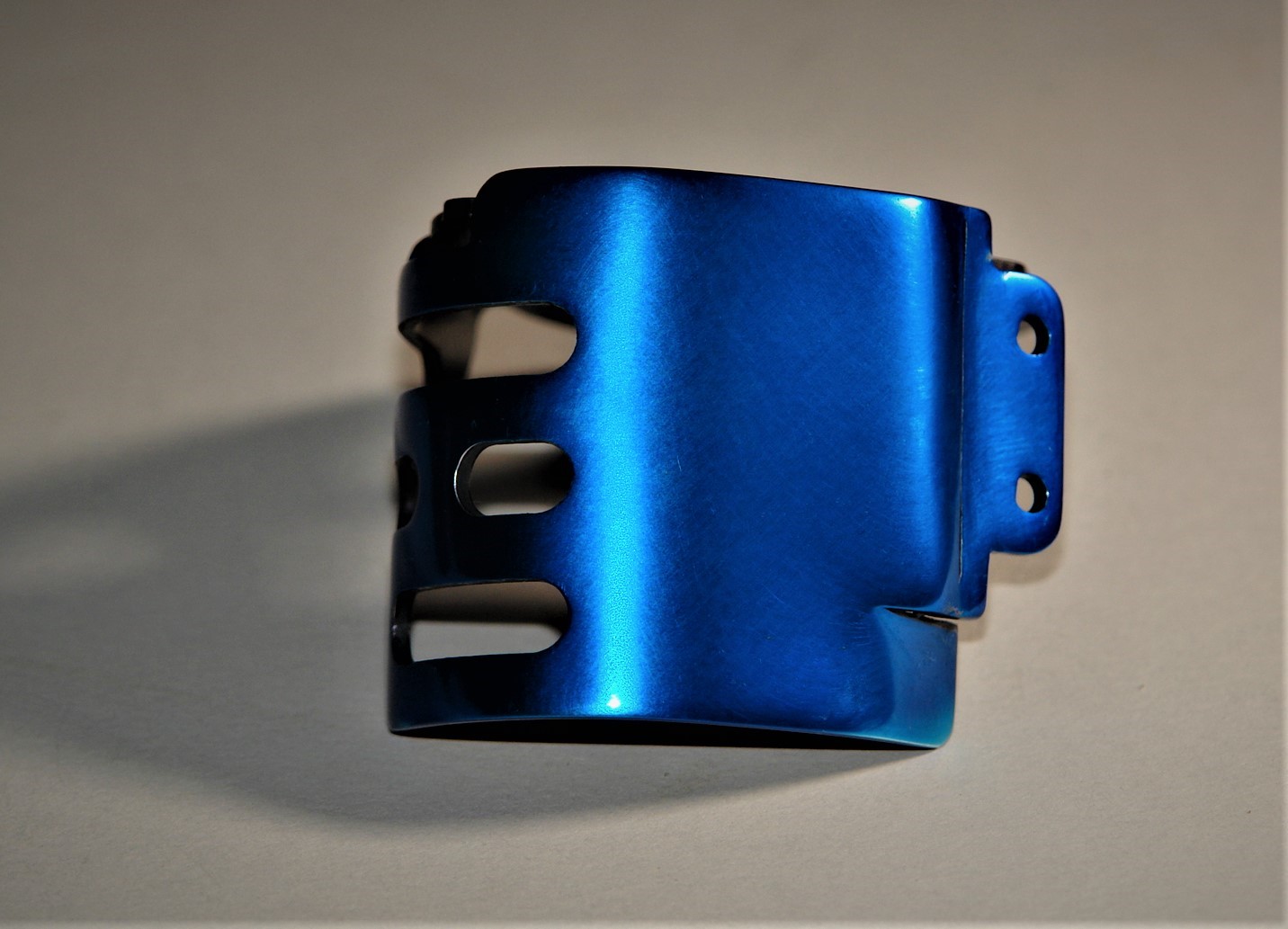

More sanding and polishing...
And the anodizing...

- MarkyDents
- Posts: 1185
- Has thanked: 1802 times
- Been thanked: 642 times
Re: LosiXX #2
Wow polishing before anodizing really makes a fantastic difference !

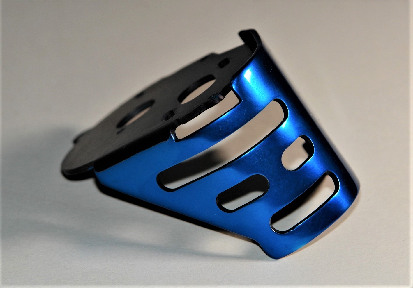

Re: LosiXX #2
And that was not the final polishing. To achieve a nice anodize the final polish must be nearly flawless.MarkyDents wrote: ↑Wed Jan 19, 2022 4:19 pm Wow polishing before anodizing really makes a fantastic difference !
This motor plate is not perfect but pretty nice.
Probably had at least 4 or more hours of sanding/polishing, probably far more.
Then another hour or two of prep before anodizing.
In the ano bath for 2 hours.
In the dye bath for 30 min.
In the nickel acetate sealant for 30 min.
Finally 30 min cleaning, a light buff and light oiling.
Chuck

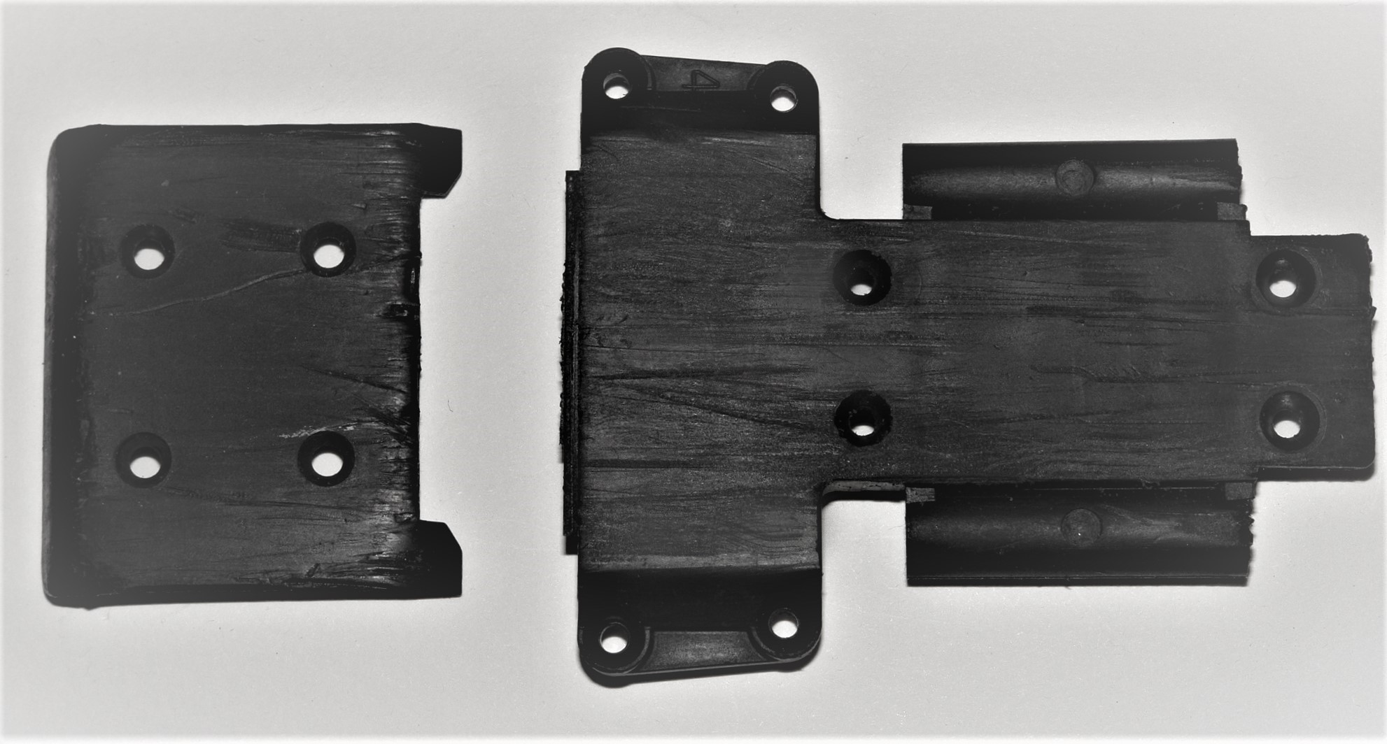

Re: LosiXX #2

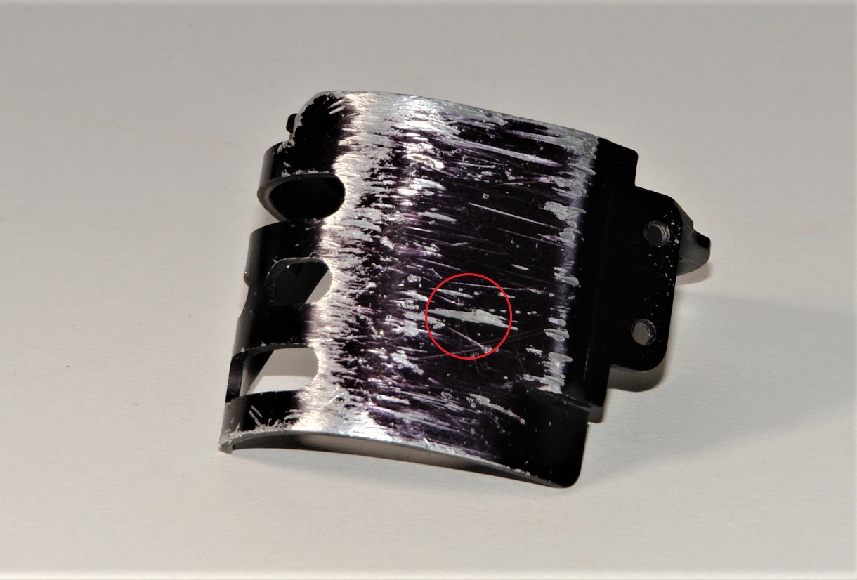

I had been collecting a few replacement parts for a while.
The bumper and rear pivot support were pretty torn up.
Went ahead and completely cleaned everything.

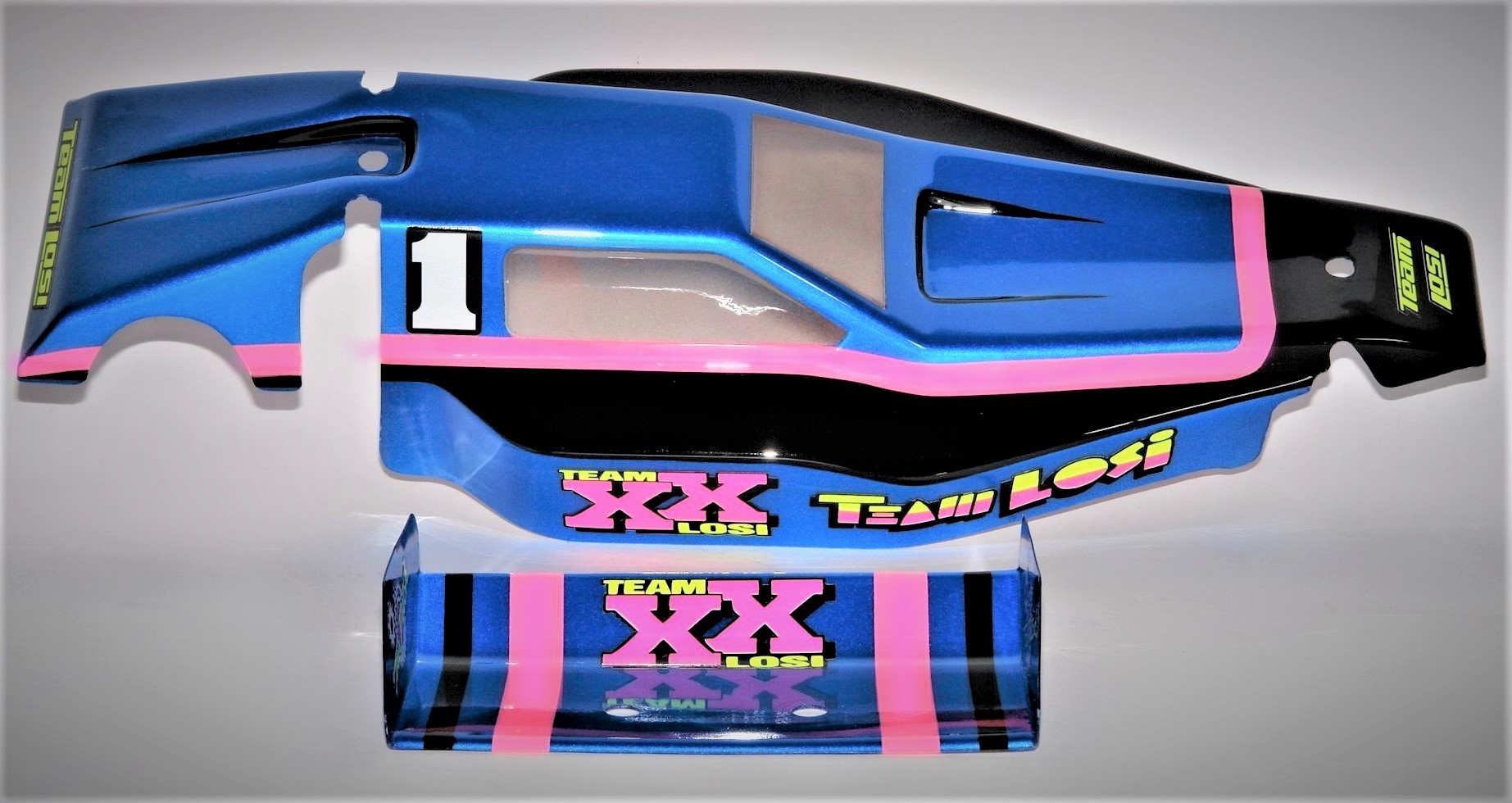

Got a Boki body and gear cover, new RPM ball ends, wheels , wheel covers and tires.

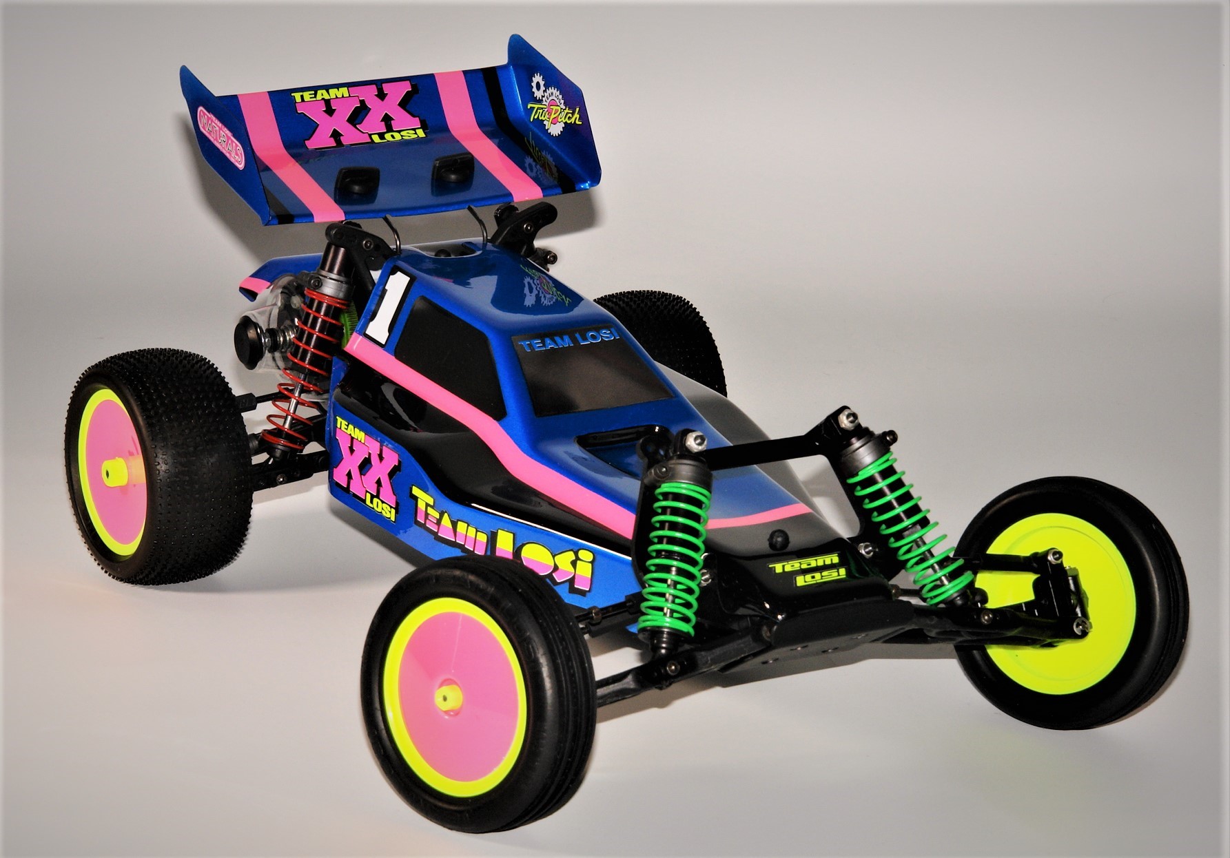

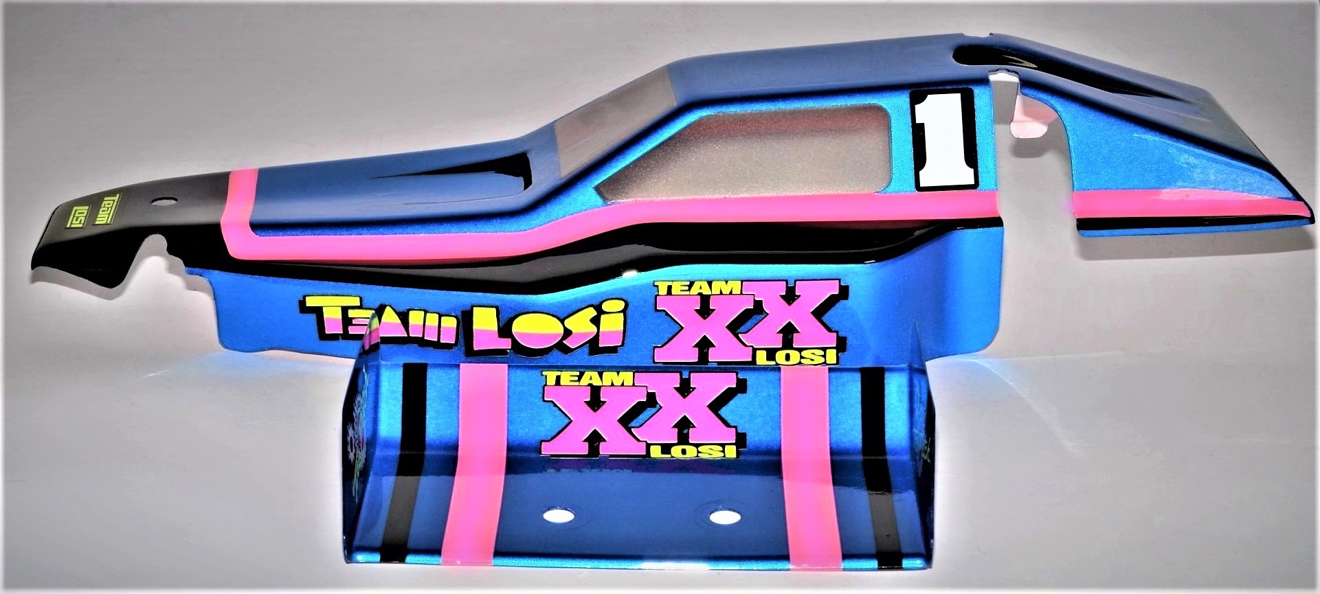

The Boki body turned out pretty nice.
Box art-ish but that Faspearl blue spoke to me after the motor plate was anodized.
- radioactivity
- Posts: 854
- Has thanked: 383 times
- Been thanked: 608 times

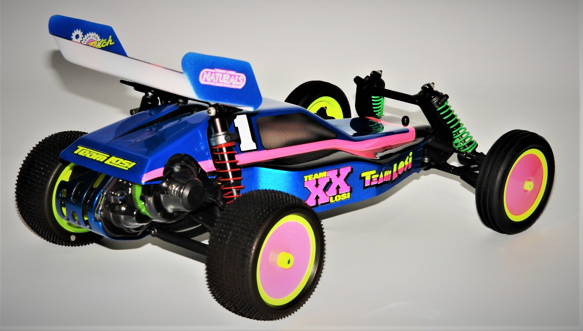

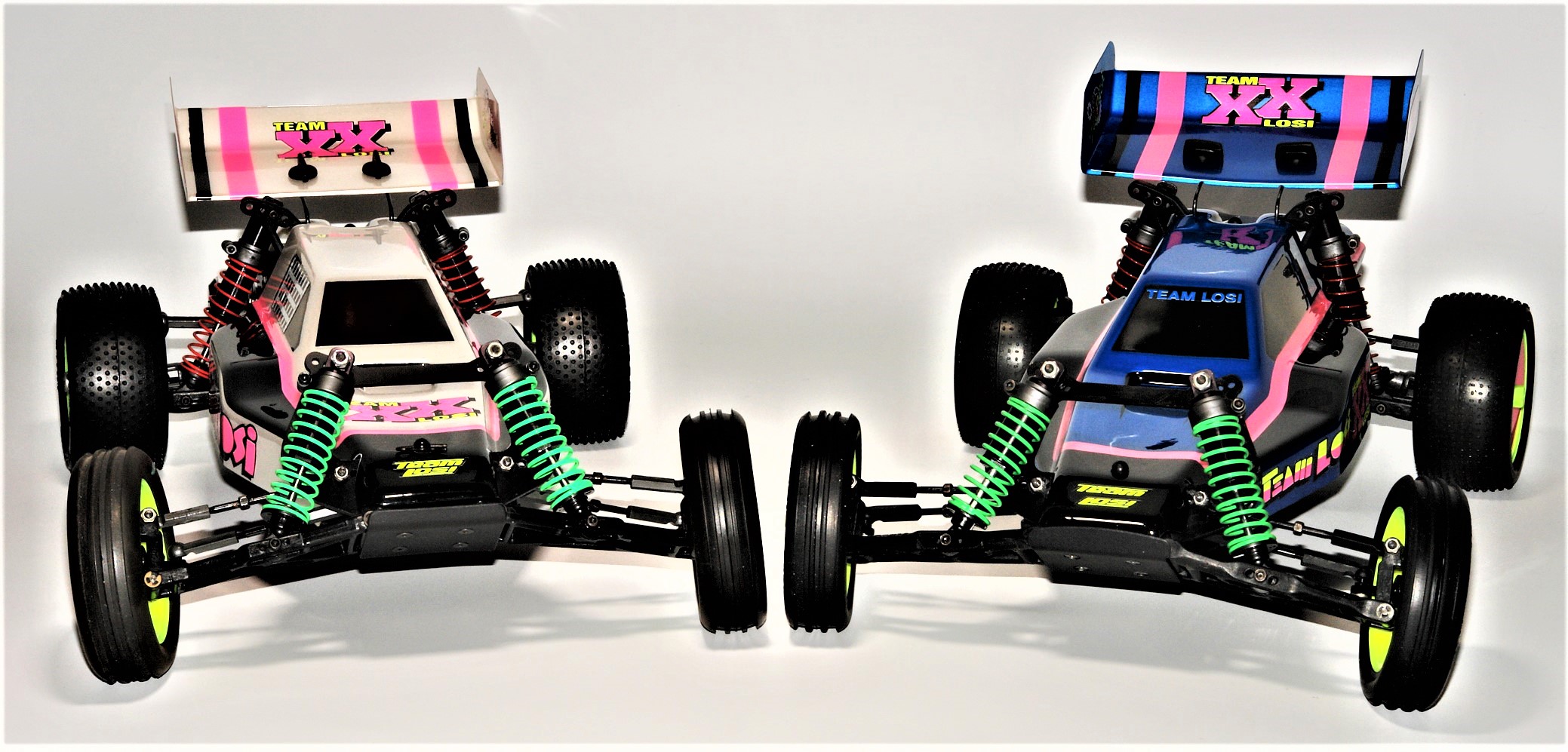

Re: LosiXX #2

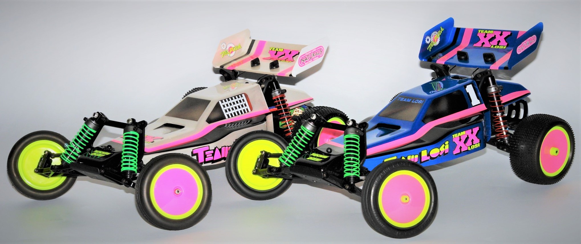

And after a little more body trimming
And with it's brother
Chuck
Chuck
- MarkyDents
- Posts: 1185
Re: LosiXX #2
Oh man that came out amazing !!
Very well done

- Frankentruck
- Posts: 3677
- Location: Texas, USA
- Has thanked: 2520 times
- Been thanked: 2824 times
Re: LosiXX #2
Wow. Very period correct styling. Totally rad dude.
