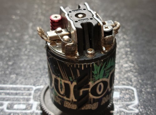

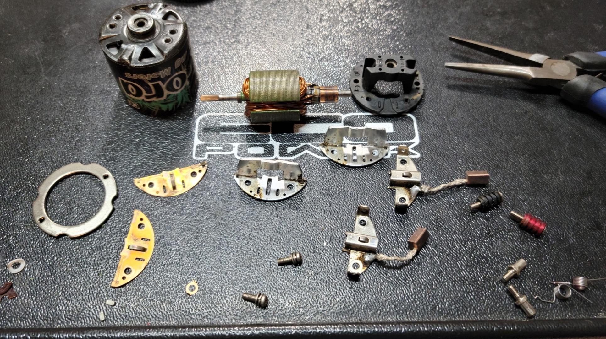

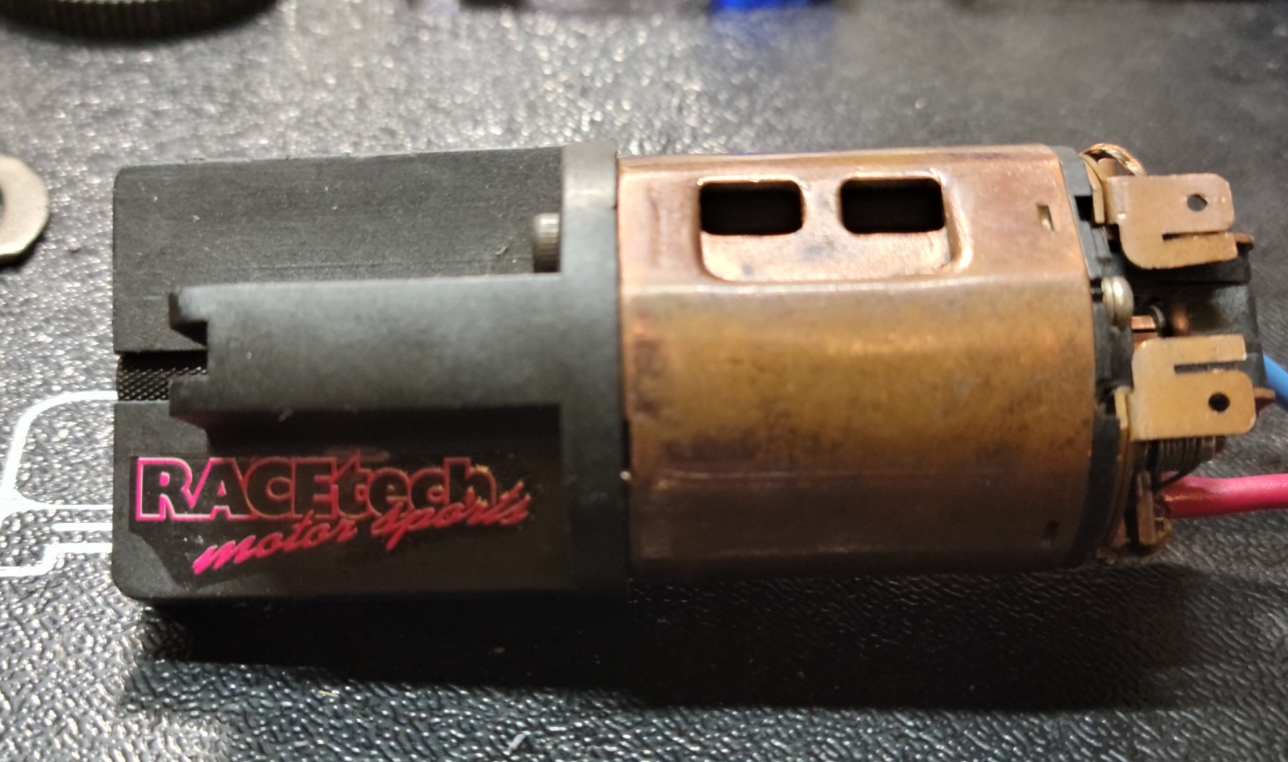

I rummaged through my stuff and found this crusty Peak Racing 12X2. It looks like a good candidate.

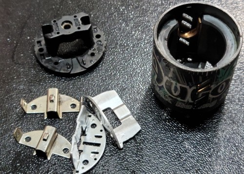

Start by disassembling everything. This one has removable brush hoods, so more detailed work can be done.

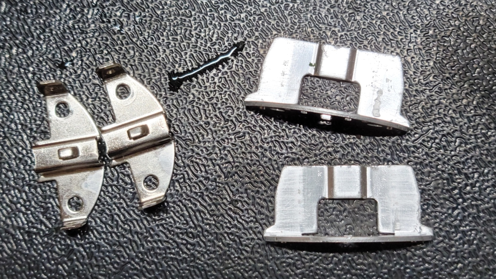

Holding the brush hoods with smooth jaws needle nose pliers, I use a mini torch and brass brush to remove any solder. In this case, I also removed the soldered on brushes as well.

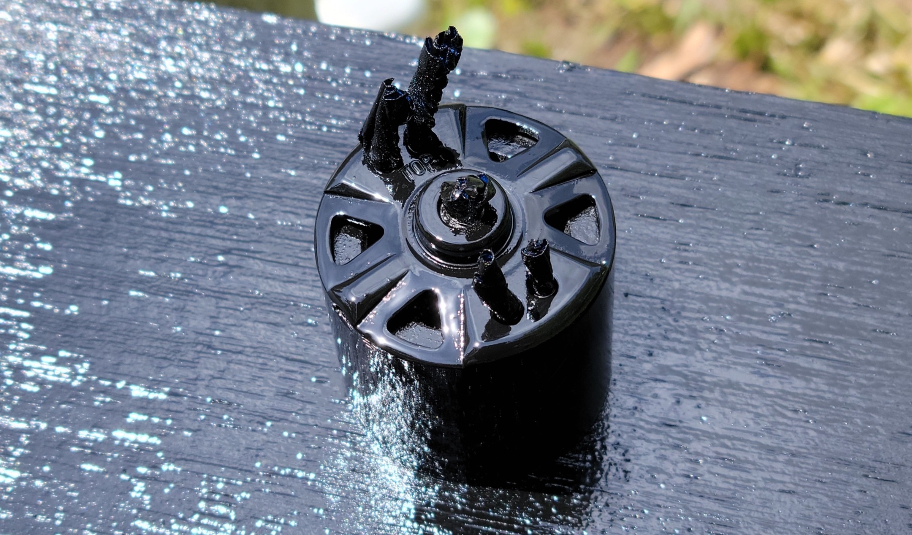

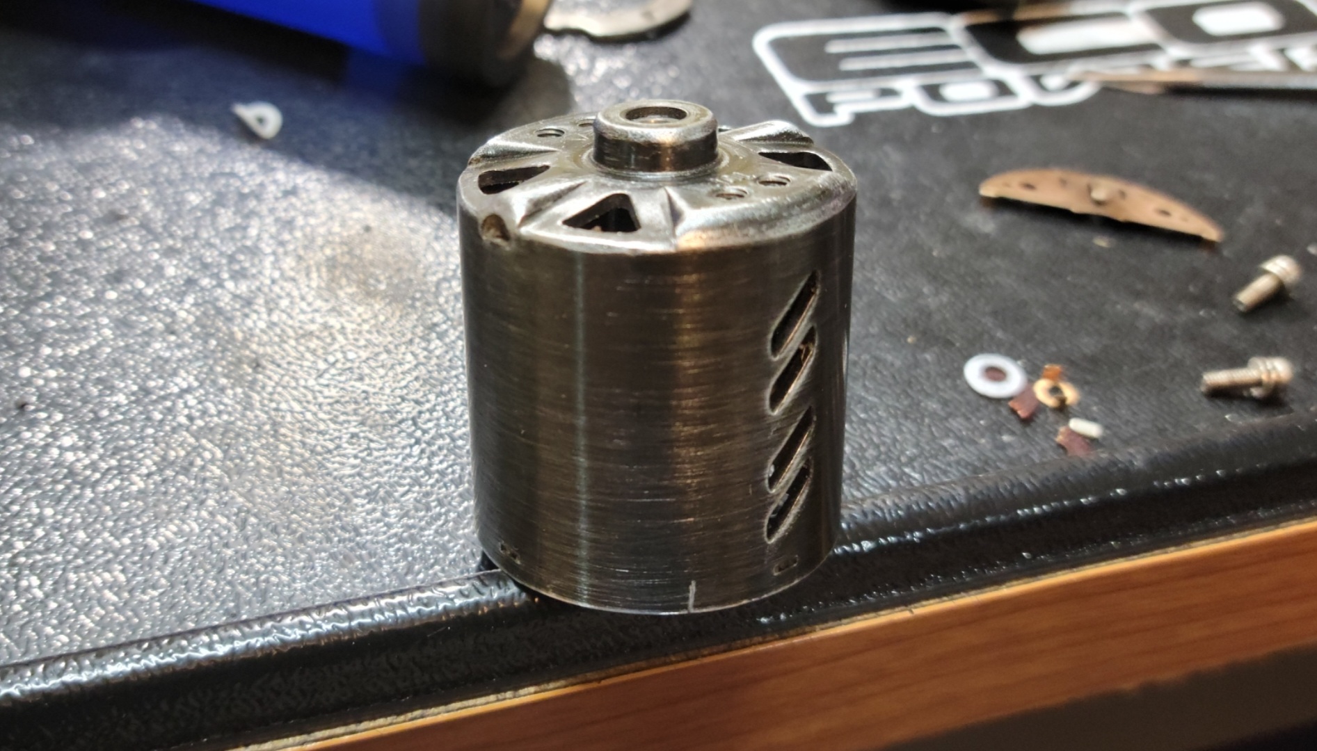

I then remove the decal and prep the can for paint, if necessary. The decals can sometimes be troublesome, this one required acetone to remove all the adhesive. It then got scuffed with a fine sanding block (foam).
If the can is chrome, I'll just try to clean it up. If necessary, I'll buff it with a fine sanding block.

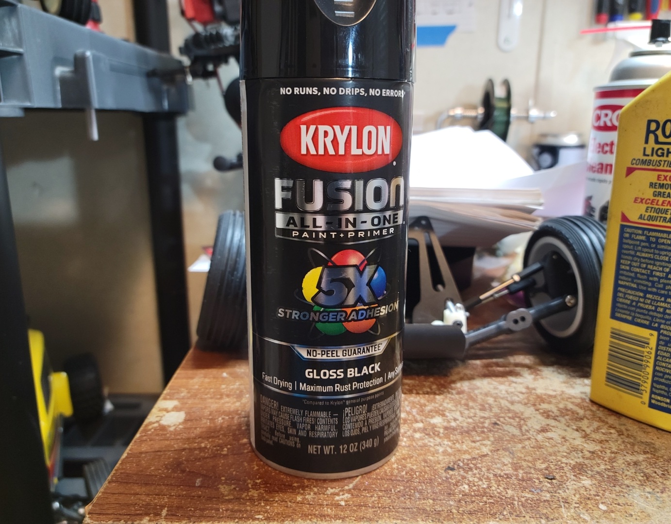

This is the paint I use, Krylon Fusion. It isn't ultra high temperature paint but it bonds well. If you think that you need high temperature paint, consider engine enamel.
I put tape through the mounting holes and bearing, and stuff the can with a paper towel. Then, 2-3 light coats. Give it at least an hour to dry.

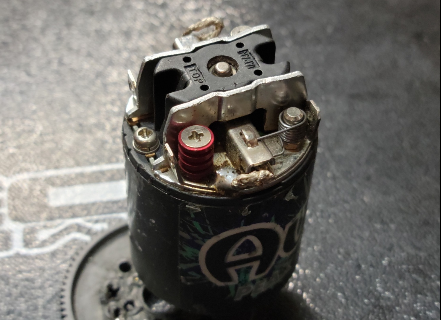

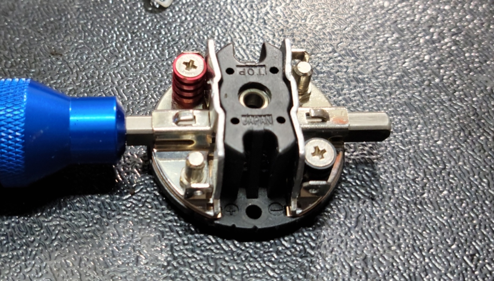

While the paint is drying, I reassemble the endbell. If you have the tools, now is the time to align the brush hoods.

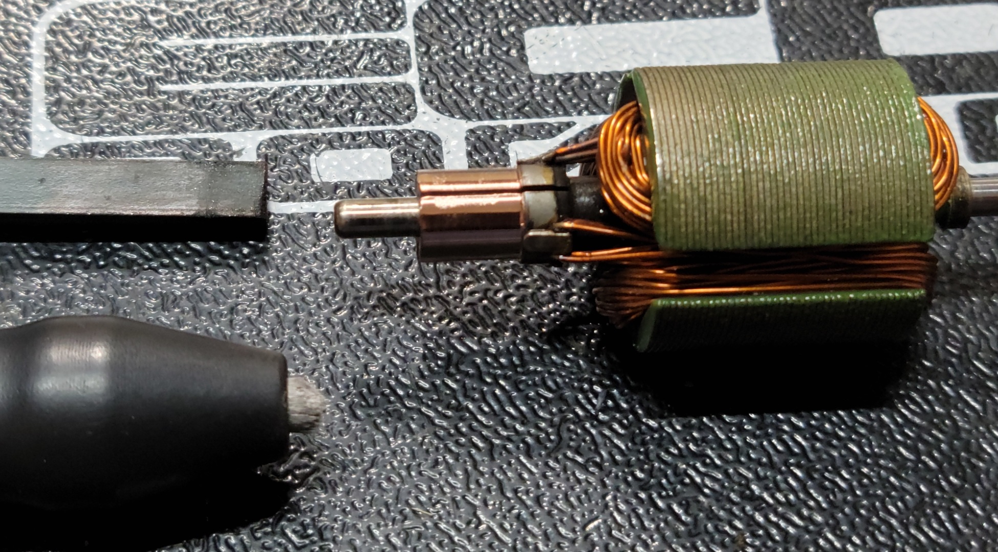

This comm didn't need to be cut. It cleared up nicely with a comm stick and fiberglass pen. I'll pick back up with reassembly later.

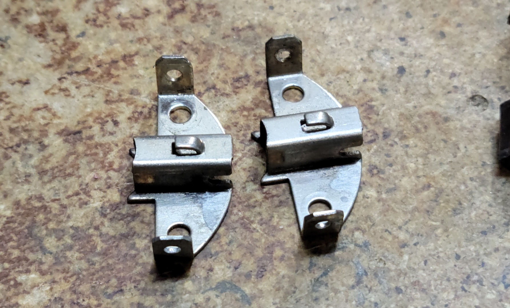

After painting the can, before reassembling the endbell, I polished the brush hoods. I used a rotary tool with a nylon brush wheel, with Brasso.

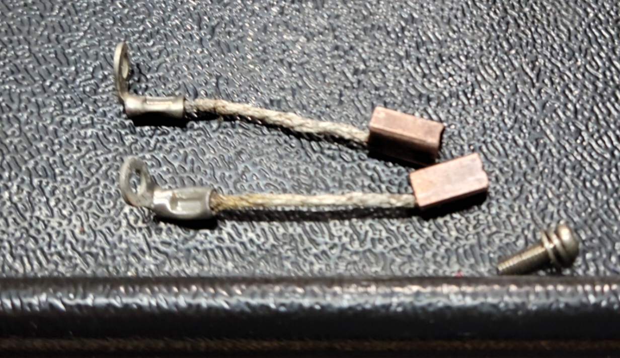

While waiting for the paint to dry, I decided to rehab the brushes as well. I was just going to put new ones on but these were in good condition and it goes with the thread.
I crimped and soldered new terminals on. These are #4 hole, 18-22 gauge, from ebay.
I then took one of my brush cutters and trued the faces.

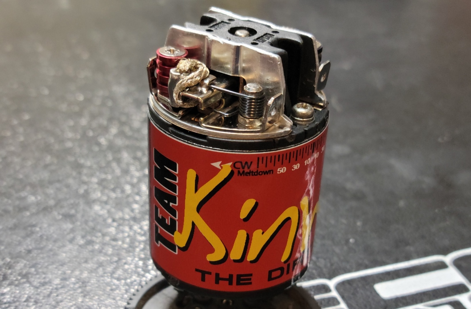

Got it back together.

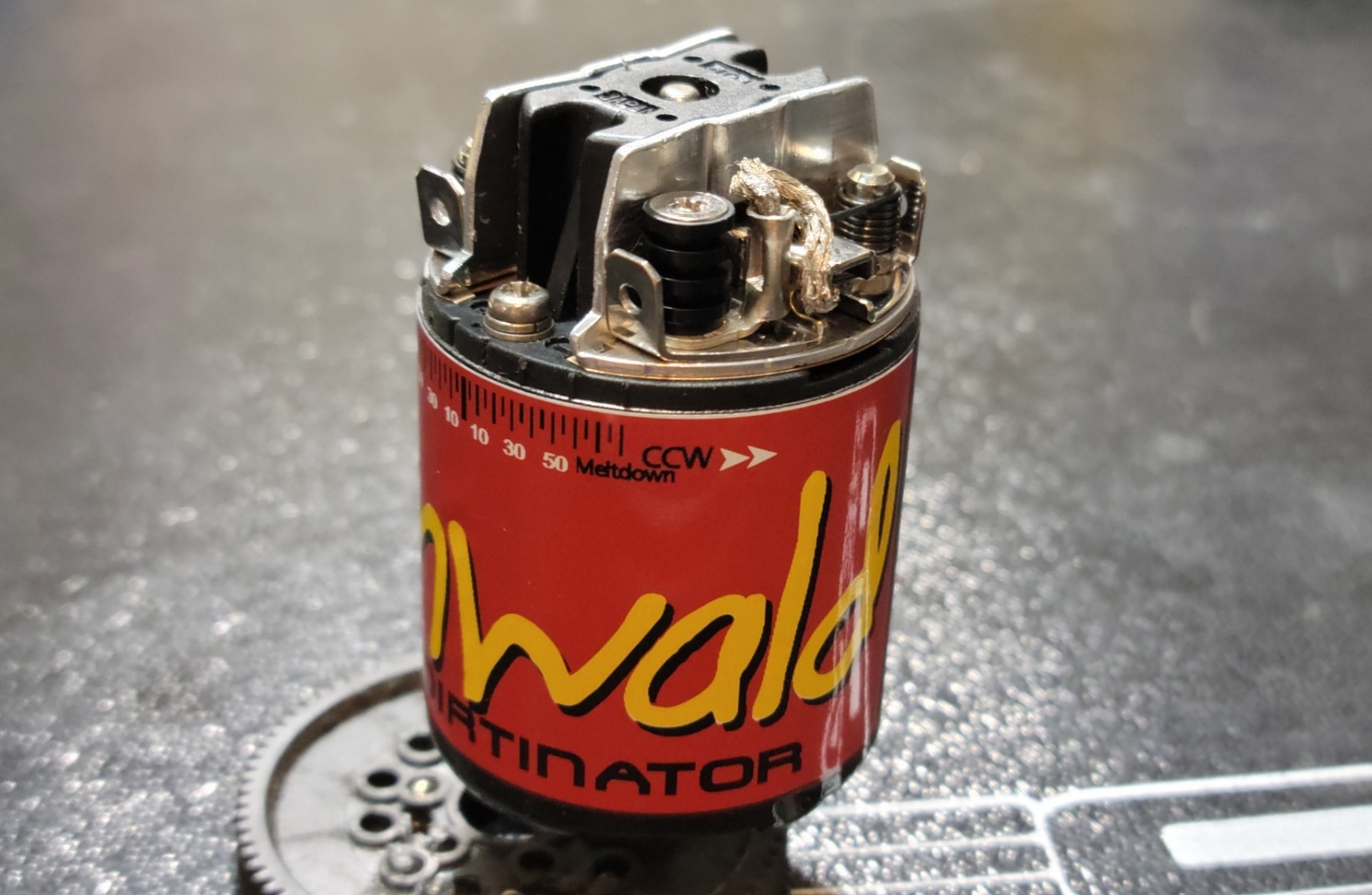

Whoever was in this motor before, had the armature endplay way too tight. I adjusted the endplay and centered the armature in the magnetic field.
I reassembled it with new Trinity springs and the old brushes.
I checked rotation before installing the decal, so that everything would line up like I wanted.
Since this decal has timing marks, I also verified the timing location before installing it.
I don't think it turned out too bad.
