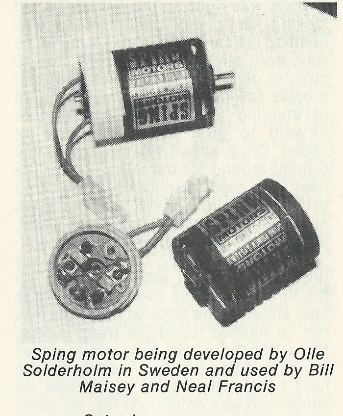

Regarding Sping, this is another mystery. Yes they made some very special motors and I would like to own one of theirs Modified. Same for the early Trinity slotted can motors. But I don´t believe the Trinity can actually was a Sping. Yes they look very similar made and the Sping picture unfortunately isn´t that detailed. But if you enlarge the picture, you can see the Sping and Trinity can doesn´t have the same number of slots.
BTW the Sping modular endbell looks a lot like a Checkpoint to me. I mean not similar, I think it´s a Checkpoint.

I have one more Sping advert here. Endbell not as clear as it is too bright, but the can slots are obvious.
