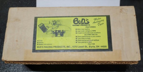

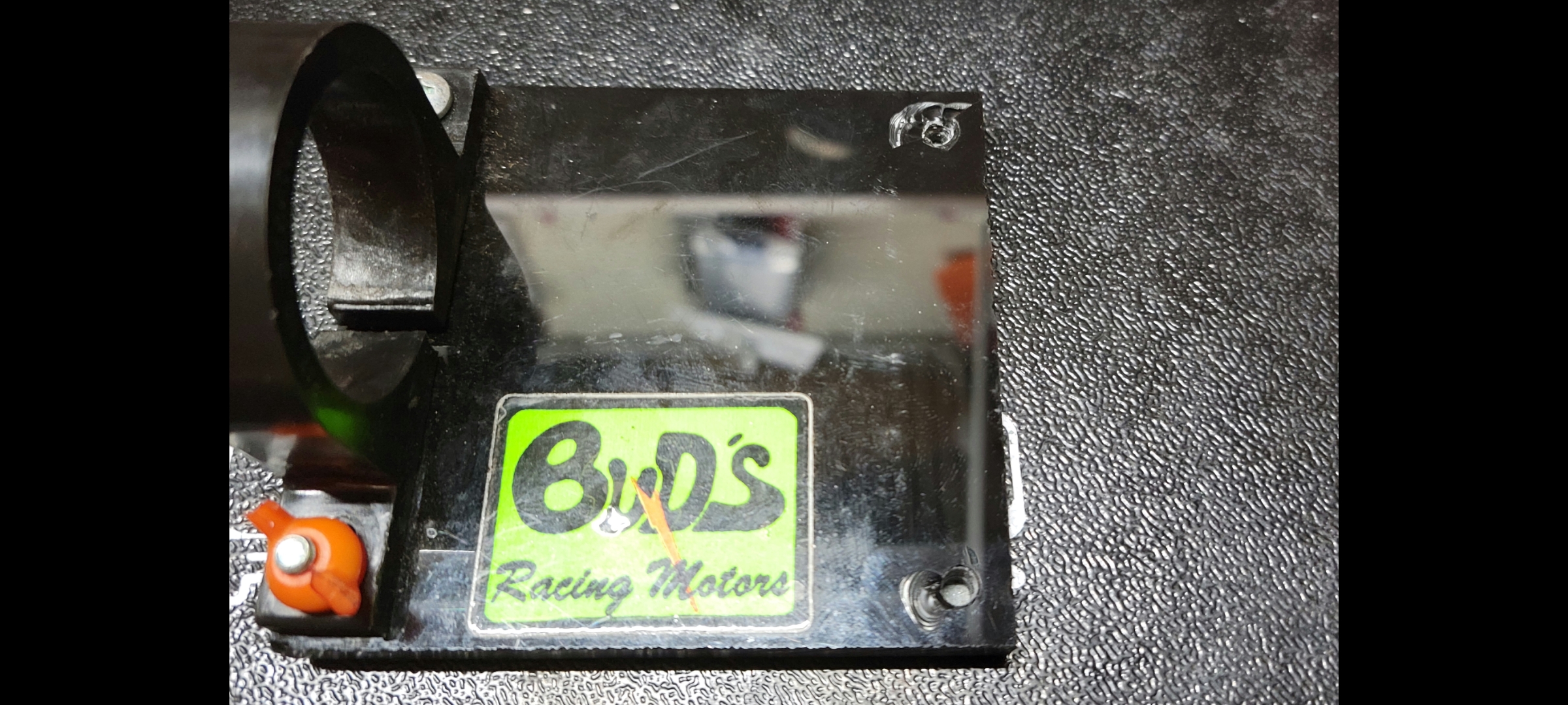

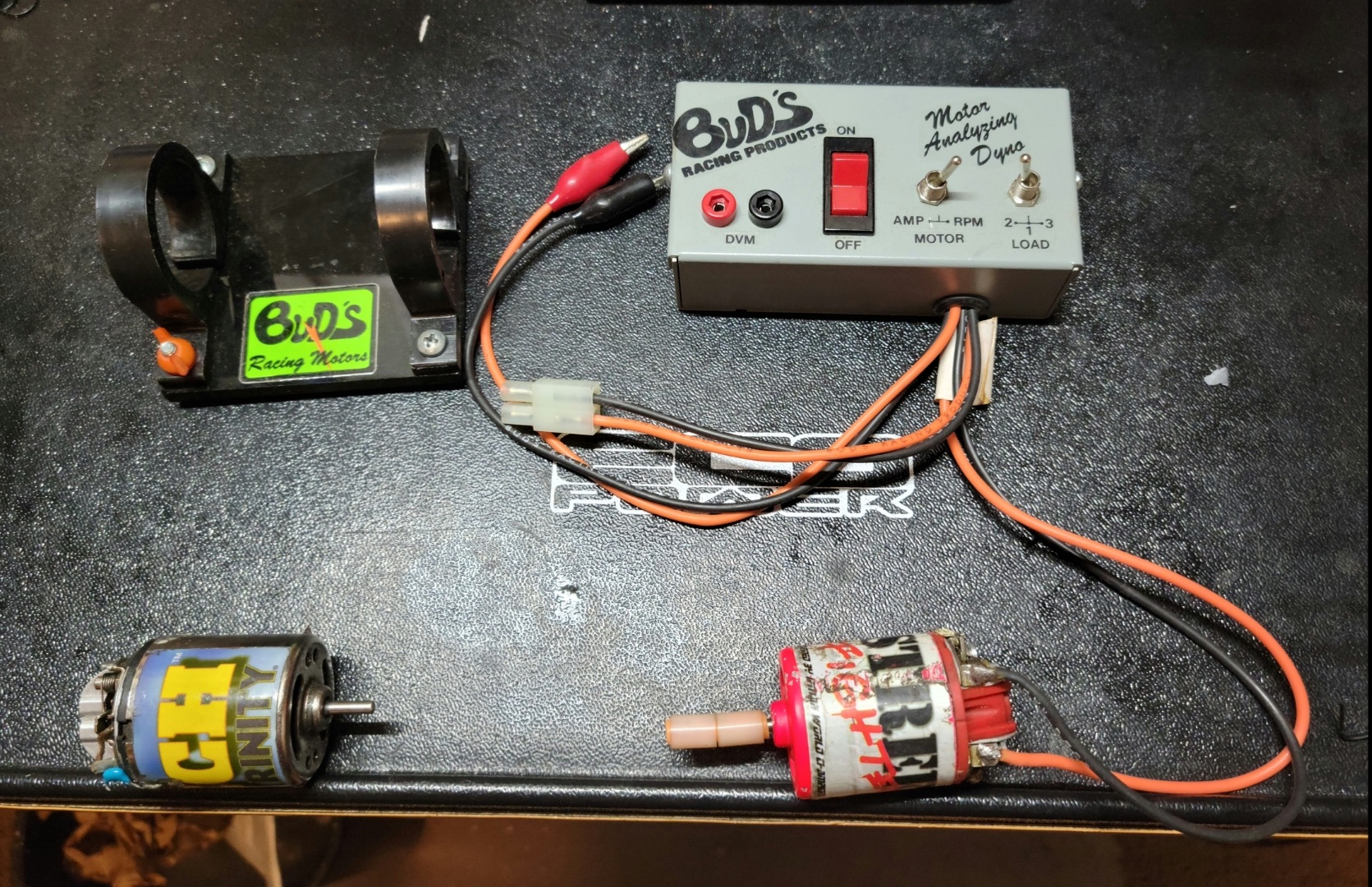

Just getting this started. It'll be a little while before I can put any data together.
Anyway, I picked up this Bud's motor dyno, complete with box, instructions, and a couple motors.

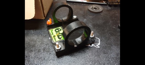

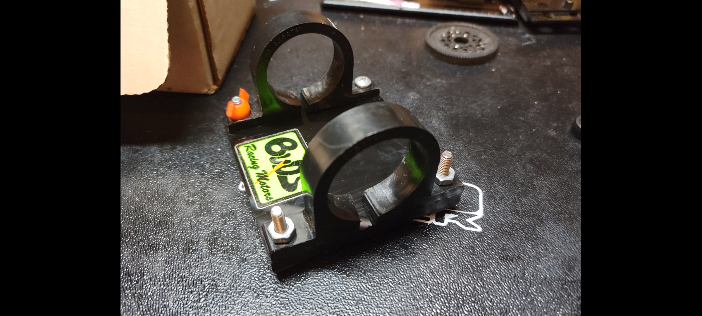

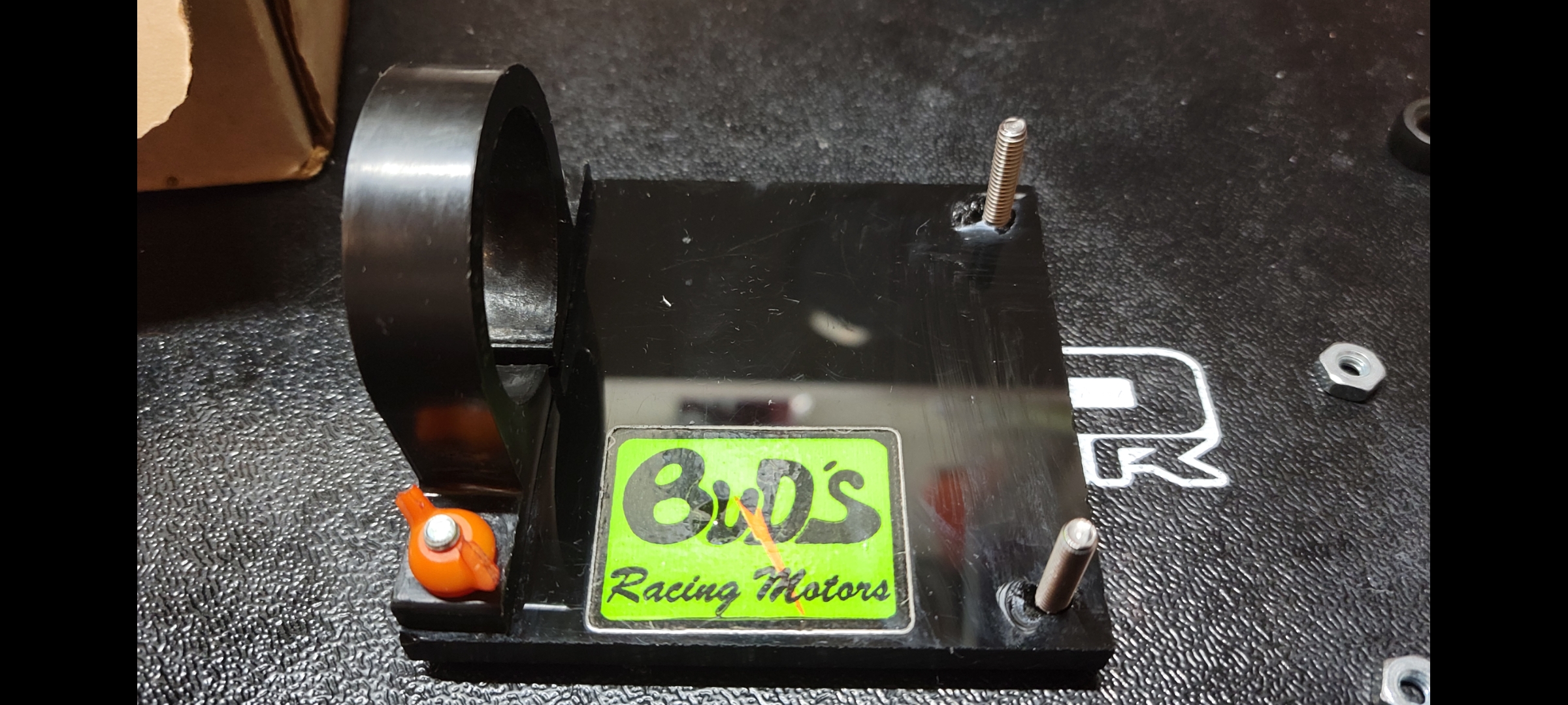

First, I had to make a couple small repairs. It came with self-tapping 8-32 screws, which had partially stripped and damaged the phenolic plastic base.
I replaced them with studs, installed with CA glue.

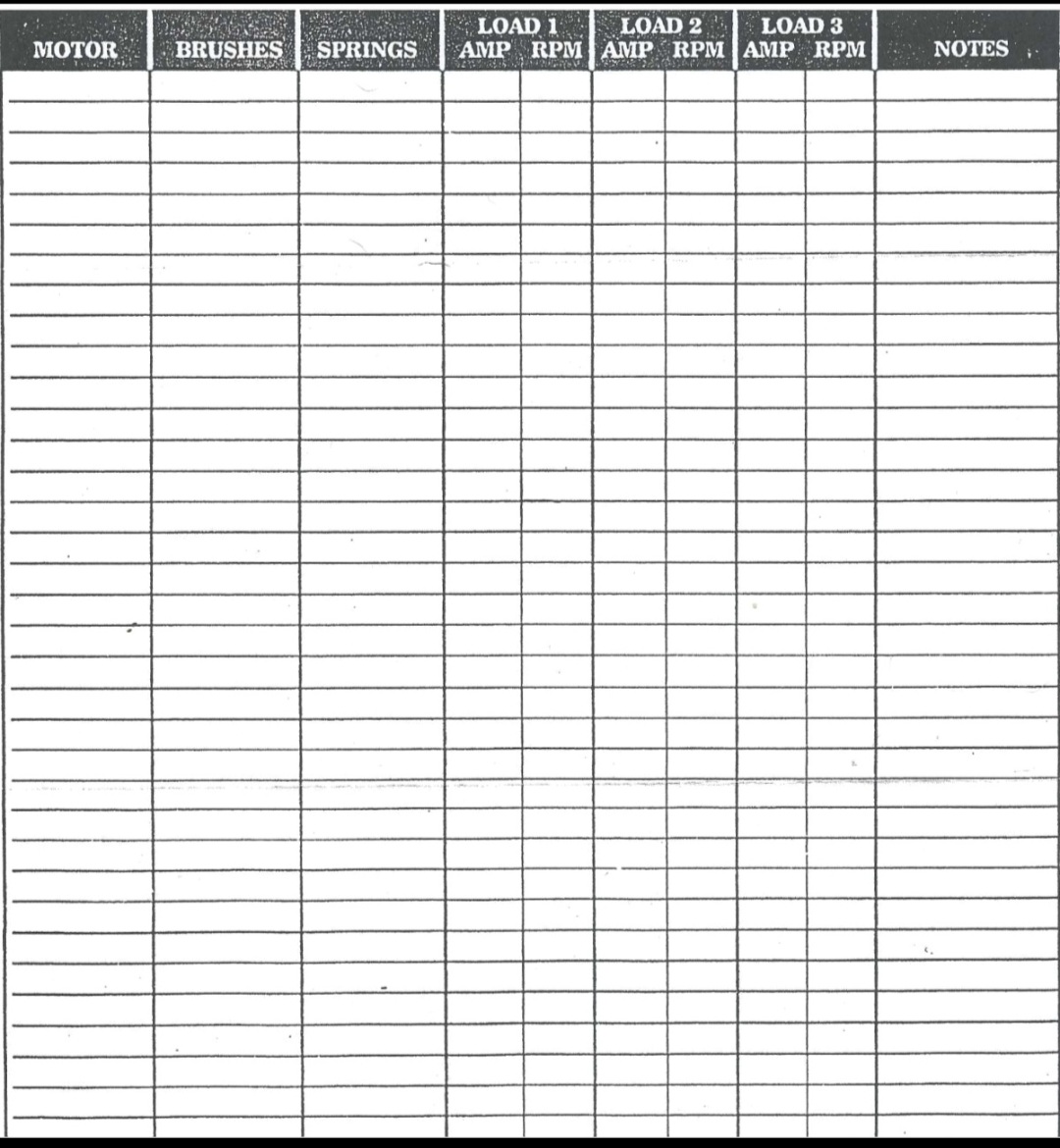

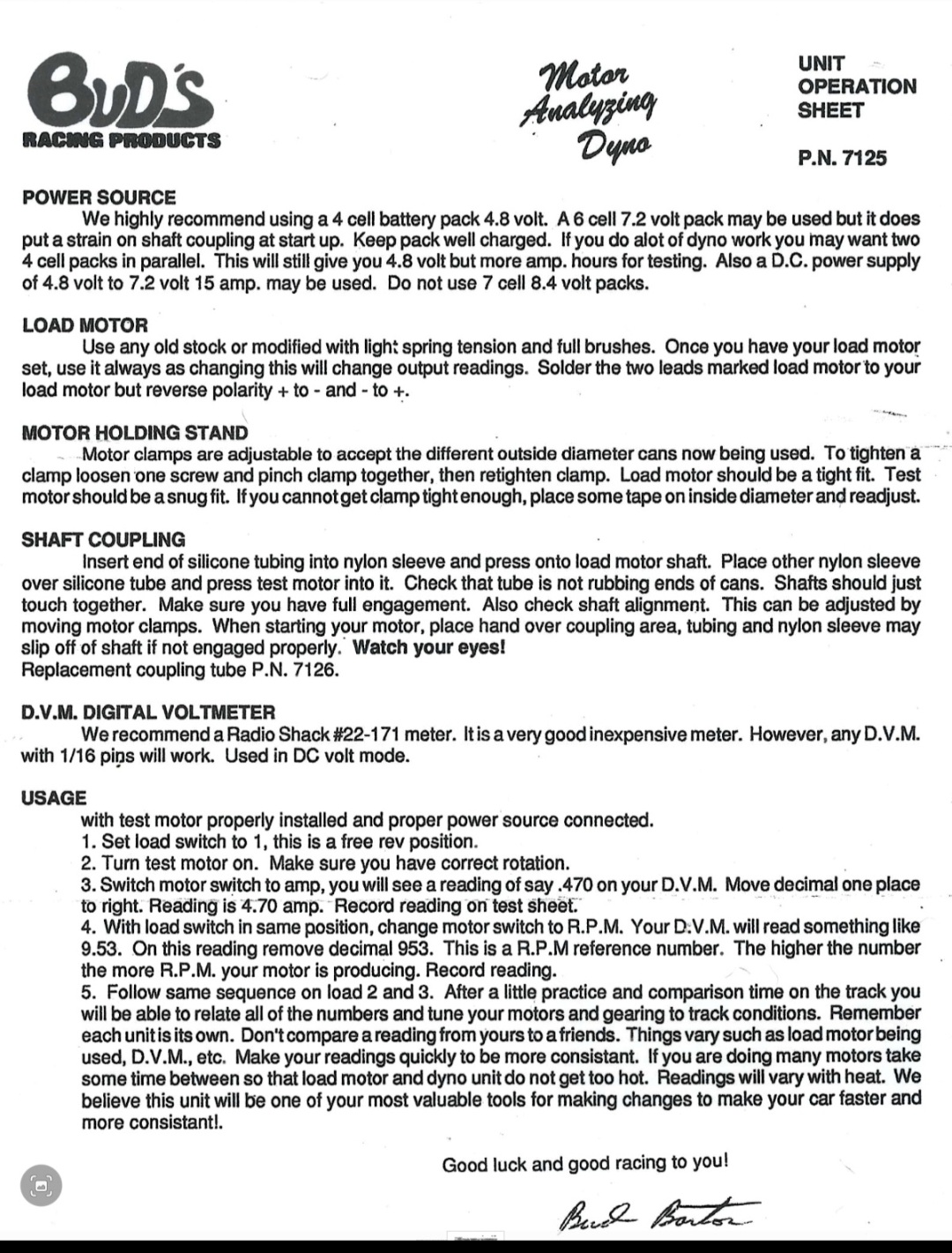

I got the scanner linked up with my tablet and was able to scan the directions.
I also scanned the data sheet. For some reason, the scanner removed the header from the page.
I also borrowed a page from the Tekin dyno manual, about making a dedicated slave motor.

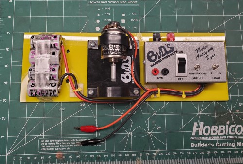

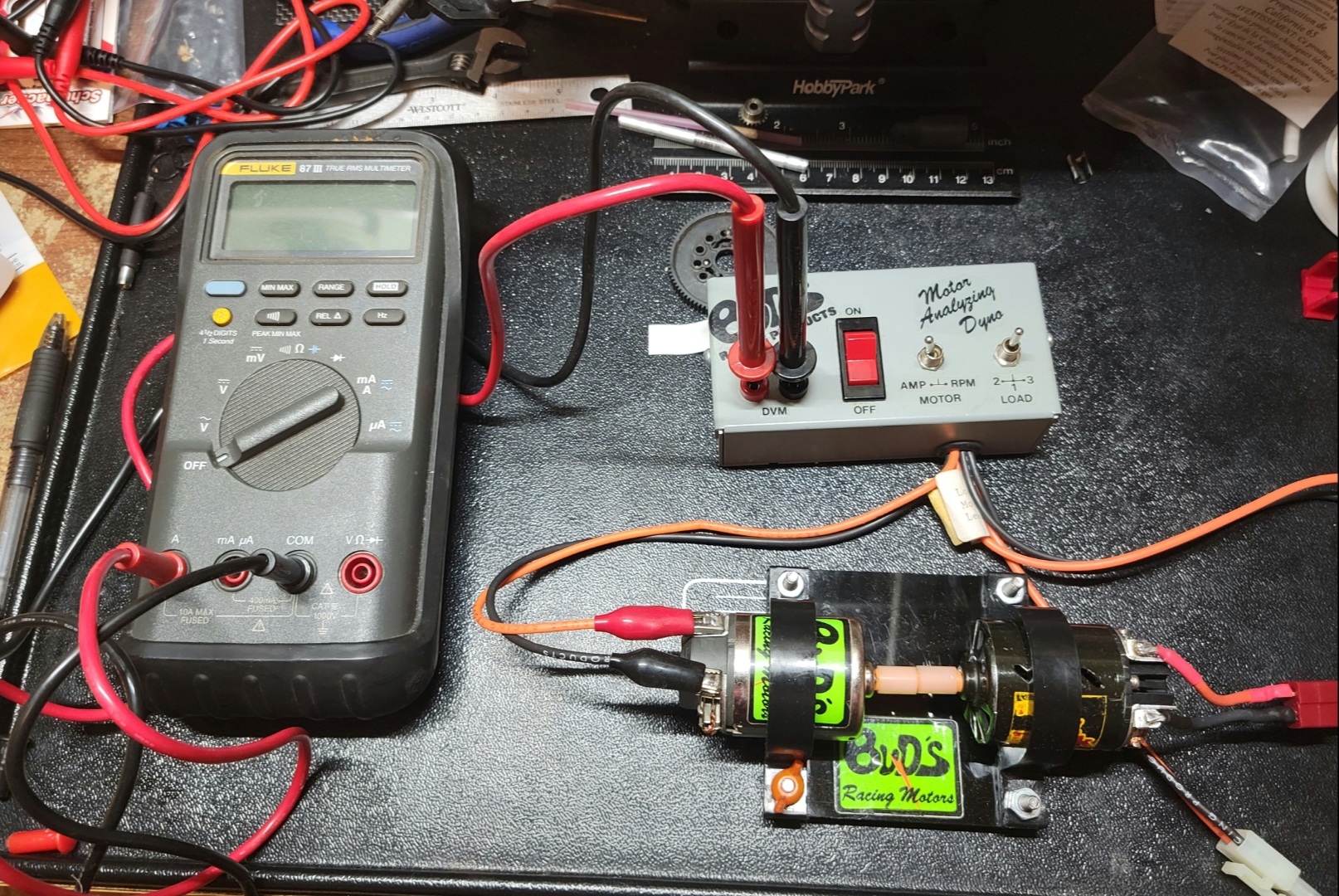

I built the slave motor and decided to try it.
Apparently, the cheap Kobalt DVM that I bought doesn't range very well, so I had to use my Fluke. Or at least, I might need to learn how to use a cheap meter.
I didn't try to get any useabe data, just verifying that it loads up and displays some type of data.
I've also got to figure out how to adjust the auto-range on my Fluke meter.

That's what I remember from the 80s....it never told rpm, just a random # that u had to use as a reference point...still classic tho

Yeah, I had one, probably still have it around here somewhere...it worked great for determining motor performance when custom cutting brushes and matching springs or playing with timing. Not a scientific tool obviously but it was cheap and worked fine for what it was...

Or a better meter.juicedcoupe wrote: ↑Fri May 13, 2022 8:50 pm Apparently, the cheap Kobalt DVM that I bought doesn't range very well, so I had to use my Fluke. Or at least, I might need to learn how to use a cheap meter.
