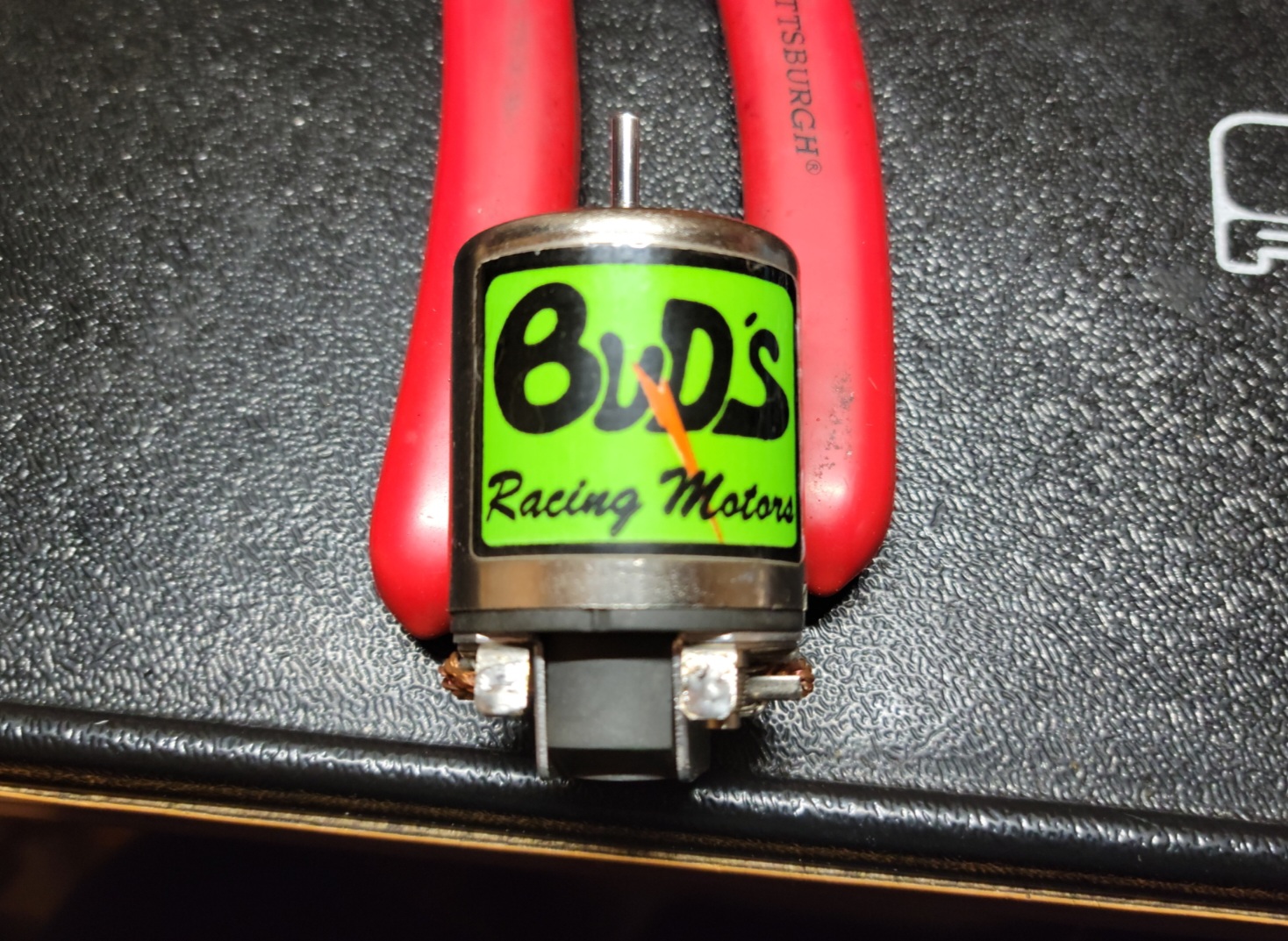

I received this Bud's motor a while back with a car. Seeing the bent tabs on the can, I just assumed that it was a common stock motor.

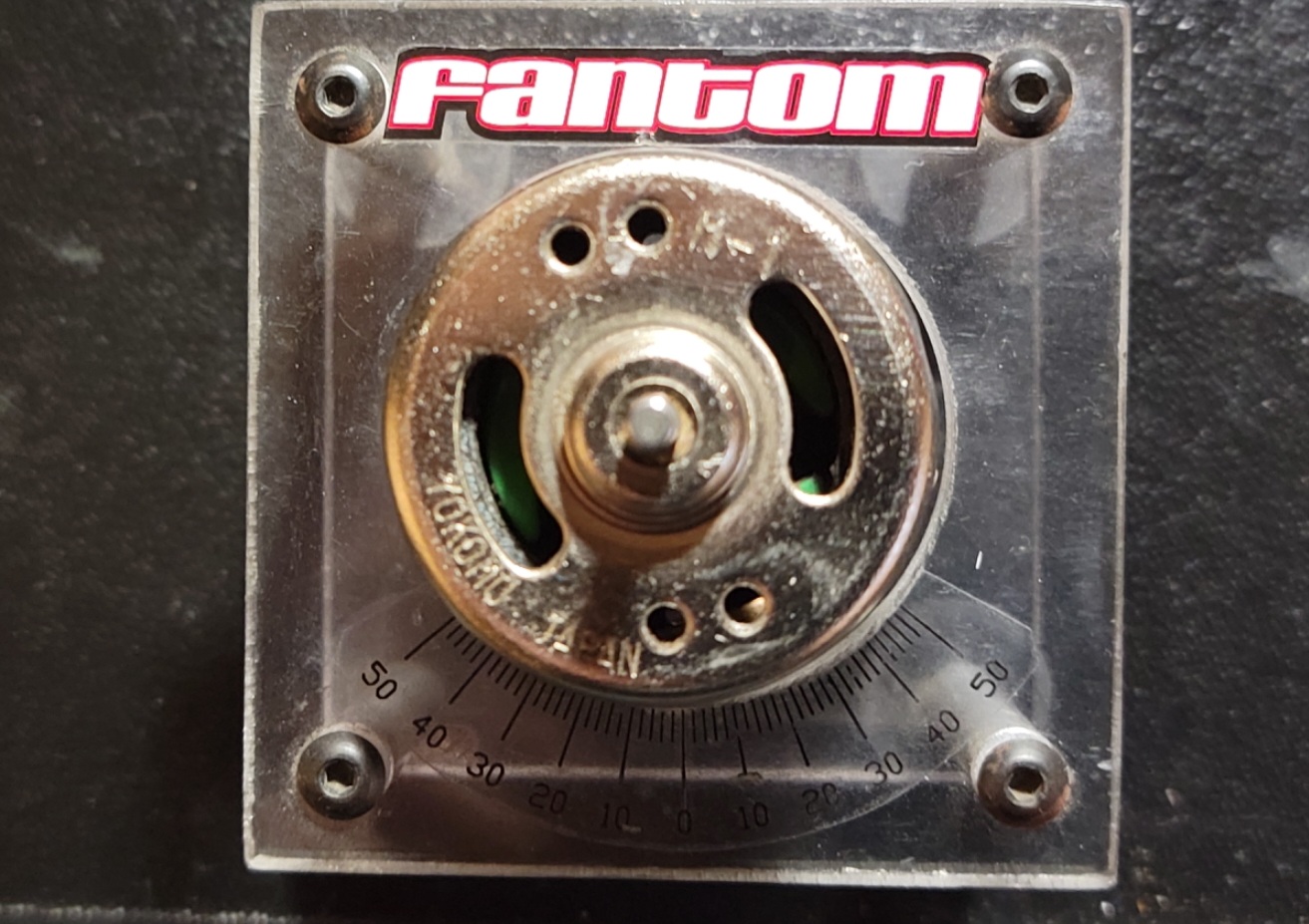

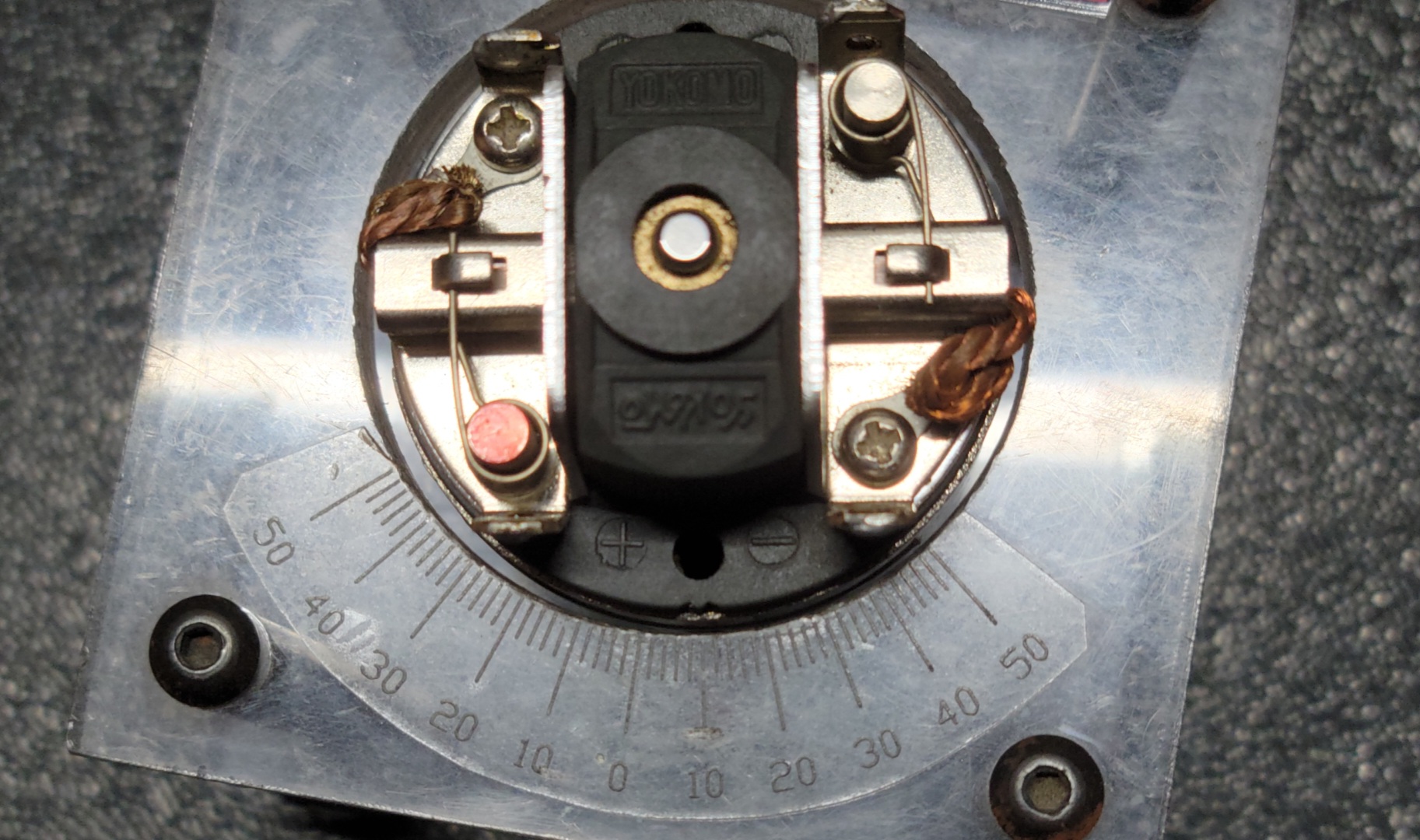

While screwing around, I grabbed it and put it in my Fantom timing jig. I was surprised to see that it only had ~10° (Maybe 12) of timing.

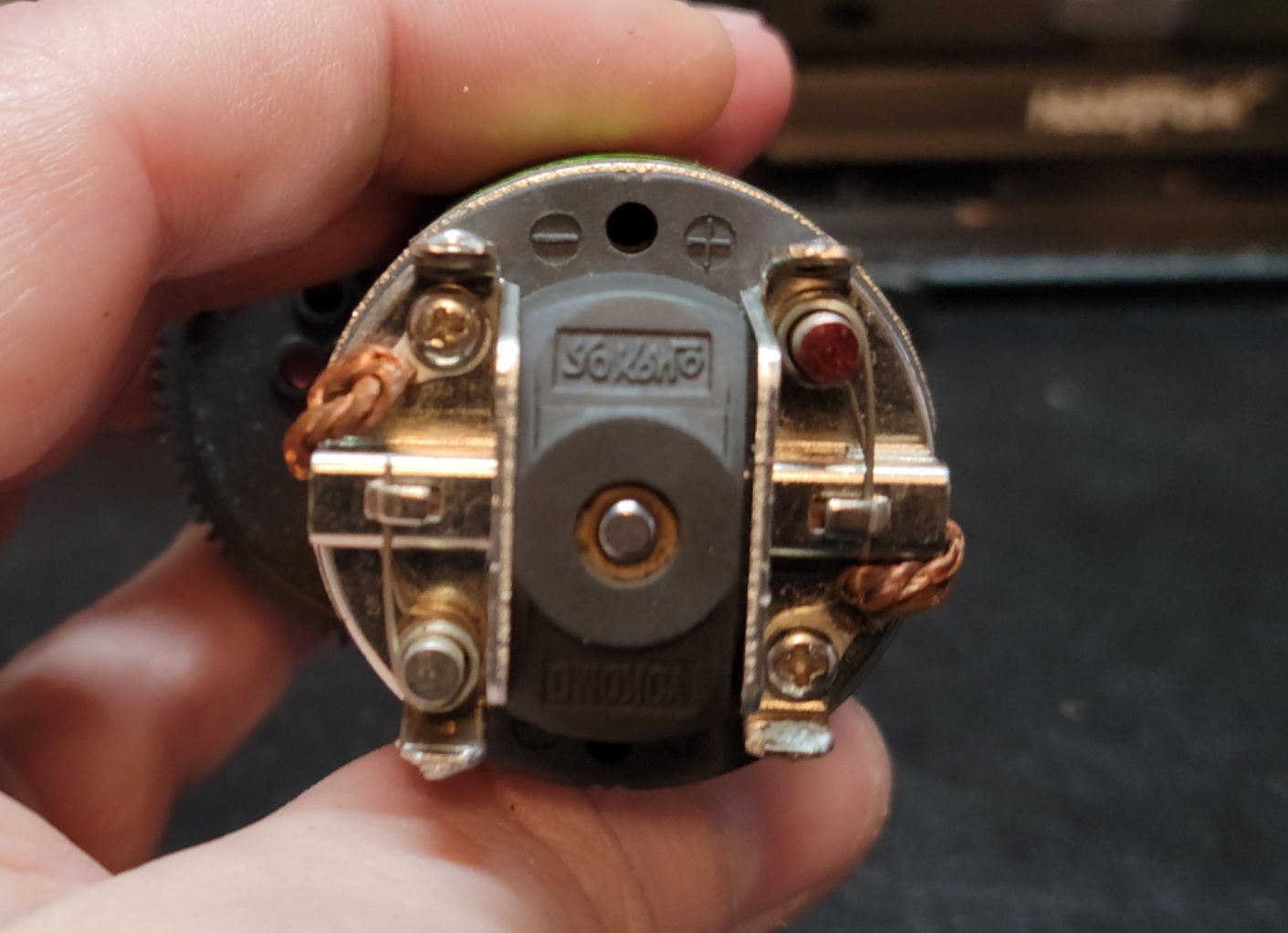

So I checked the other end. No Roar stamp, just "Yokomo Japan" and "M-1".
I'm not familiar with all the kinds of spec classes that were run back in the day. Maybe a 21T, 12°.
Anybody have an idea?

With that vintage of motor build in a Yokomo can and endbell, having a crimped silver 'stock motor' can with less that 27T would have been extremely weird. It would have had all sorts of labels about being an outlaw stock. I didn't see many Buds motors around, but maybe it was a milder timing for more durability. Some of my Yokomo style stock cans without ROAR stamp have an SP stamp. Some have nothing stamped.
