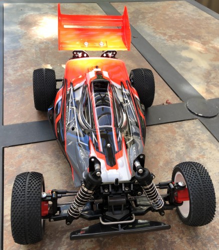

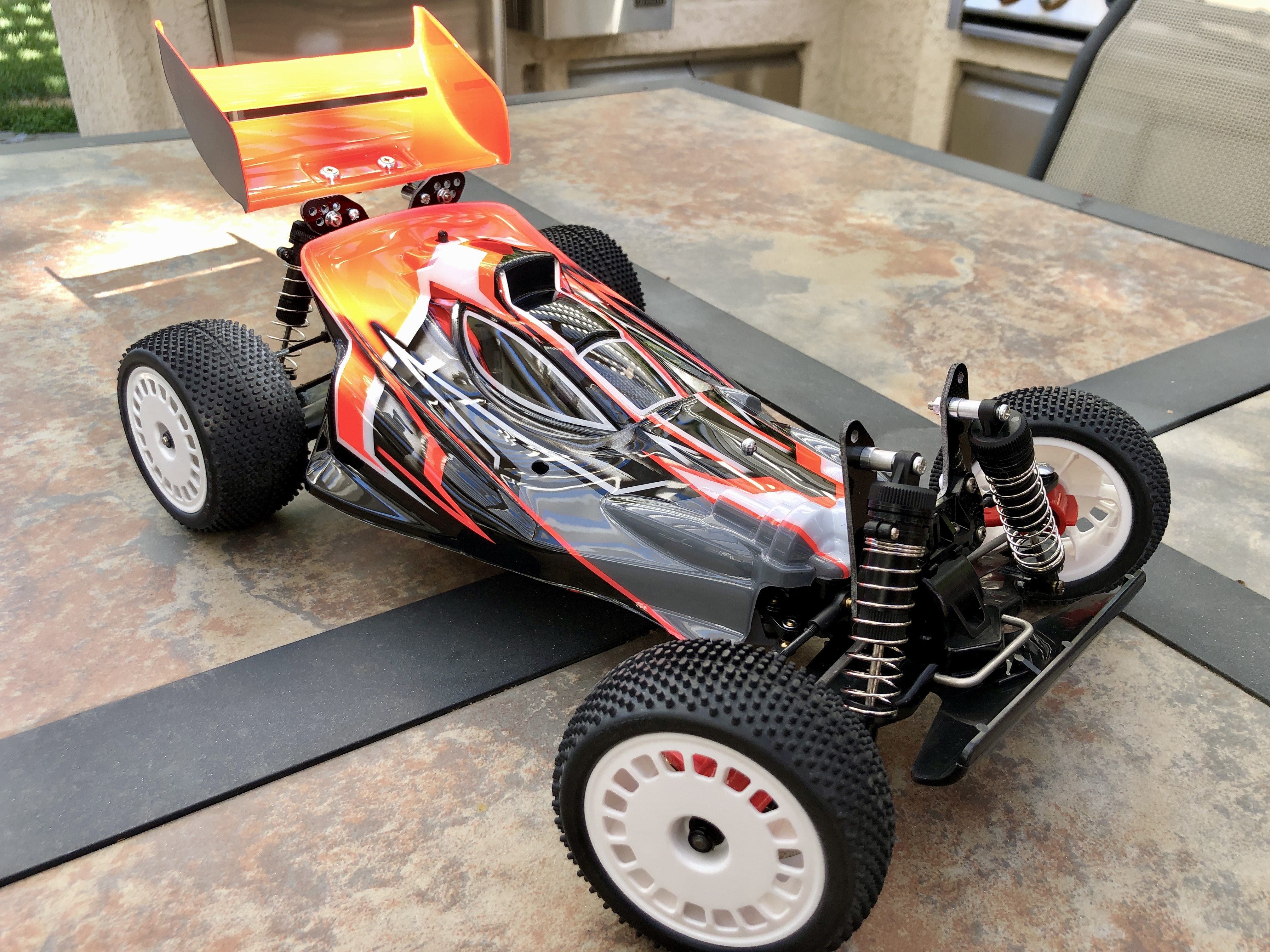

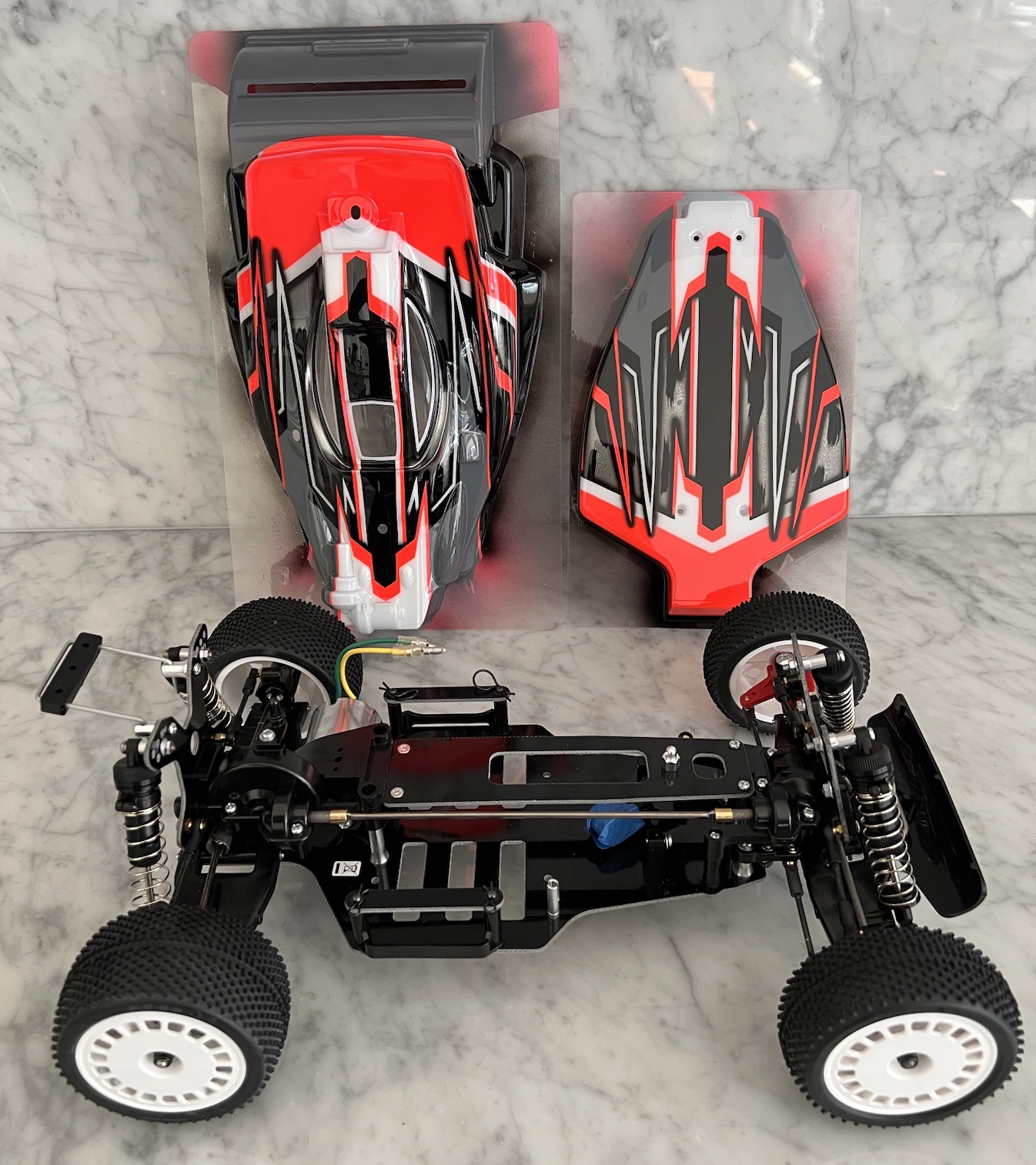

I enjoyed this build and have some general tips for your Top Force reissue build. The Top Force was the 100th vehicle in their lineup and was the next generation 4WD racer after the Tamiya Egress. This is a shelf queen and I opted for different wheels to go along with a vivid original paint scheme. I have a Super Astute, and this Top Force seems like the closest twin brother given the same wheels and FRP chassis, and plastic body shocks etc.
A few tips I thought were helpful in my build:
1) install ball bearings throughout.
2) there are places where the ball bearing are slightly loose (such as the propeller shaft and even in the transmission case). I recommend either light tape or even a light coating of Loctite to ensure that the inner ball bearing spins freeling and securely. Creating a tighter fit ensures that the ball bearing is doing all the work.
3) I carefully heat up the threaded part of the screws (with a lighter) / or put ceramic grease on screws before I insert them into the transmission case. This allows the screws to enter the plastic more smoothly and easily. This prevents cracking of the plastic. For some reason, the screws are a tight fit in the plastic, which is the reason I prefer to melt or lubricate screws.
4) I think a small spacer inside the front shocks (2mm?) (for limiting travel and height) provide a more balanced chassis ride height.
5) I like to upgrade most of the ball cups with reinforced Tamiya ball cups for a tighter fit and less play throughout.
6) For shelf builds I generally use little to almost no locktite on the screws as it often makes it harder to unscrew and disassemble.
