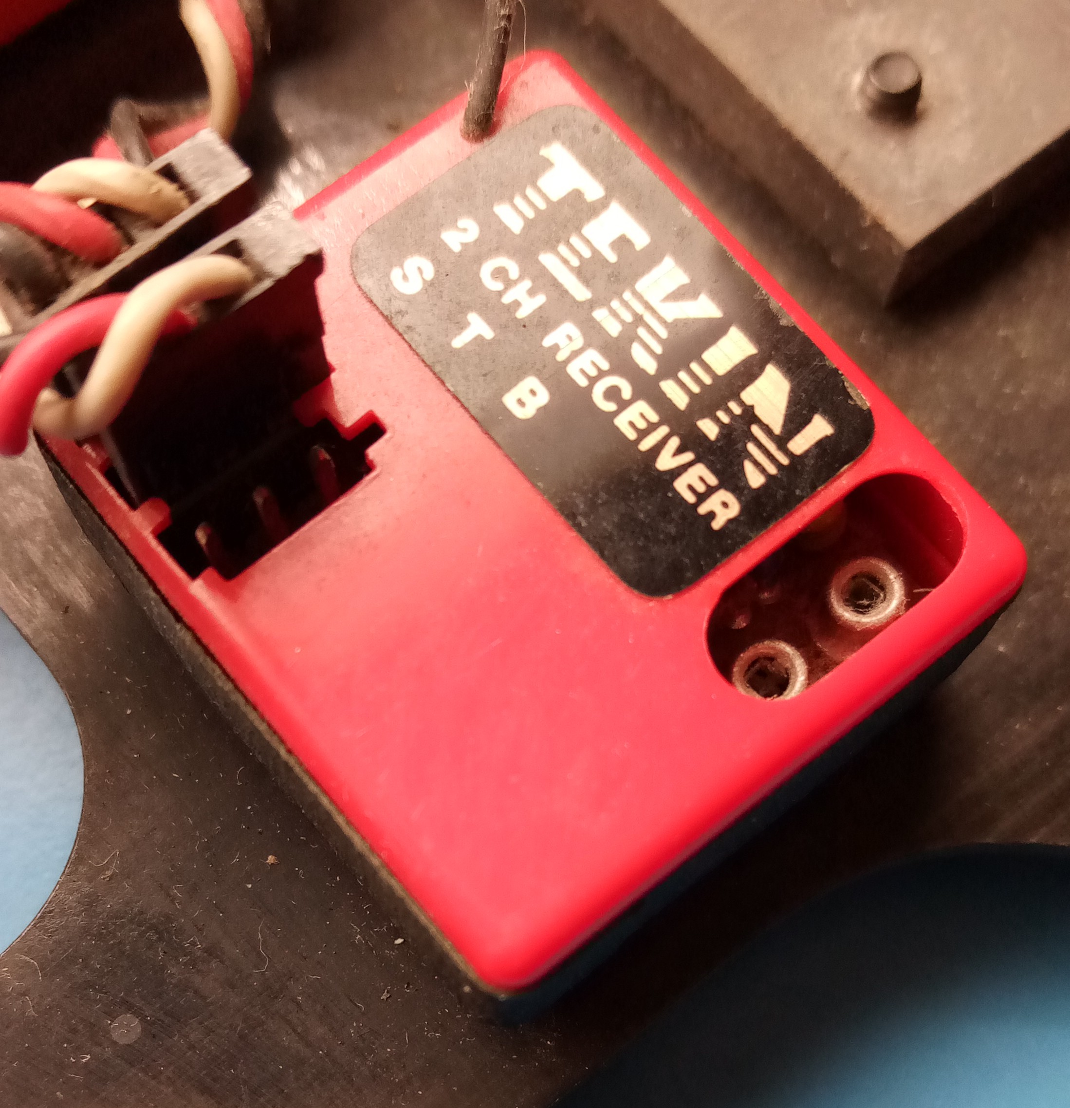

Can anyone can identify this old Tekin? Not much labeling on this one.

It looks like a 27mhz AM, earlier that the TERX models.

Looks cool! Black antenna wire is typically AM 27mhz, right?

I have one just like it, AM.

juicedcoupe wrote: Wed Jul 06, 2022 7:27 pm I have one just like it, AM.
27Mhz? I don't think I have any transmitters that can wake this one up ..... Wonder if my Magnum JR would work if I had matching set of 27Mhz crystals. Currently, the Jr is on 75Mhz. I think I may have to start looking for a 27Mhz radio.

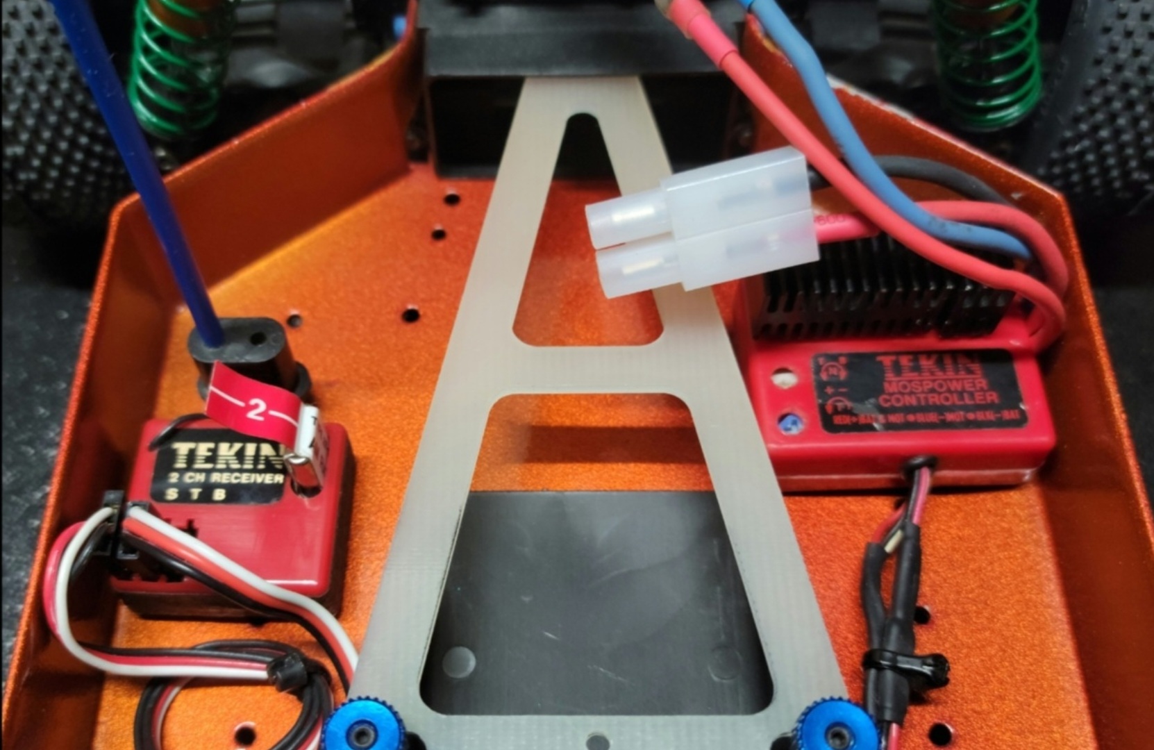

Here is mine, alongside a Tekin Mospower esc.

I have a newer TERX 75 that has a green wire, which follows the Novak trend. However, I believe that the guy at Tekin was known for kinda doing whatever.
I can't see having the wrong band crystal installed causing any problems. If wrong, it shouldn't communicate.
