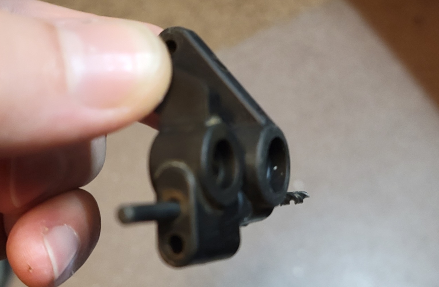

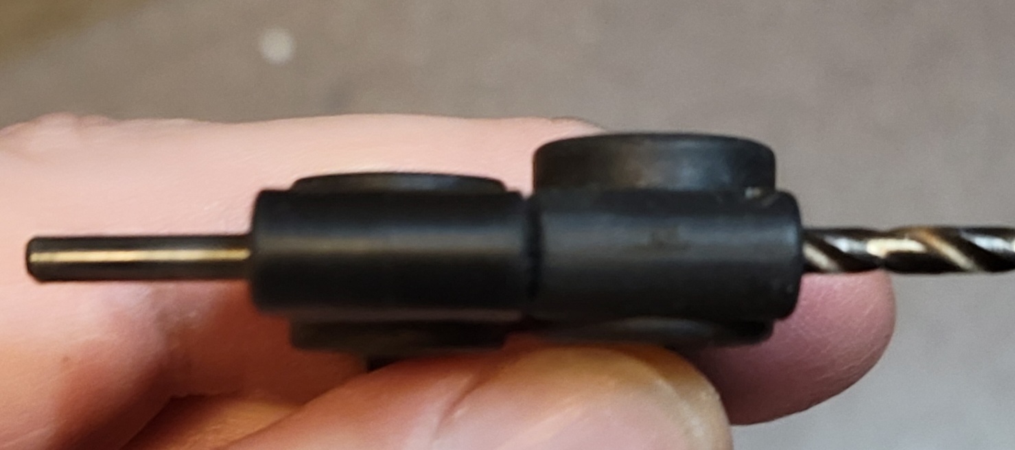

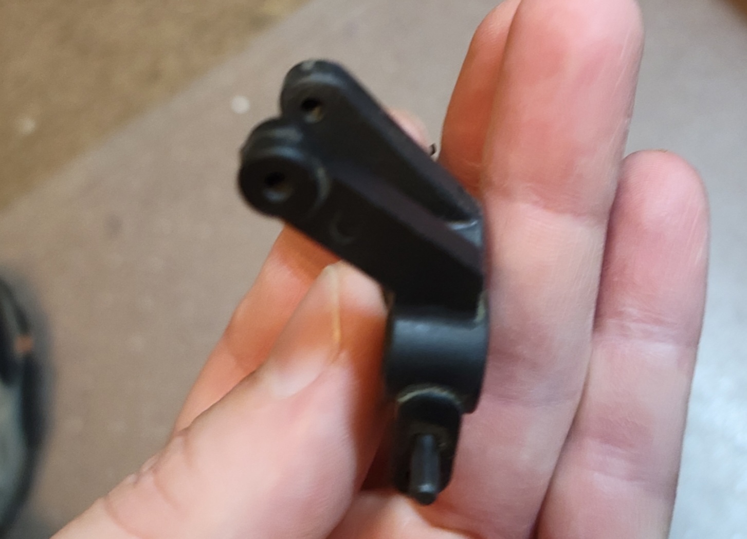

This is a Traxxas carrier beside one from a 10T. They are the common 2WD version from the Stampede, Rustler, Slash, and others.
It isn't perfect but could probably be made to work.
You can also mix and match 3 and 4mm thick bearings to shift the axles one way or the other (this is an older 8mm bearing version but the newer ones use 11mm bearings).

Awesome. Thank you once again. You should be running a hobby shop.juicedcoupe wrote: ↑Fri Jul 22, 2022 4:04 pm This is a Traxxas carrier beside one from a 10T. They are the common 2WD version from the Stampede, Rustler, Slash, and others.
