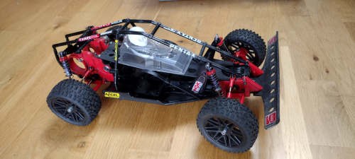

Sudden realisation...wheels on this zerda are originals even if the tyres are crap. Need to remove shitty paint job and find 1.75 inch/44mm inner dia tyres.
- Posts: 396
- Joined: Sun Jan 21, 2018 10:05 am
- Location: Beckenham, Kent, uk
- Has thanked: 59 times
- Been thanked: 71 times

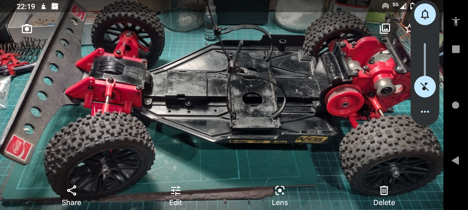

Re: Hirobo Zerda: from wreck to runner
And the wheels cleaned up ok with a soak in alcohol. I had these Advan tyres in the shoebox, a bit worn but look alright.

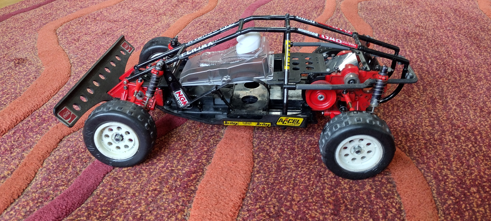

That's coming along nicely , if I was building a second Zerda I'd be really tempted to try the mid motor conversion .

Maybe one day... With old gearbox sides I replaced on the MK1
Happy accidents so far: wheels and finding suitable tyres, and I got an 18t pulley with 5mm bore then found a piece of Meccano sleeve that made a bore reducer. What are the chances?
Been rereading your refurb posts re kyosho tyres etc etc
Next job is steering servo
PS Meccano shafts 4mm and maybe colets, gears etc could help with a mid conversion

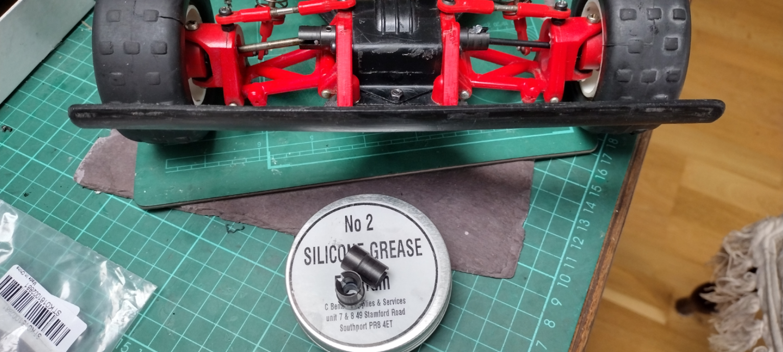

In the post today, drive shaft cups from eBay seller. 4PCS Steel Joint Cup B Set for HSP 94122 94123 94111 Redcat 1:10 RC Car.
And they fit pretty well on the front diff with 61mm dogbones.
A bit snug and maybe slightly shorter dogbones needed. I intend comparing them with the other zerda.
